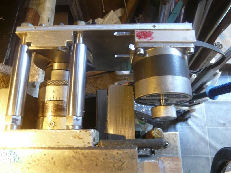

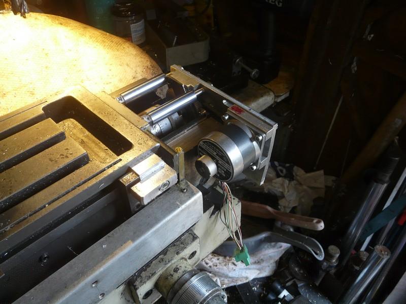

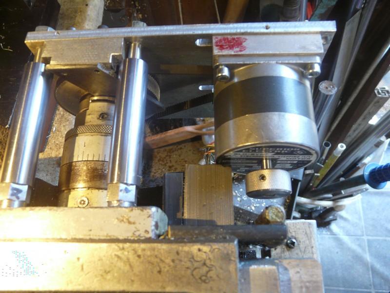

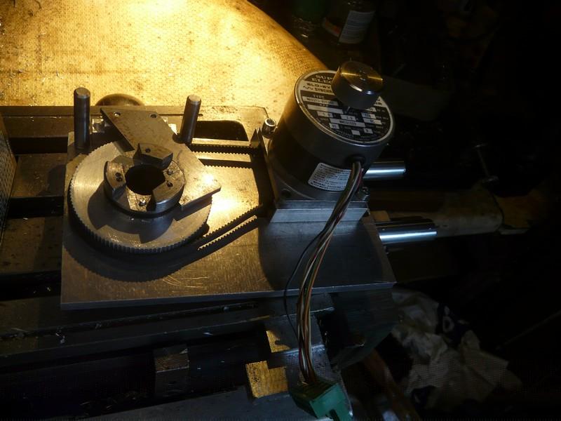

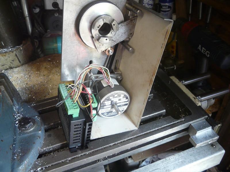

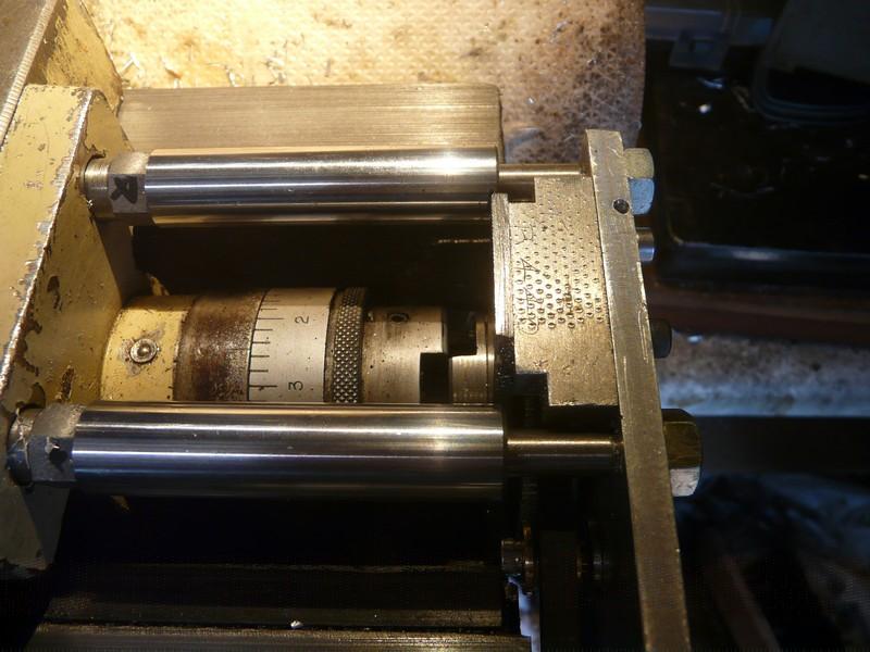

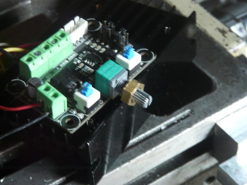

I have made a power feed using a stepper motor controller  https://www.banggood.com/TWO-TREES-MKS-OSC-Pulse-PWM-Signal-Generate-Module-StepStick-Stepper-Motor-Driver-Controller-For-3D-Printer-p-1745906.html?cur_warehouse=CN&rmmds=search from Banggood , using stuff I had cut a GT2 pully and 1/4" ally plate to mount the nema 23 motor , I had a belt but it was to short I had to buy a longer belt and fit an idler , I loose 1/4" of travel moving to the left I can live with that ,

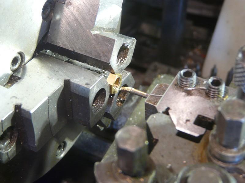

The controller came without a nut and the thread is 6.8 x 0.8mm I take that as 7 x 0.8 , as 1/32" is two tenths different I cut the nut 32 tpi on my imperial lathe over five threads that's one thow error , and it fitted that's the main thing .

Don't little things like that bug you, it would cost them cents to include a nut with it to save the hassle.
Good to hear you got it sorted on an imperial lathe though.
I find factory metric bolt thread diameter to anywhere from around 0.15mm to 0.35mm undersized, so it probably would have been 7mm.
I have seen so many new guys over the years ask why the die won't start on a shaft they have turned down to say 6mm expecting 6mm thread to be 6mm spot on.

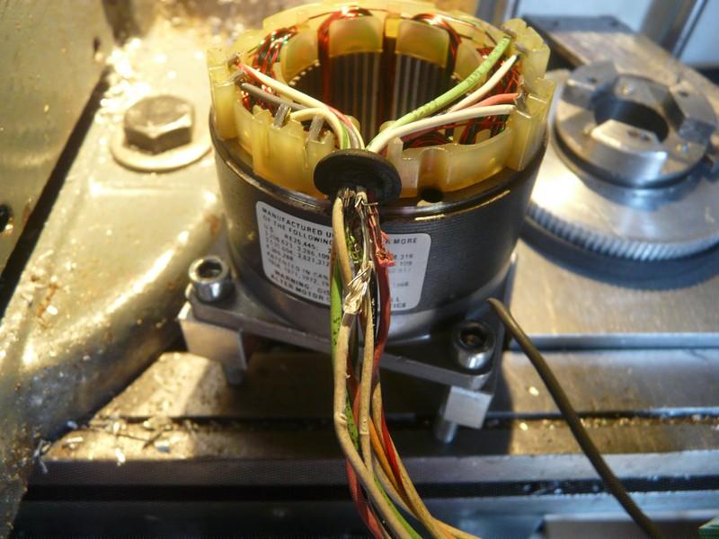

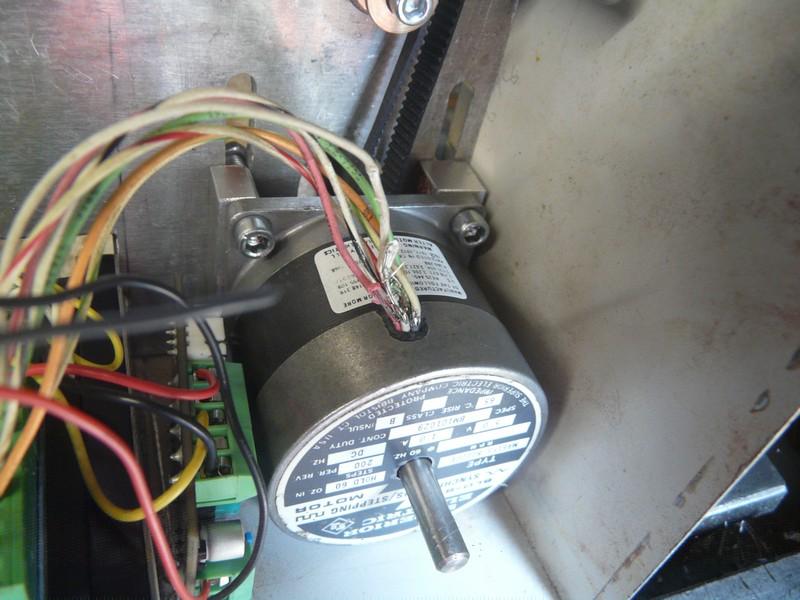

Bit of a cock up last night tried another test fit ang pot the motor in the wrong orientation and shorted the wiring , stripped the motor today and replaced the wires , the steel wires were crimped to the windings so I soldered the pairs together and changed to a four wire set up , no photo of the finished job as the camera battery died .

Nothing worse than knowing it's your stuff up, good to hear you got it fixed though.
That magic smoke never goes back in, lol
I have had to dig in a few motor windings to make them do what I want them to do.

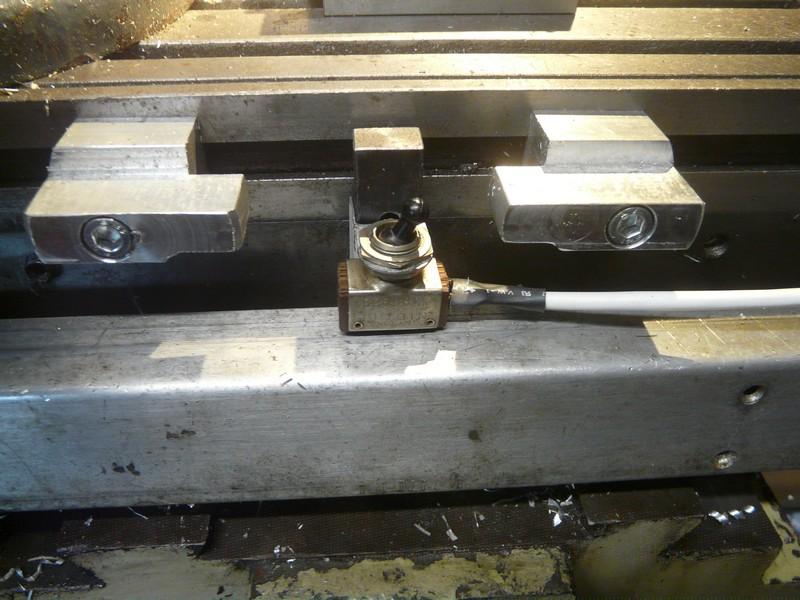

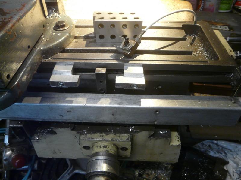

The direction is signal or zero so a simple on or off toggle switch , rigged up with stops gives automatic revise and is remarkable accurate for something so simple .

« Reply #10 on: August 08, 2021, 10:59:03 AM »
Nice work

Aw come on that’s waaay to easy!  :jaw: That would be good for winding coils also.

Works a treet and is so simple to set up .
