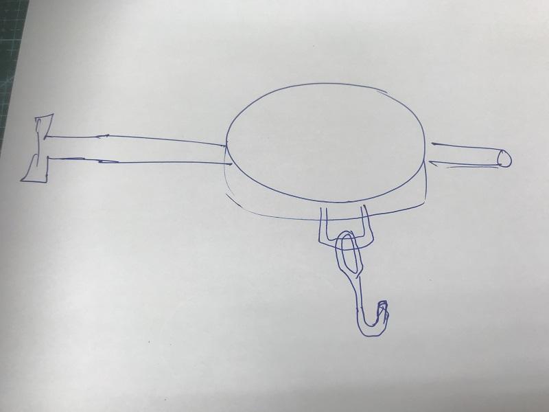

The one I remember had a hook with an oval pivot hole that was impaled by a U shape welded to  the ring pointing outwards and horizontal. The hook could pivot up to the crucible lip and due to the oval hole lift a bit more a drop over the edge.
Rather fiddly I thought but  it worked
Have a crude sketch:
