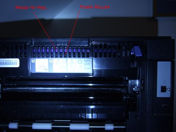

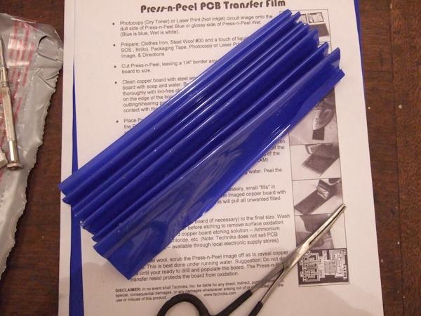

I received the blue Press-N-Peel sheets yesterday. These are supposedly designed for laser printer transfer to printed circuit boards. Pricey stuff, $3+ per sheet. I bought 5.
Well that was a mistake. The first sheet I tried disappeared into my Dell 1250c laser printer (Xerox Phaser 600b engine) and never returned.   :scratch:
Removing all the user access covers for clearing paper jams failed to disclose its location.  :bang:
Shining a strong flashlight into the back cover grill showed a thin sliver of blue trapped in the (well guarded) fuser rollers. The entire sheet was compressed into a space a couple mm wide (see I can use metric). :bang:
After a fair amount of internet research uncovering some approximate anecdotal advice I managed to take off the retaining bezels defeating most of the devilishly clever hidden plastic retaining hooks catches and pivot points, only breaking one or two in the process. And finally loosening the entire top case of the printer for access. :bang:
The plastic grill (still attached) covering the fuser roller was bent back far enough to insert a hemostat and clamp onto one bit of the blue transfer sheet. I gradually worked it out through the top of the grill.
Released and expanded it looked like the side panel of an accordion. I have never seen a worse paper jam. Well it's not paper, actually, it's very thin plastic film, super shiny on one side. Who in their right mind thought that this kind of thing would pass through a laser printer intact? Including me? Why didn't I go......hmm, that'll never work, let's not take a chance? But nope, I just ran it through, thinking gee this stuff says it works..... I'll soon have a brass etched plate, now.....Duh!  :wack:
Okay, folks..... don't buy Press-N-Peel transfer sheets unless you enjoy "Pressing" hidden plastic fasteners in your laser printer's construction a"N"d "Peeling" crumpled plastic film out of its fuser rollers.  :dremel:
Luckily my printer wasn't damaged (other than the broken catches) and I was able to print again on real paper after the fiasco. What a blivet.  :zap:
Caveat emptor.
