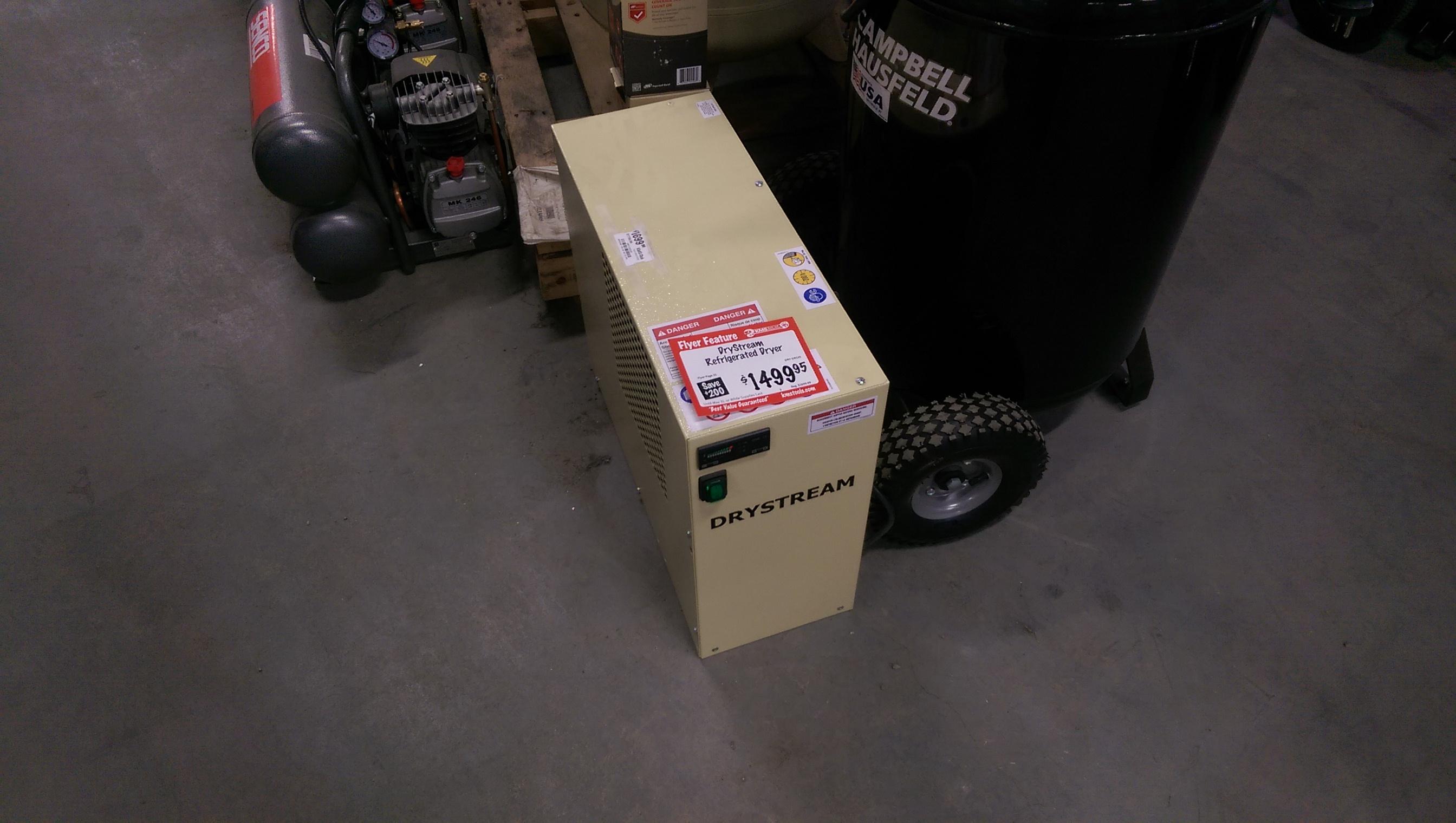

I use a DryStream   [ You are not allowed to view attachments ]

I use a DryStream
Is't that a bit expensive kit to keep workshop interior slightly less humid? :scratch:
Re: Need a small desiccant drum dehumidifier for my workshop
« Reply #5 on: January 19, 2021, 10:59:58 PM »
This is so the waranty is covered. Apparently the pellets are not good enough.
