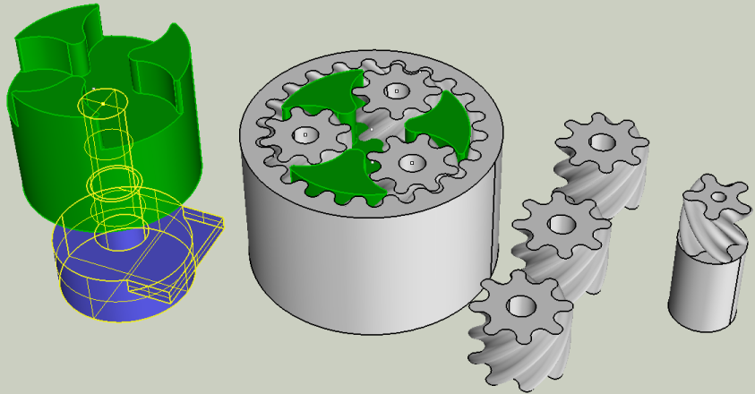

Today, after finding this video, I got stuck in the idea for printing the reduction gears for the pot, after all:
As can be seen, fewer and bigger gear teeth are used. There is a link to Thingiverse for the 3d model in the video description.
There seems to be quite a lot of slack between them, which could probably be adjusted in the slicer settings. Haven't got much into that, so I rather redraw/modify the gears using 3d software.

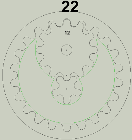

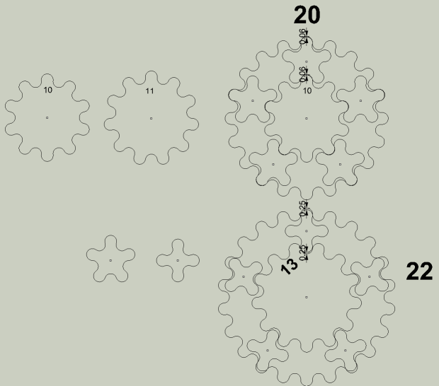

When there are sun- planet-, and ring gears involved, trying to figure out the gear ratios makes me feel dizzy, so it's better to just print out some samples, and see, how it works.
Nothing critical about the gear ratios, so any result, that 'feels' good enough for the purpose, is worth testing with actual potentiometer.
At first, I'll be using simplified tooth shapes for sketching:
This will be a short sideproject, to see, if the concept is relatively easily implemented, as I don't feel like delving into it too deeply at this point.

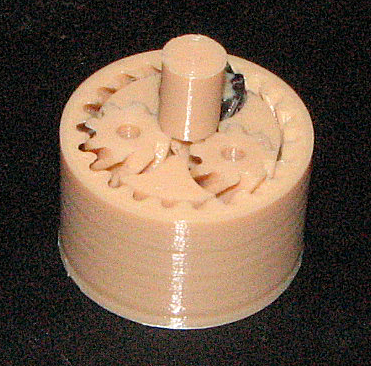

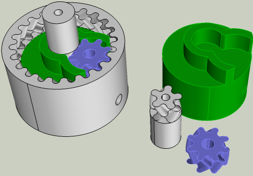

The "potentiometer gear reducer" -side project goes on: I noticed, that gears with straight teeth don't work so well in this case, so helical ones would be better.
Test setup for gears with 45 degree angle:
Idea came from this:
Printed parts:
So far, it seems to work as expected. For now, tolerances are bit tight, but it's just a matter of playing with the offsets of the gear profiles.
Also, as the gears are helical, they tend to 'climb' up or down, while turning back and forth. Some sort of support structure needs to be added to keep them in place.
Currently the footprint, or outer diameter of whole thing is 30mm.

I'd suggest printing them as Herringbone gears which have no side thrust. The downside is that the outer would need to be split so that it could be assembled from each side and then joined at the separation line. Or maybe the gears could be printed as two halves that come together with pegs to engage them. They'll still require some means of gluing or a snap-together fitting so that they don't part company in one direction.

Seadog, thanks for the idea! I tested it and it works very well to keep the gears in place.
Assembling the thing, yes, it's a bit of dowside, but somehow I managed to cram the gears together.
With the gear sizes, that I've tested do far, the reduction ratio is close to 4(by eyeballing, while rotating). Sun gear has 5, planet gears 8, and ring gear has 22 teeth.
To simplify the thing, I guess only one planet gear(blue one) might be enough, as there aren't much of forces involved. With small, printed gears, there seems to be always hideous tight spots, so reducing the gear count is an attempt to minimise that:
If more gear reduction is needed, there would be room for that also:
To get less wobbly action, the sun gear should probably use a metal rod(2mm in this case), attached to the green part.
As an alternative for using gears, plain friction based one, as on a picture on the previous post, should make the desingn a lot more easier to build. Using the steel balls would require very tight tolerances, and is therefore beyond the scope.
Again, one possible option could be to use something like rubber as a material for the planet gear, which otherwise causes the tight spots.

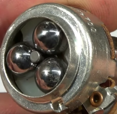

I think you are getting confused with the ball bearing pot.   They are no more precise to make than a 3 legged stool, the use of 3 bearings (the items of precision) allow the shaft to self centre, a bearing pot can slip.  It relies on two conical surfaces to work, the shaft is tensioned to maintain friction.  As the shaft and cone wear, the ratio of turns also changes, slightly.  Do you want repeatable location (geared) or high resolution of motion, the two are not the same.

Joules, that's interesting. I thought that the ball mating outer metal surface had similar form, like on ball bearing. Thanks for clarifying.

For the benefit of anyone struggling with how this works, the parts contacting the balls need to be metal, but the rest could be 3D printed, such as the carrier that holds the balls and transfers their motion onward.   I know this form of reduction drive from telescope fine focus controls.  The drive can be configured push or pull by the direction of the cones, this is in fact the opposite to the potentiometer in question, only low load applications need apply   8-)

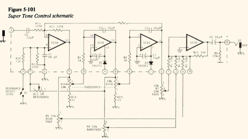

Build the 'Super tone control', that has separate high- band- and lowpass controls in it:
It should add more flexibility for tone shaping of the input signals. If it does well, I'll build another one for the output also.

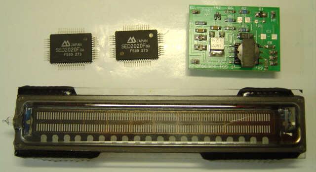

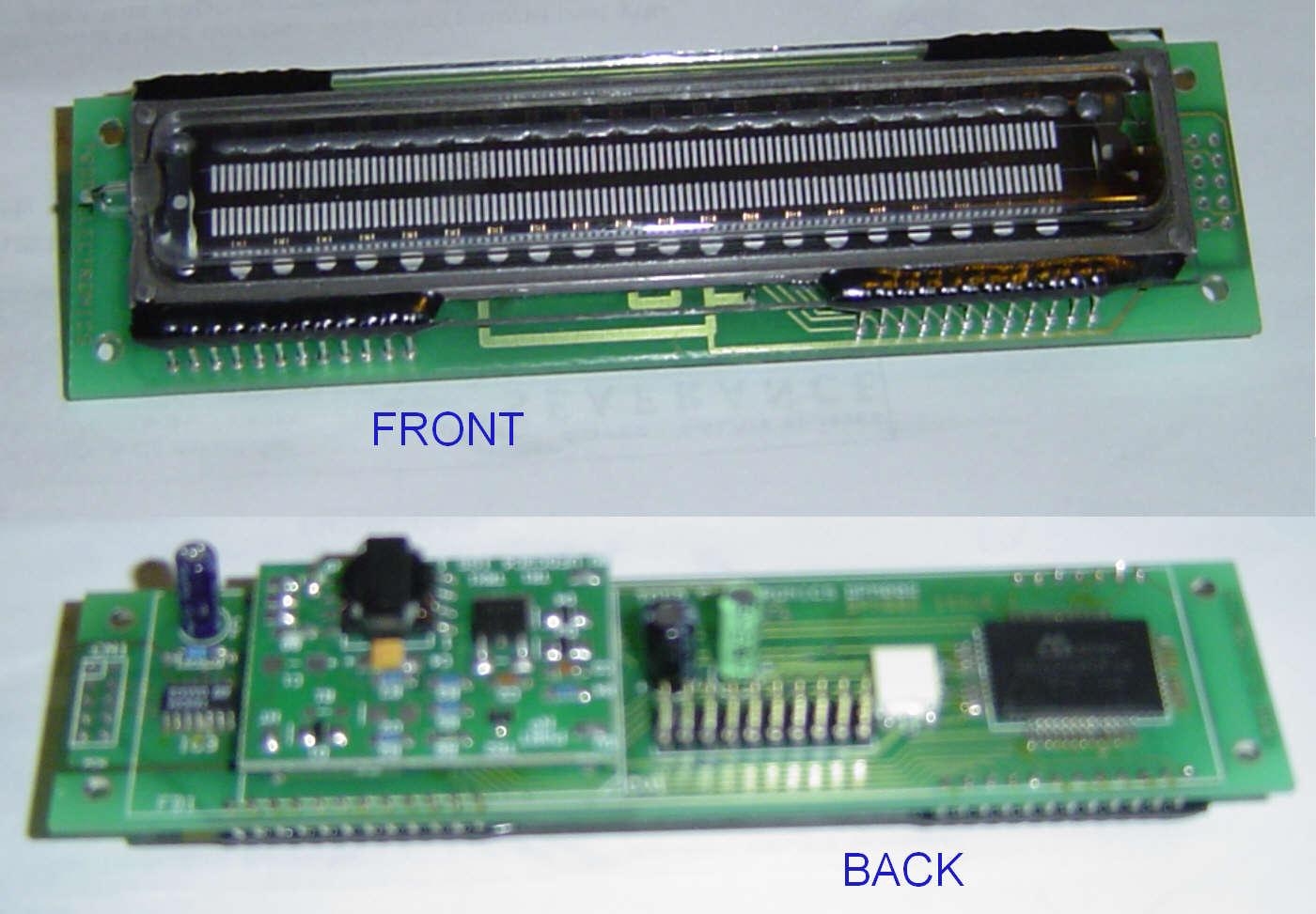

I've had a far-fetched idea of adding some kind of an audio analyser to the setup, having an led bar display for each channel, to show and hold the peaks of average values of say, 5 sec. audio samples, to get the 'profiles' of certain sample's frequencies.
Can you program a PIC micro? (specifically 16F877)
I have a few 101 segment bar graph VFD devices and drivers (I think I'm out of PCBs but the gerbers are in the zip file) . Happy to donate one to the cause if you can use it :-)
https://drive.google.com/file/d/0BwXDcXKx2KzldldqSlZTS0hvT3M/view?usp=sharing

Bill, I appreciate the generous offer. Only problem is, that I don't know how to program in assembly langue. Back in the eighties I had the Sinclair Spectrum, which had an option to use assembler(was that same as assembly language?). Although I was fascinated by its sheer speed(sample programs from books and magazines), when compared to ones written in basic, I never understood its construction.
Later on, when internet started to grow, there were more info and samples of it available, but still I ended up scratching my head. So far, basic is the only language, that I can comprehend, and write simple math programs. I remember trying out some basic to assembler(or to machine code) translators at one point, but back then the results weren't too spectacular.
Since then, I haven't looked much into it, so in these days, more robust ways to do the translating could be available. As far as I know, there are also Basic Stamp -systems available, but as they don't seem to be as popular, as PIC-based ones, the prices are prohibitive, especially, if one needs several of them for separate projects.
Apart from the "language barrier", an interesting subject.

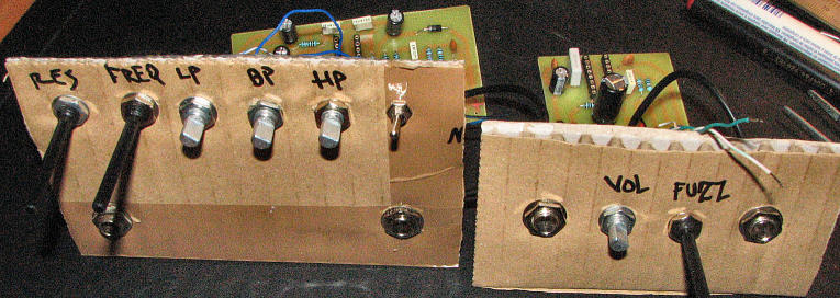

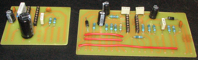

Today I managed to almost finish the fuzz and super tone control for the vocoder:
Again, the fuzz pcb layout was mirrored, which I noticed(again), while soldering the corner legs of the ic socket.
Anyways, It was a breeze to make a corrected one, as the board is so small.
The way, that the fuzz works with the vocoder is already tested, when it was on the breadboard. The super tone control will have to wait, until the vocoder itself is fitted into the enclosure.
The plan is to use as few switches as possible, to avoid unnecessary wiring hassle, when compared to the original, Paia version.

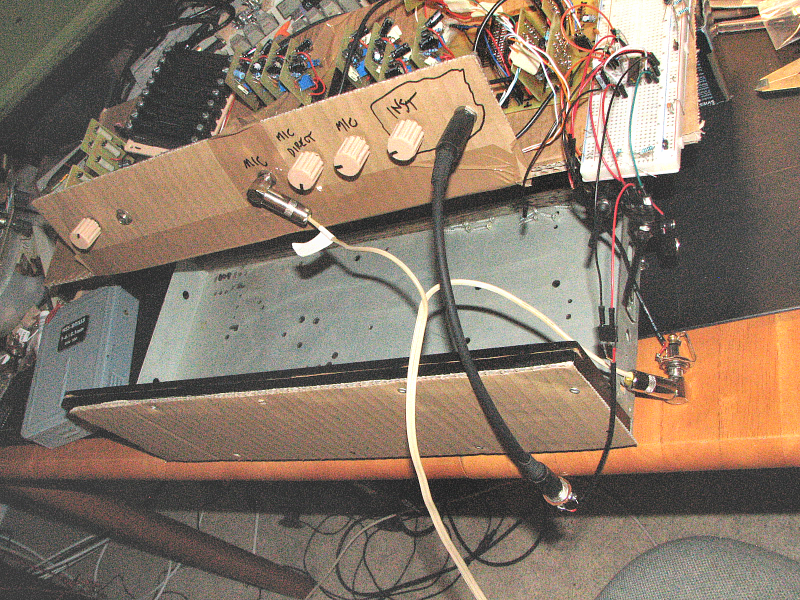

Now the vocoder has an enclosure, although carboard is still in use for front panel:
There will be at least 7 pots more and one switch, once the fuzz and super tone control are installed. Then plug for the headphones, so the output doesn't need to be connected to the pc's soundcard, while testing.

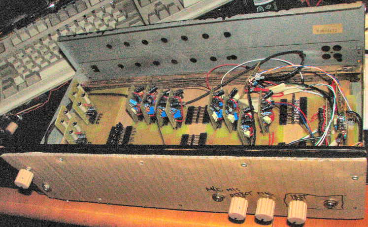

Today more cardboarding:
Before putting the tone control and fuzz into the vocoder enclosure, it's easier to first test different combinations, to see, how they work. Knobs need to be printed, and power supply wirings added.

Tone control and fuzz are now tested and working. Haven't used them with the vocoder yet, as I got bitten by the "guitar repair/mod" -bug.
