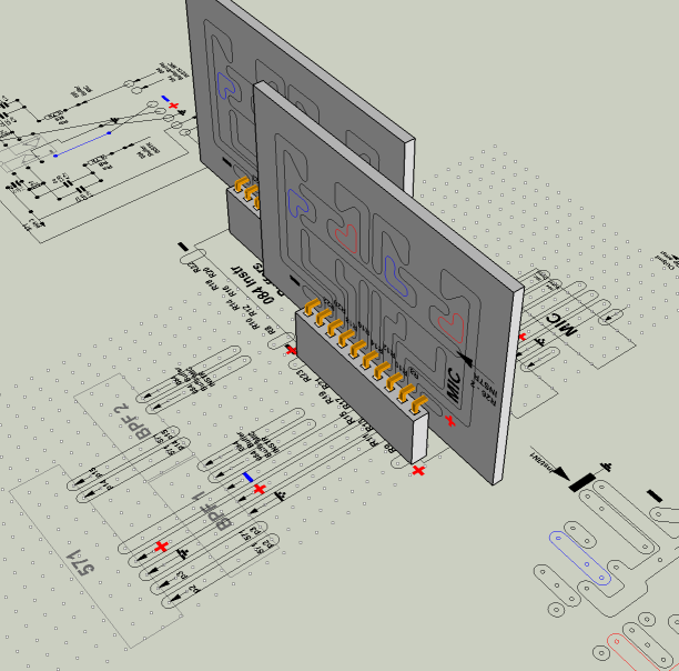

Today I've been mostly scratching my head, about how to draw a 'bus board' for the blocks:
Idea for that came from the Elector vocoder. I'll draw 3d-model of all the boards(blocks), as they are built.
Usually on more complex projects like this, it's the best way for me to make sense, by 'simulating' the objects, that have actual physical dimensions.

I haven't yet found a way to draw the 'bus board', or 'motherboard', where all the blocks could then be inserted using headers. It's probably because at the moment I don't have too much of circuit board to spend.

Bus boarding in process:
Really good concentrating exercise, I must say. I started by adding power connection traces, but soon noted, that It's better to leave them last. That way the signal paths have traces with less jumper wires.
Whole layout is about 260mm long, so it is too big for me to make it in one piece. Once the drawing is done, I'll divide it to 3 or 4 parts, which could then be connected together using pins and headers.

Drawing of the bus boards first version is almost finished:
At this stage, I think I'll probably use angled female headers for bus board connections. At least it should make testing of the separate boards easier, by using the same wires as on the breadboarding.
If testing goes ok, they could then be connected together by adding male pin headers between them. For that, I'm going to order longer ones, as the ones I have in shelf, are too short.

To see, if the compander bus board could be used for led-ldr pairs, I made adapters for the pin headers, so that it's easier to connect the breadboard to the rest of the circuitry:
I did roll some temporary optoisolators to test the concept. They aren't lightproof, and need to be covered with something like a cardboard box, when testing. I had to order more ldr's, as it is probably better to have the same model for all the eight pairs:
First I connected some leds to compander bus boards' header pins(which are connected to band pass filter's(bpf) outputs), and it was like a christmas tree. Frequency sweep from 0 to 6000Hz showed, how each channel responded to certain frequencies. Adjustable gain, first stages(for mic and instrument) had expected results; when turning the gain down, leds dimmed correspondingly.
So far, it looks like the bpf's outputs itself might have enough drive to make the leds light up at the usable levels.
One part of me tells that the signals should be buffered, before they hit the leds, but not yet; only if there are several, noticeable impacts to the rest of the circuitry, then it should be done.
Version 0.1 layout of the possible compander-replacing led-ldr portion:
Mic input signals drive the leds, and should ideally be in a dc form. Diodes do some rectifying by allowing only positive peaks of the ac-form audio waves to pass through, and then the 47uF caps smooth out rest of the signals.
Instrument input signals go through the ldr's, that act like variable potentiometers. Again, microphone's signal controls the intrument's signal output level.
As can be seen in the above layout, 'outputs' of the ldr's are fed to the final stage, being an op-amp. They are simply tied together, which shouldn't work, as all of them will fight against each other, to get a place in the sun. Buffering seems to be the key, and is added later on, if definitely needed.
