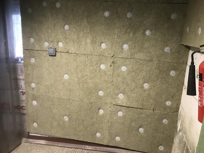

Cracking on today I got the north wall covered in acoustic insulation apart from where it abuts the west wall, and I got the south wall insulated over the wooden cladding, again leaving a gap next to the west wall. The east wall is finished so I am left with the lower (masonry) half of the south wall and the west wall to complete.
The west wall is where the radiator air leaves the enclosure, and I need to bend up the cowl arrangement and insert it through the wall before fitting the sound insulation.
I also want to sound insulate the ceiling - probably using wire mesh of some form with the Rockwool resting on it - I have two unevenly spaced rafters to fix it to so it needs to be stiff enough to carry it's weight and that of the Rockwool over a cantilever of 600 mm and a 'both ends supported' span of a metre. 50 mm mesh with 2.5 mm wire is looking like the best candidate at the moment but £12 a sheet and 6 sheets takes the shine off it. If I could get over the cantilever somehow I'd use 1/2" mesh chicken wire but by the time I've messed around with batten etc I think probably I'll go for the simpler solution of stout mesh!

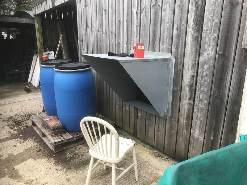

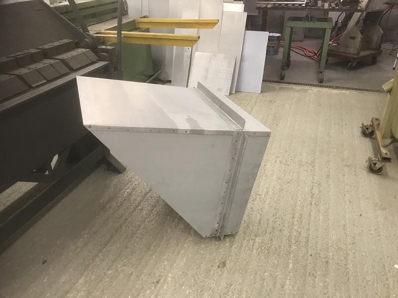

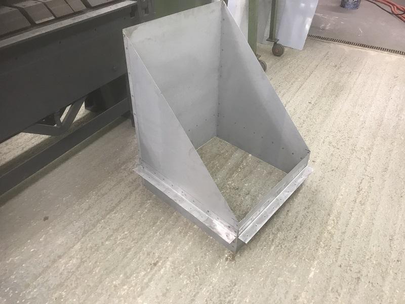

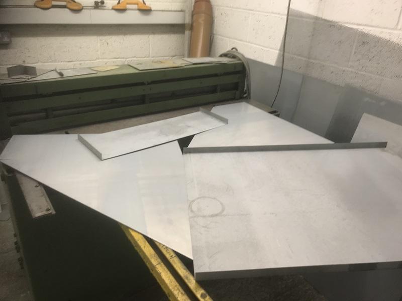

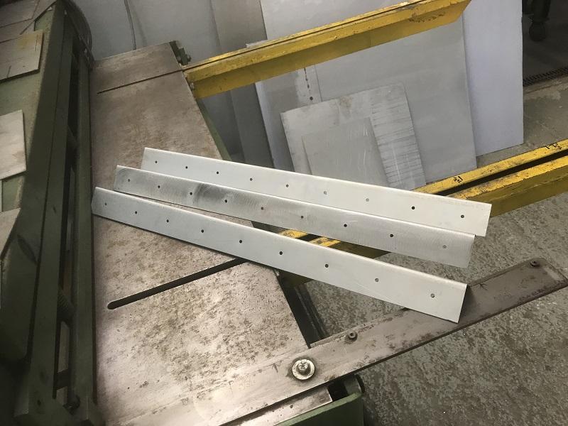

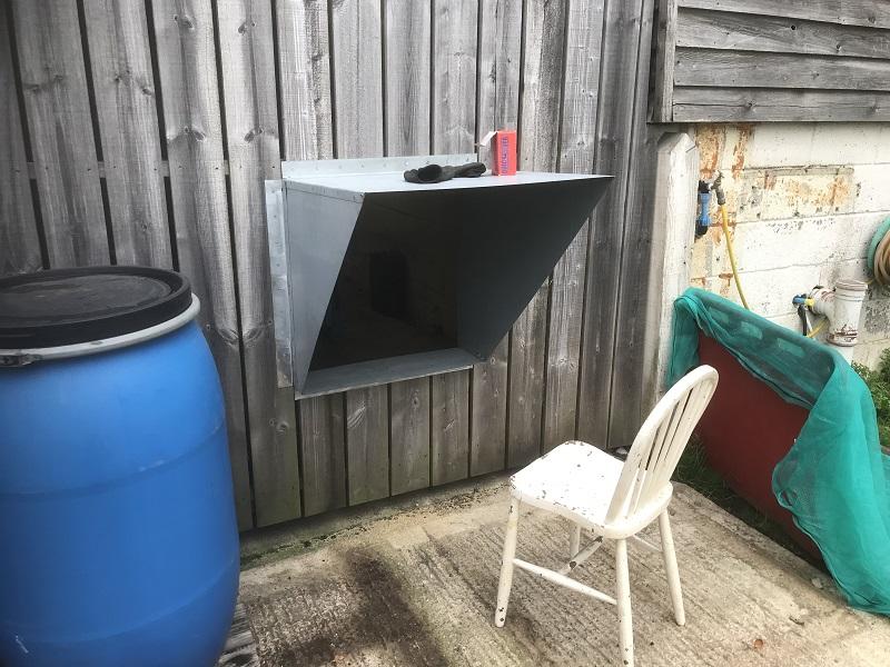

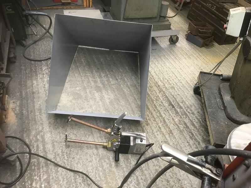

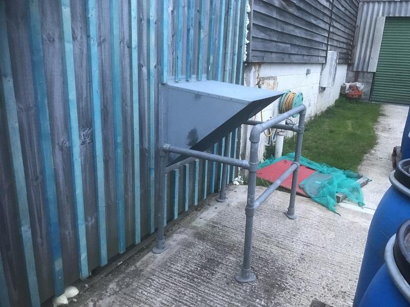

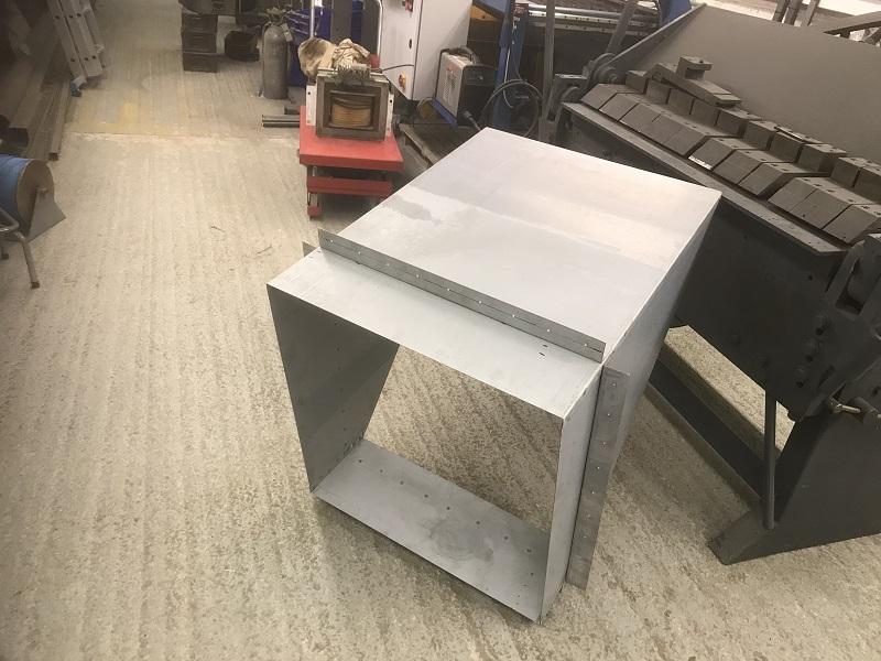

A burst of intense sheet metal bashing this morning produced a radiator cowl to be fixed to the the west wall of the stable when I've cut a suitable hole.
When it is in situ and therefore somewhat more rigid I will add either some louvers or a mesh to stop wild life entering.
I've spot welded pre-drilled flanges on with the upper one 1-1/2" displaced from the lower one to make the horizontal surfaces of the cowl actually slope outwards to shed rain.

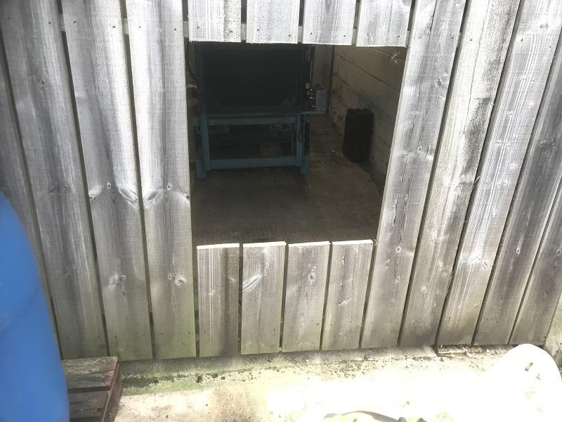

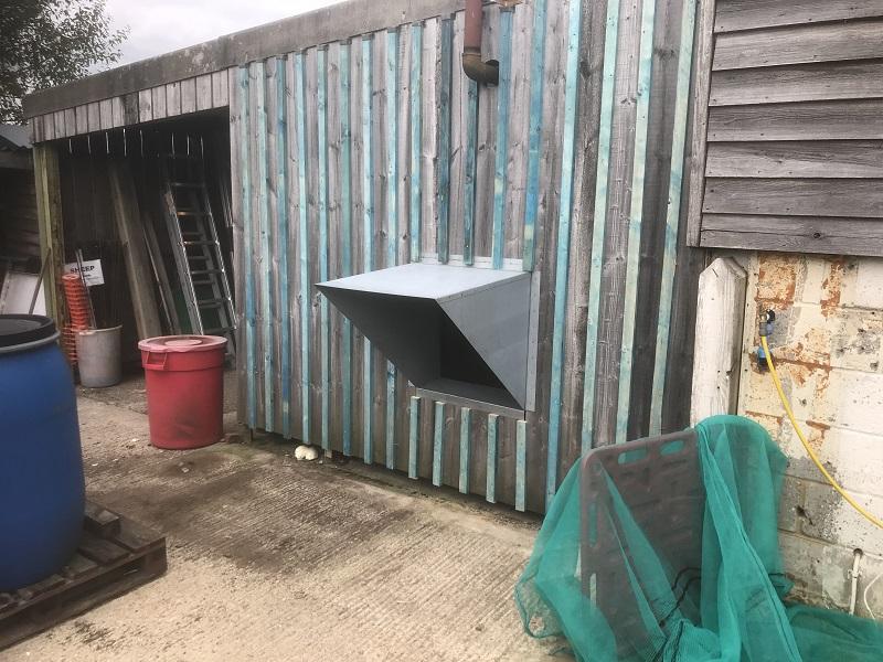

Next job - mark out and cut a darn great hole in the stable wall  :bugeye:

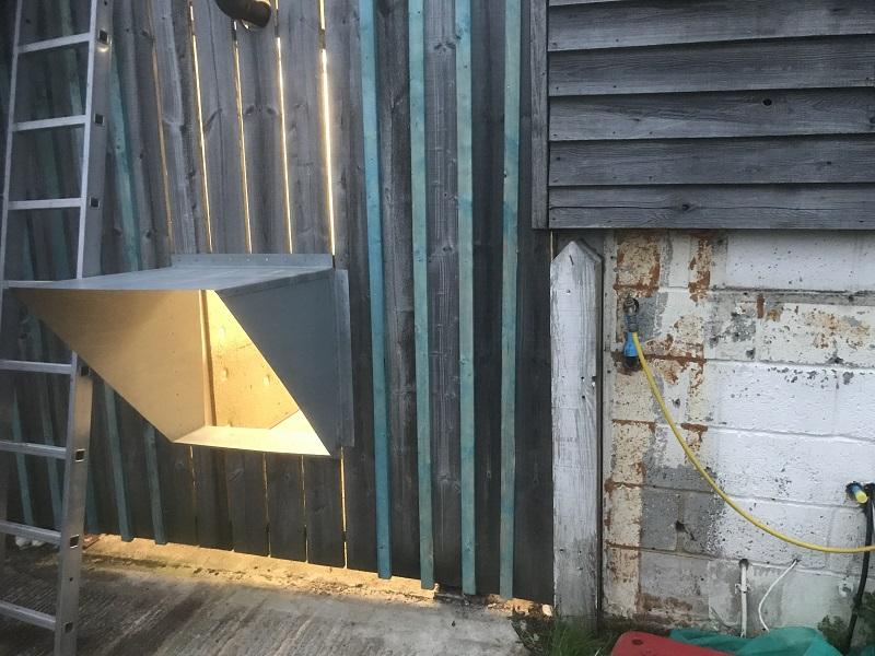

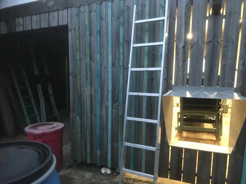

« Reply #82 on: October 17, 2020, 08:32:13 AM »

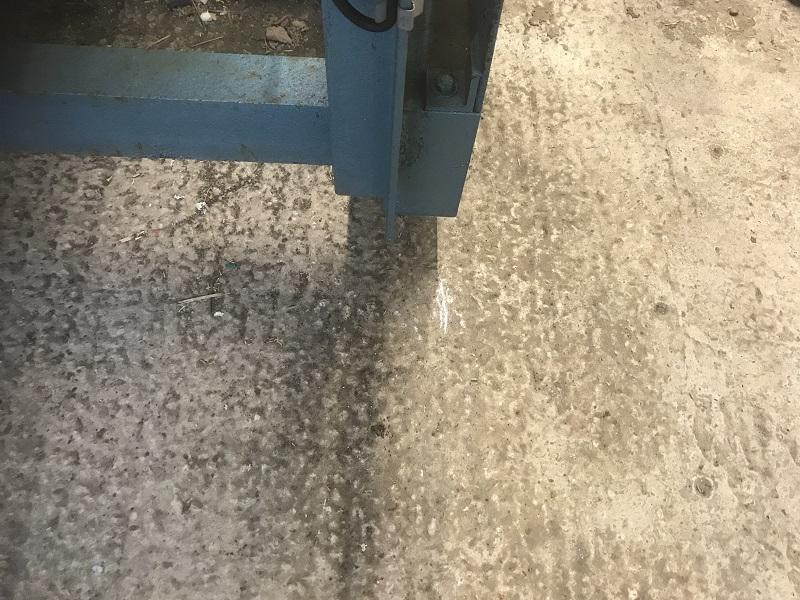

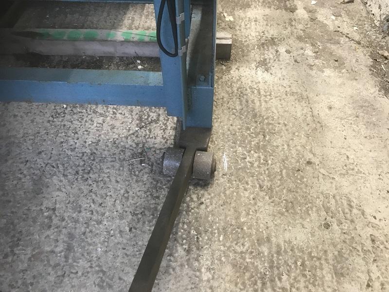

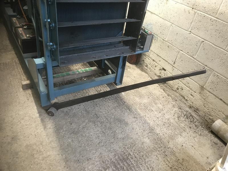

Measuring up the wall to cut a hole for the cowl showed me that the generator was not quite parallel to the south wall - the radiator end needed to move south two inches, and if it did that the required hole EXACTLY lined up with four of the stable wall planks.
So shift the generator - it's only about three tons and the direction of travel is slightly up hill - just do it  :scratch:
Roller crow bar to the rescue and it's amazing what you can shift single handed with a bit of grunt  :clap: So now the potential hole is in a more conveient place cut it out - so I did with my jigsaw.

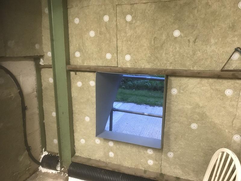

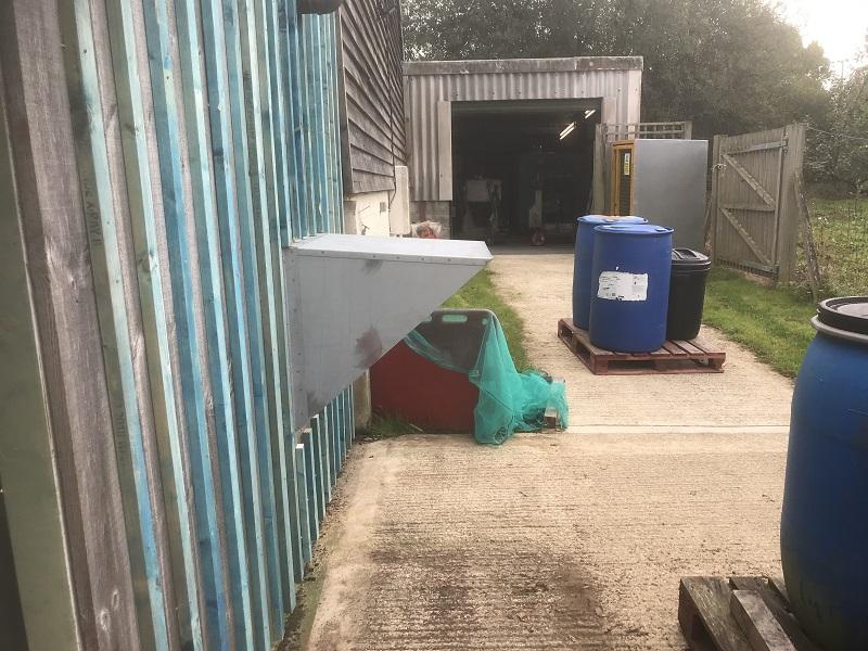

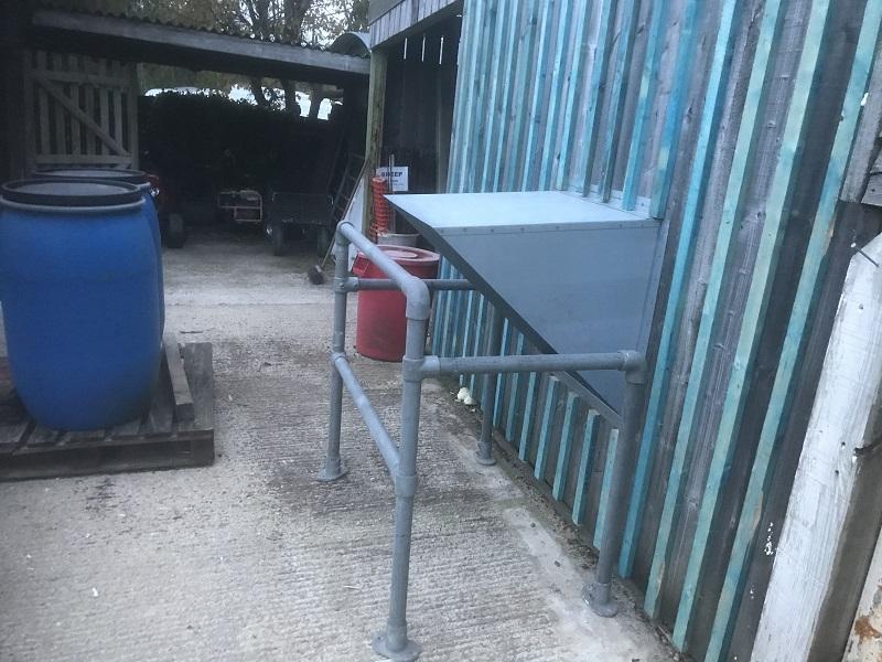

Not only was the hole in the right place but the cowl actually fitted through it, so I set too screwing the flanges in place.
 . . it was then the I discovered a major cock up  - I'd offset the flanges in the wrong direction so the 'horizontal' surfaces slope towards the wall not away from it  :bang: :bang:
Theoretically it's just a case of 'un-spot-welding'  three of the flanges and re-fixing them in the right place, but I was rather enthusiastic welding them and they are rather robust welds.
. . I'll cogitate on it for a bit, and maybe experiment undoing spot welds on some scrap - you can get a special drill to remove spot welds, but I don't have one.

My experiments removing spot welds confirmed that buying the proper drill was sensible so I have some on order.
I also in anticipation  of removing the wrongly located flanges bent up the replacements

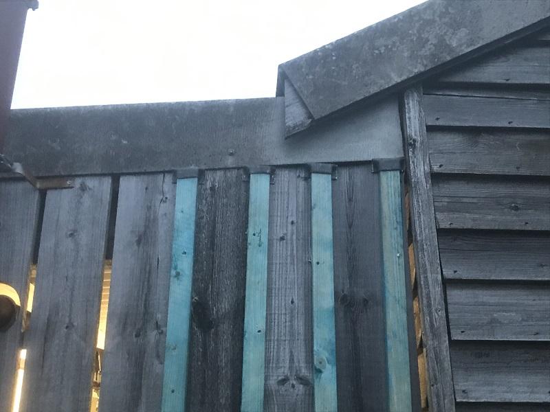

Then I started blocking up the slits in the Yorkshire boarded stable by over boarding with 25 x 50 roofing battens, and as it's not practical to get them under the barge board to keep rain out of the upper end grain I've given each of them a little lead rain cap.
Obviously I can't complete this until the cowl issue is resolved as the battens interfere with the cowl, but I've managed to do all the rest.

  • Posts: 9051
Re: Trying to Quieten the 110KVA Generator
« Reply #85 on: October 18, 2020, 07:05:21 AM »
Thanks Phil, yes that's the sort I've ordered along with a conventional stubby flat ended drill.
. . . .BUT . . .do I fancy removing 40 odd spot welds and possibly end up with a messed up main cowl body . . NO !
So I decided just to abandon the original and make another - I had the materials and it undoubtedly took less time than drilling out the spot welds. So it's (re) made and fitted and the Yorkshire boarding weather strips are finished.

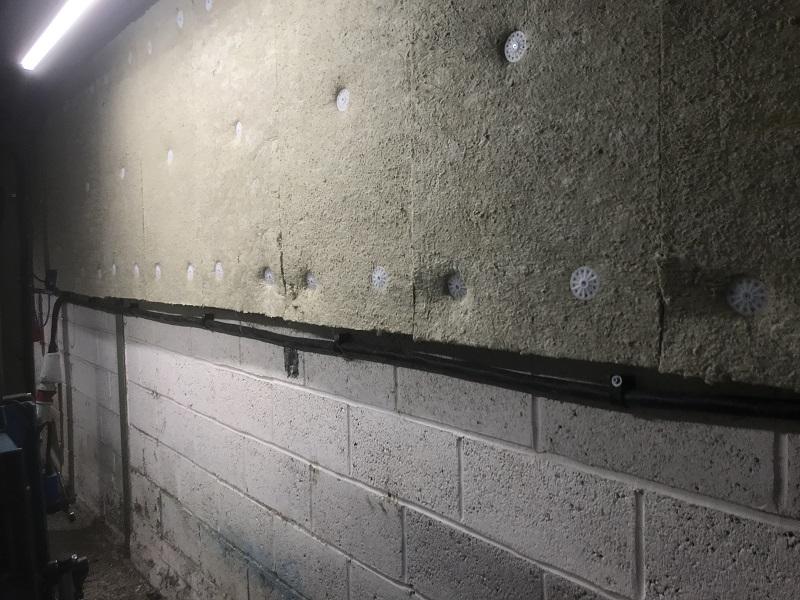

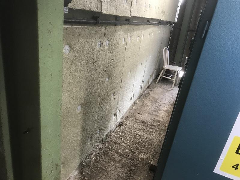

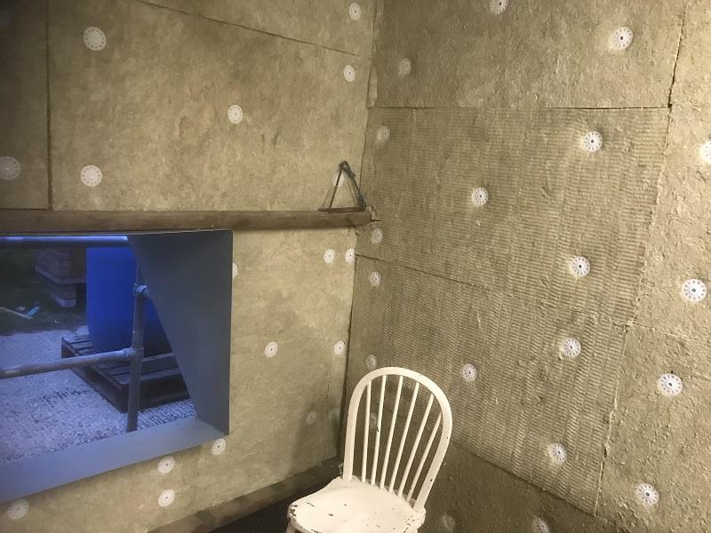

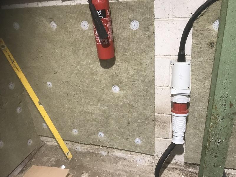

This afternoon I finished off fixing the Rockwool acoustic slabs to the lower half of the south wall.
I'd been putting this off as the substrate is rather variable cement blocks peppered with hard bits of slag and I knew that it wasn't going to be straightforward.
The fixings I'm using are miniature 'frame fixings' 5 mm diameter by 50 mm long and are intended to be inserted into a 5 mm drilled hole, and the metal screw tapped home to expand the plastic plug. I rapidly found that the screws all too easily bend when even lightly tapped and that driving them home with an electric screwdriver improved the success rate enormously !
Just the west wall round the recently installed cowl to be lined and when that's done I can start the ceiling. Six 1250 x 2400 x 5 mm galvanised weld mesh ordered from F H Brundel which should arrive in the coming week.

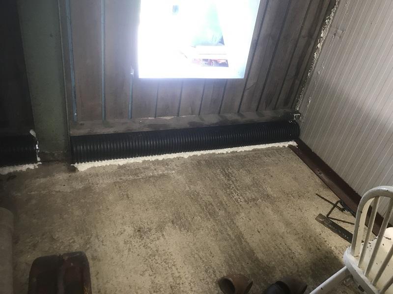

I've been cogitating on how to seal off the lower edge of the west wall. In its original incarnation as a stable the Yorkshire Boarding deliberately didn't stretch down to the concrete floor. This was to prevent rain wicking up the end grain and rotting out. The planks stop about four inches short, with the lowest horizontal beam being about seven inches from it's lower edge.
I considered a couple of courses of brickwork and a bit of damp proof course under the timber, but water will still puddle on the DPC.
Then I remembered that I had a few spare lengths of six inch 'twin wall' electric cable ducting that not only had an outer diameter of seven inches (ideal!) but was obviously made from rot proof plastic, AND the curvature would shed water from outside BACK outside. Perfect  :thumbup:
Cutting a suitable length this morning it proved to fit very nicely. Just in case it wants to pop out I've run some expanding foam along the inner / lower edge to keep it in place. This can be trimmed later today when it's 'gone off'
Unconventional I suppose but I think that it will be effective.

Later this morning, in a nod to Health and Safety, I built a safety barrier round the projecting cowl to stop people bumping into it. (Pete. you will recognise the bits !!!)
Then after lunch I was able to finish the bits of the South and North walls abutting the West wall that previously I'd had to leave, and then finally finished fixing acoustic slabs to the West Wall.
So that's all vertical surfaces covered in 25 mm Rockwool Acoustic Slab - just the ceiling to do which is going to require a bit of ingenuity, but that will have to wait until the 50 x 50 mm mesh arrives so time to think about it.
(That's 58 slabs fitted or 41.76 square metres, the ceiling is a further theoretical 23.4 square metres or another 32 slabs which is lucky as I have 38 left!)

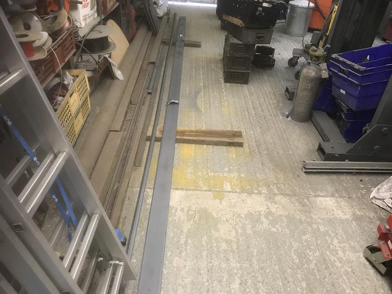

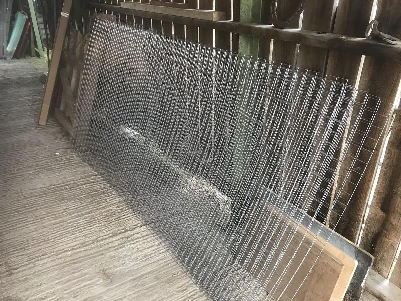

True to their promise, Brundles have just delivered a bankrupting load of steel to me  :bugeye:
The six 50 x 50 x 2400 x 1220 galvanised mesh panels to hold the ceiling acoustic material up, but also . .
Three off 6 mm x 100 mm x 6 metre mild steel bars and . .
Two off 25 mm x 25 mm x 3 mm x 6 metres angles
. . .to make Copes and Drags for the Foundry - but more of that later in an another thread probably.
Meanwhile I feel singularly disinclined to start fixing the mesh, and anyway first I need to reduce the three light fittings to dangling cables in order to get the mesh up (lights will fix up under the mesh)

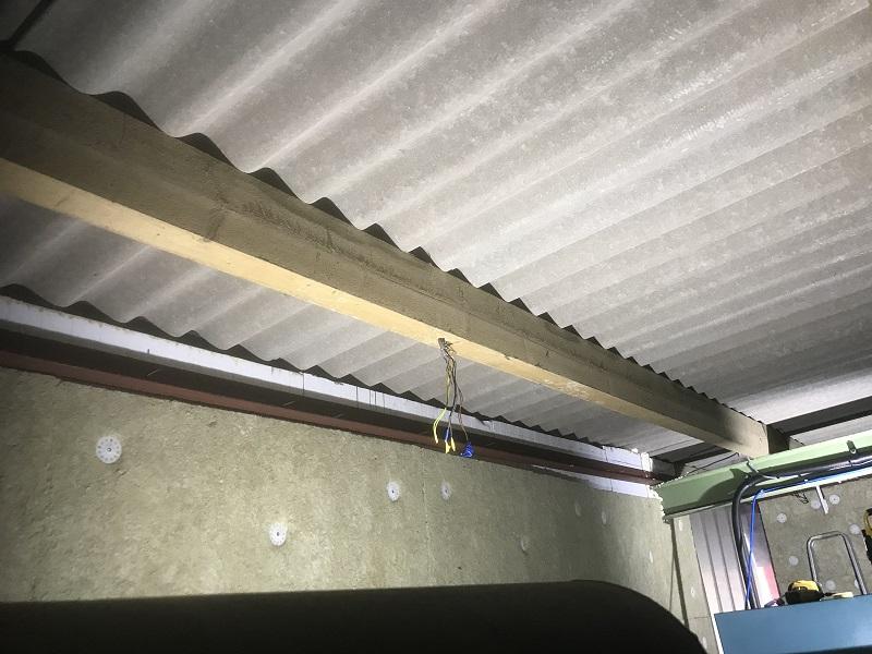

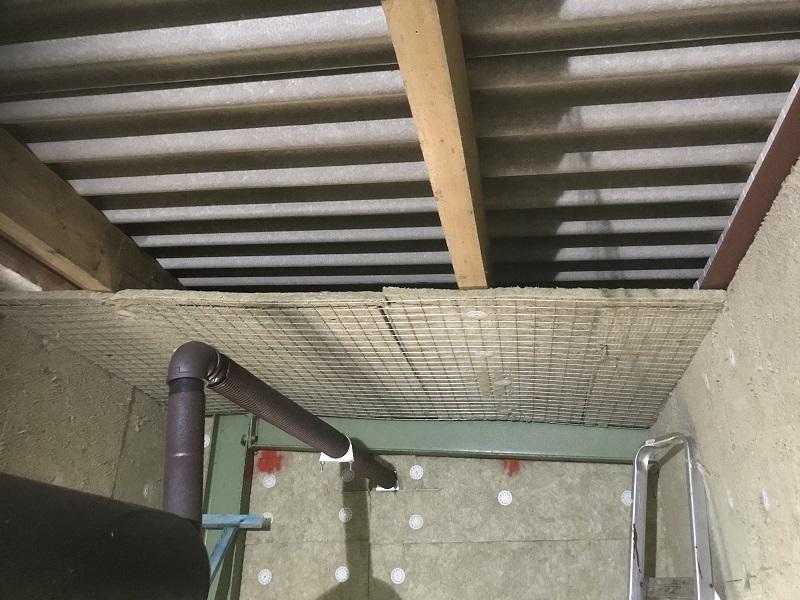

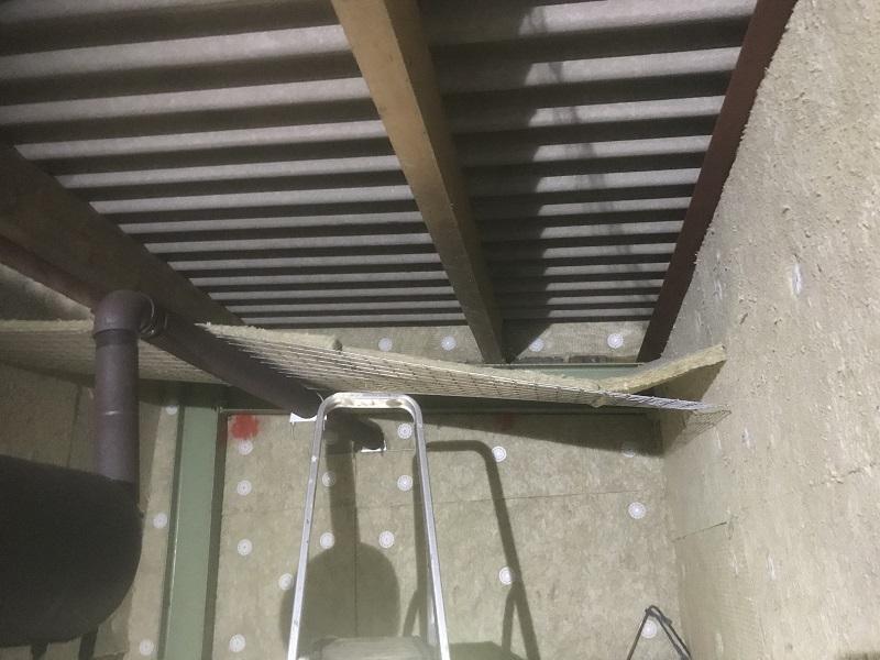

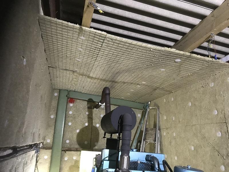

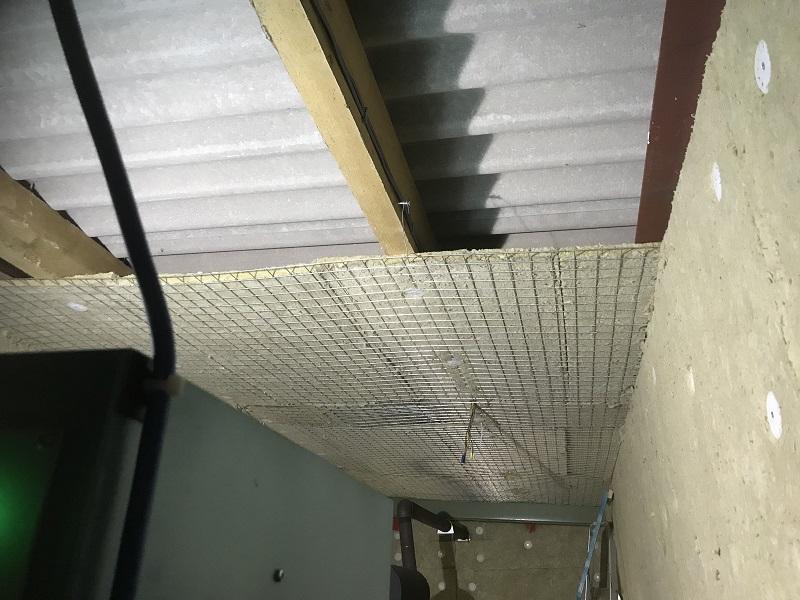

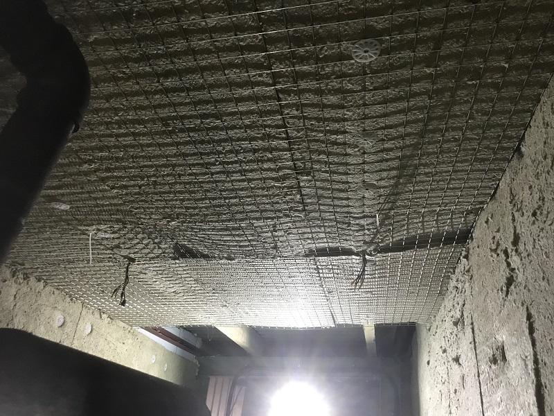

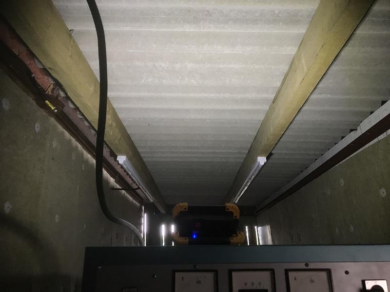

As soon as I could escape from other duties this morning I isolated the lighting supply to the generator room and took down the two LED strip lights and one LED flood light. Leaving the cables dangling (but taped off) I will have to work the mesh sheets round them.
To start the first mesh I put screws into the side of the two joists near the west wall, and fixed short lengths of fencing wire to them to initially suspend the mesh (trimmed to width) at an angle so that I could then 'load' it with Rockwool, pivot it into place and screw it up. To help this process I made a suitable temporary prop.
Needless to say it wasn't quite as simple as that - but  I got a tolerable result fixing the first too meshes. The mesh size is about 50 mm longer than the Rockwool length so 1200 mm x 50 mm bits have to be packed on the exposed edge as I work from West to East.
The next mesh will incorporate the lighting cables, and I'm tempted to cut it lengthwise where the cable emerges and put it up as two bits.
« Last Edit: October 21, 2020, 10:09:07 AM by awemawson »

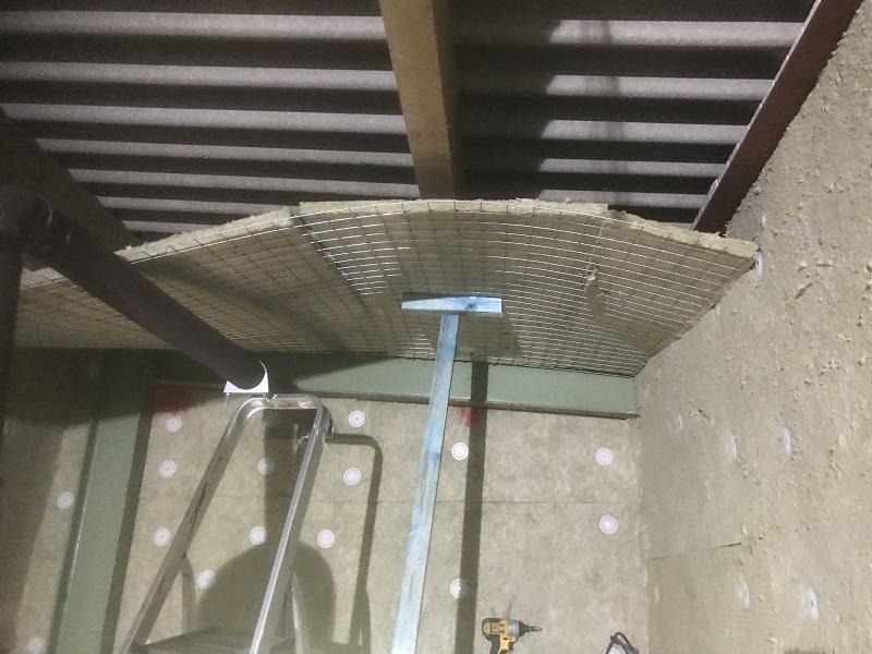

This afternoon when I was released from Puppy sentry duty I managed to get a further one and a half more meshes up.
As I thought that I might have to, I ran a partial sheet up to the lighting cables and a full sheet beyond which worked out quite well, though obviously the room must taper a bit as the sheets are getting too long - next one wil need to be shorter by one mesh I think to avoid scaring the walls too much as it's moved into place.

IIRC, the building regs for noise control recommend / require a gap between rockwool and the next panel for most effective noise reduction. So the gap between the panels and the roof certainly wouldn't be a bad thing on that basis, assuming they are correct.
Looking forward to the acid test ie dBA measurement of the final system! I suppose you might argue the acid test is avoiding a bad review on Tripadvisor or whatever.
