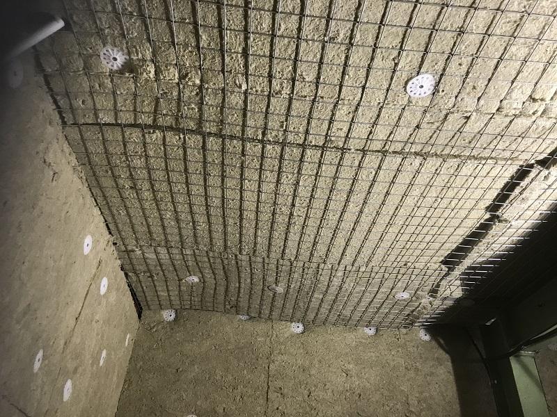

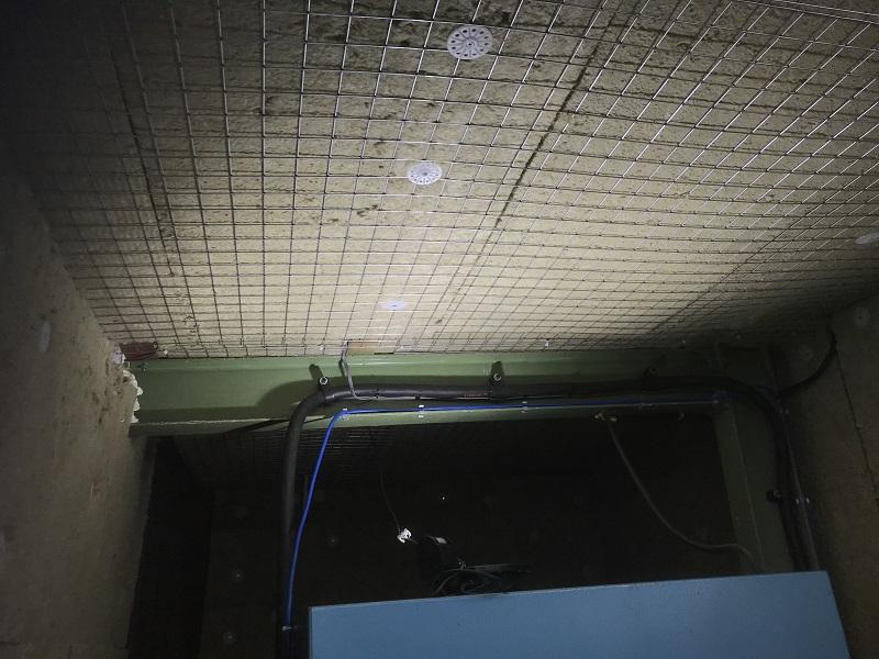

Today I got the last of the Rockwool sound insulation installed. The last panel was a bit of a pain as it needed a 50 mm 'extra' bit fitting that for the life of me I couldn't get to stay put as I fixed the mesh. Cosmetically not ideal but probably has zero effect on the sound deadening!
So what's the results?
Well when I began I was measuring 107 dBa adjacent to the generator, and 71 dBa by the cottages courtyard (this last figure seems to have been recorded optimistically low by me on earlier posts)
Now I am measuring on brief tests today 95 dBa inside the generator room, and 59/60 dBa by the cottages courtyard.
The 12 dBa reduction in the generator room is obviously very significant but I'm surprised the the remote reading isn't less, though it IS the same 11/12 dBa reduction.
. . . still got the canvas 'radiator exhaust tunnel' to go !
Apart from the canvas, re-installing a spot light fitting, and a major hoovering up that's about it for the generator room.

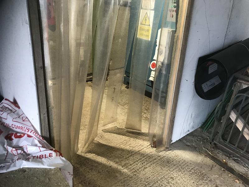

Russ I’ve been considering some sort of spray to make it less friable but paint would be inflammable so my thought at the moment are along the lines of a solution of sodium silicate.
I’m sure that the generator note will change with load, in fact I know it does, but the actual noise level subjectivity seems the same.
The biggest escape point is probably the door where I have those pvc strips, but I can’t block it as loads of air is needed for cooling and combustion.

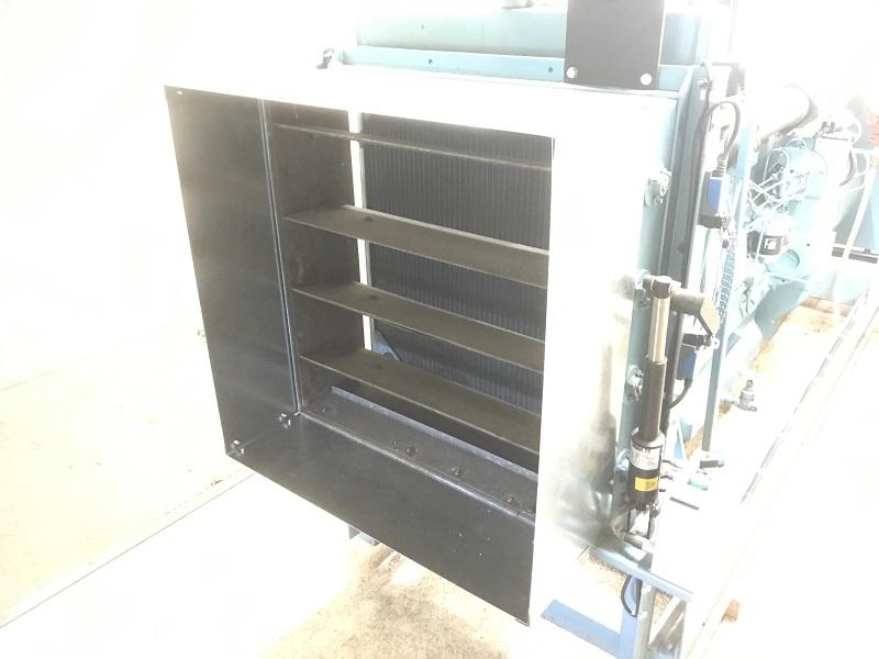

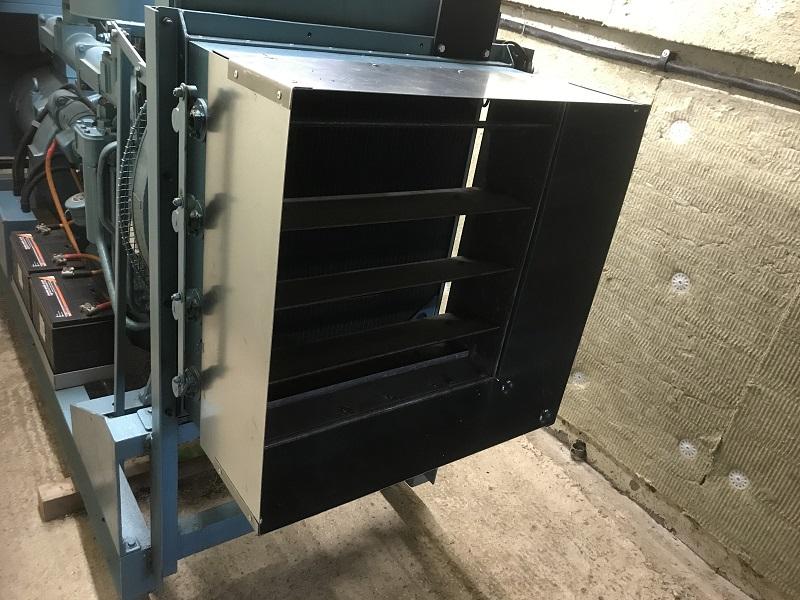

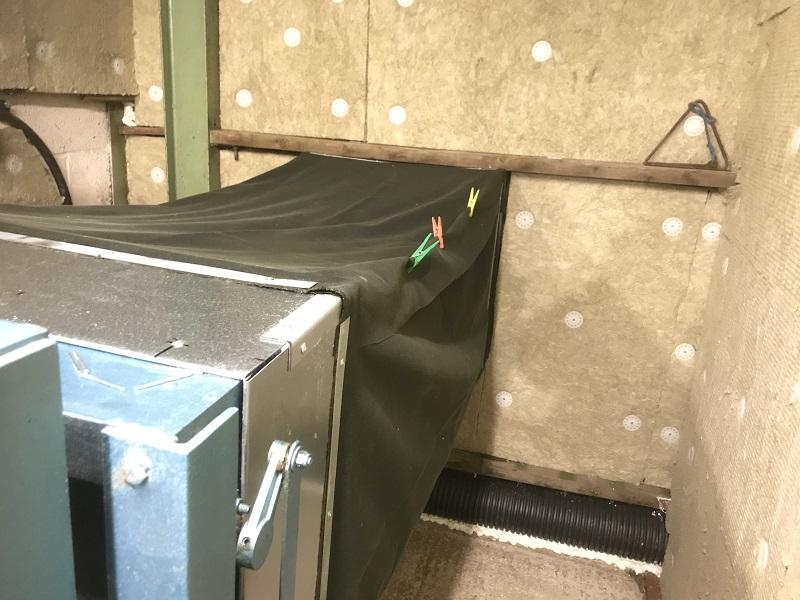

Today I extended the radiator surround forwards towards the west wall by about eight inches.
This will allow me to use a single width of the canvas as a wrap and give sufficient overlap for fixing, otherwise I'd have had to join two strips of canvas which would have been a bind.
Need to make and fix a grill to keep insects out, then the canvas can go on.

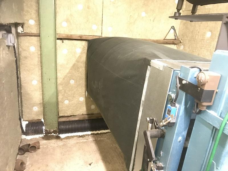

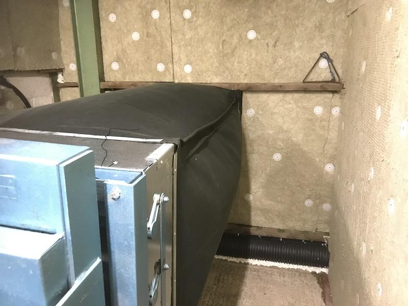

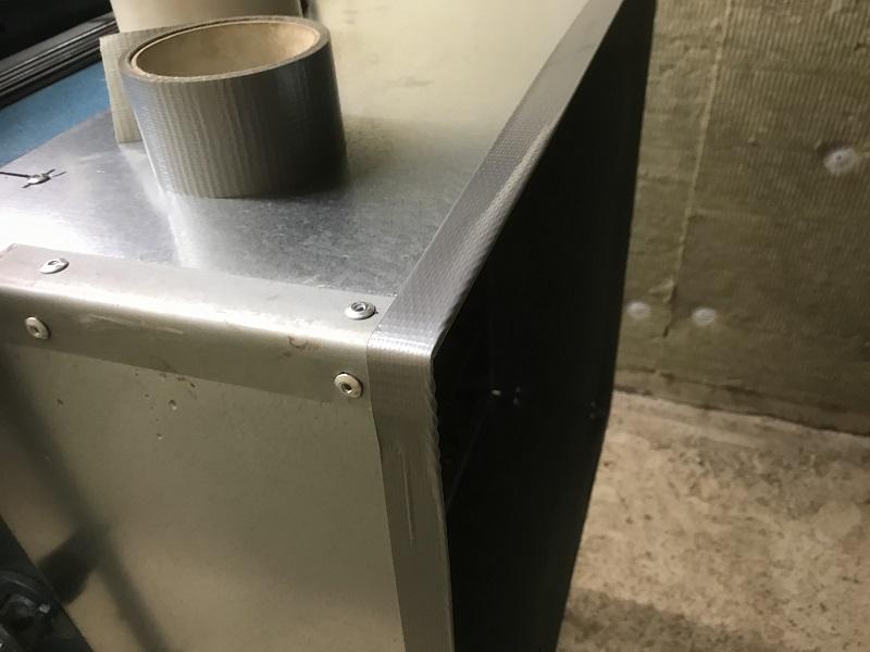

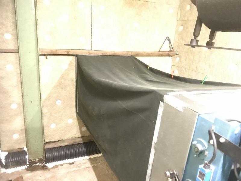

With the help of  a friend I managed to get the canvas wrapped round the wall flange and  radiator extension, and fixed with 25 mm strips of Zintec pop riveted through the canvas. Prior to wrapping I put gaffer tape over the raw edges of the wall cowl and radiator extension to hopefully prevent the canvas chaffing.
Needless to say it was not ever so easy, but rare earth magnets came to the rescue holding the canvas while I fixed the strips on. I'd intended to use double sided carpet tape to hold  it temporarily in place, but as the canvas is waxed it didn't stick!
Once it was in place and the seam crimped together with clothes pegs I was able to tack stitch the seam with rather crude tacks and the pegs could be removed.
Starting the generator it was immediately apparent that the airflow was now completely different. Before the radiator air was re-circulating but now the hot air is expelled and fresh drawn in through the PVC door strips, which now billow inwards. I feared that the door being partly open would increase the external noise but I'm still measuring 60 dBa at the cottage courtyard.
It's amusing to see how the 'tunnel' inflates as the generator is running.
. . . just the outer grill to make and fit, but it's pouring down so it will have to wait.

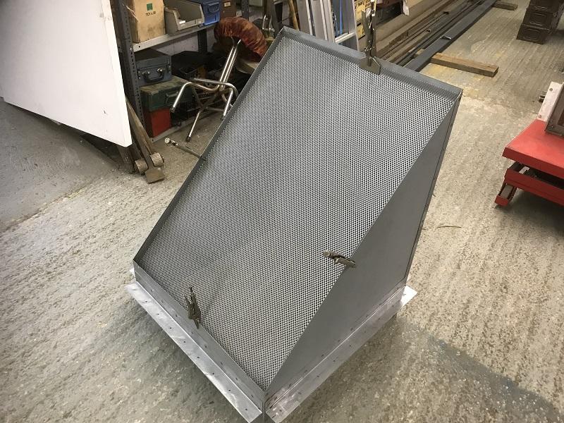

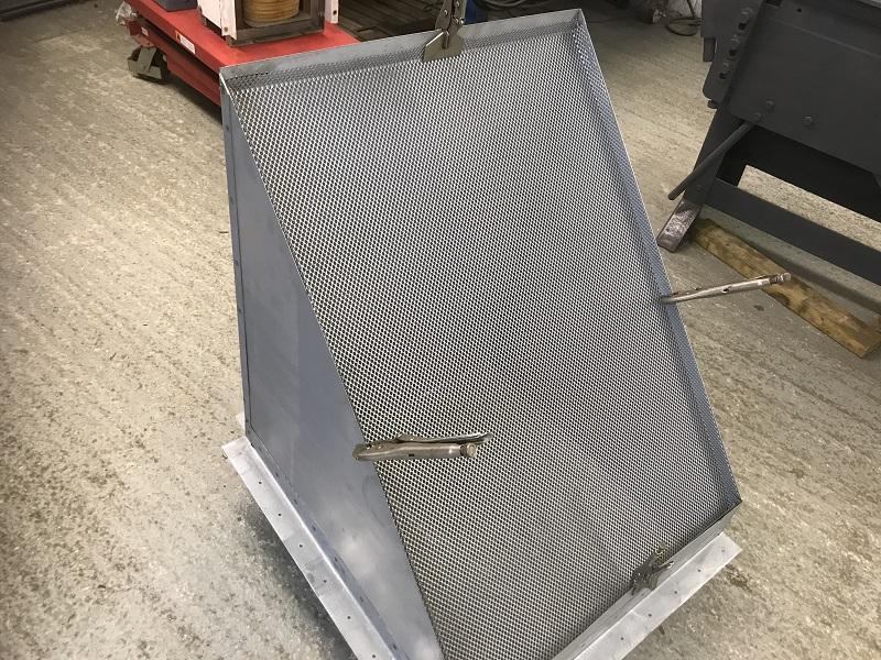

Rain barely stopped all afternoon, but as I have the original cowl, where I cocked up the flange, I was able to use it to model the vermin mesh.
Mesh cut and bent and ready to fit when weather permits!
It is slightly finer than I would have chosen as no doubt it will give a bit of air resistance, but I had it in stock so have used it. Can always re-make it  later in a coarser mesh if it gives problems, but I think that the engine is adequately cooled and anyway will only be used for short(ish) runs.

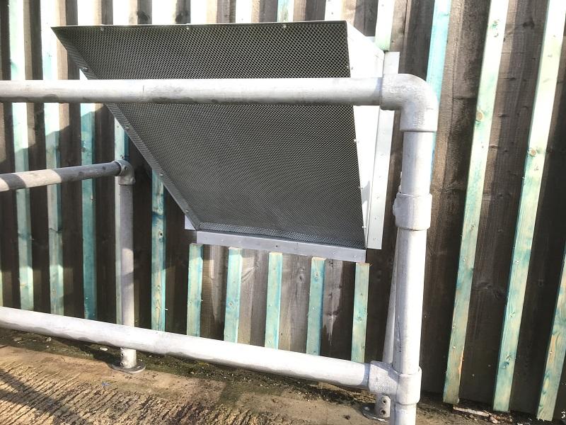

A slight respite from the rain this morning, I even spotted the sun at one time - so I sprang into action and fitted the 'rodent mesh' into the radiator exhaust flange. Just a drilling and bolting affair - nothing too complicated.
Air flow doesn't seem to be unduly affected - no doubt the over pressure in the canvas tunnel will be greater, however having a 45 degree cut off on the cowl has increased the discharge area by about 40% so the impedance of the mesh perhaps isn't anything to worry about!
