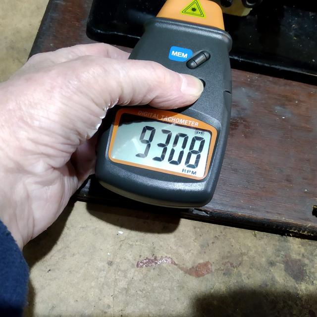

Grabbing my laser tacho, I decided to see just what were the peak revs?  :scratch:
It peaked at 5,000rpm!!  :bugeye:  .. Before going, "PUP":zap: again.
That's just a bit too enthusiastic, for my liking.......  :palm:

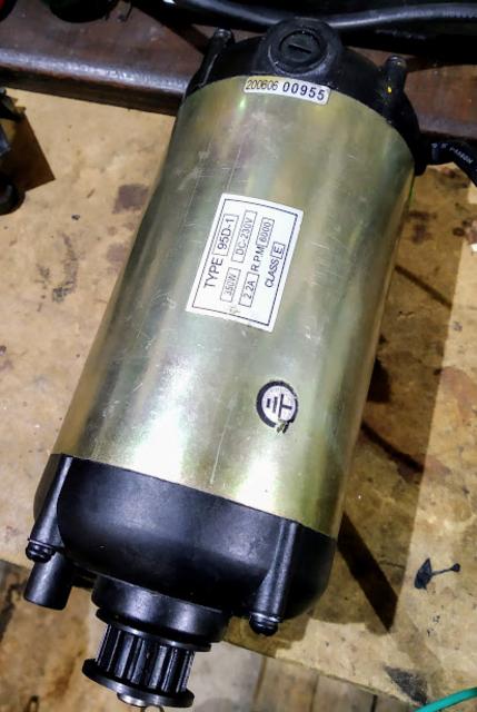

Time to check the motor. Should give 6,000rpm. According to the label.....
Reflector tape, on the pulley......
By ek! We must have the GT model.......

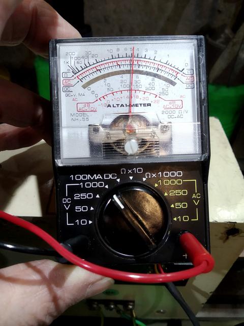

John suggested checking the voltage supplied to the motor. As, this determines the motor speed.
The result wasn't helped by my 35yr old meter reading x 2(+).
500+ volts! I don't think so.......
New meter on order. Further fumblings, in a few days time.
Any comments/ helpful advice gratefully accepted......  :thumbup:
Re: David's Mini Lathe......
« Reply #31 on: November 29, 2019, 04:52:37 PM »
The new multi meter arrived, early this afternoon.
After a bit of familiarisation,  :zap:  I checked the full revs voltage to the motor.
That's, ok......
John suggested, I check the speed pot, R3.
As the other two, are sealed, with gloop. I guess, someone has twiddled with R3......
I set the lathe running, sensible revs. Rotated R3 anticlock. The revs reduced!  :ddb:
1/4 turn at a time, on R3, while increasing the speed knob setting.
After almost 2 turns, we hit a "stop". Flat out at.......
Guess the "stop/ resistance" was the original position of the pot. I'll leave it alone from now on. Probably.  :thumbup:
Sincerest thanks to Mr. Rudd, for his help and guidance, through fings wot most of us don't understand.  :mmr:
