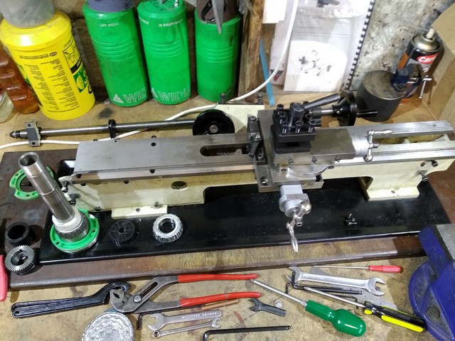

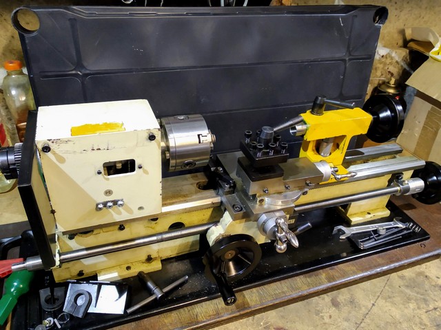

The lathe is mine now. It arrived, as a  lego set, in several boxes. In serious need of rebuilding.
I started during the summer......
I finished the mechanical work, this weekend.......

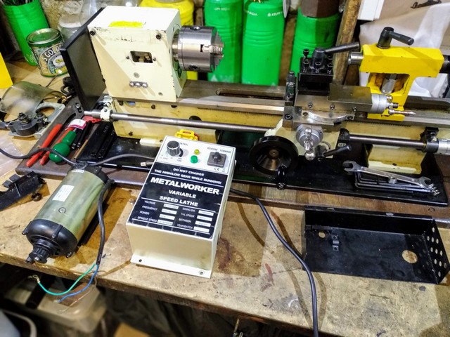

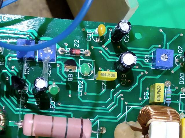

Next up. The electricals. Never before, fumbled with Sieg's, mysterious clever stuff.....

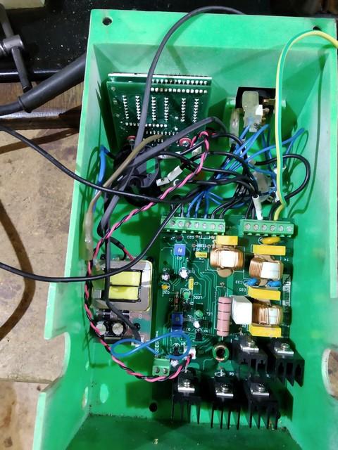

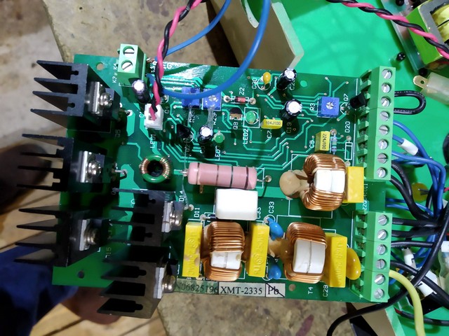

Inside the box.......

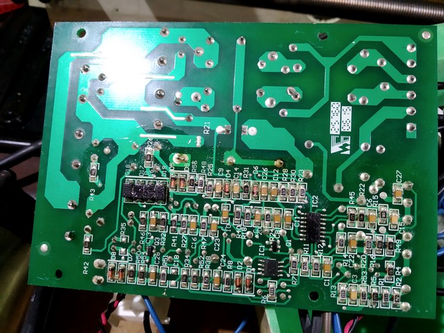

And, back view of the loose board......
I plugged together, what seemed to fit together.
Not sure which way around the input lead fitted, as both outputs from the emg switch, were black/blue wires.
Switched on. Hoping for a click. Or, a little light...... Nothing!  :scratch:

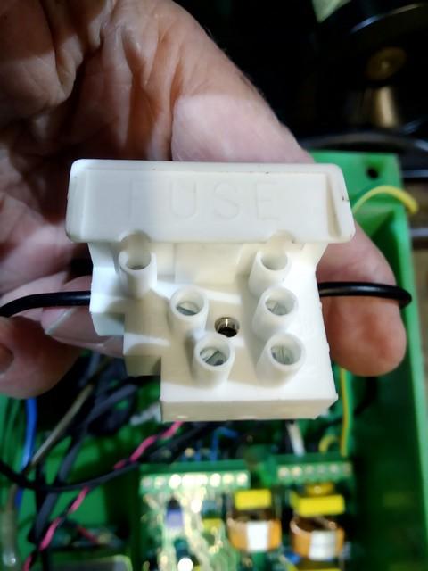

HAH! No fuse, in the plug.  :thumbup:
Fitted 3amp fuse. Switched on..... Nothing!  :scratch:
Metered the supply, into this gubbins. But, not out of it......
No fuse in there, either......  :thumbup:
Fitted another 3amp fuse. Switched on..... Nothing!  :scratch:
Checked the fuses. Both of them had blown. Quietly....  :(
That is the limit of my electrical understanding. It's time now, to hand over to a higher authority.
Hope you guys can sort me out, as you have done several times in the past......

First up, have you got a dvm, know how to use it?
Can you follow a schematic drawing?
Is there an XMT number on the speed control board? ( I think it might be XMT 2335 or summat...)

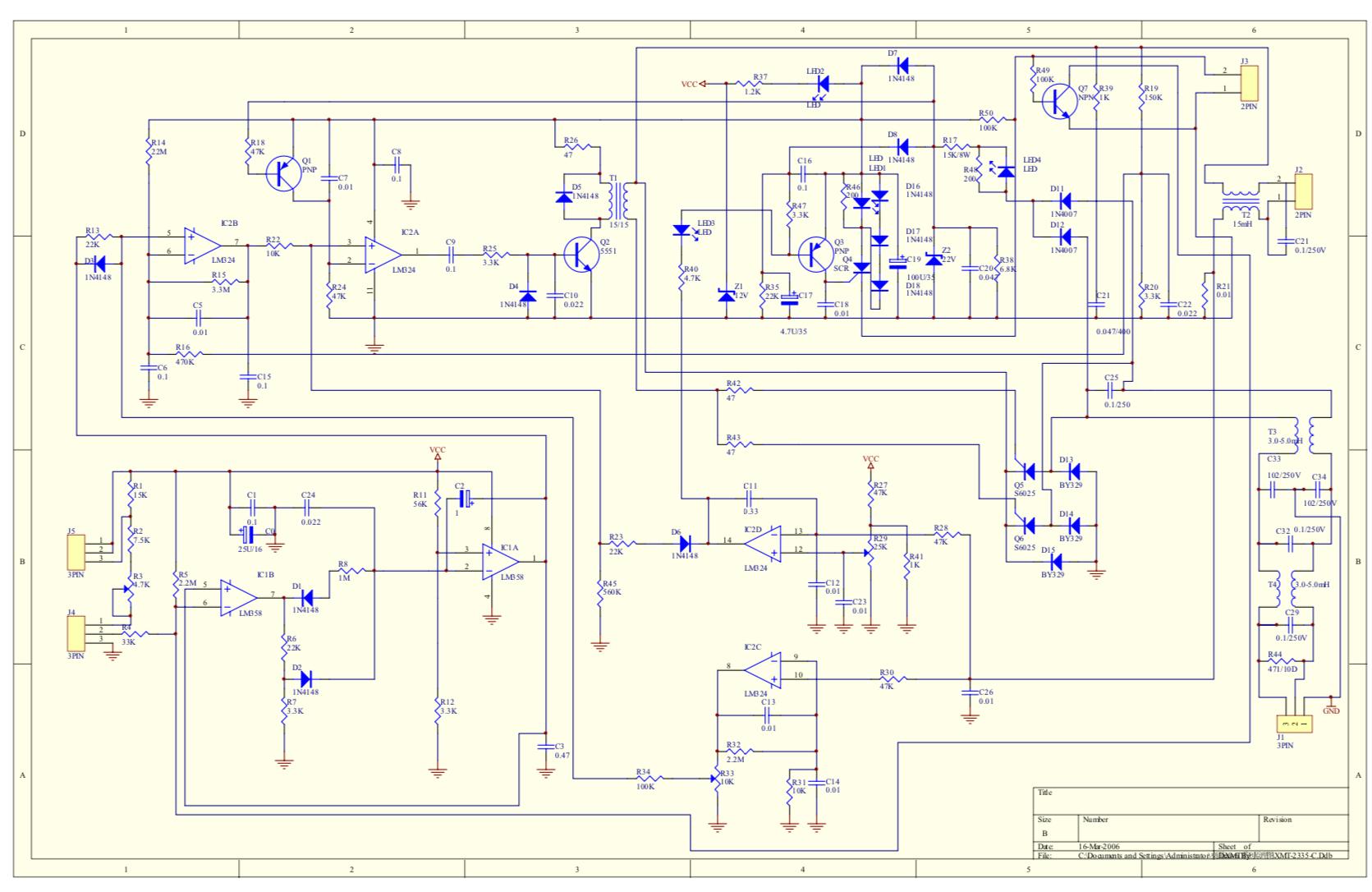

 This one will be no problem. Mebbe...   http://littlemachineshop.com/reference/drawings/4507-XMT-C3Lathe.pdf
XMT-2335........
Are we off to a good start?  :thumbup:

I found this, but I guess it’s probably out of date being from 2006.  It is however a starting point.

I'm assuming you have all the wiring in the right place...,,?
****With the lathe unplugged from the mains***
With new fuses fitted where needed, meter switched to Ohms range, can you measure between the Live and Neutral pins on the 13Amp plug, do this with the Red E-stop button not latched....
What reading do you get on the meter?
We are looking for a low value that is causing the 3A fuse to blow......
If the result is good, that is there is no short across the supply, I suggest disconnecting the motor and in its place a 100 watt light bulb, then try the machine plugged in..
Joules, good find on the schematic...the circuitry hasnt changed much over the years, they are basically the same as the KB boards from the USA..

No worries David, the schematic is here for you and others.   Perhaps over time we can build up a table of test points and voltages for others to fault find from, as it seems a common problem sorting these boards out.
Is this low enough, John?  :palm:
  • Posts: 2552
Re: David's Mini Lathe......
« Reply #13 on: October 11, 2019, 12:09:19 PM »
David, that is a low reading, likely to cause a fuse to blow....
I see there's a little power supply in one of the previous fotos, can you disconnect the power feed to it and measure again?
If the reading is still low, can you disconnect the mains wires going to the speed board and try again...?

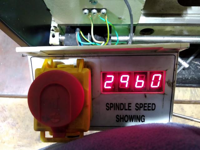

« Reply #14 on: October 11, 2019, 02:57:43 PM »
John.
 The speed control knob doesn't click, off. In the stop position.
Thinking this might be at fault, I disconnected all three wires. No difference.
 The feed wire to the transformer, is already, not connected to anything. In the pic, it lays over the top of the control box.
I have also pulled out the plug, where the wire to readout connects.
No difference......  :bang:

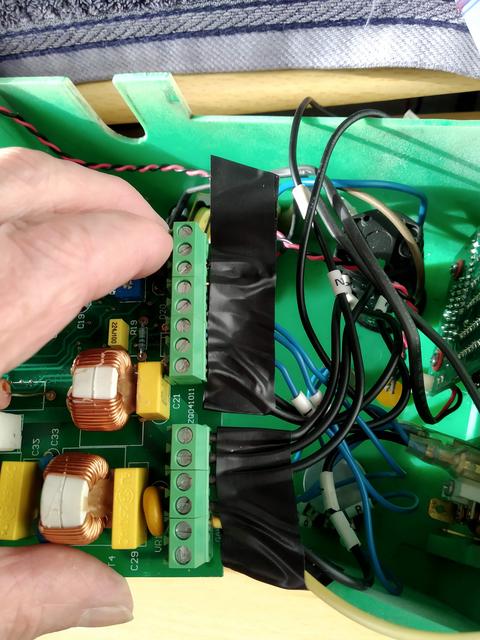

The two wires connected to the speed control board at the Line In terminals, can you disconnect them from the board, then:
1) measure the resistance across the L and N pins of the mains plug ( do this with E stop in its normal state) ( this will determine if there is a fault in the incoming wiring stuff)
2) measure the resistance across the two Line In terminals on the speed control board...
« Reply #16 on: October 11, 2019, 04:37:02 PM »
John.
 Wires disconnected. Meter across plug pins... No reaction.
Meter across, the two terminals. Needle fully over, reading zero.
  • Posts: 2552
« Reply #17 on: October 11, 2019, 05:16:40 PM »
David looks like theres an issue with the board then...
Would you like me to look at it and effect a repair?   :zap:
( I just checked, a new board is £132... From Arc..Ouch, didnt think they were that much...)
« Reply #18 on: October 11, 2019, 06:05:34 PM »
Please John. I certainly would!
It's a pity, I can't fit one of the spares, you repaired last year.....
No rush. I'll detach, and box it up, over the weekend.
Thanks for your input. I've enjoyed this little fault finding exercise.....

The board is now on it's journey North, to John's.  :thumbup:
I was imagining the chaos, all those loose wires could cause. (Despite having a diagram).  :zap:
I thought it best to tape em to each other, before removing the board......

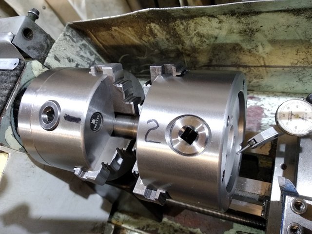

« Reply #22 on: October 15, 2019, 04:43:05 PM »

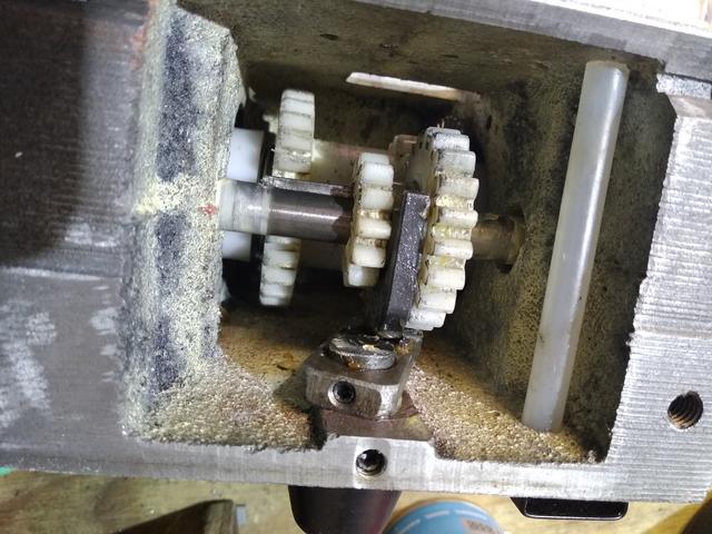

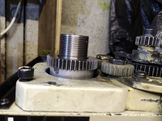

Several times, over the years. David called here, with lumps of his lathe for modification.
The first project was to replace the orrible saddle strips, with solid ones. Seems they have stood the test of time. No work needed on that area. Still sliding sweetly...  :thumbup:
A couple of years ago, he installed taper roller bearings. Calling here, for the gear spacer mods.
Faced the front one to correct alignment. Then made a 2mm thick, spring "wave washer", from a couple of turns of stainless welding wire.
Just visible, to the left of the Lo gear.......
When it arrived here, I realised, it still wasn't right.
I faced 3mm off this face, to allow for the wider bearings.......
The tumbler gears, are now aligned correctly......

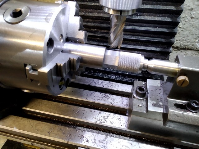

« Reply #23 on: October 16, 2019, 04:13:04 PM »

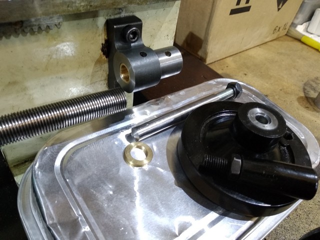

Next up, was the leadscrew handwheel.
Using a left hand, leadscrew plummer block, bushed to 10mm bore. On the r/h end.
Lopped the end off the leadscrew, and inserted a length of 10mm silver steel.....
Left hand dial, is held onto plummer block, with grub screw.
Right hand dial is fixed to handwheel. 10 thou' between graduations.......

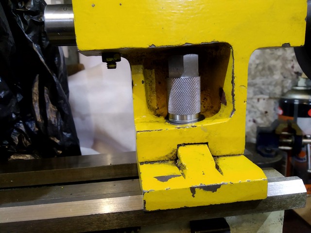

Next job, tailstocks. Got three of em. The blue one is mine. It's quill thread is rather tired.
Mixing and matching. Hoping to finish with two good uns.
Anyone contemplating a camlock?
 This one is useless. Won't clamp securely to the bed. Slides under quite light pressure......
Making a clamp nut.......
Think that looks at home, under there.......
Can be accessed, over the top of the compound slide.......

The magic box, of coloured magic parts, came back from John's.
It works very well. The wheels go round, just like they used to do.....  :thumbup:
I was surprised to see, the original lathe is rated at 3,000rpm.
This set up peaks at 3,600. And, the bearings don't like it. They gibe, and the motor cuts out.  :scratch:
I guess, we now need to lower the overall gearing......
  • Posts: 2552
« Reply #28 on: November 25, 2019, 03:43:38 PM »
What bearings are you running? Tapers? Is the preload set ok, not too tight?
« Reply #29 on: November 25, 2019, 04:22:55 PM »
Yes, tapers. Not set for any machining, yet.
 Just gently nipped, until there is no discernable movement, felt by hand.
The proper set up, is to come after a bit of running in.
« Reply #30 on: November 27, 2019, 04:53:10 PM »
Managed some workshop time, yesterday.
While I was busy, I set the lathe running in Lo gear, 700 rpm.
 Tweaked the bearings, after 10mins, and upped the revs.
Eventually reaching peak revs in Lo, 2,180. (Seems rather high to me)......  :scratch:
All seemed ok, so I changed to Hi gear.
Ran for a while, eventually reaching 3,000rpm. The supposed peak revs.
 Wound it up, a bit. Reached 3,600. The digital reading stayed there, but the revs continued to obey the speed control.
The bearings seemed happy. Not getting warm at all. So, I tweaked the speed control a bit more...
 The revs climbed higher! Until the motor cut out, with a, "PUP".  :zap:
Apparently, no harm done! (Except to my nerves). It re-started, as usual.  :thumbup:
Grabbing my laser tacho, I decided to see just what were the peak revs?  :scratch:
It peaked at 5,000rpm!!  :bugeye:  .. Before going, "PUP":zap: again.
That's just a bit too enthusiastic, for my liking.......  :palm:
Time to check the motor. Should give 6,000rpm. According to the label.....
Reflector tape, on the pulley......
By ek! We must have the GT model.......
John suggested checking the voltage supplied to the motor. As, this determines the motor speed.
The result wasn't helped by my 35yr old meter reading x 2(+).
500+ volts! I don't think so.......
New meter on order. Further fumblings, in a few days time.
Any comments/ helpful advice gratefully accepted......  :thumbup:
« Reply #31 on: November 29, 2019, 04:52:37 PM »
The new multi meter arrived, early this afternoon.
After a bit of familiarisation,  :zap:  I checked the full revs voltage to the motor.
That's, ok......
John suggested, I check the speed pot, R3.
As the other two, are sealed, with gloop. I guess, someone has twiddled with R3......
I set the lathe running, sensible revs. Rotated R3 anticlock. The revs reduced!  :ddb:
1/4 turn at a time, on R3, while increasing the speed knob setting.
After almost 2 turns, we hit a "stop". Flat out at.......
Guess the "stop/ resistance" was the original position of the pot. I'll leave it alone from now on. Probably.  :thumbup:
Sincerest thanks to Mr. Rudd, for his help and guidance, through fings wot most of us don't understand.  :mmr:
Hi John,
Sorry to hijack this thread but I'm hoping you can help me.
I have a Sieg X2 Mini-Mill with an FC350BJ/230V motor controller board that has bitten the dust  :zap: (motor speed goes berserk on full throttle - somewhere around twice its rated speed of 6,000 RPM).
The motor is 350Watt 230V, same specs as the lathe I believe.
The original board is no longer available and it seems that the replacement is the XMT-2335.
The XMT-2335 has more terminals than the old board and I haven't been able to see how they are labelled from any pics of it, and I don't have a circuit diagram for the mill either, so I'm wondering how to wire it up, I looked very carefully at the pics that were posted of David's lathe controller but couldn't see how it was wired - you mentioned a small transformer in one of your posts but I think that is a power supply for the lathe speed display.
The terminals on the FC350BJ are:
1 and 2 - DC for Motor,
3 and 4 - AC for 230V Mains input,
5 Not sure what it's for (goes to one of the switches on the panel I think, the board is on my desk right now), and
6 and 7 jumpered together.
And then there are P1, P2 and P3 for the control pot.
 :bow: I'd be very grateful if you would let me know what you can about it, you know a lot more about these infernal devices than I do.
Many thanks from an Expat-Pom living in Australia.
Cheers,
Davo.

I'll dig out the schematic for the XM board, I think the best thing to do is take this off line...my email address should be in my profile or you could pm yours to me....
If the motor is going flat out then chances are the fets are shorted....board can be repaired but I doubt you'll find any one down under...you could send it to me here in the uk....

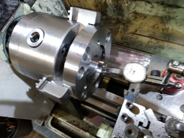

Back in February, a new 4" chuck and adaptor, arrived......

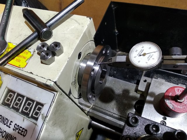

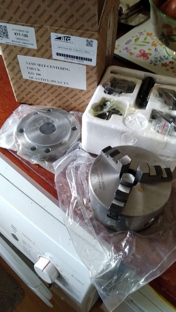

I made three balance plugs for the redundant holes in the adaptor plate. Then realised, only one was needed!  :doh:
I like to fit 40mm x m6 grubscrews, shortened as necessary, as chuck studs....
Everything fitted together well. But the workpiece insisted on 5thou'+ eccentricity!
 Started to check every locating point.....
All's well here, too......
That's disappointing! The chuck is 5-6 thou eccentric, on all three (six) jaws......  :(
Relieved the locating recess, by a few thou per side.
 It's easy enough, while changing chucks, to set true to a mandrel. Before finally nipping the chuck nuts.....
Thanks for looking in!  :thumbup:
