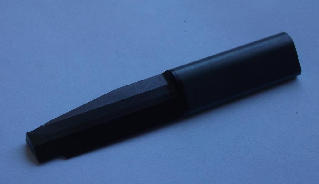

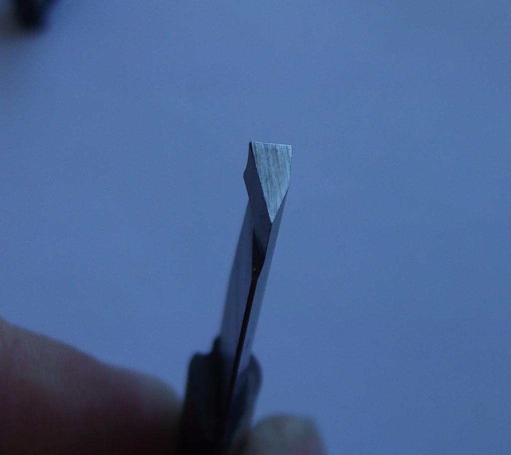

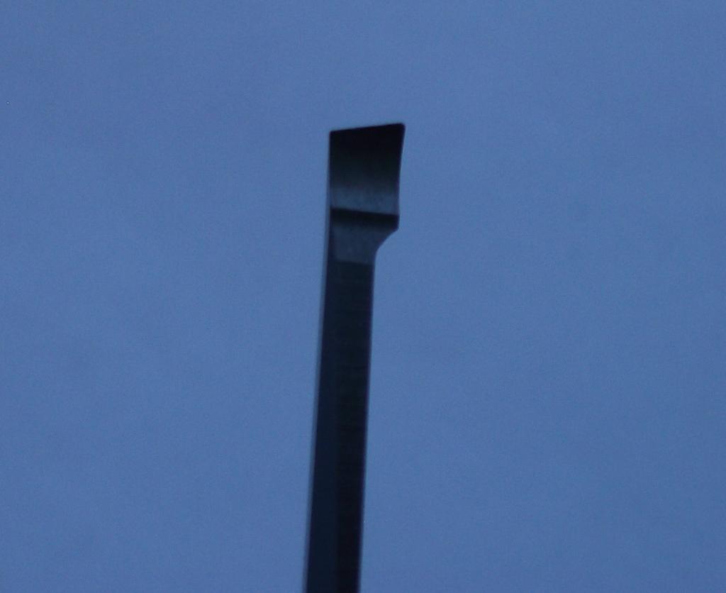

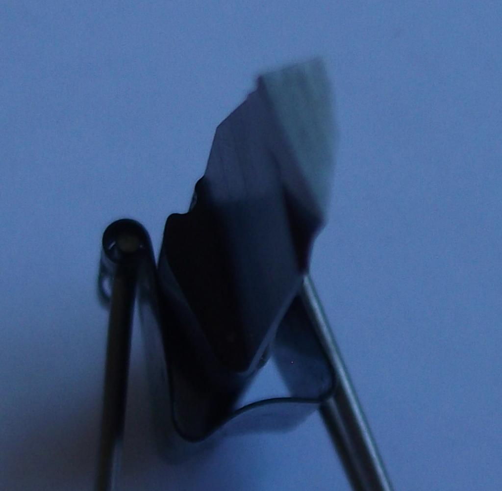

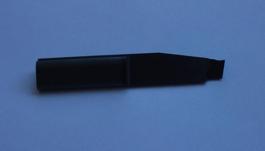

« Reply #2 on: May 31, 2020, 04:33:25 AM »
Here's a few pictures of a carbide trepanning insert , they may help with the cutting geometry.

Bill, does that tool have a tendency to dive towards the centre of the hole ?  Quite aggressive rakes on the tip, something I should really have a play with, what are the tip dimensions hard to judge scale from the pictures.
It's about 3mm groove and about 30mm deep , total length about 65.
Can't say I've noticed it dive in any particular direction ,it is solid carbide.

« Reply #7 on: May 31, 2020, 08:07:02 AM »
Cheers Bill, I thought just the tip was carbide.  Nice link Matthew, he was just down the road (a bit) from us, wish I could have seen his place before he wound it up, real shame.

« Reply #8 on: June 01, 2020, 09:06:10 AM »
The fancy trepanning tools are run well below centerline, if I remember correctly, and the whole insert is slanted down a lot.  Very funny looking.  I didnt see any dig in issues, even on delrin.
