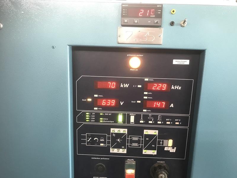

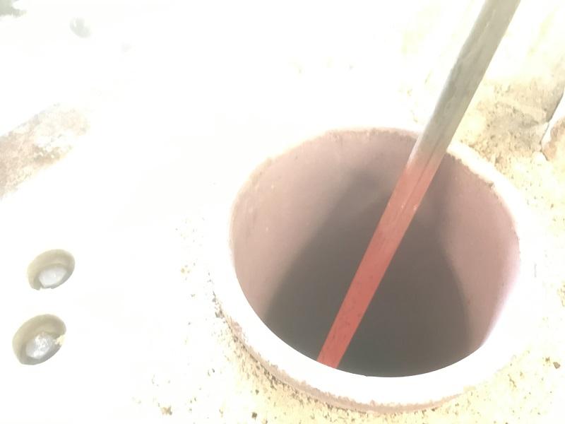

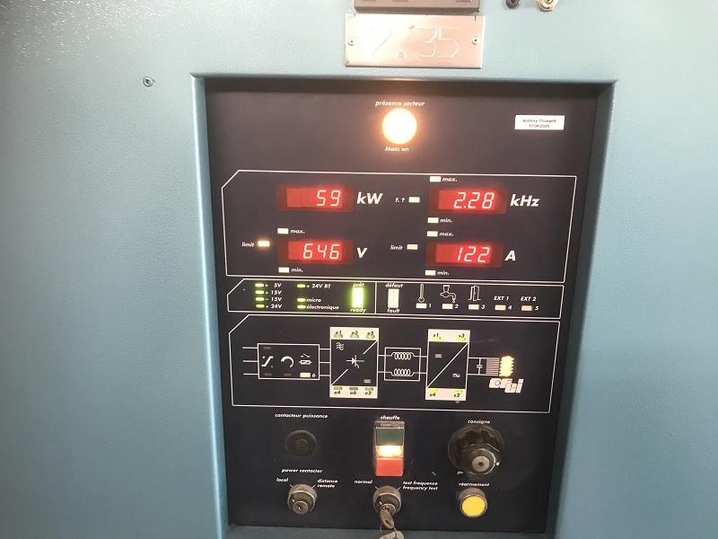

The 11:00 deadline came and went so I fired up the 110 kva generator and did a simple 'bar heating' exercise to put a bit of load on the connections and wiring - all seems well  :thumbup:
The same bit of 16 mm mild steel bar that I'd used before was raised quickly to glowing point - a matter of a couple of minutes or there abouts.
There must be some sort of power limiting algorithm running on the furnace microprocessor - it 'topped out' at  59 kW this time - I suspect that it is based on the charge in the crucible. I must experiment when I have the place to myself with greater and lesser charges and see when the yellow 'limit' light comes on as I turn up the power.

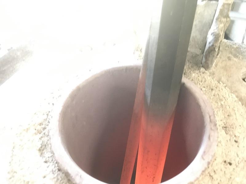

« Reply #503 on: August 03, 2020, 08:27:08 AM »
Well they've actually all gone out now - one couple were still there when I did the previous run but they were indoors so may not even have heard anything - after all it was over in five minutes - that's the good thing with induction heating.

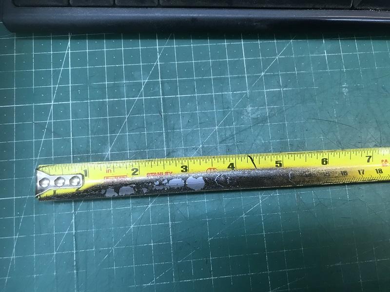

SO - let's do a second run with more mass in the crucible and see what happens. I added a 550 mm length of 33 mm hexagonal mild steel bar to the 16 mm round that was already in it, fired up Big Bertha and again ran to glowing heat - just a few minutes. Limit came on this time at 70 kW / 147 amps (had been 59 kW  / 122 amps previously)
I'm now thinking maybe the electronics is measuring the resonant circuit peak voltage and putting a limit on that - it's not entirely consistent but first run the voltage was  646 v at limit, this run it was 639 v. Need much more data I think.
Anyway I learnt two three lessons in this exercise.
a/ Driver goes into limit at different powers depending on charge in crucible
b/ Don't worry TOO much about the noise - it's much less at distance and I'm up close.
c/ And DON'T poke your tape measure in the crucible to measure a bar length - even when everything is OFF it's still hot enough to remove the paint !

I've been looking in detail at what circuit diagrams I have for this beast - the power electronics is comprehensively covered, but the control electronics is treated as a 'black box'. It's a single large PCB called a Saphyr Monocarte with loads of  microprocessor support chips and both digital and analog circuitry. Fortunately the manual labels the various connections to it, and I've managed to deduce that it IS monitoring the voltage on the resonant circuit (Internal massive capacitors and external crucible coil) through a step down transformer, so presumably that is the 'Voltage' displayed on the control panel, and it looks as though it has a limit set at around 646 volts as that value features in several of my pictures when 'at limit' independent of which furnace body is connected. The 'Current' displayed is the 3 phase input current and fairly closely corresponds to the value that the diesel generator indicates.
. . . it's all a learning exercise !

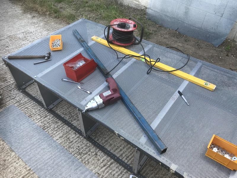

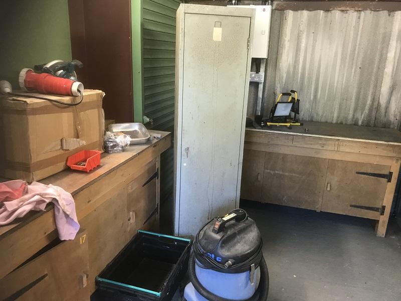

Before I start using the foundry in earnest there's quite a bit of sorting out needed - stuff has just been piled up all over the place to let me get on getting the furnace working - well now it does so time to start the sorting.
Just outside the foundry sliding door, in the welding shop, were two 1 metre wide shelving units that historically have held electrical installation materials, rolls of conduit wire, adaptable boxes,  isolator switches - you know - the stuff that accumulates and is too good to throw out as undoubtedly it WILL be needed. Over the past weeks I've been re-deploying it elsewhere - largely successfully but you always end up with stuff with no home  :bang:
In the clear out I found a brand new emergency 'maintained light' unit - sensible to install it in the foundry if it still works - it's NiCd 4 AH 2.4 volt battery was down to 1 volt so it's now on charge but 'the jury is out' whether it will actually work.
The idea was to remove the two shelving units, put a back on one of them to stop it racking and also stop bits falling off at the back, and put it in the foundry for crucible, pattern, moisture meter etc storage where the 18" square clothing locker currently is where the PPE kit lives. This necessitated moving a foundry bench (that still has a load of Mansfield sand in it) sideways six inches, a feat accomplished with help from a friend yesterday.

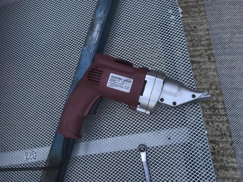

So today I looked at the pile of sheet metal for a suitable backing sheet, and found a full 8 x 4 sheet of galvanised expanded mesh left over from building the Plasma Table extraction system - a result as I'm unlikely to need the mesh in future and it saves a sheet of useful Zintec for other needs.
I'd intended to lay the shelving unit down with the mesh on top, and cut it with an angle grinder, but then I remembered an electric hand held shear that I'd bought some years ago but found to be pretty puny. Rated for 1.2 mm it really struggled, but it ate this mesh like nobodies business  :ddb: It was the inability of this shear to really work 1.2 mm steel that prompted me to get a guillotine so I shouldn't really bear a grudge!
OK back fitted, shelving unit installed, quite a bit of foundry related 'stuff' put on it AND I now have a two metre length of wall space in the welding shop that has allowed me to push the Linisher, the Corner Notcher and the Band saw up to the wall out of the way - all of a sudden movement is far easier!
The second surplus shelving unit has found a temporary home in the Tractor Shed - it needs fixing to something to stop in racking though.
I just need now to find somewhere for the clothing locker - the corner by the roller shutter would be perfect apart from the roof leak above it that I don't seem to be able to cure  :bang:

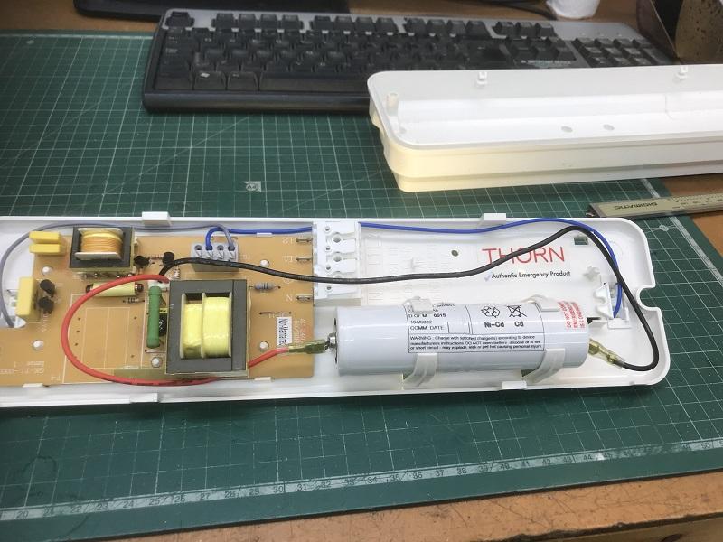

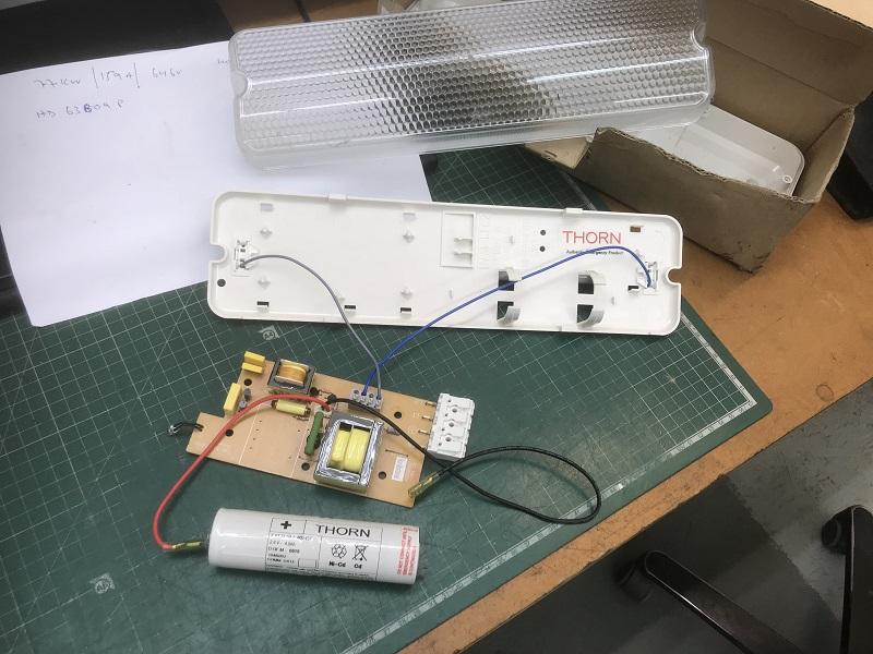

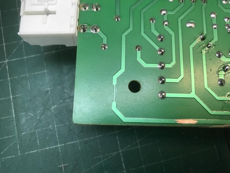

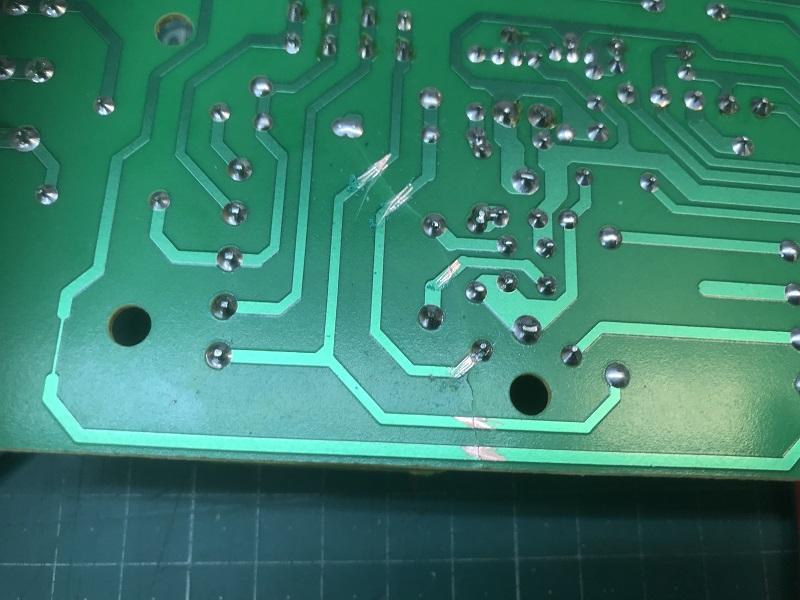

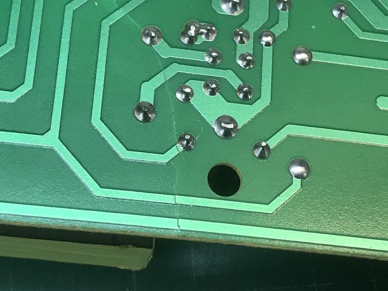

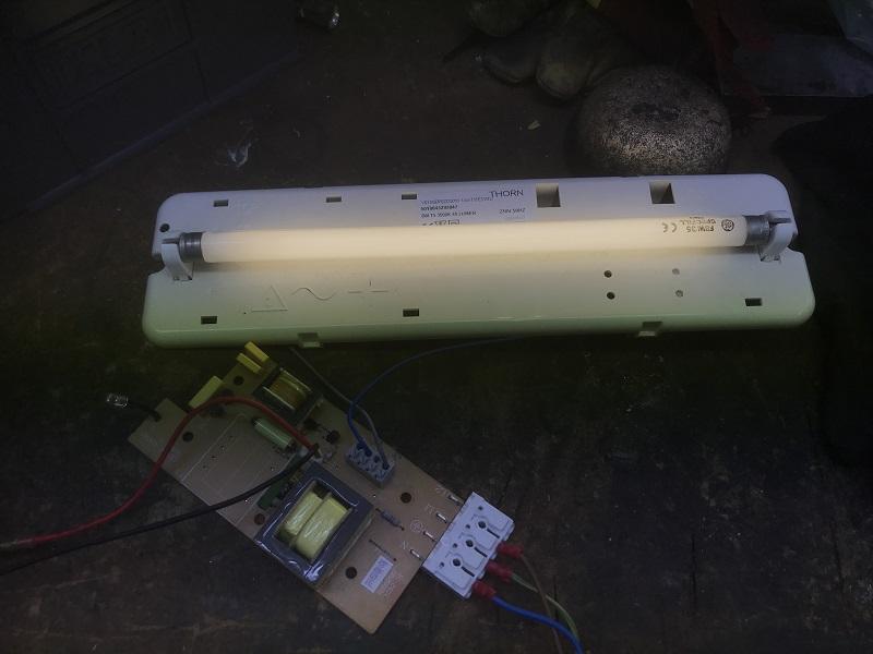

So, after a suitable time interval I checked the NiCd battery and amazingly it's come up to a fully charged state :thumbup:

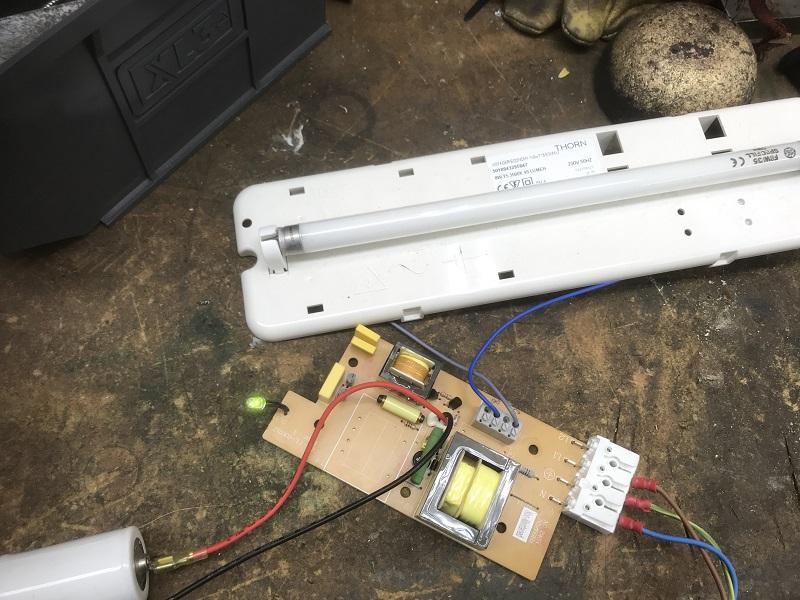

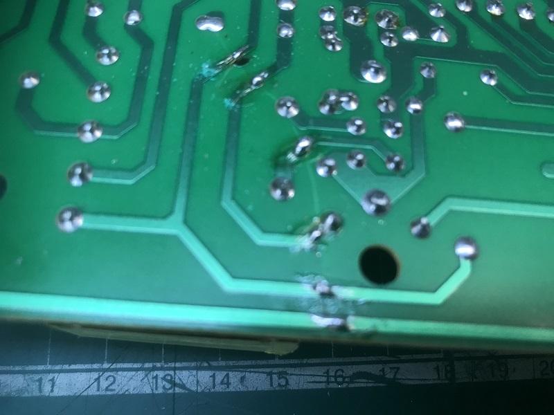

So I plugged the main inverter PCB back in connecting the battery and mains. The fluorescent light tube lit and the LED was OFF - it should be the other way round !
I then made a close examination of the PCB, which only has four transistors and two diodes plus a bridge rectifier - getting it lit up with a torch to read type numbers (I'd intended to replace the lot!) I noticed what initially looked like a scratch in the PCB but actually was a crack. It's cheepo paxolin not fiberglass so not very strong. I identified no less than six breaks in copper tracks (remember this is new never used!). Scraping the conformal coating off the tracks I made solder 'bridges' over the damage and tried again plugging it in. Result - it now works as it should  :clap:
Now solder bridges are not going to be very reliable, and if I decide to use it I'll put wire links in to replace the tracks. I seem to remember I bought a 'job lot' years back when I was equipping the main workshop - they were genuinely unused but one was declared as not working so it must have been this one.
Barely worth repairing as I can buy a new one for £25, but quite satisfying  :thumbup:

« Reply #512 on: August 06, 2020, 05:19:54 AM »
Well Graham it's two and a half hours into a three hour 'run test' and doing well - 2.4 volt battery down to 2.23 volts.
So you'll be pleased to hear that I WILL put proper repair links on the PCB along with a bit of epoxy glue, re-assemble it and stick it over the sliding door entrance to the foundry - pictures will follow later !

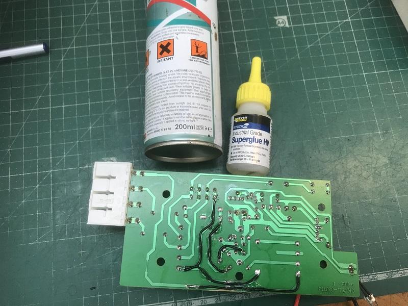

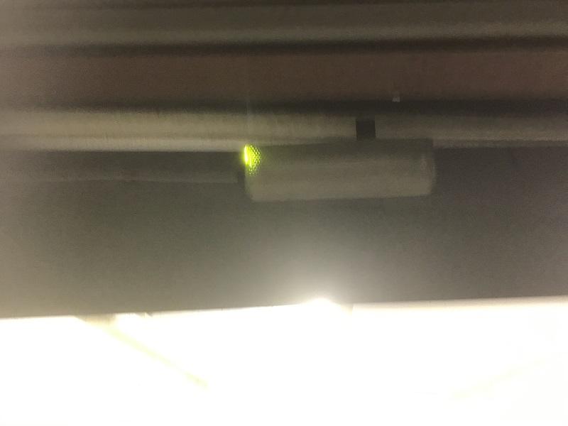

« Reply #516 on: August 06, 2020, 08:37:57 AM »

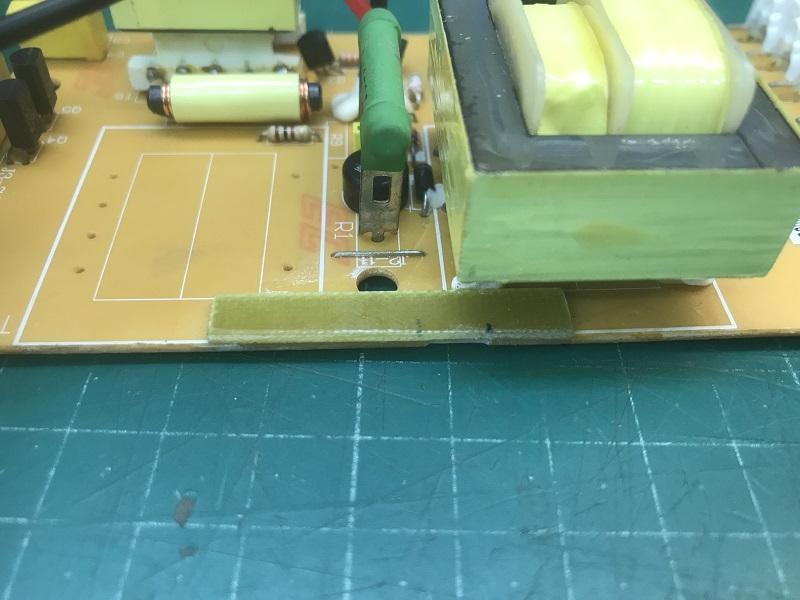

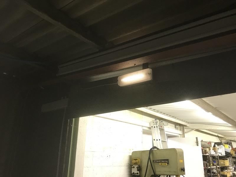

This 'non-maintained' (meaning it's not on all the time) emergency light is rated to last 3 hours. My test showed it to actually have a run time of 2 hours 50 minutes. If I can't get out of the foundry in less than 2 hours 50 minutes I have other problems not solved by lighting  :clap:
So I went ahead and did the repairs. Firstly I cut a strip of good quality fiberglass printed circuit board and super glued it across the crack to try and stop further movement. Then I put wire 'salvage' links between the nearest component pads either side of the breaks. There was one exception, where the track is deliberately very thin to act as a fuse - in this case I scraped away the solder mask and soldered directly to the track. All salvage links were then fixed down with a few drops of super glue.
I seem to remember when I worked at Ferranti on the process control computers boards were allowed to have up to five salvage links, but they had to be identified with a short length of red sleeving to distinguish them from 'modification links' - you were allowed loads of mod links! Mind you these were complex multi-layer boards with oodles of ic's on board.
Having proved it still worked I then mounted it over the sliding door entrance to the foundry running the lead to a spare 13 amp socket in a dual that also feeds the roller shutter.
Seems to work OK :thumbup:
