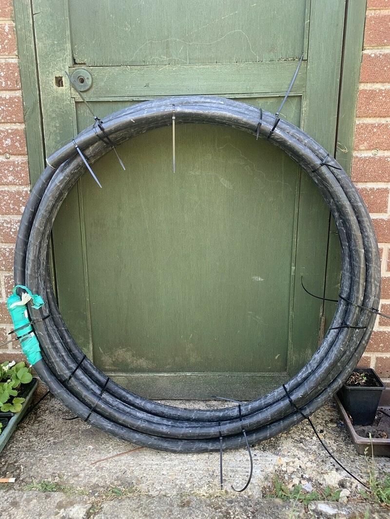

This evening I've bought an 18 metre length of brand new 4 core 35 mm csa SWA cable on ebay at a pretty cheap price (£54) and have put it up on Shiply for quotes for delivery (it's in Kidington, Oxford) . By co-incidence the best so far is from the chap who delivered the two humongous Heat Exchangers, one of which went into the new water cooler. They totalled 75 kg - this cable in 'only' 50 kg !
This will enable me to direct bury it in the earth between the generator and the foundry without any conduit and have enough either end to fix a plug and socket in convenient places. I already have a 10 metre length but it only just reaches and it's ends would have to be in darn inconvenient places.

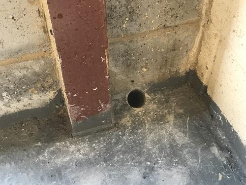

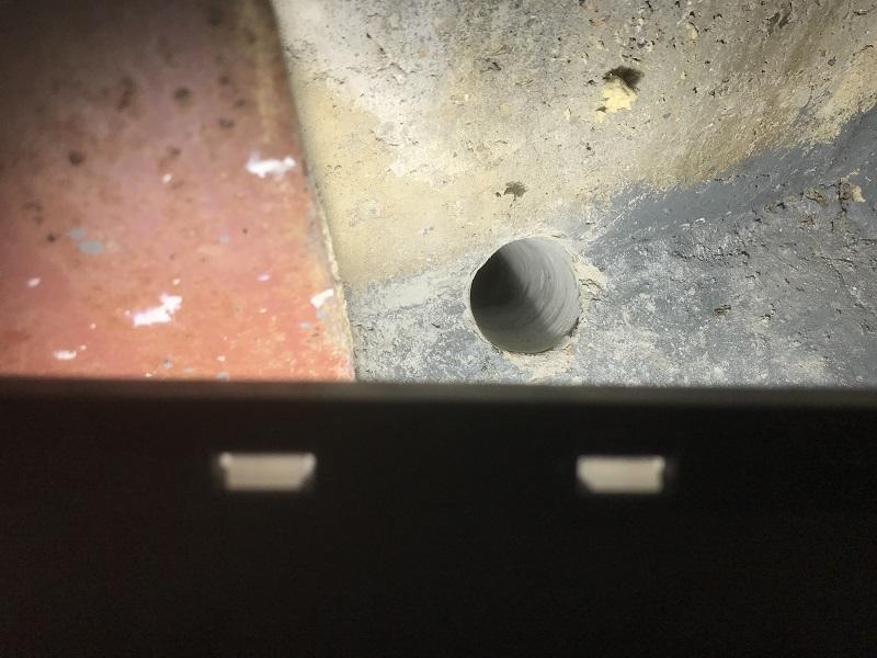

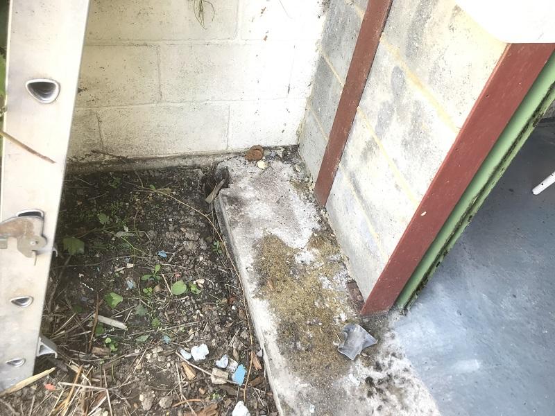

The extra 18 metres of 4 core 35mm csa SWA cable is due to arrive this afternoon so I need to consider how to get it into the foundry from it's proposed underground trench.
It's not very flexible, and needs to raise from horizontal in it's underground trench to vertical up the inside wall of the foundry, so just drilling a hole through the wall won't work due to the minimum bend radius of the 30 mm diameter outer sheath . I hit on the idea of core drilling a hole at 45 degrees through the corner of the concrete slab / wall junction. Then when the trench is dug it can slightly under mine the slab and the cable can take up a somewhat gentler bend.
So using my diamond core drill and both the extensions that I have for it I drilled the hole. It ended up about 14 inches long. Sounds simple doesn't it but producing that hole represents two hours of my life :bugeye:
My core drill perhaps doesn't have as many diamonds as it used to have, and I had to alternate between two drills as they were getting mighty hot so . . .
. . . . it may look like a pathetic little hole to you but to me it represents an achievement  :ddb:

A bit of an update:
A/ The 18 metre length of 4 core 35 mm CSA SWA cable arrived as promised late Saturday afternoon.

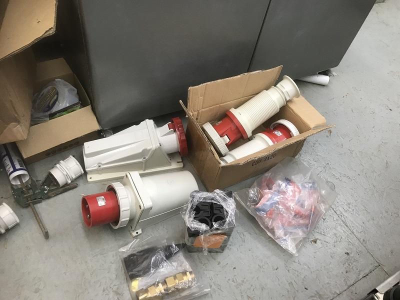

B/ I have been ordering the bits needed to make up the permanent installation (Glands, CC12 cable clips, a Male and Female fixed plug & socket, and male and female free plugs & sockets, and an underground poured resin cable joiner) and some, but not all,  bits have arrived.
C/ I have a volunteer 'trench digger' who was due to do his stuff this evening but as his Sister in Law has been rushed into intensive care that's off the menu.
D/ I've had a friend unroll the alleged 18 metres of cable and measure it both physically and electrically - it's 18.1 metres (so that's OK) and electrically sound, as is the 10 metre roll and also the 28 metres of flexible cable (despite it's antiquity)
The current (!!!) plan is to run the SWA so that the 'underground resin joint' is actually above ground inside the foundry - this is convenient for the two cable lengths and means that the male and female wall mounted plug and socket can be mounted immediately adjacent to the generator and furnace driver respectively and it minimises the amount of cable needing pulling through that 50 mm concrete hole that I drilled on Saturday reducing the risk of damage to the sheath.
But frustratingly I've not personally been able to do anything but be an onlooker to these activities as it seems I've either trapped a nerve or possibly pulled a muscle in the vicinity of my left hip and cannot be on my feet for more than about a minute before being in agony. Hopefully it'll sort itself out after a few more days but this is day three already  :( If it goes on much longer I'll need to order a Zimmer Frame  :bugeye:

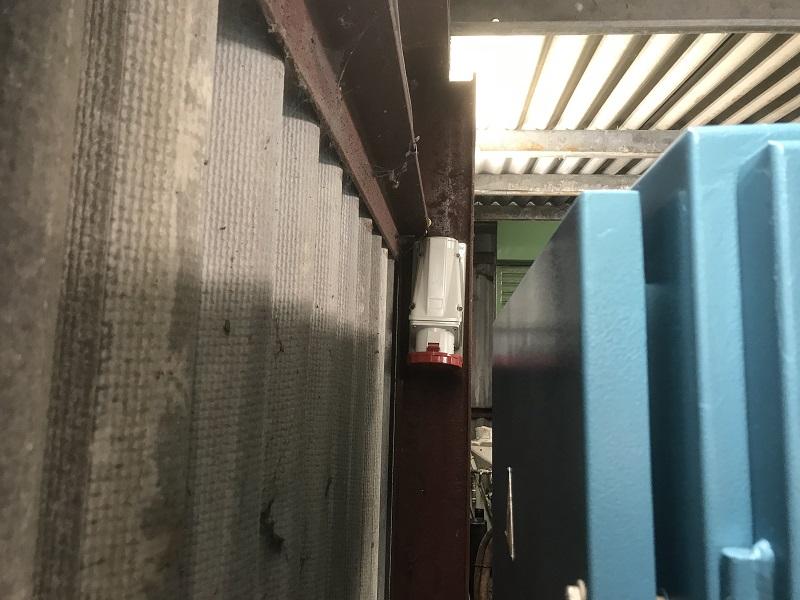

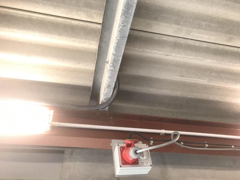

Having found that my 'new body'  coped with that I mounted up the final 125 amp female socket where the SWA cable will terminate - only four 8 mm holes through an RSJ but at least it's done now and makes visualising the cable run easier. Having done this it confirmed me in the belief that the input socket on the Furnace Driver should be rotated 90 degrees to keep it's umbilical cord shorter and out of the way of the pipe/cables that go to the furnace bodies.
All little things but at least they are done.

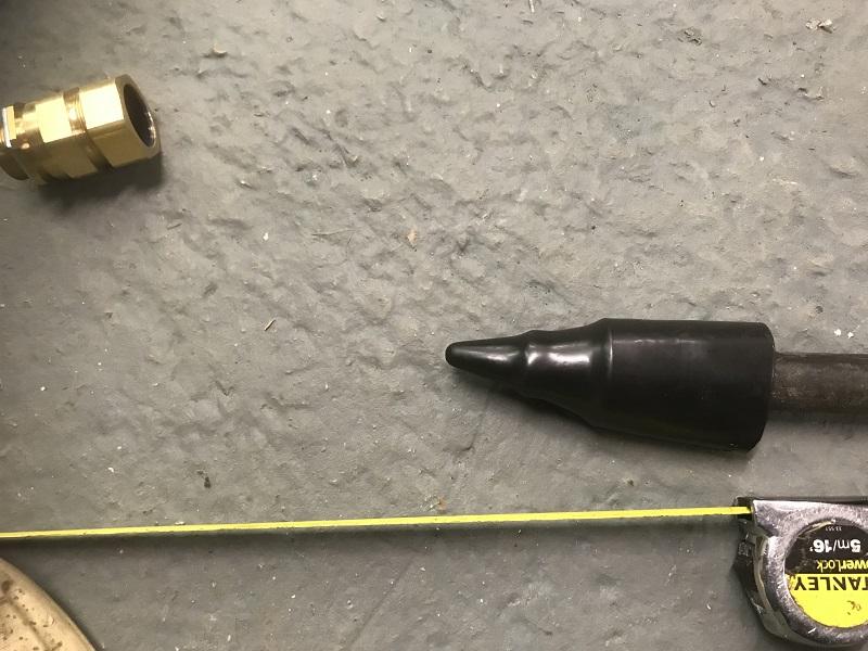

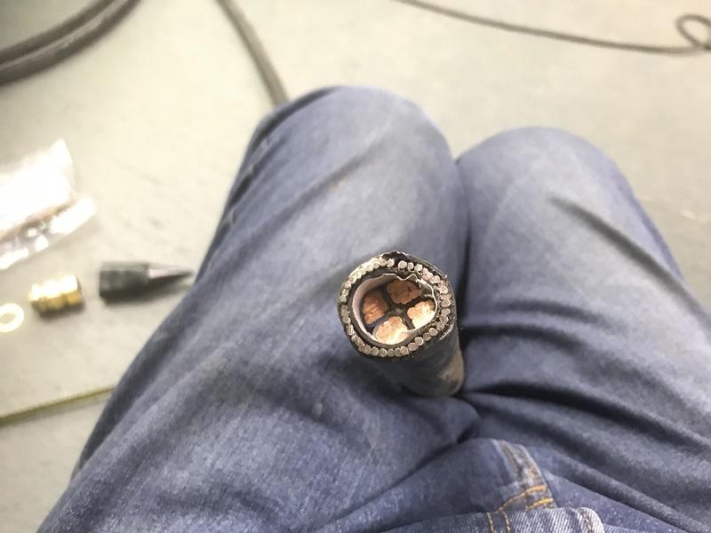

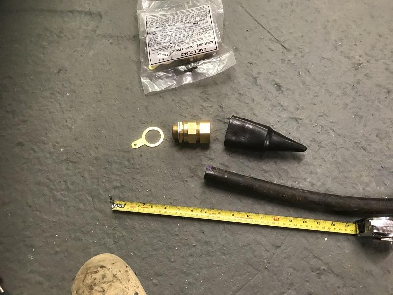

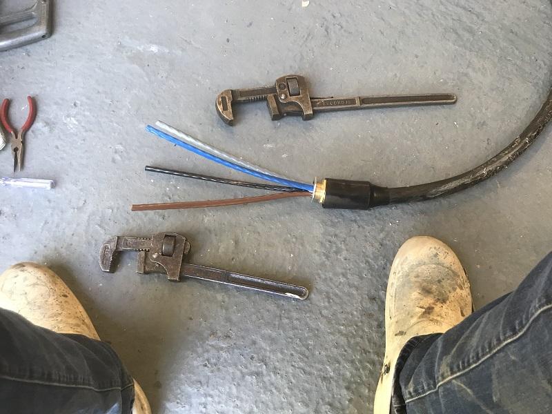

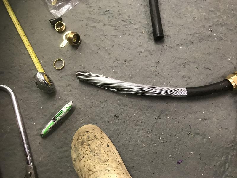

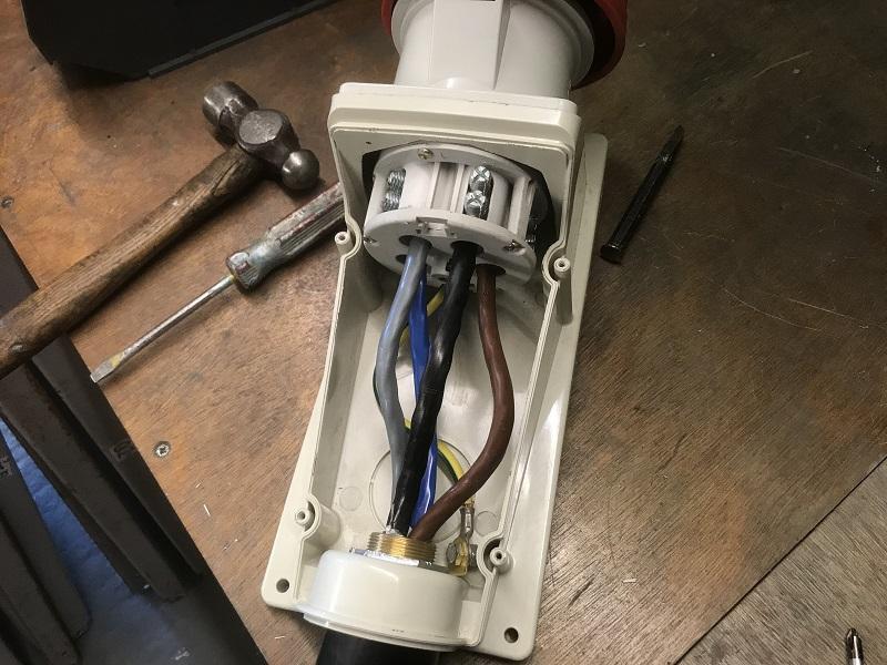

So this afternoon I decided to tackle terminating the 10 metre length of 35 mm CSA four core SWA by fitting a waterproof gland and making it off on the 125 amp socket that I'd mounted earlier.
This cable is particularly stiff, the cores having been compressed into pie slices and the copper being hard drawn bending it is great fun. So much so that I decided that I had no chance of leaving the socket on the wall, I'd have to dismount it and make off the cable on the ground.
Although it is big, it's construction is just like smaller SWA in that the cores get gripped between a conical part and a tapered ring to physically grip the cable and also provide earth continuity. Somehow I lost the taper ring - searched high and low, was about to use the ring from the second gland only to find it exactly where I was working - I reckon that the Pixies are teasing me  :clap:
Now I've picked up a couple of useful SWA tips recently watching YouTube. When trimming the cable shroud, first push it in reverse onto the cable, then just trim where it bulges - so simple! Then when the gland and cable are loosely put together run a fixing nut onto the thread and use it to tap the taper assembly firmly together before tightening the conical bits to get a well packed tight cable.
You can tell you are working on big cables when you have to use Stilsons to grip the nuts as you have no spanners big enough  :bugeye:

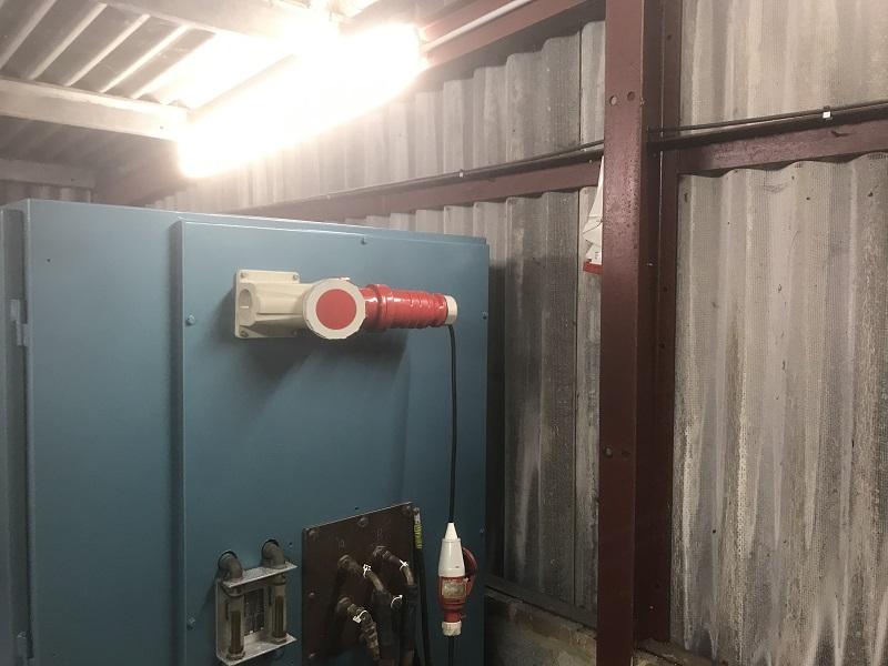

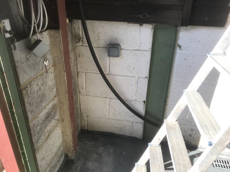

Getting the cable cores into the 125 amp socket was hard work as they just wouldn't bend, but eventually they all got into the right holes (I hope!) and were made off.
Then to re-mount the socket - due to the rigidity of the cable I had to use long bolts to slowly pull it into place then once there I replaced them one by one with the correct length. While this was happening I had loosely suspended the cable from the Z purlin that it would be attached to by CC12 cleats to get it roughly in place and take the considerable weight.

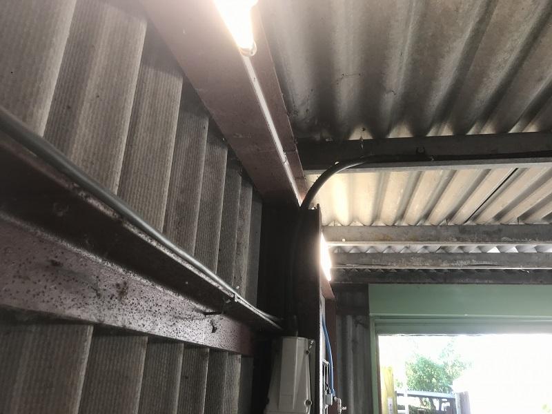

OK socket mounted, then I worked across the Z purlin fitted the CC12 cleats with 8 mm bolts and temporarily laid the cable behind the RSJ that it will be cleated to hopefully tomorrow.
The cable end currently dangles close to where I bored that 45 degree hole in the concrete. I will bring the other (18 metre) cable in through the hole (once the trench is dug) and they will be joined with a cast resin junction of the type intended to be buried.

This morning I finished off cleating the cable to the RSJ up in the gods. It's amazing how inventive you can be using the ubiquitous baler twine to haul things into position while you are trying to get a cleat, a bolt and a hole all lined up at the top of a ladder at the same time as an Anaconda is fighting you  :lol:
Oh - and I topped up the Chiller tank with about three gallons of anti-freeze solution - it had been drained off when I 'unplumbed' for painting.
