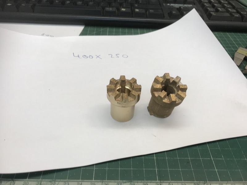

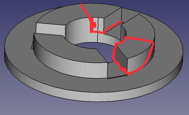

I am struggling to figure out how I can machine the item in the picture. I have it to the state that it is drawn to but adding the slopes is the hard bit. They would be easy if it was just a case of doing straight cuts but the things they are pulling in will need to increase angle as they pull in which I need to account for on the slopes. I am even struggling to describe exactly whats required even though I see it clearly in my head.

It's a ramping clutch?

Kind of more of a ramping cam.

Looking more closely at your model I am struggling a bit to understand the shape to be cut.  Does it have a focal point in the centre of the object.  I am thinking ball end mill for the step cutting do both ramps have the same profile to be cut ?
Yeah as I said I am struggling to describe it properly but at the lowest bit the tang will be 90 degrees but as the tang is pulled back by the cam the angle will change gradually by up to 12 degrees, hope that helps.

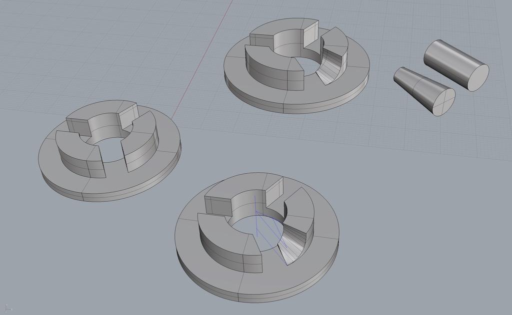

Lets try from a different angle.  I have been doodling, what shape is the follower that contacts this cam.  Is it spherical, a straight or taper pin profile.  From that I can sweep the cam surface to form the ramp.

I'd draw that in CAD as a 2-d ramp and plot x,y co-ordinates for step-milling with a ball end mill, but put the part on a rotary table and turn the part instead of moving in the x axis.
I think with a bit of fiddling this can do it but I am feeling so bad now i can't think straight will revisit it tomorrow hopefully.
