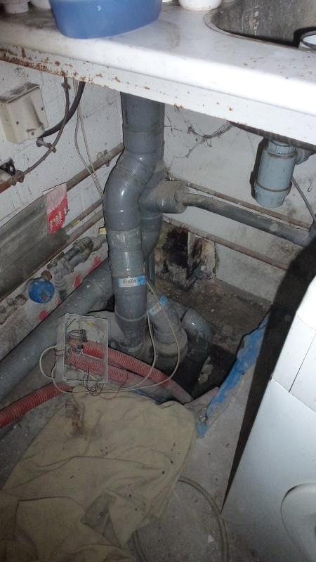

Hi,
Coming out of lurk mode! I am in the process of re-enforcing the steel structure of the building I live and work in. It's an industrial building that is fifty years old, steel frame that wasn't galvanised. I've welded in patches and bolted on re-enforcing plates on the bottom four inches of the pillars. My plan is to cast concrete around the bases as  protection against rust and to fill in the masonry that I had to break out to get access.  I have treated the steel with Phosphoric acid, after as much de-rusting/de-scaling as possible, my problem is, will the concrete react with the Phosphoric acid or should I paint before pouring the concrete?
Your thoughts would be most welcome! Regards, Matthew

Thank you for your comment! This job is in a hole in a wall where nobody could shot blast anything! It is less accessible than the other three pillars that I've done, it is below ground level on the outside, below the floor behind the soil pipe, grey water pipe, gas supply and the water pipe! Curiously, I have been metal working my entire life, most of that professionally! I want to get as much rust protection as possible as I can't get into all of the nooks and crannies!

That's the sort of thing Andrew. The biggest problem for me is rust removal. It's realy hard to get to!
