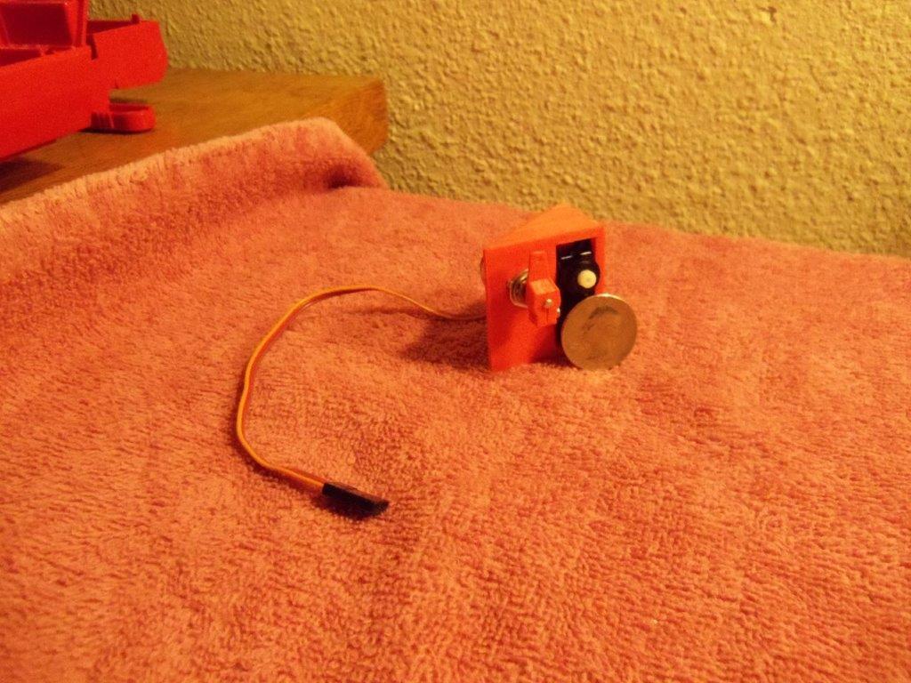

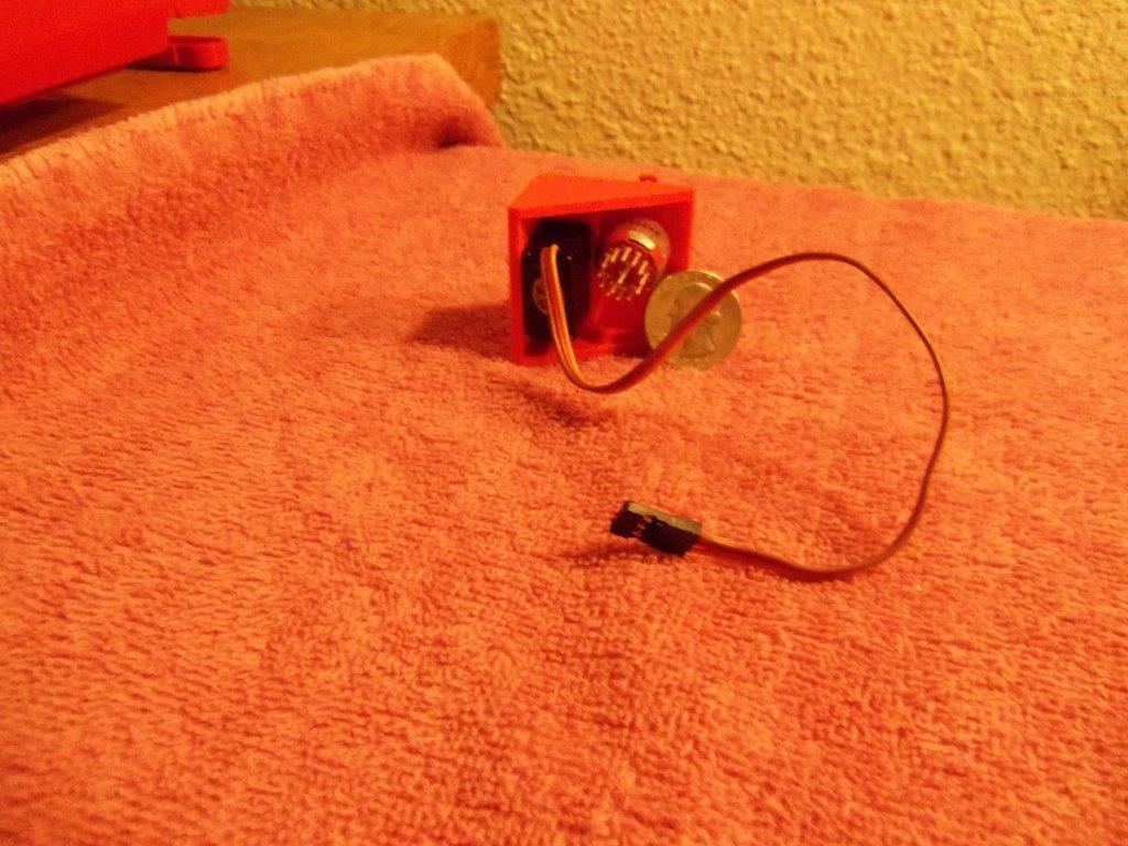

Some neat stuff vitally important material arrived over the weekend, I got my 6 position 2 pole rotary switches from Digi-Key, they're cute LITTLE suckers.
I designed a bracket that will hold a sub-micro servo and the switch, I also had to design the control arm the servo will use to change the switch position.  The first attempt didn't work out so well, things mostly fit, but I didn't have the switch oriented correctly,  The switch needs to have the number 1 position 60° ccw of vertical for all of the detent positions to line up correctly with the servo throw.  There are 2 flats on the switch that keep the switch body from rotating, and a flat on the switch shaft to properly orient the knob, or in my case control arm.  When I modeled the switch flat on the switch, my calibrated Mk I Eyeballs didn't notice that the flat on the shaft did not line up with the switch detent positions - it's halfway in between.
I'm going to be using 5 positions of the switch and I want the #3 position to be vertical, this will make getting the linkages set up sooooo much easier.  I initially had the bracket 3mm thick, I had 4.5-5mm of available threads on the switch body and the nut is 1.5mm thick so I thought I was in like Flynn.  Not so much, no room for the lock washer.  I also discovered my original assumption, that the flats on the switch body would be enough to properly orient the switch, doesn't exactly work in the real world.  The switch comes with a keyed sheet metal locating ring with protruding tabs that will lock the switch into position.  I didn't think I'd need it, I was wrong.  By the time everything gets tightened down, the switch position can change by 10° or more, this is not acceptable.
I redesigned the bracket, I cut out a section around the switch opening and rotated that section.  I couldn't figure out a way to measure the angles with what equipment I had.  I guestimated this angle at 10-15°, so I rotated the section 10° - turns out I SHOULD have rotated it 15°.  While I still had it loose from the rest of the bracket, I also thinned this section down to 2mm.  This gives me an additional 1mm of usable threads on the switch, along with the room for the locating ring AND the lock washer.  I also did a couple of other things to improve the print quality and reduce the print time, went from 70 minutes to 59.
I discovered that I couldn't get a programmer to modify the digital servos I had.  I had a couple of cheapies that I got from HobbyKing a couple of years ago - go figure.  So I ordered a couple of Hitec HS-5055 sub-micro's and a programmer to match.  They SHOULD be a drop in fit in the bracket.  If not, well, it's not like I haven't re-designed this bracket a couple of times already.
I also got my spool of "Translucent Red", and I'm a little disappointed, this stuff is more transparent than translucent.  I think you could print fairly respectable tail light lenses with this stuff.  The search for a redder red filament was on - again.  I found one that the reviewers consistently said was the "reddest red" they ever seen, and it's called...  "Enzo" Red, yup, it looks like Ferrari Red on a spool.  We'll see how close it comes to matching the Bruder red plastic.  If this one doesn't work, then screw it -  I'm just gonna get a can of rattle-can red and paint everything to match.
I'll take some pictures tonight, after I've got the switch oriented correctly.

I took some pictures last night and kept the best two, they are attached below.  You've got a view of the actuator arm side of the switch, and the pins side of the switch.  The actuator arm is in the #3 position.  Positions 1 & 2 are CCW of center, and positions 4 & 5 are CW of the center #3 position.  A quarter is shown as a scale reference.  The servo shown is one that I had in my junk box, but it's supposed to be the same size as the Hitec servos I've got ordered.
This will probably be the last of the pictures for a while, I got my Arduino Nano's last night so I'll be busy learning how to program them, doing the programming, and testing/debugging my programming.

Not too much progress since last time.  In my day job the two busiest times of my year are the Christmas shutdown and the July 4th shutdown.  When the plant's not running, you've got to cram in as much process improvement work as you absolutely can.  The plant's up and running again now so we can all take a couple of deep breaths - and then start getting ready to do it all over again in July.
I did get a little time to do some more work on the turret slewing gearbox.  For a little while I thought that I had it completed, then I turned on the steering servos in my CAD drawing.  The slewing gearbox and one of the steering servos were trying to occupy the same volume of space - not a particularly good idea.  I wound up rotating the gearbox CCW 90° around the turret pivot axis, and letting the gearbox stick out the side of the frame - into the unused space inside the model fuel tank.  That was mighty considerate of them, putting that big, well - relatively big, empty space right where I needed it.
I started printing out the parts for the turret slewing gearbox, when I've got it complete I'll take a family photo and I'll update the 3D PDF.
