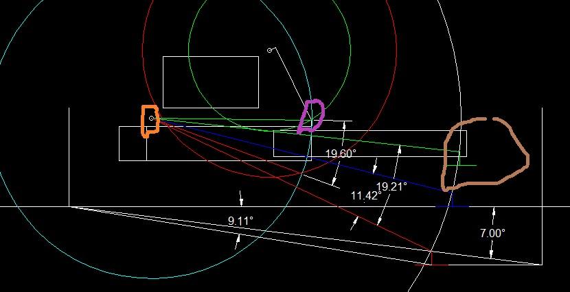

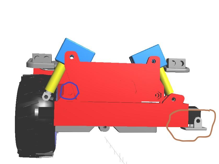

Well, I’ve got good news and bad news.
The good news is that all the parts have come in so I can start experimenting with the 6050 IMU and my Nano clone, to see if I can work out an auto leveling system for the Manitou.
The bad news is that last night I did some drawing to determine how much of a pitch and roll angle the crane could be at and I would be able to level it using the outriggers with no blocking.  Turns out it’s not so much.   I’ve attached a JPG of the 3D PDF since some people seem to not be able to view the PDF.
In its’ current configuration the outrigger pad, circled in brown, will extend about another 3” to the right, actually 77mm for those of you that are Imperially challenged.  The outrigger will pivot around the location circled in blue.  The outrigger assembly is driven up and down by the ram, the yellow part right above the outrigger.  The ram will have about 3/4” of travel, call it 20mm.  This translates to about a 1-1/4”, call it 30mm, vertical travel of the leveling pad.  In itself, this is not bad.  However there’s almost 1” of ground clearance to the leveling pad, call it 24-25mm, so there’s less that 1/4” of actual vertical movement before the ram reaches the end of its’ stroke.  I’m going to have to either use blocks almost all the time, or I need to redesign the outrigger rams.
I think I’ve got 3 options on the redesign:
1) Raise the ram motors a lot – maybe 20-25mm!  I don’t know if I’ve got room to do this and still clear the molded in counterweight.
2) Move the ram motor assembly from centered on the outrigger to the far side of the outrigger.  The far side would be away from the 2 outriggers.  This would allow me to move the point where the ram attaches to the outrigger from the top of the outrigger to the bottom.  This would give me approximately an additional 20mm of ram travel.  The additional ram travel would give me an additional 30mm of vertical travel on the pad.  The problem with this option is I’m not sure I’ve got enough clearance between the wheel and the outrigger for the ram.
3) Move the ram motor assembly from centered on the outrigger to the inside of the outriggers.  The inside would be between the 2 outriggers.  The problem with this option is I’m not sure where the ram would be in relation to the outrigger extension motor.
If I can get another 20mm of ram travel, that translates to 30mm of vertical movement for the leveling pad at full extension.  I could lower the leveling pad about 1-1/2".  Which if I measured it right means I would be able to correct for a +/-13° roll angle and/or a +/-9° pitch angle on the crane.
Offline WeldingRod
  • Posts: 401
Re: Bruder Manitou 2150 - RC conversion
« Reply #81 on: September 23, 2021, 12:27:42 PM »
Move the blue circled pivot point inward?
Online ddmckee54
  • Posts: 376
« Reply #82 on: September 23, 2021, 12:54:36 PM »
WeldingRod:
That might help, what might help more is dropping the outriggers down so that they're even with the bottom of the axles.  This would move the pivot down not in.  That would effectively give me 10-12mm more of vertical travel just by eliminating some of the ground clearance under the outriggers.  But it wouldn't be eliminating any of the crane's ground clearance since the axles are that low already.  When you add in the additional 10-12mm of ram stroke that would give me I'm probably close to the 1-1/2" movement that redesigning the ram placement would have given me - with a lot less hassle.
It's a change from the Bruder original, but they were designed as toys - not scale models.  I can live with it.

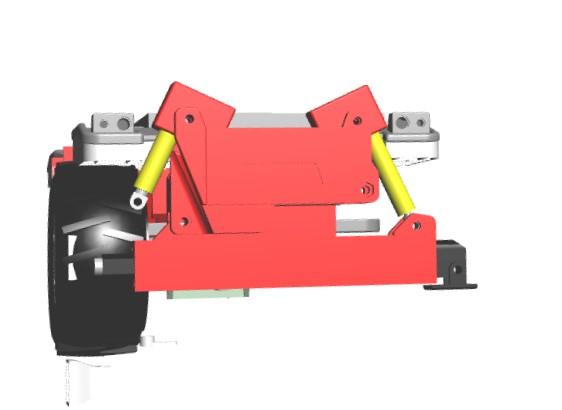

I looked at the model last night, both the 3D version and physical one, and I came to the conclusion that my options 1-3 will NOT work.  I can't raise the outrigger ram motor, option 1, because that will interfere with the crane counterweight as it swings around.  I can move the rams to what I called the outside, option 2, because that will interfere with the fenders and wheels.  And I can't move the rams to the inside, option 3, because that will interfere with the outrigger extension motor.
WeldingRod suggested moving the outrigger pivot point in, and I thought about that, but I wasn't sure if that would be a help or a hinderance.  It did get me to thinking about moving things though.  Last night I played worked with the 3D model and lowered the outriggers 11mm so that the bottom of the outrigger was even with the bottom of the axle.
That way I can accomplish several things.  I don't lose any ground clearance on the model, I reduce the amount of travel between the UP position of the outrigger and the ground, and I extend the outrigger ram - giving me more travel on the ram.  I'm gonna give WeldingRod the blame credit for this idea.  I've attached a screenshot of the revised 3D model.  Ignore all the extra crap - I forgot to turn it off before I saved the PDF last night.
The second attachment is a HIGHLY simplified front view of the Manitou.  Can’t see it?  Well, at least all the important bits are there anyway.  The white rectangle at the top is the upper frame of the crane.  Below the upper frame is the outrigger, it is shown in with the outrigger fully extended,  The horizontal line that runs all the way across from one side of the screen to the other is the level “ground”.  The vertical line on the left is the outside of the tires on that side.
Inside the orange blobby-circly-thingy is the outrigger pivot point, this point never moves with respect to the upper frame.
Inside the magenta blobby-circly-thingy is the outrigger ram lower pivot point when the ram is retracted, the angled white line is the ram centerline when retracted.  The small white circle to the upper-left of the magenta thing is the outrigger ram upper pivot point – this point never moves with respect to the upper frame.  The green circle shows the path the end of the outrigger ram would follow as it is swung around the ram’s upper pivot point.  The cyan circle shows the path that the ram’s lower pivot point will follow at the outrigger is swung around it’s pivot point.  The white line, the green circle, and the cyan circle all conveniently intersect at the same spot, the fully retracted position of the ram.
I determined that the outrigger ram has 27mm of usable travel.  Offsetting the green circle 27mm. and I get the red circle.  The stuff shown in green is with the ram fully retracted.  The stuff in red is with the ram fully extended.
The tan blobbish thing on the right contains the simplified outrigger pad, that’s the green inverted T, the pad pivot point, and line that shows the center-to-center distance between the pad pivot point and the outrigger pivot point.  The large white circle is the path the pad pivot point will follow as the outrigger ram extends and retracts.  All this crap just to get a couple of angles, and we’re still not done.
Where the red circle and the cyan circle intersect will be the position of the outrigger ram lower pivot point when the ram is fully extended.  Looking at this in the light of day I can see I made as boo-boo  19.6° does NOT equal 19.21°.  I think I know where I screwed up, when I changed the angular dimension style halfway thru the drawing - I changed it from X° to X.XX°.  I measured the angle between the two green lines so I could determine where the pad pivot point would be with the ram extended.  It measured 5°, but it was actually 5.39° - I just measured it.  That means my measured maximum pitch&roll angles will slightly too small, probably by less than ¼ - ½ degree.
OK – focus!  Back to draining the swamp.  With the pad pivot point‘s lowest position now fixed we can find where the pad touches the ground, the red inverted T.
Assuming that the crane will pivot on the outside of the tire, we draw a line from that point to the pad’s assumed contact point and measure the angle.  VIOLA, we get 9.11°-ish, remember I makada slight boo-boo way-back-when.  That’s the maximum roll angle I can hope to correct without blocks.  The vertical line on the right represents the distance between the front and rear outriggers.  When I connect the dots and measure the angle I get 7°-ish degrees as the maximum pitch angle that I’ll be able to correct without blocks.
I actually thought it would be more, but numbers don’t lie.
