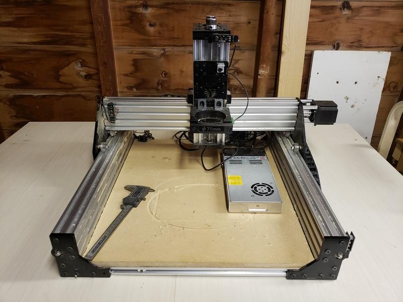

Ok...
Parts came. Went together easily... Then it sat. I kept seeing things to improve. My time was short so I never got to implement them. I decided to rebuild it before I even used it. I ordered the parts to convert it into a different CNC Router. This one was also on OpenBuilds. The Sphinx55
I ended up getting it converted and was able to cut some stuff. Did very well with wood. I was able to get some 3D Carved signs made for presents.
It could cut aluminum... but the cuts had to be light and speeds/feeds almost dead on. I traced a lot of the quality issues I was having to some play in the Z axis. I knew this wouldn't be the stiffest things in the world, but I thought it would be better than what it was.

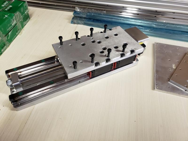

I started researching ways to help stiffen things up. I then found THIS:

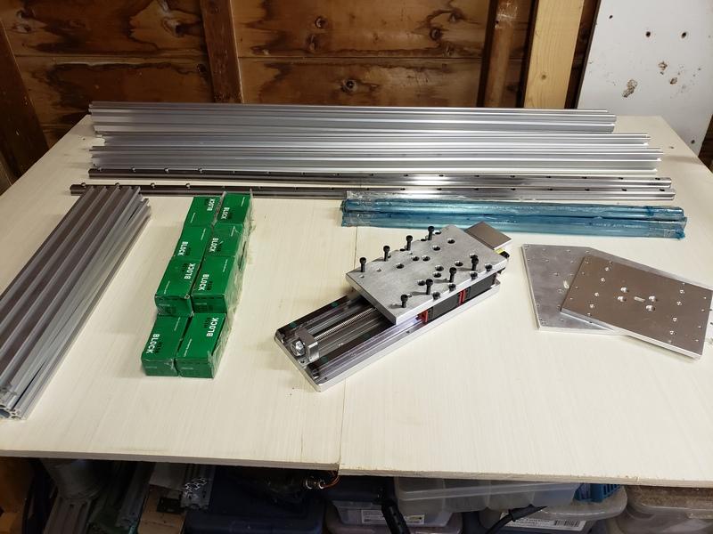

Oooh. I like that. But, I didn't like the 12mm linear rails. I have those on my Ender 3. They are fine for a printer. And I am quite sure, about a million times stiffer than the stock wheels. I just didn't want the 12mm.
I email the guy selling the plates and ask him about a set of plates for the 15mm rails instead. He tells me that he designed a kit for the 15mm rails but has not yet machined a set yet.
Sign me up!
I think to myself... While I am at it. Why not increase the footprint. Right now it is at 500mm by 500mm. Let's make it 1000mm by 500mm.
Ordered a flurry of parts
Aluminum extrusions for the base
1000mm C Beam and Acme Screw for the X axis
Plate kit from Blue Ox Solutions
15mm Linear rails and bearing blocks (1000mm and 500mm(2))
A new Z axis actuator from CNC4Newbie
A bunch more bolts/nuts etc...
As soon as everything gets here, I will start tearing down and rebuilding.

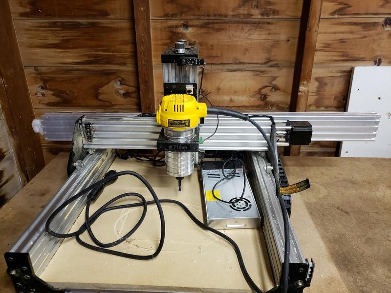

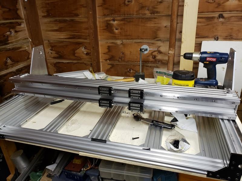

Re: OpenBuilds C-Beam Machine
« Reply #5 on: August 17, 2020, 10:12:31 AM »

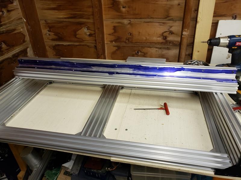

I did get some things in already.
« Reply #6 on: August 17, 2020, 10:14:15 AM »
So I started the tear down.

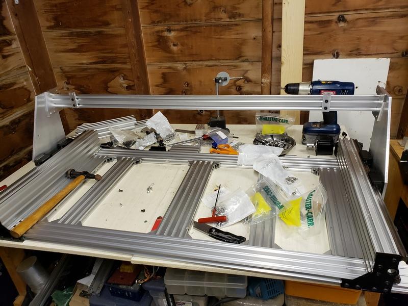

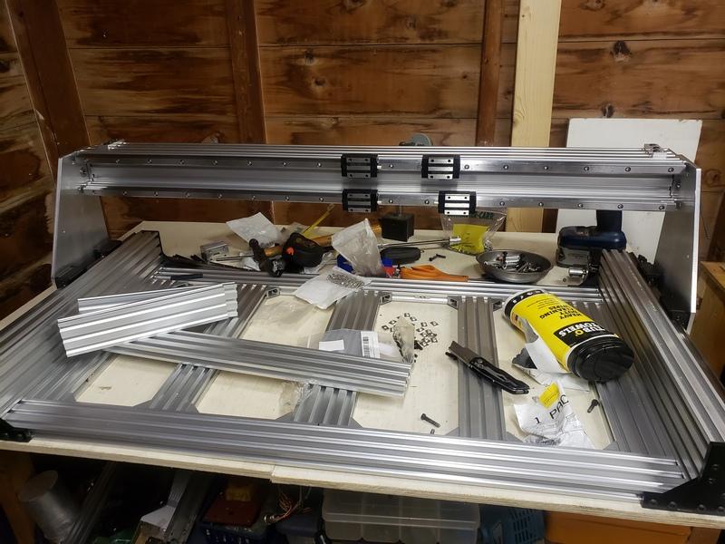

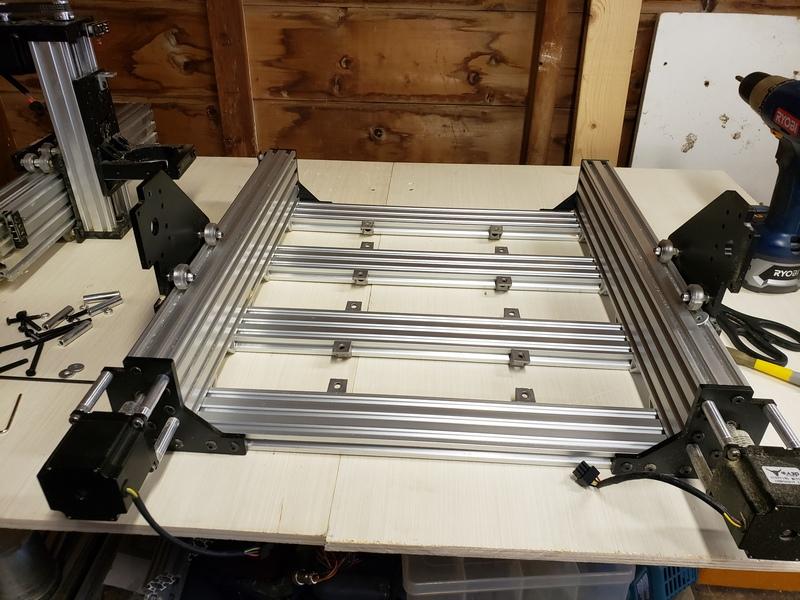

« Reply #7 on: August 21, 2020, 10:00:57 AM »

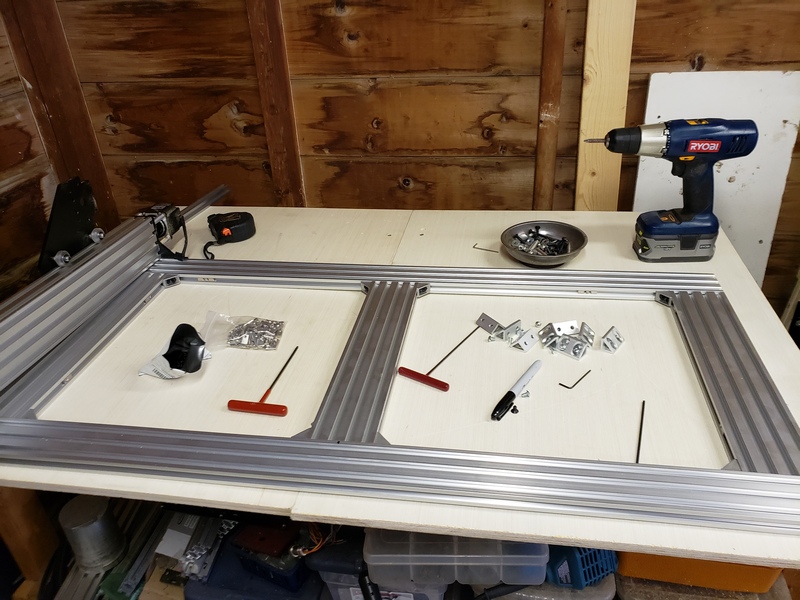

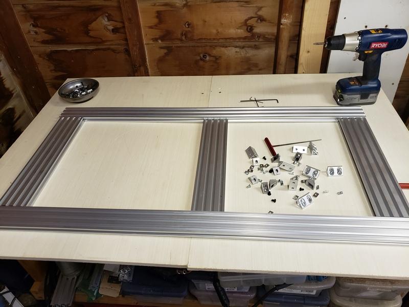

While I wait for a few more things... I started to put the base together.
I still need to add some cross members to the bottom of the frame. I have decided to add some t-slot track instead of just a spoil board. Those should be here tomorrow. I can then think about how the crossbeams will be setup to support the t-slot track.

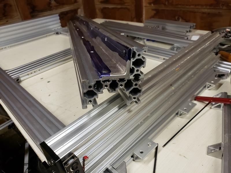

« Reply #9 on: August 21, 2020, 10:07:08 AM »

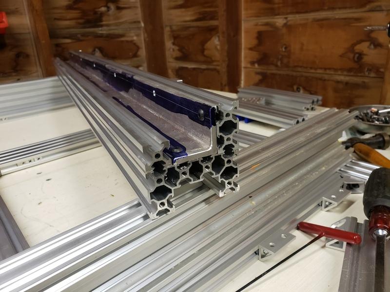

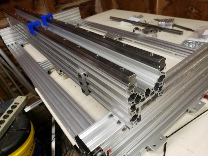

I also did a bit of work to the X gantry.
By itself, the C-beam is an 80mm by 80mm that is a 1000mm long. That is basically, well... C shaped. Not sure how stiff it will be so I am adding some bracing.
I will end up using adapters and plates to add a 20mm x 40mm extrusion to the top of the X gantry and a 20mm x 20mm to the bottom. When you look at it from the side, will sort of resemble an I beam. I decided to add a length of aluminum angle as well...
You can see in the last picture, a couple of the alignment blocks I 3D printed to help install the rails.

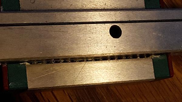

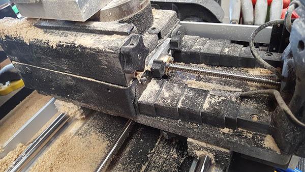

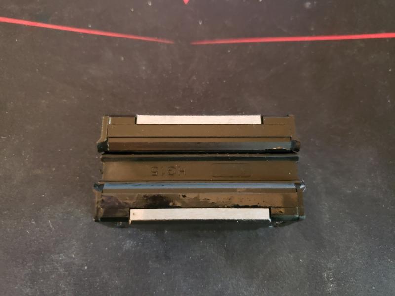

One problem I've run into with MGN linear guides is the carriages are not sealed.  This doesn't matter on a 3d printer, but it's the pits on a router :hammer:  Fortunately, they are easy to disassemble and clean.  I'm currently experimenting with using felt furniture pads which have an adhesive back to cover the open bottoms as well as adding 3d printed covers.  So far it's been working well.
p.s. A bag of 1000 ball bearings is cheap insurance  :clap:
« Reply #11 on: August 22, 2020, 10:28:21 AM »
Tell me more? Got pictures etc?

« Reply #12 on: August 23, 2020, 02:23:35 PM »
Breaking down the rose engine to show the felt wipers on the linear slides is not an easy task :(
Here's the bottom of an MGN carriage:
And a couple of shots showing the 3d printed covers:

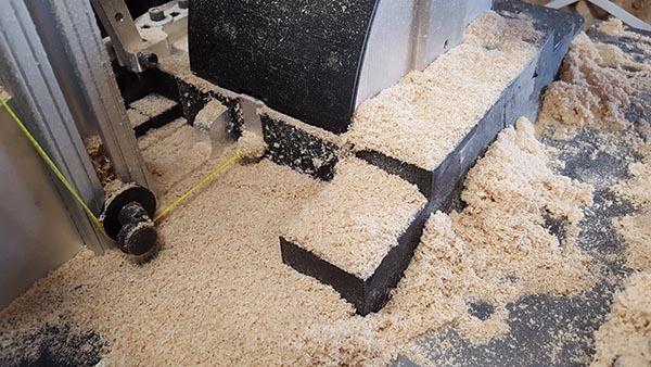

I learned quickly that a dust boot was needed. First time I cut a wood sign, my whole shop got covered in layers of sawdust.
I ended up 3D printing one and a cyclone bit that attaches to a 5 gallon bucket to swirl the dust down and keep it out of the shopvac filter. Works well too...

This is the dust cyclone I printed:
https://www.thingiverse.com/thing:2104717
And the dust shoe
https://www.thingiverse.com/thing:2802301
Had to design and print some hose adapters for it. But, it works fantastic.
« Reply #18 on: August 25, 2020, 09:18:44 AM »
I had a good look at my bearing blocks. The look a bit different from yours... Mine are sealed.

I was able to get into the workshop last night for a little awhile.
I was able to do some pre-assembly and test fitting. I lost a little on the X axis due to the gantry plates sticking further outboard the the stock roller plates. Ended up trimming about 2" from the bottom rails.
I got the X Axis mostly assembled. Thing weighs a ton without the Z Axis. Beginning to wonder if the puny stepper motors will be able to handle it or if I am going to need to order some stronger ones
I got to the point of test fitting the built X Axis before I called it a night.
Tomorrow I hope to get the screws in for the Y & X Axis. Have to take the gantry plates off and mount the anti-backlash nuts...
