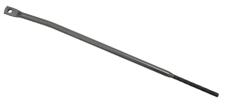

The piece is 16" long (40 cm) and it needs to be bent 4" (10 cm) from the end.

Here is what it will be replacing. As you can see, not much of a bend.

Just do it in the vice, use a ring spanner if you need some leverage and a tighter bend.

Got it done. Wrapped copious quantities of electrical tape around it, put it in the vise, put a 2 foot piece of steel pipe over it, a few short tugs and all is well.
