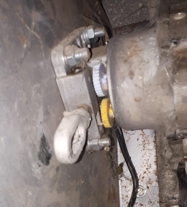

Hi guys, our tractor shed has a bigish roller shutter. Normally goes up and down using the key-switch.
Not any more!
Started to not go all the way down, initially a 30 mm gap, then 60 then more like 90.
Thought at first there would be some obvious micro-switches but none that I can see.
Before we call in the company I would like it to close [Public Hols in .ie tomorrow]. So I have the long pole with the hook on the end but it just turns without lowering the shutter.
Is there some trick to using the manual backup system?

on the tubular motor type of roller shutter door, the limit switches are inside the square shaped end of the motor, which is accesible at the end of the roll of panels, there is usually two blue plastic allen sockets visible, one for top limit and one for bottom. Unfortunately I cannot think of any scenario where they could move out of adjustment without the mechanism stripping its tiny nylon gears!, if it is that type, new motor time! I have three of this type of door.

can you see the motor, or is it inside the box that the shutter rolls into? pics? search tube motor on google images. it sounds from your description of the manual winding mechanism that it is a tube motor.
  • Country: ie
Re: Help with a big roller shutter
« Reply #8 on: August 07, 2019, 05:05:18 PM »
Its an internal tube motor.
There are two small plastic wheels that I think adjust the limits.
However a supplier (and me) cannot explain how the limits have moved!
Anyone know which wheel is which and how to set the limits?
I am awaiting a quote for new internals (motor and limits etc)
Thanks for the help so far

« Reply #10 on: August 08, 2019, 12:49:41 PM »
well they are not identical to mine, but tube motors nonetheless. To adjust them you hold the switch in the direction you want to adjust, and when the door stops, turning one or the other wheel will take the door a little further in the direction it is going in, usually about 1/2 inch at a time. Whilst it sounds difficult, in practice it is very logical once you know which is the up adjust, and which is the down. However, as I said above, I cannot understand why they have got out of adjustment, and it does sound like the mechanism has quit, which is a pain if the motor is still ok.
  • Posts: 819
« Reply #11 on: August 08, 2019, 01:08:58 PM »
