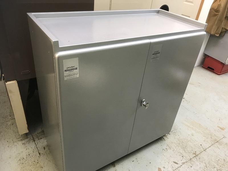

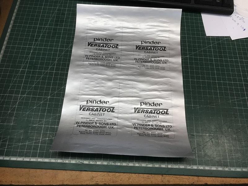

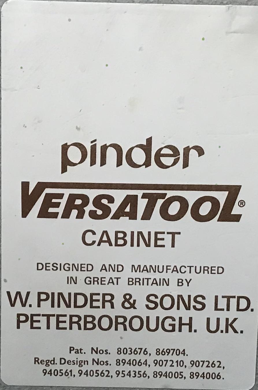

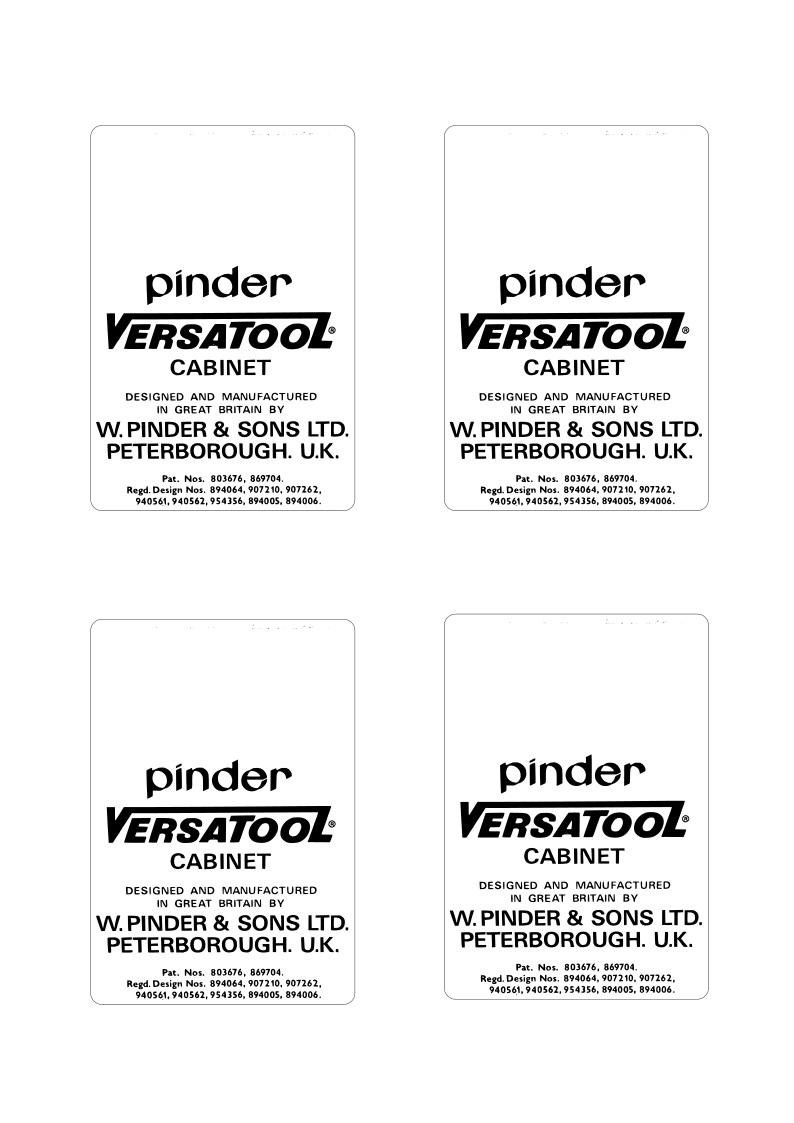

While waiting for varnish to dry . . . YAWN . . . I started playing with Inkscape the graphics program. It is amazingly versatile but I find it's human interface rather clunky and non-intuitive.
Casting about for something to experiment with I thought - why not try and copy one of the silver foil labels that originally adorned the doors of these Versatool cabinets.
So, taking a photograph of the one surviving label, and much assistance from YouTube I cleaned up the image, dropped the back ground, adjusted the inevitable distortion and then set the size to that of the original. Then (more YouTube!) surrounded it by a box with rounded corners as cutting guides, and created a full page with four copies evenly distributed - four being the maximum I could get on an A4 sheet.
Success so far, as it printed on paper very nicely, but the original was on 'silver' foil - what's available. Once again eBay came up trumps with full A4 self adhesive laser printable silver foil stock with a fast delivery at a reasonable price. It arrived this morning, and a quick bit of setting up produced four nice labels cut from the sheet by careful application of a scalpel.
The foil print was quite ruckled as it came out of the printer, but the labels flatten down OK when applied.
(I confess that the second label applied to the right hand door was to cover a paint blemish  :palm: )
Altogether quite pleasing.

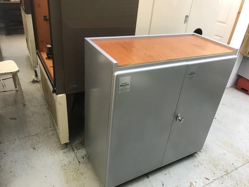

Then finally, now the varnish is dry, the counter top was replaced

« Reply #54 on: April 16, 2019, 11:43:40 AM »
I was going to ask how you ere going to deal with the large paint flaws on the right hand door - but cleaned my screen instead!
Strangely enough I have also been trying to learn some inkscape. I agree it's not very intuitive and without the tutorials you don't stand much/any chance of producing satisfactory results. I can muddle along with CAD producing drawings but I couldn't even get a start with this program without the assistance of youtube vids.
Your cabinets have come out very well and the stickers set them off nicely Andrew.

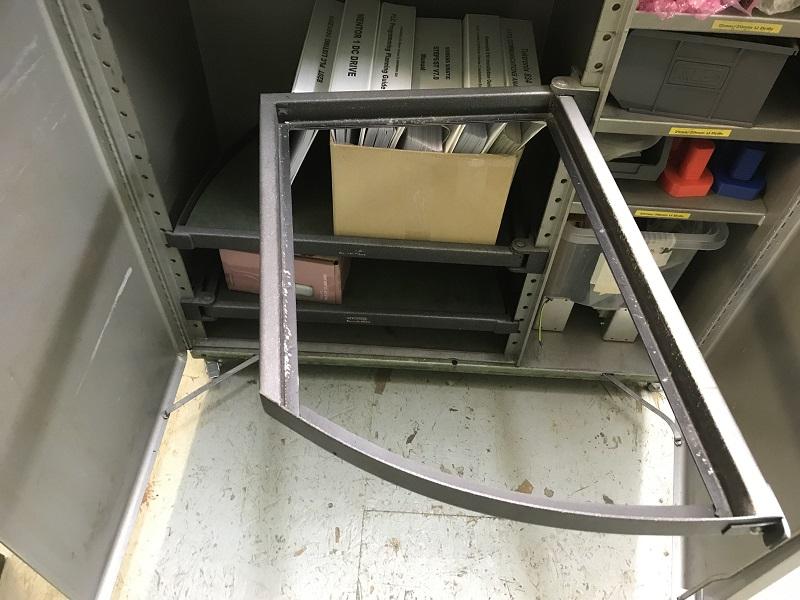

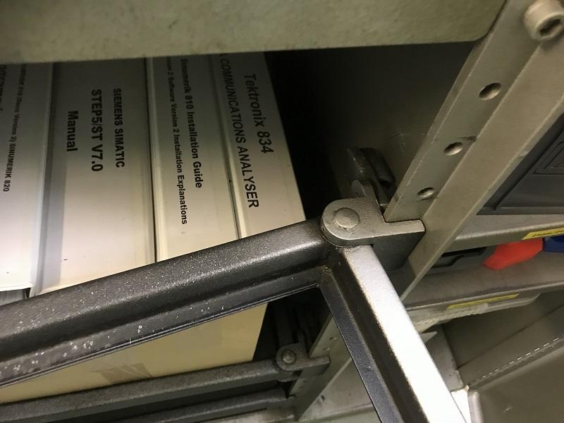

This is the Versatool arrangement
Re: Versatool Cabinets
« Reply #63 on: April 18, 2019, 11:36:49 AM »
Thank you. That looks pretty hefty material thickness. I was thinkking thinner metal and more dimenssions to build up stiffness.
  • Posts: 9048
« Reply #64 on: April 18, 2019, 12:42:00 PM »
But triangulated braces below will clash with the lower shelf. As it is I have to be a bit careful with protrusions below (tool holder shanks) clashing with things on the lower shelf. In the Versatool design each shelf can be easily set at a new height in 2 inch increments by a single fixing set by inserting a cranked square bar and twisting. (A nice bit of 'post design design' when you get your spacing wrong !)
