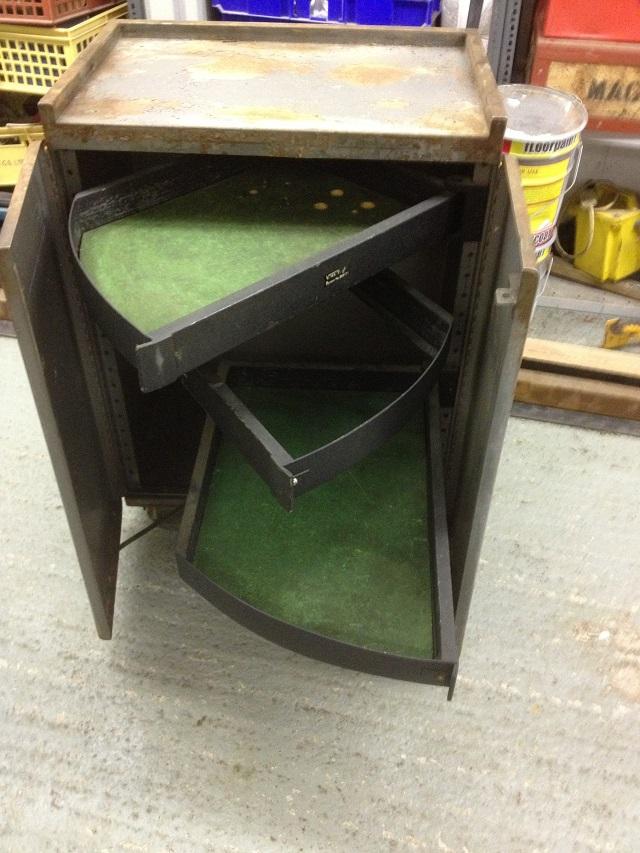

« on: July 16, 2013, 07:05:27 AM »

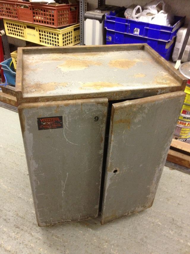

I acquired these two Versatool cabinets a year or so ago, and now I am tooling up for my big CNC Lathe the time has come to put them into service. They are rather tatty, dented and rusty. The intention is to clean them up, knock the bigger dents out, then re-spray them.
  • Posts: 9126
Re: Versatool Cabinets

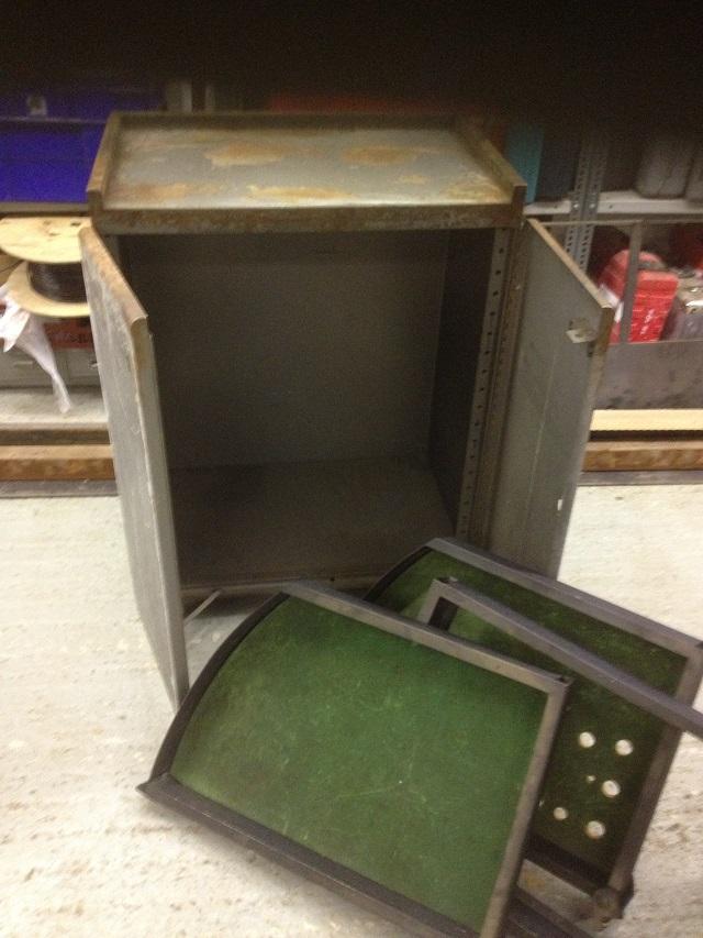

« Reply #1 on: July 16, 2013, 07:08:46 AM »

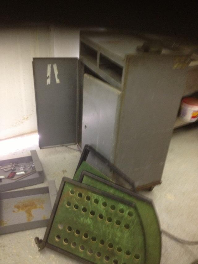

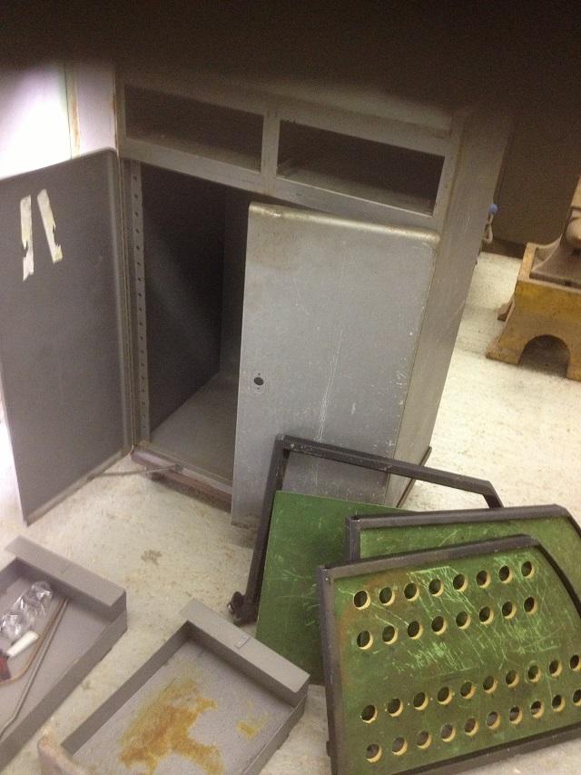

First I stripped out all the nice rotating shelves, drawers etc and went at them with a few gentle taps from a hammer

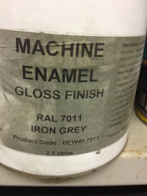

Checking the paint department, I had enough primer, and enough 'Iron Grey' top coat left over from spraying my 60 ton garage press when I re-built that, but I lacked the KPT04 thinners and only had one 'strip and clean' disk left. Suitable orders placed on eBay and I'll just have to be patient and wait for them to arrive.
If the weather holds I'm tempted to sand blast the cabinets - my 'portable' sand blaster is a Hodge Clemco biggy of the sort they use for motorway bridges and is a bit of a pain to pull out from where I store it - however a friend wants to blast some sandstone in his cottage wall so maybe we can kill two birds with one stone!

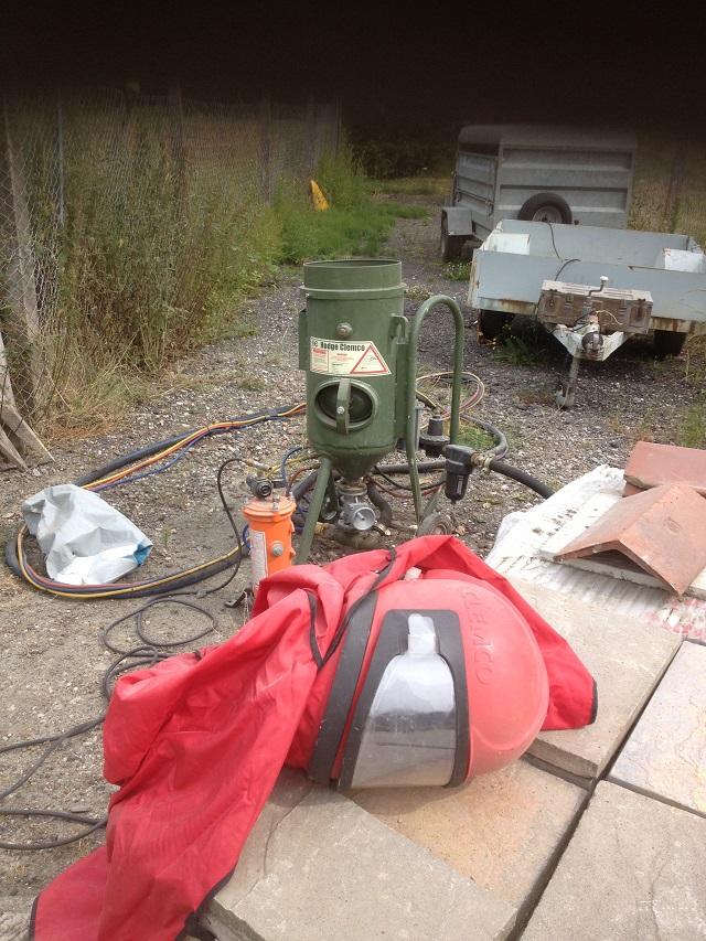

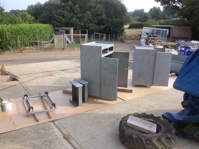

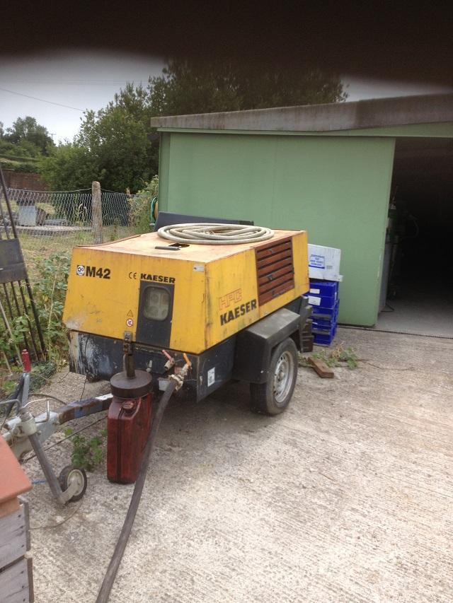

So of course I got impatient and dragged out the sand blaster anyway! This was 'a good thing' as it forced me to re-arrange the room I had it stored in, and tidy away some crates of machine spares into my container.
Anyway, have a sand blaster and the compressor that I use with it:
  • Posts: 9126
« Reply #4 on: July 16, 2013, 12:45:30 PM »
After using two bags of this grit - that's of the order of 60 kgs as the bags are approx 30 kg a piece for some reason:

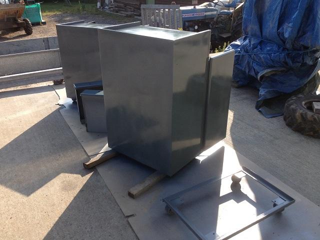

  • Posts: 9126
« Reply #5 on: July 16, 2013, 12:46:41 PM »

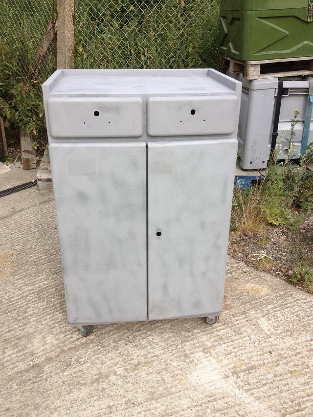

We end up with this result:

I've moved them into my insulated and dry workshop over night as otherwise they will rust very rapidly being really bare steel. If the weather holds tomorrow I reckon I've just about got enough thinners to blow a thin primer coat on to keep them safe

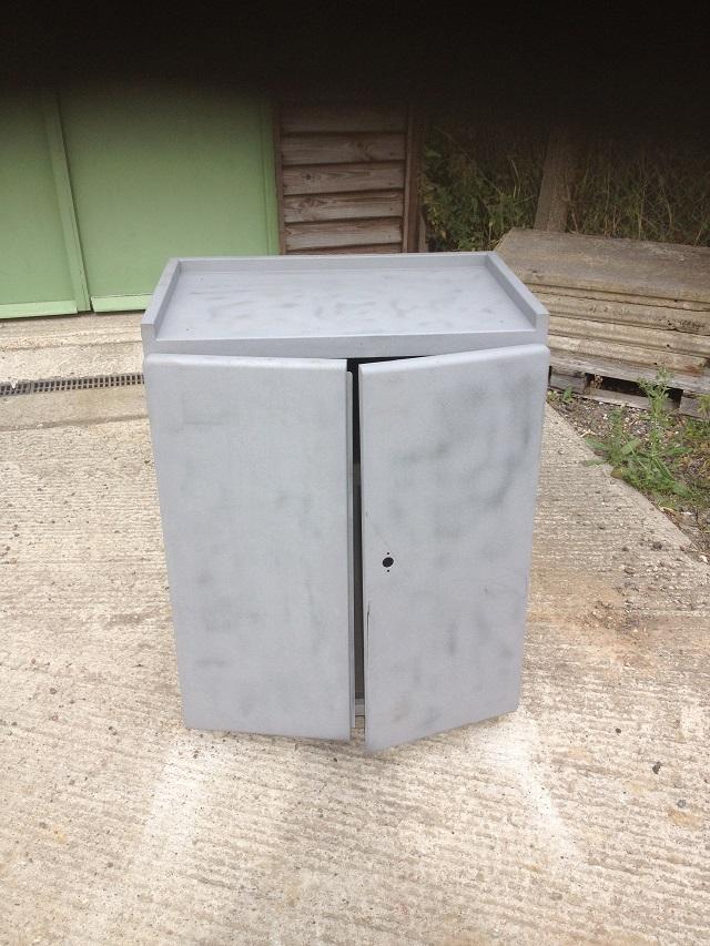

« Reply #13 on: July 17, 2013, 03:43:17 AM »
I always like to get something constructive done after I've fed & mucked out the animals and before breakfast, so here we have the Versatool cabinets set out ready for painting:
  • Posts: 9126
« Reply #14 on: July 17, 2013, 03:46:02 AM »
And here they are after the first coat of primer, which I just squeezed out of my remaining thinners - I had to clean the gun with Zylene  rather than the KPT04 that the paint is based on, but it worked ok:

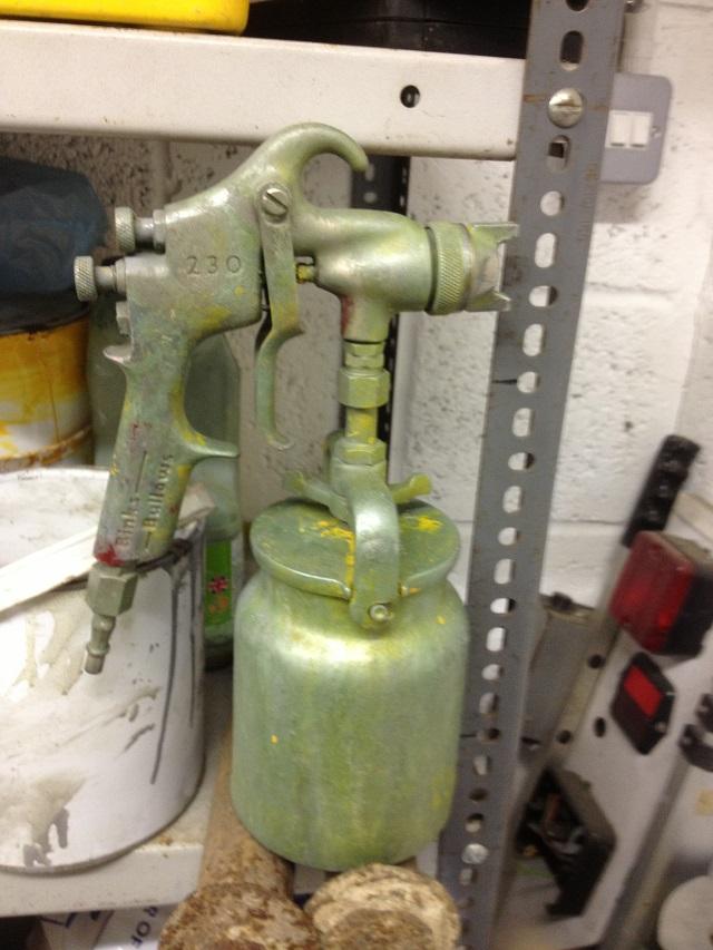

Well I'm certainly no expert spray painting!
The spray gun is a Binks Bullows '230' which I have had for probably over 30 years - as you can see it's sprayed a few colours in it's life. My 'method' of cleaning is:
a/ Pour out any remaining diluted paint - (I save it in a clean sealed plastic milk bottle if I have more to do later )
b/ Wipe out the reservoir, nozzle face, dip pipe etc with workshop tissue
c/ Put in about 50 ccs of thinners, shake it around, and spray into a wad of tissue - discard remnant
d/ Repeat c/ above
e/ Again put 50 ccs in the reservoir, swill it around then leave it in the gun
This seems to keep the workings clean and not clog up ensuring it's ready for next time

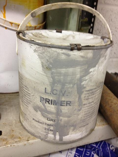

The paint system is one I originally came across advertised on eBay as 'Tractor Enamel' It's a synthetic enamel that produces a very tough coat if you put it on thin enough to thoroughly dry between coats. The primer includes corrosion inhibitors. As you can see I've had this can of primer for a year or two.
I use about 10% thinners in both the primer and the top coat, which is the max they recommend, and I put it on quite thinly. I want pretty quick drying as most of my spraying has to be done out doors.
You can get primers that are loaded with a filler - called primer / surfacers - they put a significant thickness on that you can flat down with wet and dry paper. These are good when you are trying to get a mirror finish on a car or something of that ilk, but kit in the workshop really doesn't justify that sort of approach in my way of thinking.

The paint came from a very helpful company called 'Fascinating Finishes' who hail from Hull - they will mix it to any colour you choose from the 'RAL Chart' - details on this can:
« Reply #19 on: July 17, 2013, 11:07:56 AM »
I can see that you've had that tin of corosion-inhibiting primer a long time - the tin's started going rusty :)

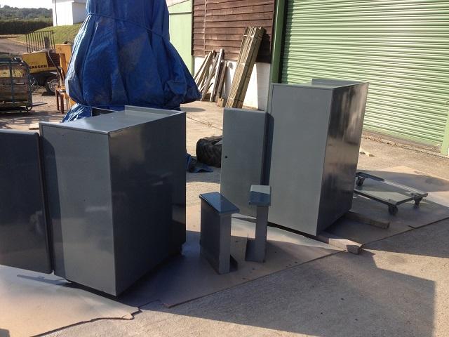

« Reply #23 on: July 18, 2013, 03:50:03 AM »

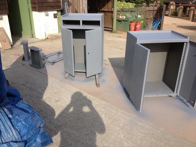

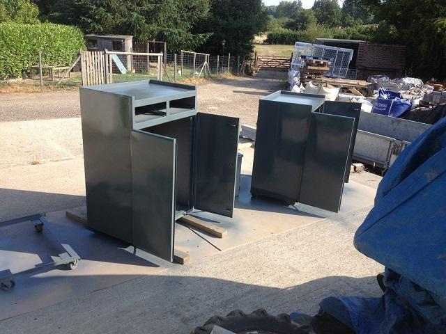

Top coat on - time for breakfast !
Not perfect, but a dramatic improvement on their previous state. Not enough paint left for another coat so I'm sure this will do fine. These will need to be left for a few days to fully harden before re-assembling the door and drawer furniture. I've even bought some new green baize for the shelves. Need to cut new plywood boards for the tops and those shelves with holes other than where I want them

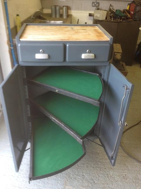

« Reply #26 on: July 26, 2013, 01:21:01 PM »

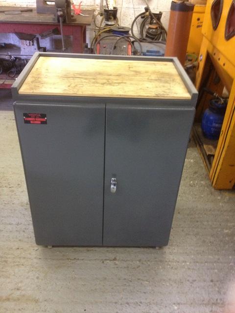

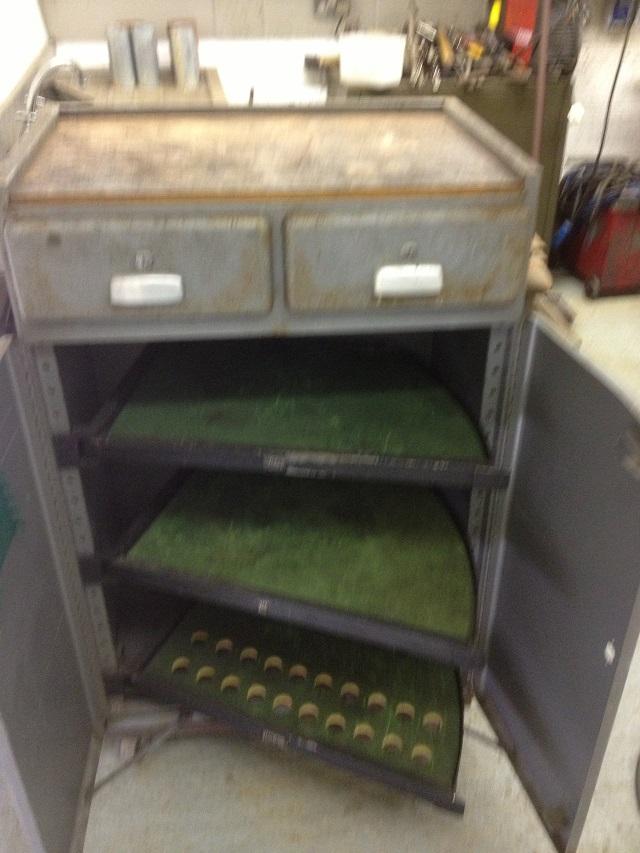

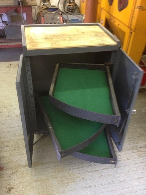

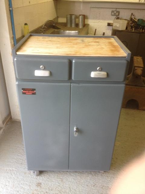

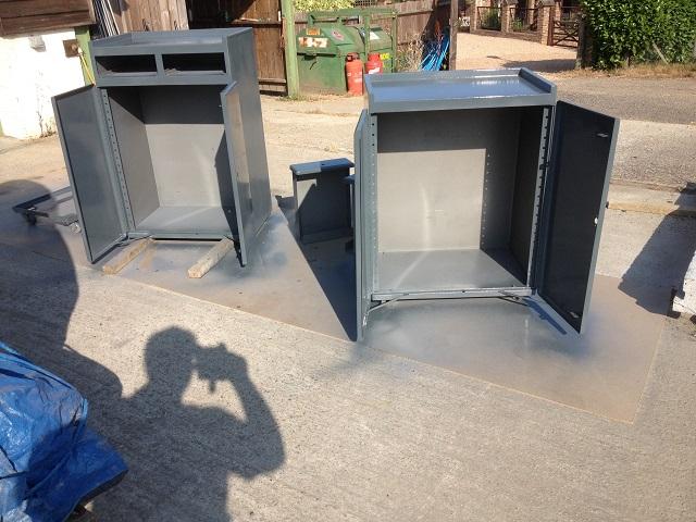

The time was right, so today I've re-assembled all the door furniture, sorted out the stripped threads on the drawer handles, bent up new locking bars to replace the missing ones on the smaller cabinet, cut new shelves and lined them with green baize, and sanded down the top wood 'bench' surfaces. The later I may replace - they are pretty tatty and I can't sand them any more as they are plywood, and I'll go through the top lamination. I had some left over ' 20mm shuttering plywood' that I used for the shelves as they are covered, but it's not a good enough top lamination to be an exposed surface.
All I need to do now is decide what holes are needed where to store all the tools for the Traub CNC Lathe I've been resurrecting.
Anyway have a few pictures:

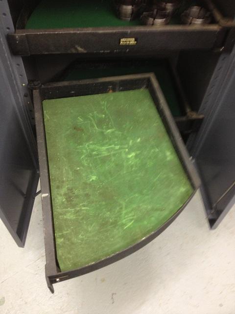

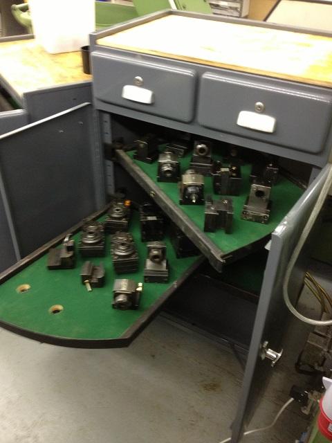

Started fitting out the shelves for tooling for the Traub CNC Lathe.
First - I used up two shelves for the static and powered tooling for the tool turret:

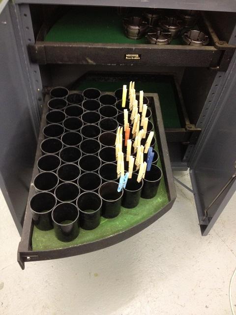

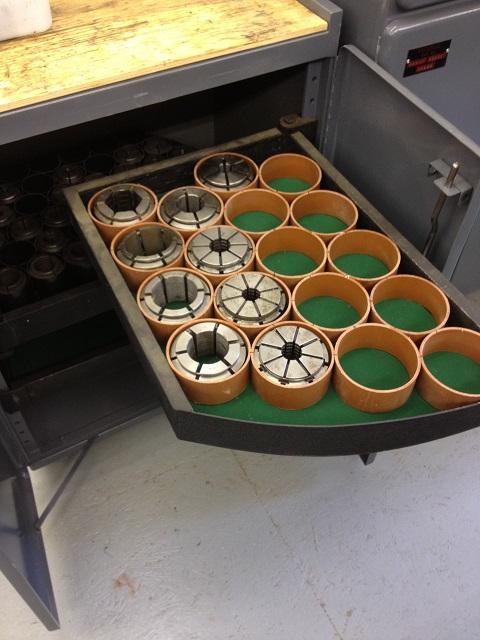

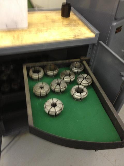

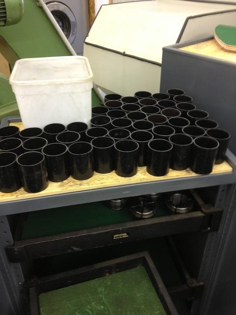

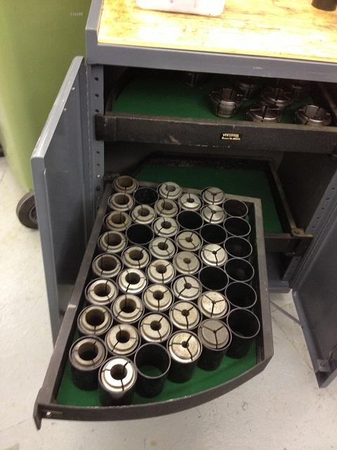

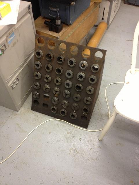

Then I had to think how to store the collets. Two types, one type for the main spindle, and these for the opposing spindle:
  • Posts: 9126
« Reply #29 on: July 28, 2013, 10:58:25 AM »
If I were to bore the shelves to fit, the set would not fit on one shelf without being too weak as the holes would be too close together. Not nice to just sit them there and clang together, so I hit on the idea of making a honeycomb of sleeves.
Gutter downpipe plastic tubing was just about the right size:
  • Posts: 9126
« Reply #30 on: July 28, 2013, 10:59:36 AM »

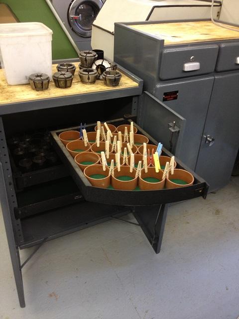

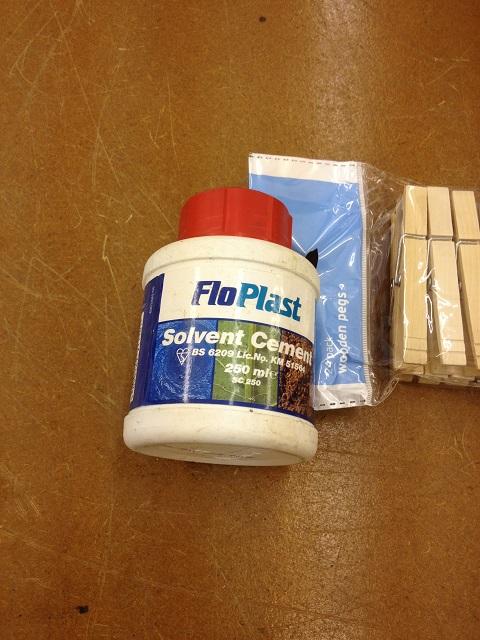

I decided to glue the pipe sections using solvent weld glue, so best to put in one of the old shelves first as the glue is bound to drip everywhere:

To keep the pipe sections firmly together I used domestic clothes pegs - it'll be ok dear they won't get messed up :)
Yikes send for a Gypsy - I'm running out of clothes pegs!
  • Posts: 9126
« Reply #33 on: July 28, 2013, 11:05:24 AM »

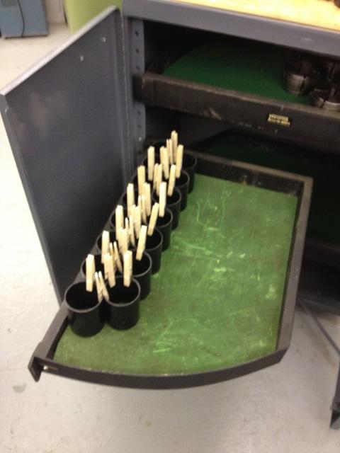

I ended up 'walking' the pegs across the honeycomb - fortunately the glue sets pretty quickly in the current hot weather.
I was fearful that the glue would soak into the baize of the old shelf and stick fast - luckily it didn't
  • Posts: 9126
« Reply #34 on: July 28, 2013, 11:06:26 AM »
So back goes the new shelf complete with honeycomb and collets

I'm tempted to do something similar with these 'J56' collets from the main spindle. They neatly sit inside a piece of 110mm drain pipe, so I feel another honeycomb coming on!

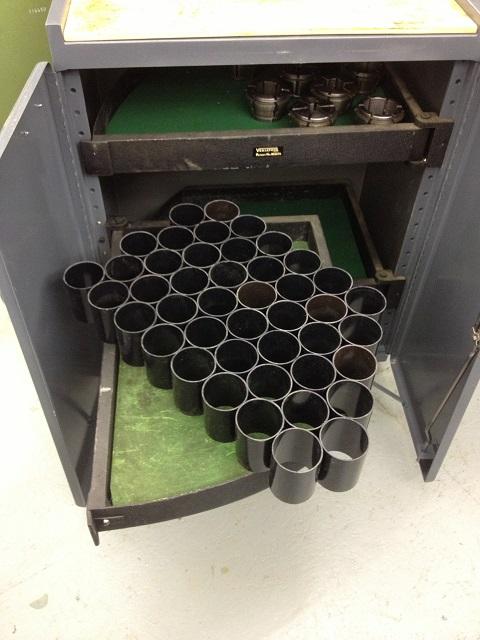

Well I bowed to the inevitable and made up another honeycomb for the bigger collets. This time made from 110mm soil pipe. I only had the brown underground variety - black above ground would have been better but not worth the £10 to buy a length.

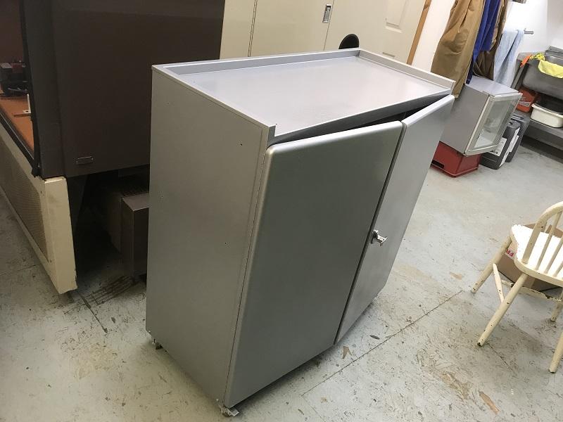

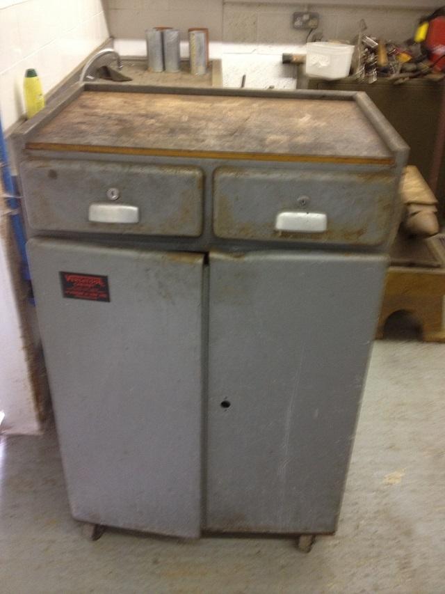

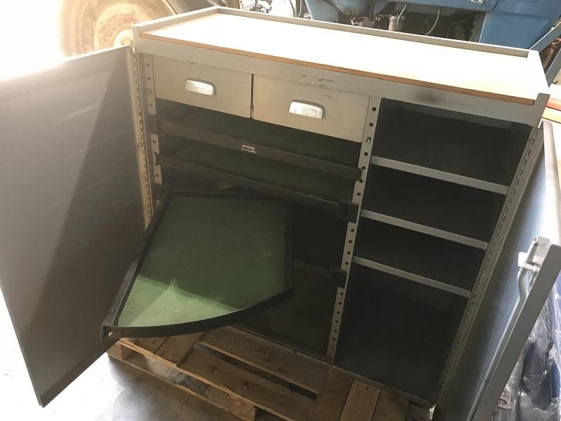

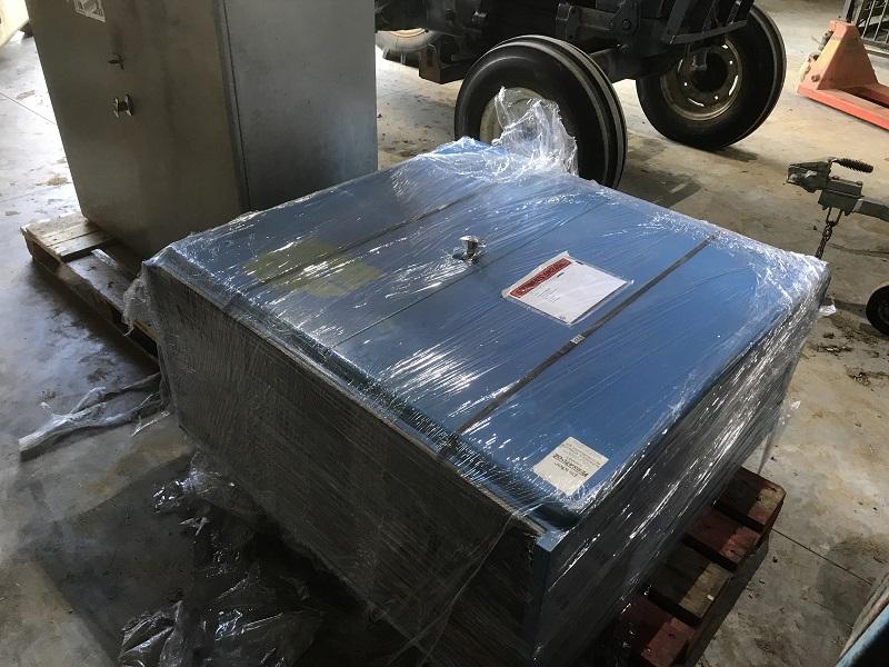

Resurrecting an old thread here, but it's the best place to put the info !
The cabinets described above were refurbished to house the tooling for the Traub CNC lathe that I had, but when it was sold, stupidly I let the cabinets go with it. Now I'm at the stage with the Beaver TC-20 CNC lathe that I need somewhere for it's tooling so went looking for more.
It seems that since then they have become 'trendy' with the yuppies that want bits of old iron in their kitchens - yes they are being used as kitch  kitchen cabinets would you believe  :bugeye:
So the price has gone through the roof, but I did manage to get a matching pair from opposite ends of the country. These ones are rather nice in that as well as the swinging shelves and a pair of drawers, there are also some handy 'normal' shelves.
I'm not sure if these will be blasted and re-sprayed as they are not in as bad condition as the others, and anyway the weather is not suitable probably until the spring. But I do want to make them movable. Previous ones sat on a frame with castors but I want to build the castors directly in. Problem is that the base is flanged, with a 25mm recess.

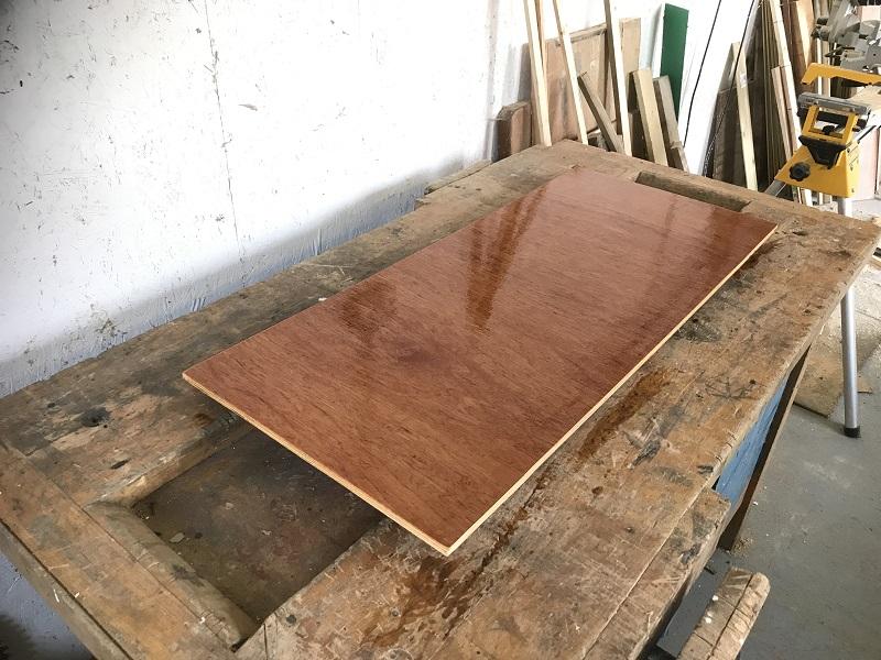

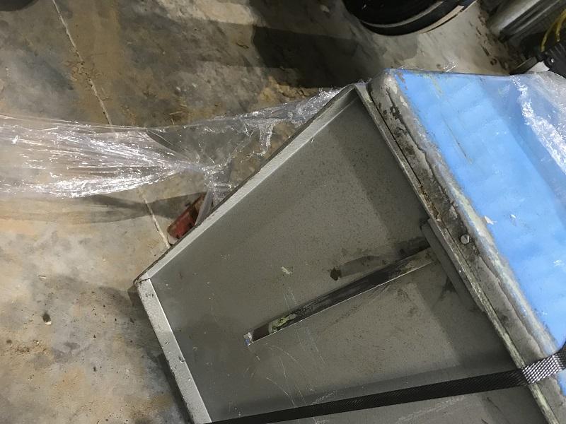

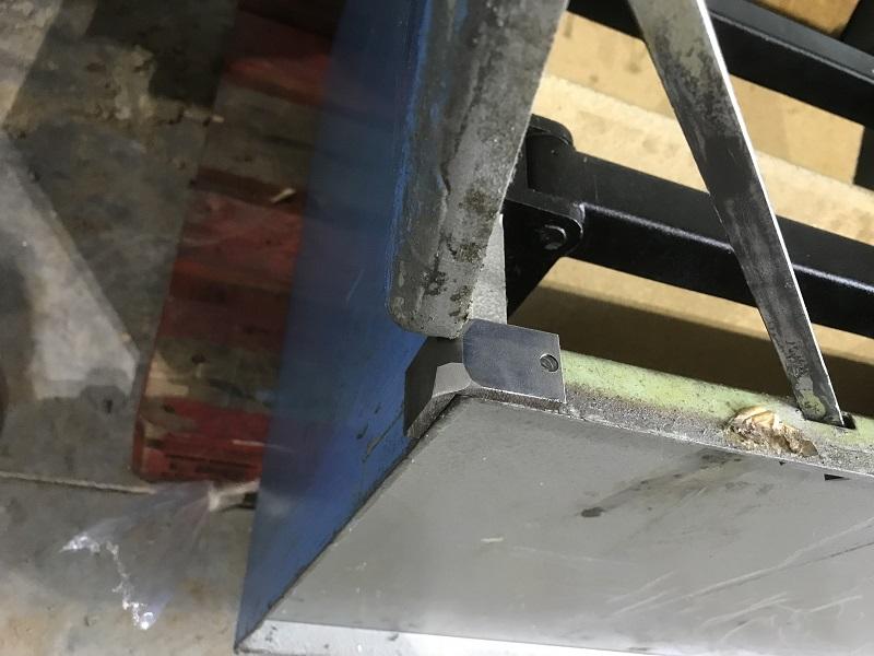

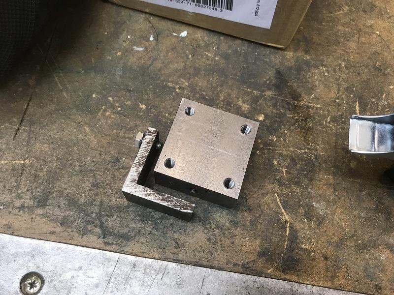

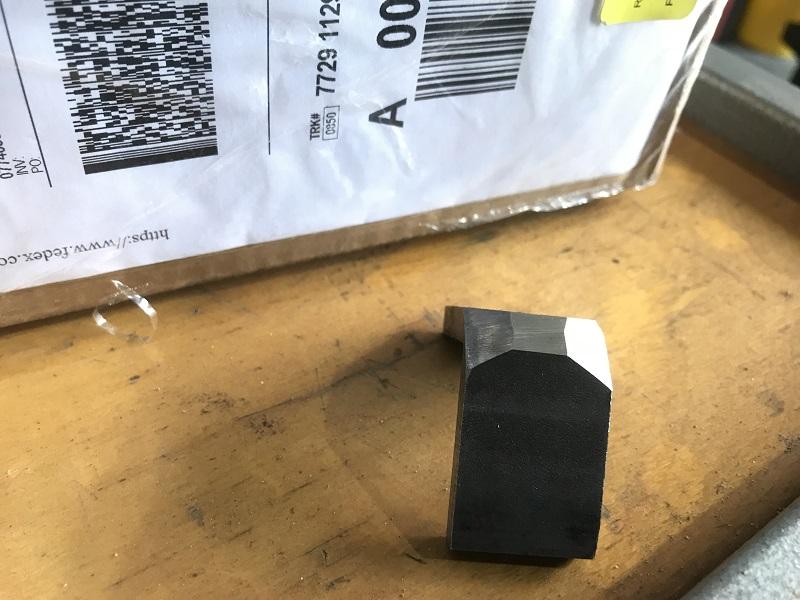

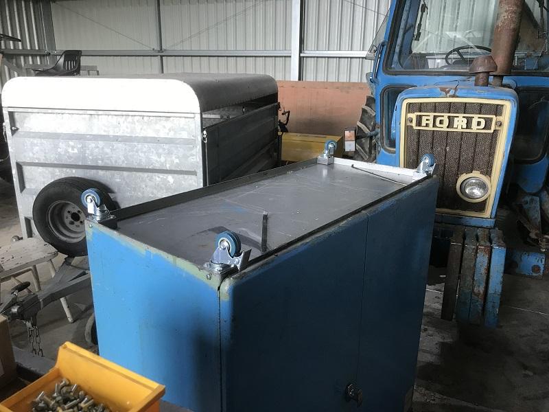

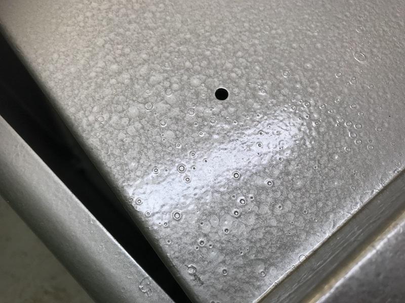

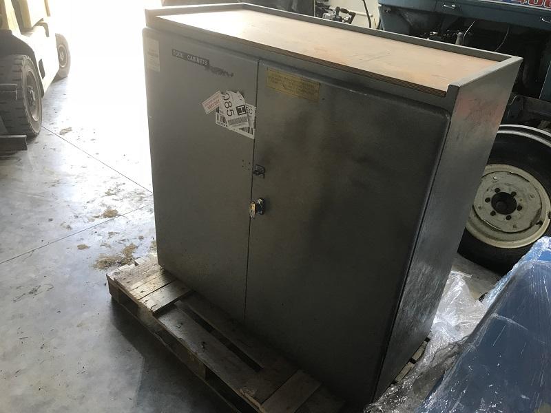

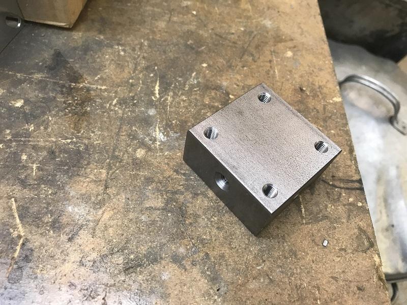

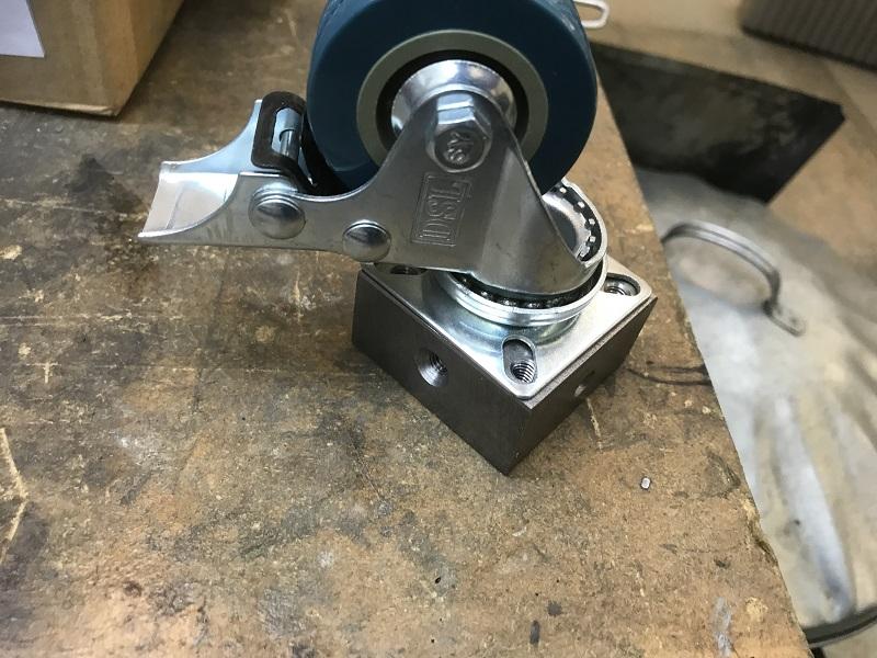

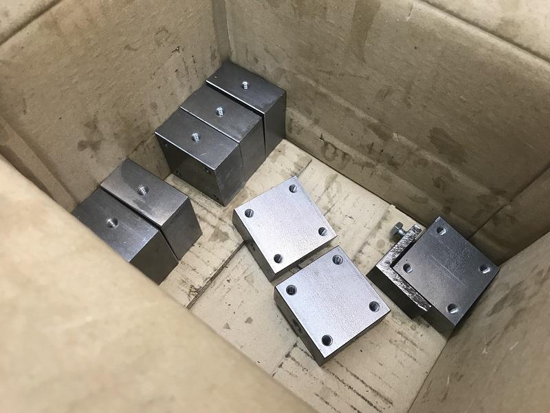

Now the cabinets are stout affairs with thick metal to the sides and base. I decided to make raising blocks to sit the castors on, with the weight being taken by bolts into the frame, and also by the blocks being in contact with the base.
A bit of suitable 50 mm x 25 mm bar in EN3a was ordered up, and being now to hand I cut 8 off 50 x 50 x 25 chunks and programmed the Beaver Partsmaster to spot drill, drill, and tap the 6 x 8 = 48 M6 holes to take the castors and fix the blocks to the cabinets. All went to plan, finishing yesterday evening.
This morning I made up a little drilling jig to align the mounting holes and set too on the first cabinet. The jig needed a chunk grinding off to clear the doors in use, but it all went pretty well. Heavy old lumps - I'm waiting for a friend to arrive shortly to help me turn the second one over - but one is done.
« Last Edit: October 31, 2018, 12:36:22 PM by awemawson »

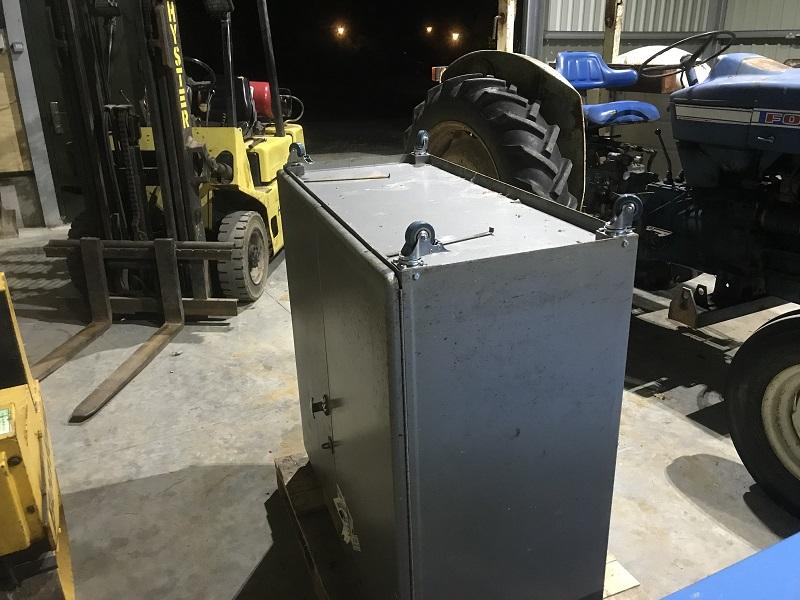

  • Posts: 9126
« Reply #43 on: October 31, 2018, 03:05:53 PM »

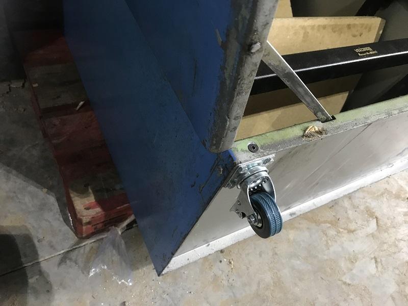

Derek came and helped invert the second cabinet at lunch time, and as I got a bit of time before supper I managed to 'casterate' it.
Just need to decide how to get them back on their feet and into the workshop.

I see a forklift nearby...
Russ
  • Posts: 9126
« Reply #45 on: October 31, 2018, 06:14:53 PM »
It'll certainly help, but actually rotating it isn't quite as straightforwards as you might think - nowt to hold on to. I do have some powerful lifting magnets that might help tilting it but although it's thick I'm not sure that that panelling has enough meat for all the magnetic flux to be useful.
Offline seadog
  • Posts: 223
  • NE London
« Reply #46 on: October 31, 2018, 06:23:26 PM »
You could put a piece of thick plate on the inside.
Offline nrml
  • Posts: 262
« Reply #47 on: November 01, 2018, 01:49:51 AM »
Putting vintage steel cabinets on wheels is just going to increase its yuppie appeal. Better hide them deep in your workshop, well away from prying eyes.

At long last I have got round to sorting out the second Versatool cabinet for the Beaver TC20 CNC Lathe tooling and documentation.
Of the pair that I bought, one was in fair condition just needing a bit of cleaning up, but the second one had been painted blue over it's original silver hammer finish, and was rather tatty and scratched.
Firstly I gave it a really good clean up with 'Mr Muscle' to get rid of the oil and examine the over paint. I decided that if it was given a very good rubbing down with 'wet and dry' paper and soapy water it could stand another coat of silver hammer finish without the complete grit blasting that I had initially planned for it. This was slightly influenced by the fact that the weather still isn't good enough for outdoor grit blasting.
Saturday morning was very cold, but bright and sunny with no rain forecast, so the cabinet was wheeled out side, given a wipe down with a rag soaked in Industrial Thinners, and a coat of hammer finish paint applied. Note that this is NOT 'Hammerite', which since they changed the formulation I don't find any use at all. It is an industrial Xylene containing tough rough equivalent of the original Hammerite formulation.
I'd just about finished when the heavens opened  :bang: Not rain but heavy hail  :bang: Nothing for it but to leave it to it's fate. Needless to say there was rather more hammer effect than intended, and the doors were a real mess as they were the last bit I'd sprayed before the hail.
Fortunately this is very fast drying paint, and yesterday afternoon I was able to give it another vigorous rubbing down with wet and dry and get back to an acceptable finish for another coat of paint.
16:30 and the sun was shinning brightly, so out it came for another coat. Doors done first this time - I'd just finished then decided to blow over it's top - it didn't need painting as it is over lain by a 12 mm plywood insert, but I did ! Silly boy - just finished and, you guessed it, rain - only light this time but still rain. I gingerly wheeled it back into the workshop to dry off, and apart from a few blemishes to the top surface, and a very little bit to the door tops where they got a bit of over spray, I'm passing it out as acceptable.
« Last Edit: April 14, 2019, 09:36:18 AM by awemawson »
  • Posts: 9126

So this morning (Sunday) I was down at the local B&Q collecting a suitable bit of 12 mm plywood. Literally half the weight of the original and the grain running the wrong way, but it's all that there was.
It's been cut to size and had it's first coat of yacht varnish - it will certainly get one more coat and likely a third over the next few days - in contrast the original looks extremely tatty !
« Last Edit: May 08, 2019, 11:35:23 AM by awemawson »

What is this "industrial Hammerite" of which you speak, and where may one obtain it? I share your opinion of the new stuff, it's crap, but I have a couple of machines I want to refinish in their original (or as near as) colours, a Taiwan but good 14" bandsaw, and a Qualters and Smith hacksaw, both in light green hammer finish, which is not part of the "new" hammerite range! swapping an excellent product for a reduced range inferior product is not progress! It is now an Akzo Nobel Product, and I see they are also selling Kurust, which used to be a Kingston paints (Hull) product. Ho hum.

While waiting for varnish to dry . . . YAWN . . . I started playing with Inkscape the graphics program. It is amazingly versatile but I find it's human interface rather clunky and non-intuitive.
Casting about for something to experiment with I thought - why not try and copy one of the silver foil labels that originally adorned the doors of these Versatool cabinets.
So, taking a photograph of the one surviving label, and much assistance from YouTube I cleaned up the image, dropped the back ground, adjusted the inevitable distortion and then set the size to that of the original. Then (more YouTube!) surrounded it by a box with rounded corners as cutting guides, and created a full page with four copies evenly distributed - four being the maximum I could get on an A4 sheet.
Success so far, as it printed on paper very nicely, but the original was on 'silver' foil - what's available. Once again eBay came up trumps with full A4 self adhesive laser printable silver foil stock with a fast delivery at a reasonable price. It arrived this morning, and a quick bit of setting up produced four nice labels cut from the sheet by careful application of a scalpel.
The foil print was quite ruckled as it came out of the printer, but the labels flatten down OK when applied.
(I confess that the second label applied to the right hand door was to cover a paint blemish  :palm: )
Altogether quite pleasing.

Then finally, now the varnish is dry, the counter top was replaced

Very good job. They look like new.
I have a question about this style of cabinet: How do this style swing out design compare in practical terms with modern drawer type tool chests?
There are some obivious differences like, in theoriy you could fit more light weigh stuff on drawers and swing out design is mechanically simple....but it real world use? What is the deal?
There is no question which one looks better and traditional.

Pekka the advantage of the swing out style to me is that they are designed so that tools with shanks can stand upright retained by holes. The frame of the quadrant is stout steel but the quadrant itself is a wooden insert intended to be bored to suit.

This is the Versatool arrangement

Thanks for the Paint link Andrew, after one look I lost all self control and ordered 5 litres of light green! Don't tell John Doubleboost, but there is going to be a lot of green machinery in my shop! Are you thinning it with universal, cellulose, or a special thinner? looked on the site, but could find a mention of it.
  • Posts: 9126
« Reply #66 on: April 22, 2019, 09:27:34 AM »
Phil I dilute with about 10% of 'Industrial Thinners' and it seems work out OK !
I believe that these thinners are xylene based.
