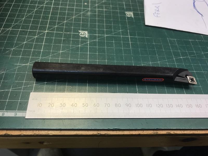

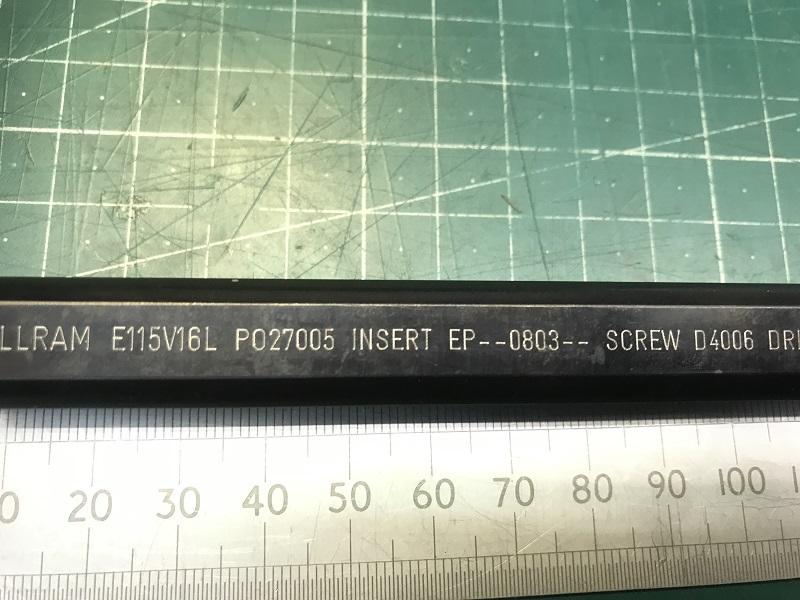

I have a lovely 16 mm carbide boring bar with through coolant - a STELLRAM E115V16L that takes "EP--0803--" inserts but I cannot trace a source.
So if anyone has any knowledge as to where some may be lurking please say.
They are VERY similar to a CCMT080308 except that the retaining hole is larger on the Stellram at 4.2 mm (as opposed to 3.2 mm)
Stellram, who were in Melksham in Wiltshire, seem to have vanished off the face of the earth, their phone numbers aren't answered and their web site doesn't respond so I expect that they've been gobbled up by another manufacturer  :scratch:
. . . any help would be appreciated

Andrew,
Stellram's parent company is Kennametal - might be worth contacting them.
Are you sure it's similar to a CCMT.
I have some Stellram inserts and they're not 80 degrees but 73 degrees.
Mine have a part number EPMT08M304E-73
Most Stellram are 75 degrees.

« Reply #2 on: March 21, 2019, 11:09:14 AM »
Thanks Phil that helps a lot. I've managed to track down some in a carbide grade suitable for aluminium alloys ("GH1" grade) using that document but grades suitable for steels at the moment is eluding me.
By heck inserts are a minefield with different specs on not only geometry but carbide grades all expressed in different ways  :bang:
