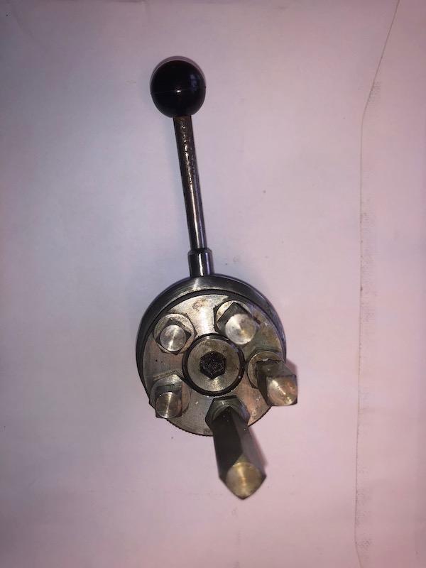

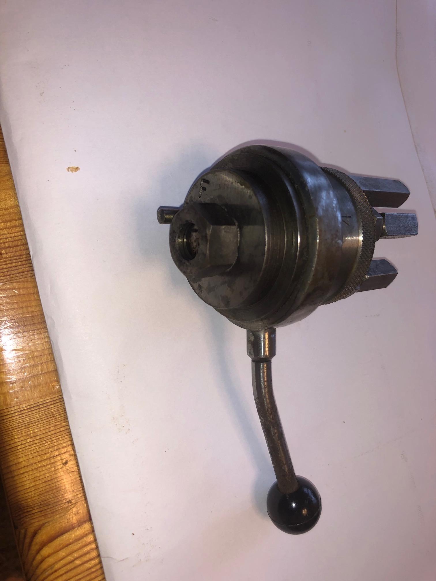

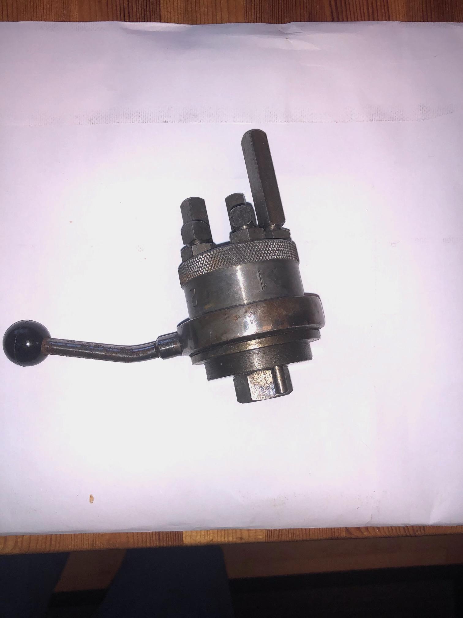

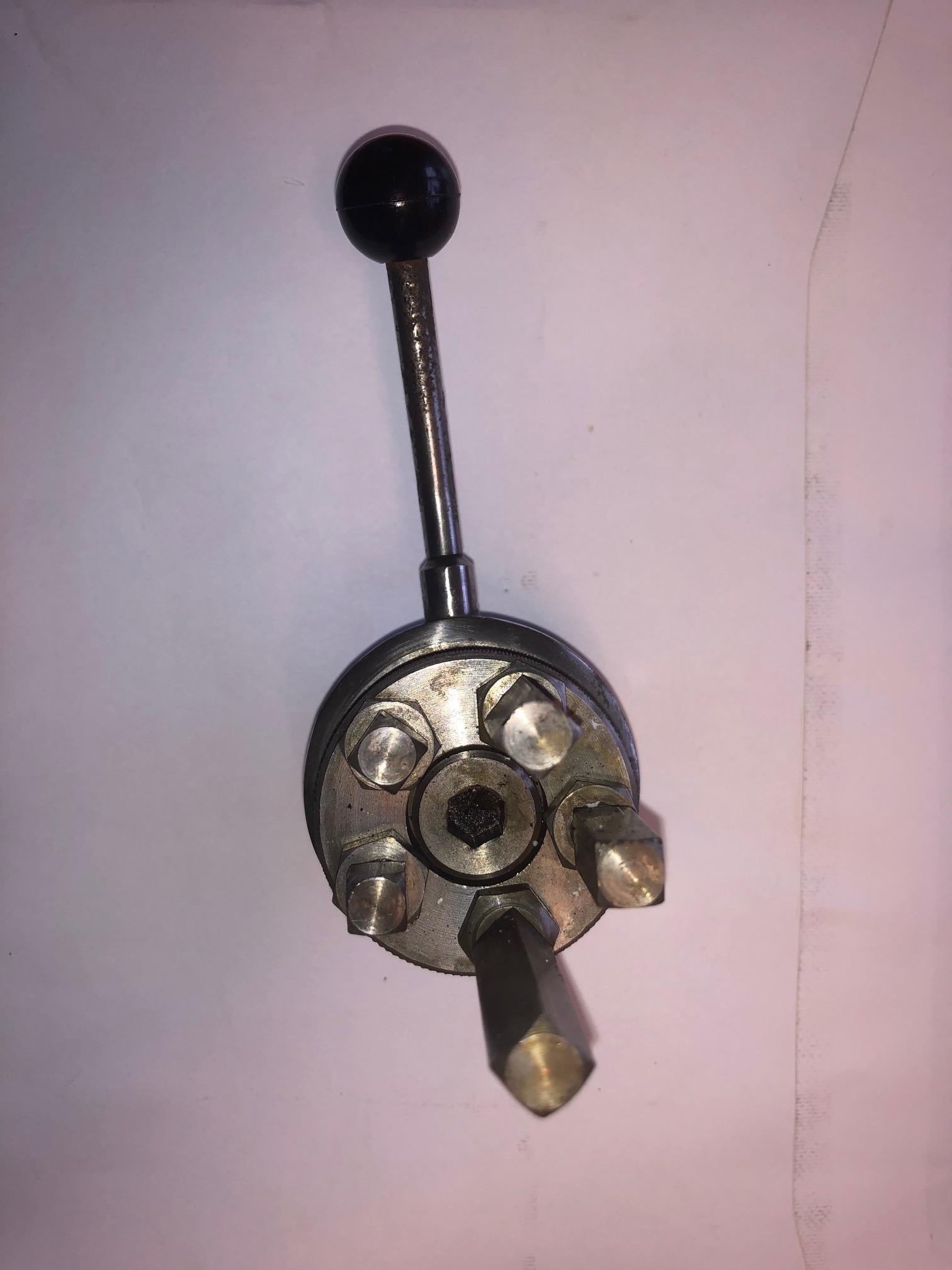

Hi I bought this carriage stop recently with a view to fitting on the bed of my Raglan 5 inch lathe which has "knock off" on the saddle.
I think this component is really designed to be part of the saddle on whatever lathe it belongs, I think it may be for a Colchester but unsure.
I bought it because it was there, I think it is new as it had protective grease on it.
As the peg on my saddle is very short it will not reach the lower stops and the peg is flush when pressed in it would need an intermediate part to work.
So can anybody clarify what make and model it fits, if it goes on the saddle and any other comments please.
I apologise if pictures are wrong size
Regards Phil

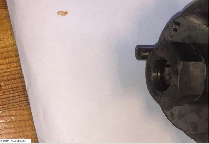

As an example here is a 'screen grab' of your last picture as displayed:

This is a test let me know if it is ok Phil

It looks like it mounts on a bracket at the hex end , on the clubs Mk1 Little John there is a bracket on the bed below the headstock with a 3/8" rod , this may be an after market mod .
Re: Lathe Carriage Stop
« Reply #14 on: December 18, 2018, 12:22:14 PM »
On the one that I had on a Colchester Student a few eons ago, the side of the apron was tapped 1/2" UNC, and the stop bolted onto it directly. But it had a 'keeper nut' on it to stop it falling apart in storage. Are you sure that your hex doesn't just unscrew and the male bit mount the device?
The spring loaded ball bearing makes it fun fitting :)
Do you have the other half of the device that mounts on the bed?
Offline appletree
  • Posts: 202
« Reply #15 on: December 18, 2018, 12:44:26 PM »
Hi Andrew
The nut on mine is holding everything together, I have a feeling something probably wants to leap out from inside.
There is a loose pin on the mounting face and 2 pin holes marked L and R, I imagined this unit "interacted" with and tripped the saddle drive, but from your comments it's perhaps nothing more than an indexable set of stops that mount on the saddle, and a bed stop.
Rather than the other way round where the indexible bit is on the bed.
And no I do not have the bit that mounts on the bed, come to that I don't have the lathe either, It was just one of those useful looking bits that followed me home.

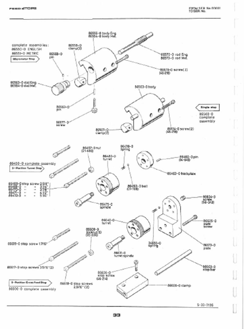

This may help
