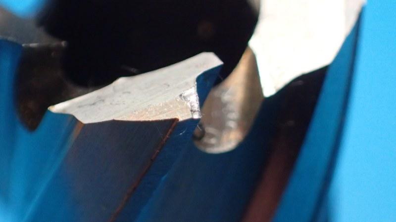

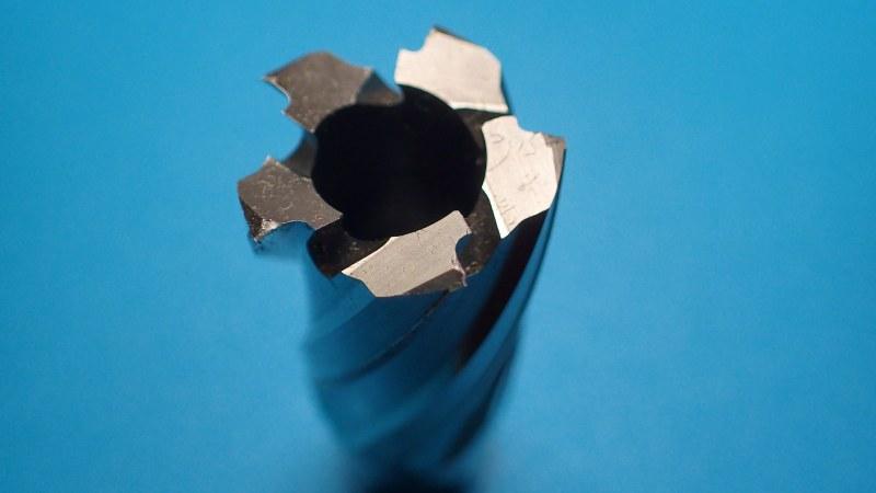

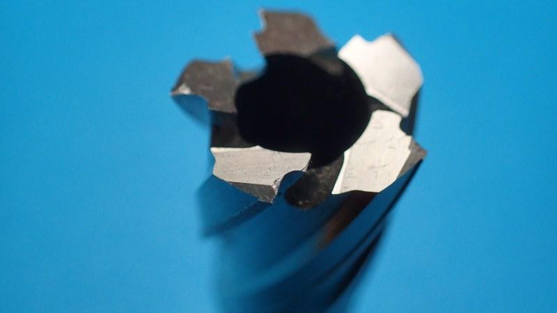

My most used Rotabroach is dull.....
Is there easy way to sharpen them?
I have TCG and magnetic table, but not really right spindle ar anything to mount 3/4" weldon shank rotabroach.

I used to get mine professional resharpened but they were never as good as a new one .
For some time I think it has been cheaper to buy new cutters  . Resharpening costs about £5 per cutter and a new 14mm cutter costs us about £8
The problem with resharpened cutters is that unless they are done correctly and that requires 5 separate operations per tooth they lose there self centering ability and  can skate on the work before they bite ,the other problem is swarf remova lwhich is also caused by bad sharpening .
If the swarf goes in between the cutter  and bit left in the middle it will cause the cutter to jam and more than likely break , this is often cause by incorrect resharpening.This can in turn cause a problem in getting broken pieces of cutter out of the hole
If correctly cared for the cutters will do lots of work, over the years I have drilled thousands of holes and only now use new cutters

The no of grinding operations depends on how badly damaged the cutter is .It might be possible to grind across the front of the tooth ,but if you look at your cutter you will see that the cutting edge is staggered, this is important for the swarf clearance and centering of the cutter so you would also have to grind the lands of the cutter
Then the cutter would possible need  backing of which is 2 more operations. So 4 operation not 5 my mistake
That is how it was described to me by a specialist tool and cutter grinding company  .
I have not tried it myself but if anyone wants to have a go I have a large quantity of used cutters. Mike

I noticed that tooths were slightly staggered, but opposite teeth looked symmetrical. Surfaces to touch up looked straight lands (facets?), not that complicated geometrically, but needs pretty controlled and repeatble depth stop (two settings and two angles).
I will not loose much money if I try to sharpen it one day. I ordered exactly same size, and then others fifferent brands, I better check them before and make some notes.
