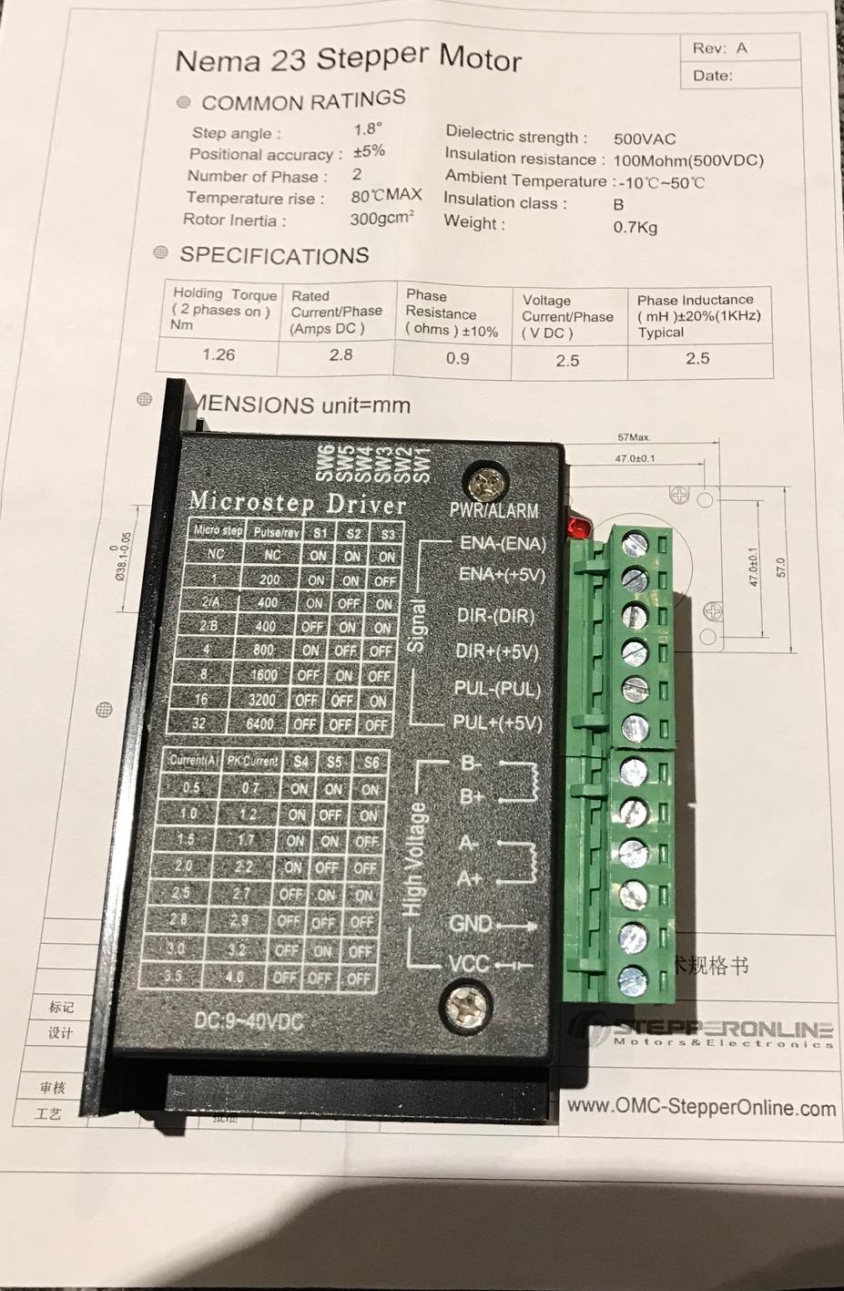

Thanks for this I have just checked the Inductance on the Box says  "Phase Inductance  at 1khz typical is 2.5
so If my poor maths is correct that is 46.16v
With that in Mind ...I just need a Medium speed to traverse quickly when Not cutting and a Very slow speed for when it is cutting. Does that alter anything ?
Also just noticed the driver I bought of Fleecebay is rated at Dc 9-40vdc at max 3.5amps and 4.0 at Pk Current which i guess is at Peak current ?
Please excuse my ignorance within electronics as I know Very little and am trying my hardest to grasp a small slither of what many folk know lots.
If you don't succeed ...try try try again...you can't fail trying.
Offline Buell
  • Posts: 77
Re: Power supply for Nema 23 Stepper ?
« Reply #9 on: November 11, 2018, 12:41:54 PM »
Clearly I shouldn't Go over 40vdc at 4amps  as thats all the Driver could handle ?
Offline ddmckee54
  • Posts: 446
« Reply #10 on: November 14, 2018, 11:07:04 AM »
That's right, it's like the weakest link in a chain.
Look at the voltage ratings of all the equipment.  Whatever has the LOWEST maximum rating will be the highest voltage that you use for that entire system.  You can use lower voltage, within reason, and the system will still run - it will just run a little slower.

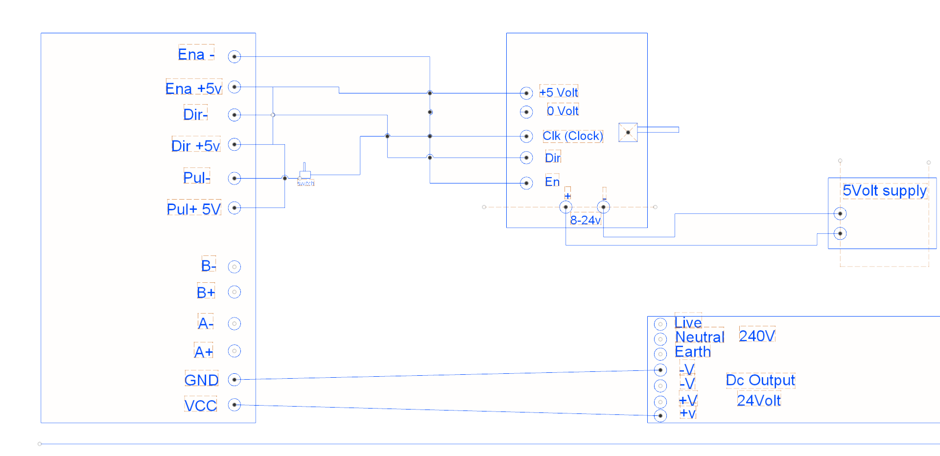

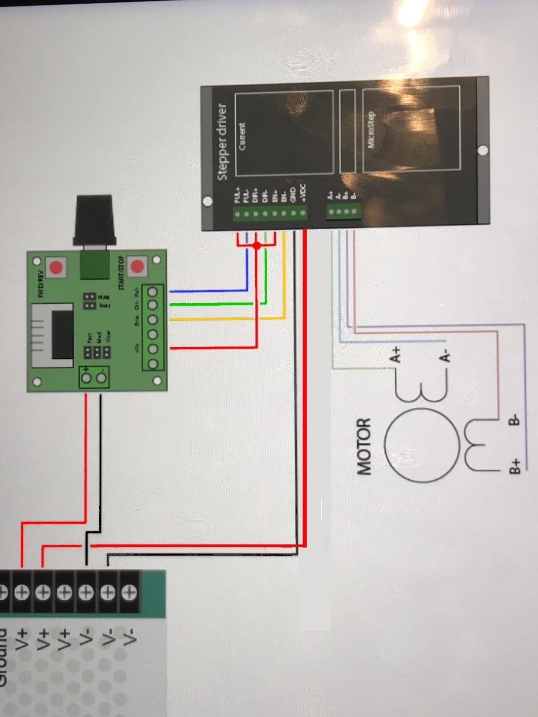

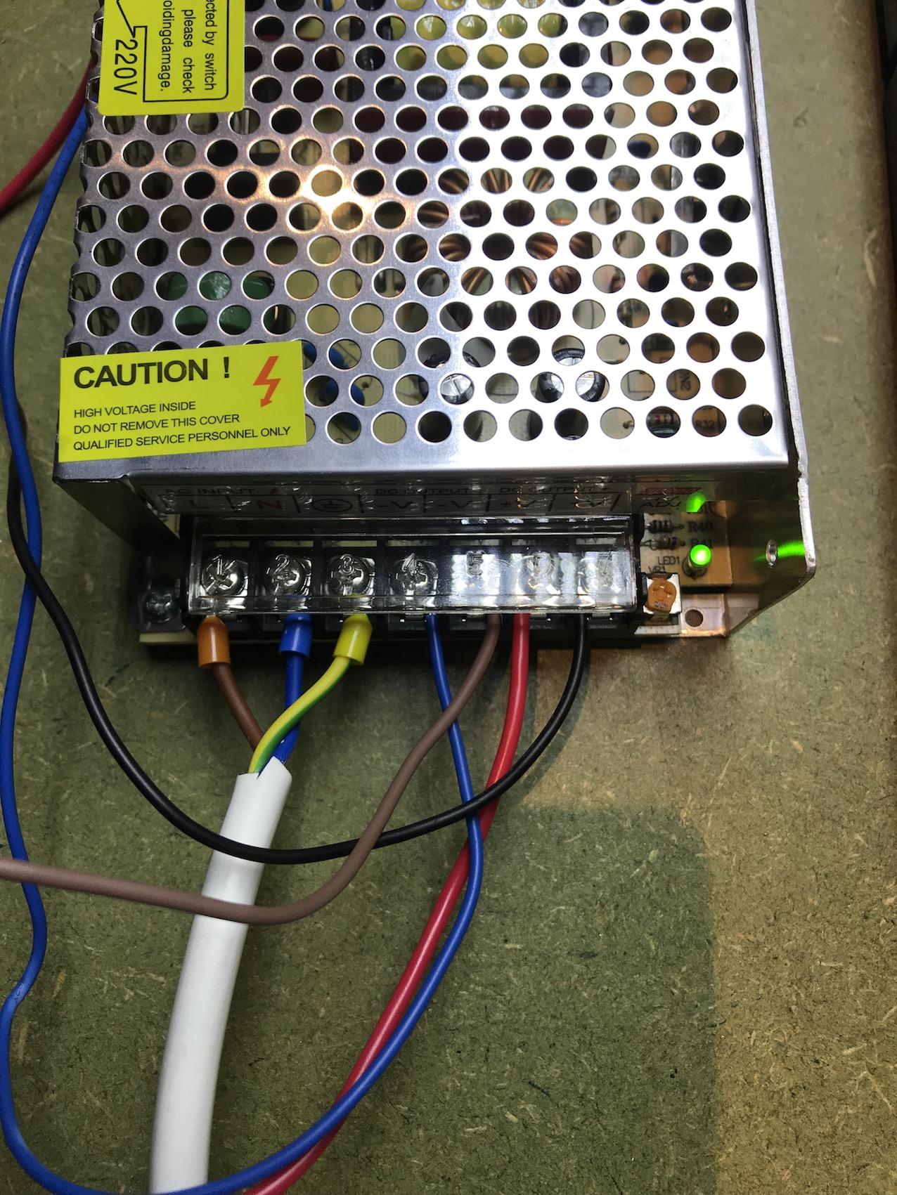

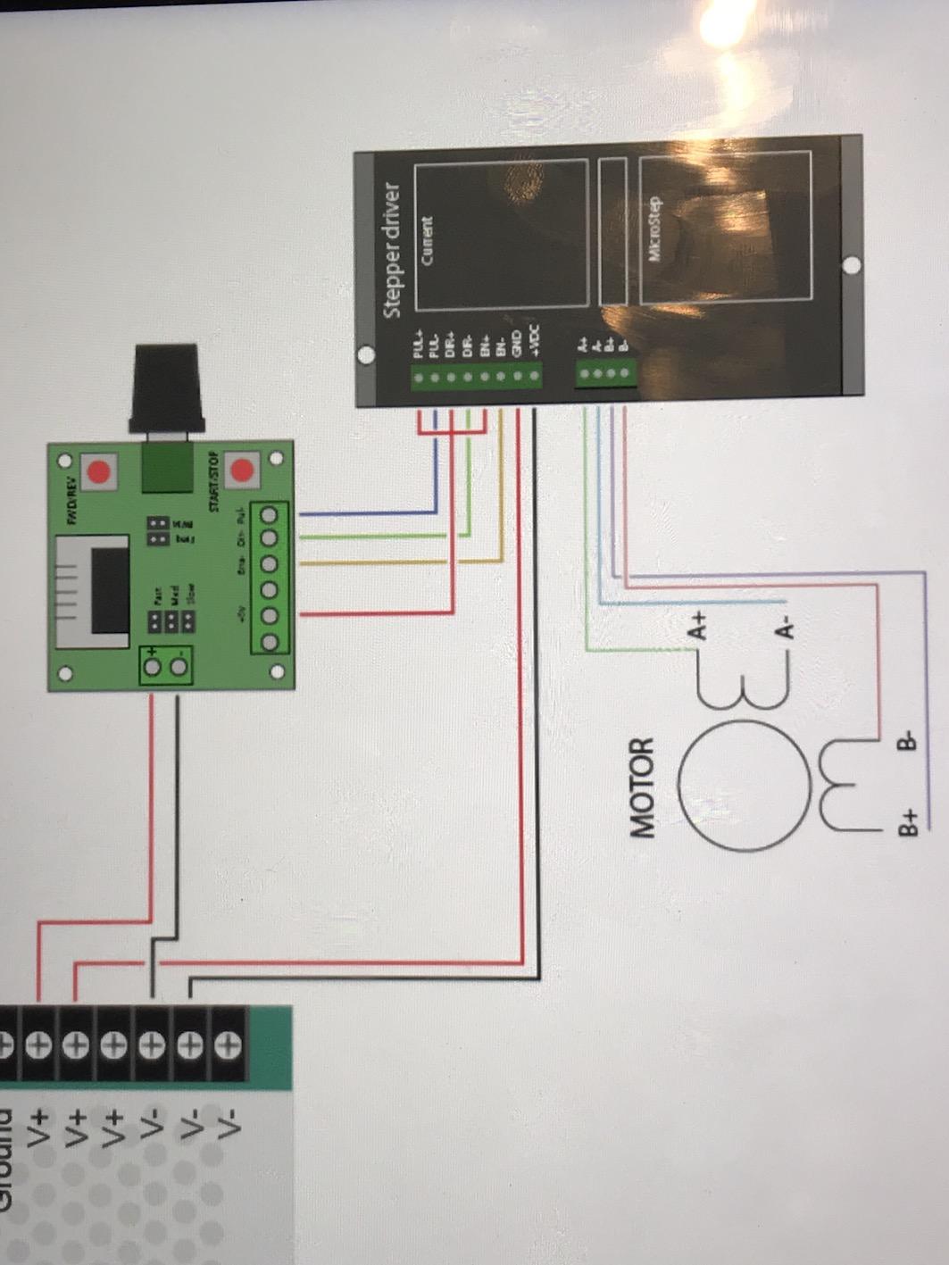

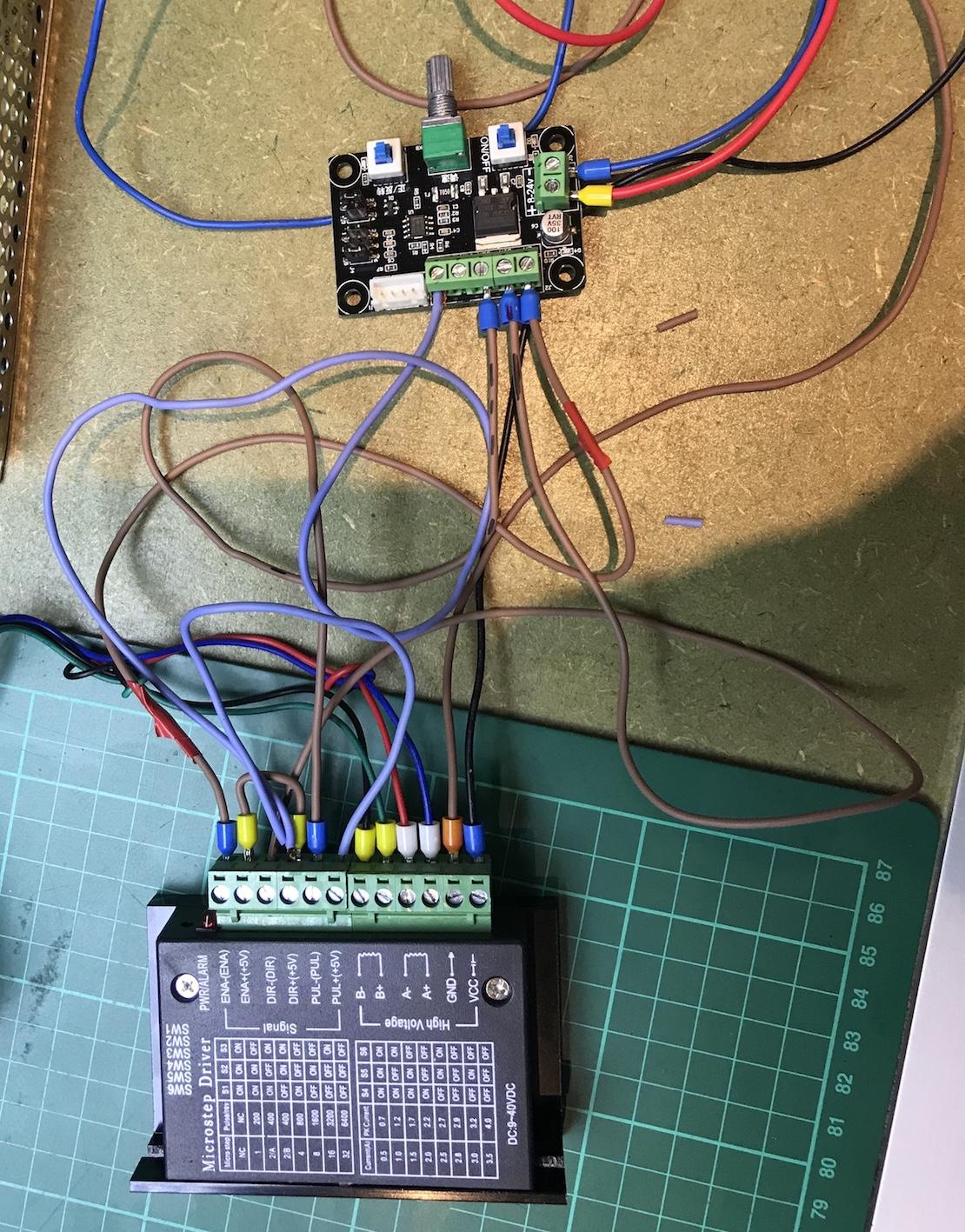

Ok so got a few bits but super struggling with the wiring side made someone could clear the fog..all lights up nothing has gone bang ! but nothing moves or shakes or rattles yet...but locked solid when the power is on. Help
« Reply #12 on: November 29, 2018, 05:46:54 PM »
Hi Buell,
Excuse the crap drawing (I'm not good at drawing with a mouse) but I think you need to connect it something like this:
I would connect the Direction, Enable and Pulse wires to -ve but then you need to common all the +5V terminals together and connect them to 5V. The inputs are usually opto-isolated and you need connections to both -ve & +ve.
Offline Buell
  • Posts: 77
« Reply #13 on: November 29, 2018, 06:04:07 PM »

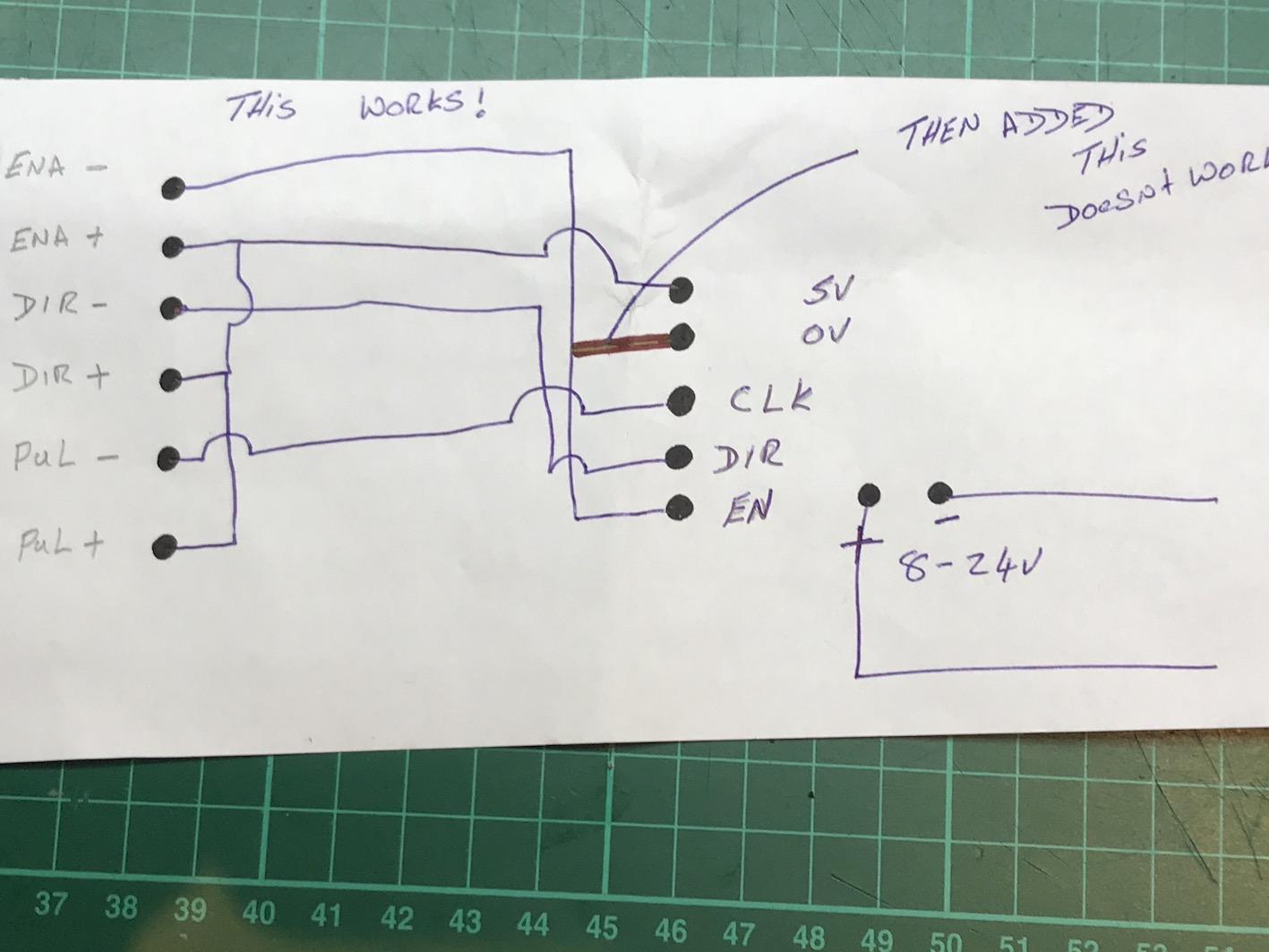

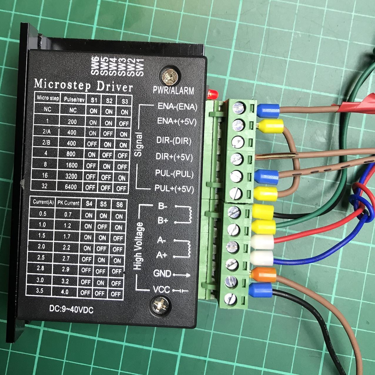

Thanks for that...finally found something online...turns out its ...
PUL+DIR+ ENA+ all together to the last terminal on the controller ..have no idea what that is as its in chinesium.
PUL - to CLK
DIR- To DIR
ENA- to  En
so one other question if I had made the worst dogs dinner out of this , is there any damage i could do ? other than mains in and 24v to the wrong terminals ?
Just the beginning for me doing this kind of stuff !
Thanks for the reply this thing works !
Offline John Swift
  • Posts: 344
« Reply #14 on: November 29, 2018, 06:08:10 PM »

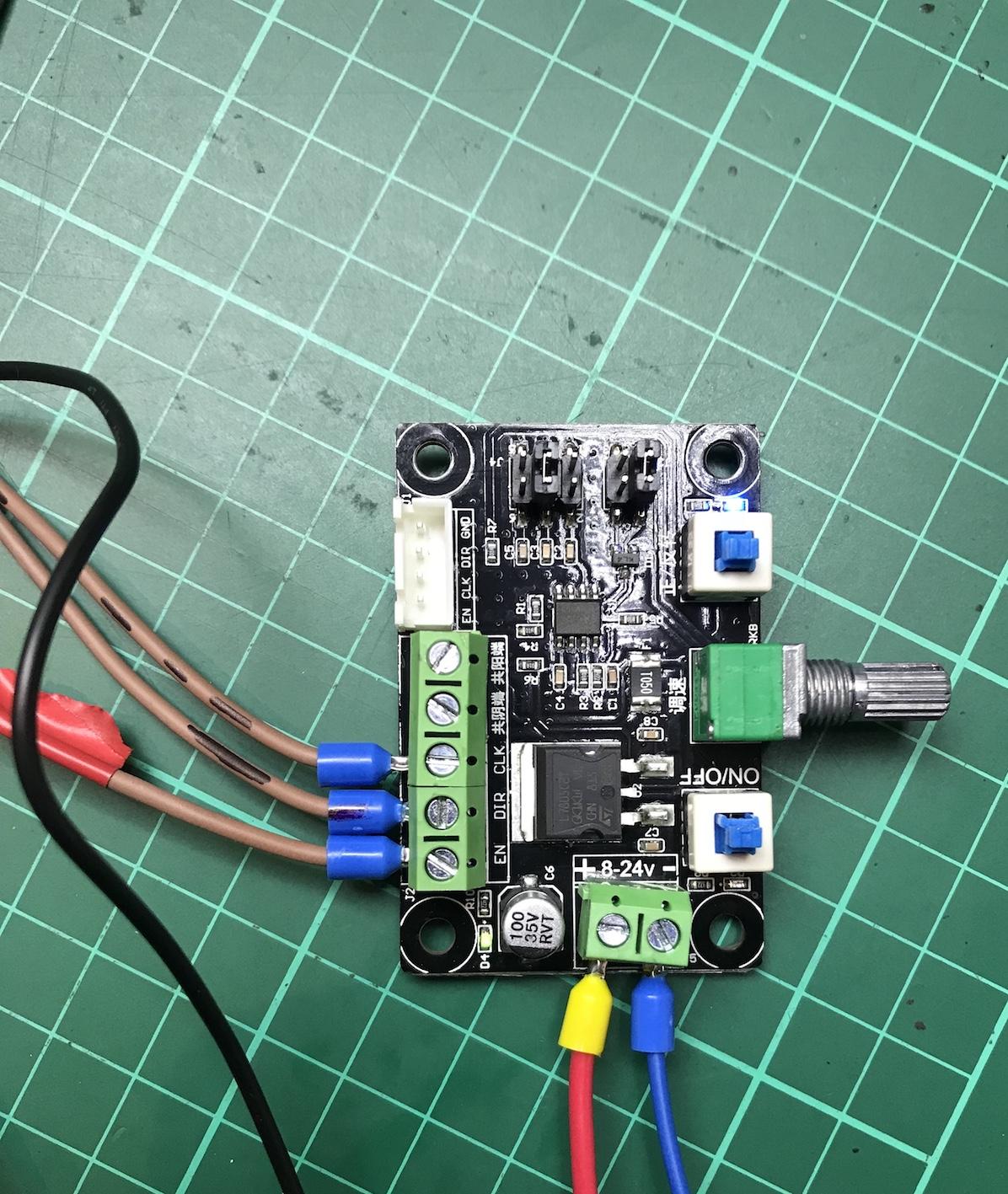

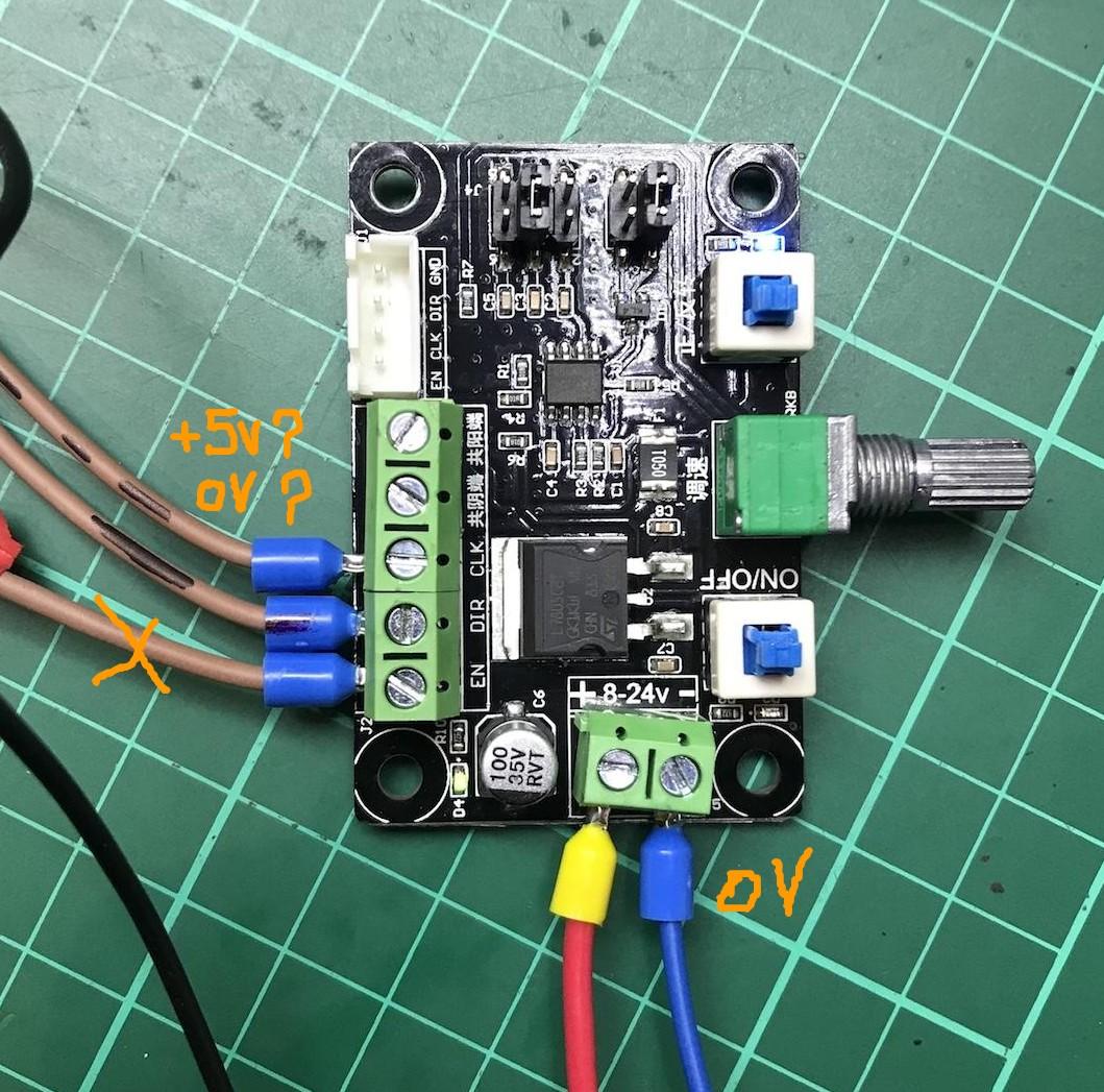

Buell
can you post a link to the instructions for the pulse / direction board ?
I expect the two terminals labled in Chinese are +5V out from the regulator IC
 and the common 0v to the pulse , direction & enable outputs
for your initial test just connect the stepper driver  -pulse to the negative supply terminal
and + pulse to the pulse board pulse output
PS
 do you have a multimeter ?
with the meter set to ohms
you should be able to test for continuity between the negative supply terminal and the two terminals labeled in Chinese
to find out which is the 0V and which is the +5V out

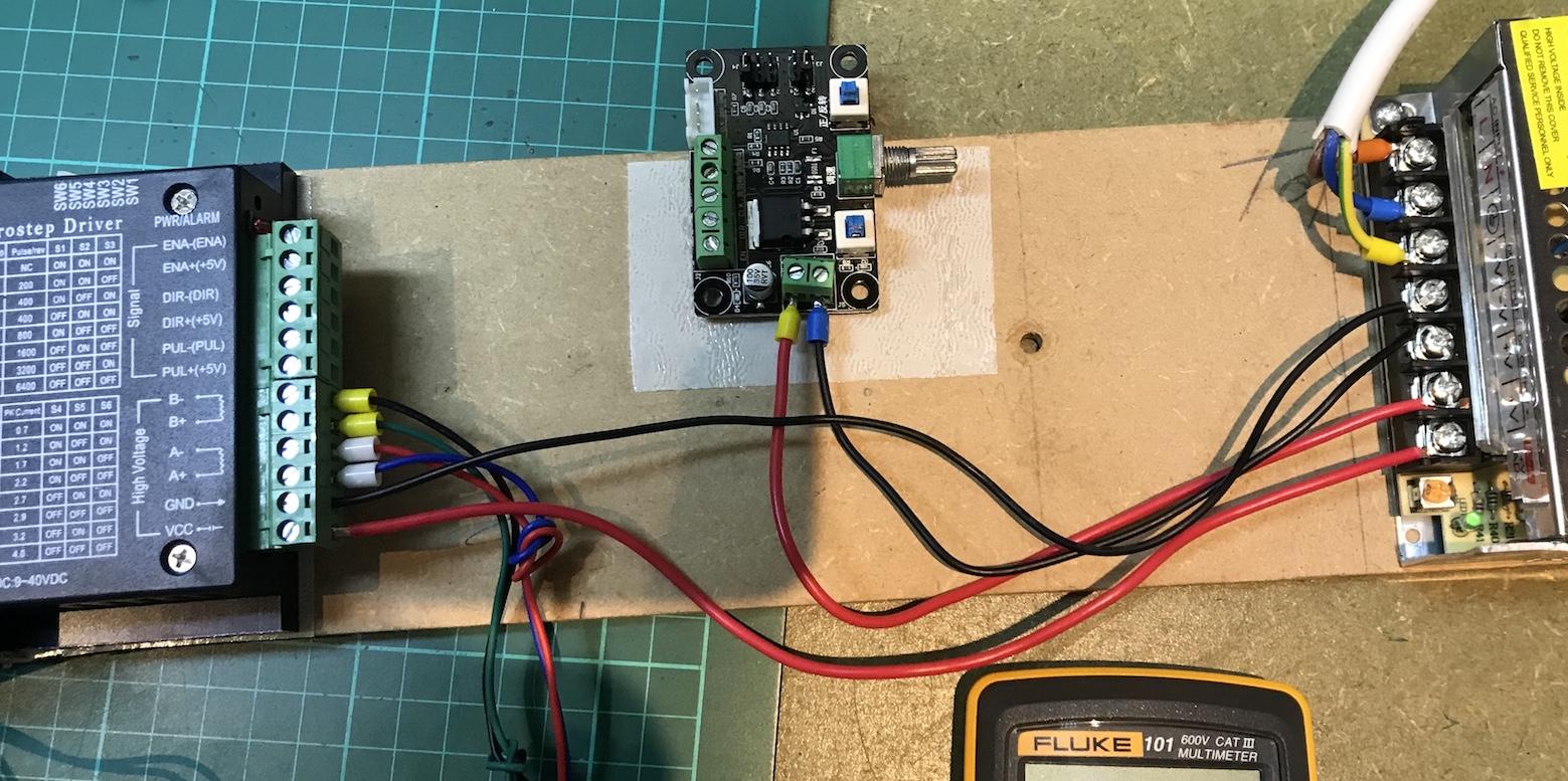

Got it going heres a vid
Hope its ok to post here ?

This is what I ended up with as a visual just In case it didn't make sense. Well it doesn't to me !
Offline Buell
  • Posts: 77
« Reply #17 on: November 29, 2018, 06:59:57 PM »
One draw back to this wiring....It doesn't Lock The motor !! Any ideas  ? I would need it to lock to stop it from moving In the mill.
« Reply #18 on: November 30, 2018, 02:35:56 AM »
Buell,
You'd need to keep the enable input grounded to keep the motor powered to hold it. If your control board doesn't do that just put a switch in the enable line to switch the input to your driver from the control board to 0v.

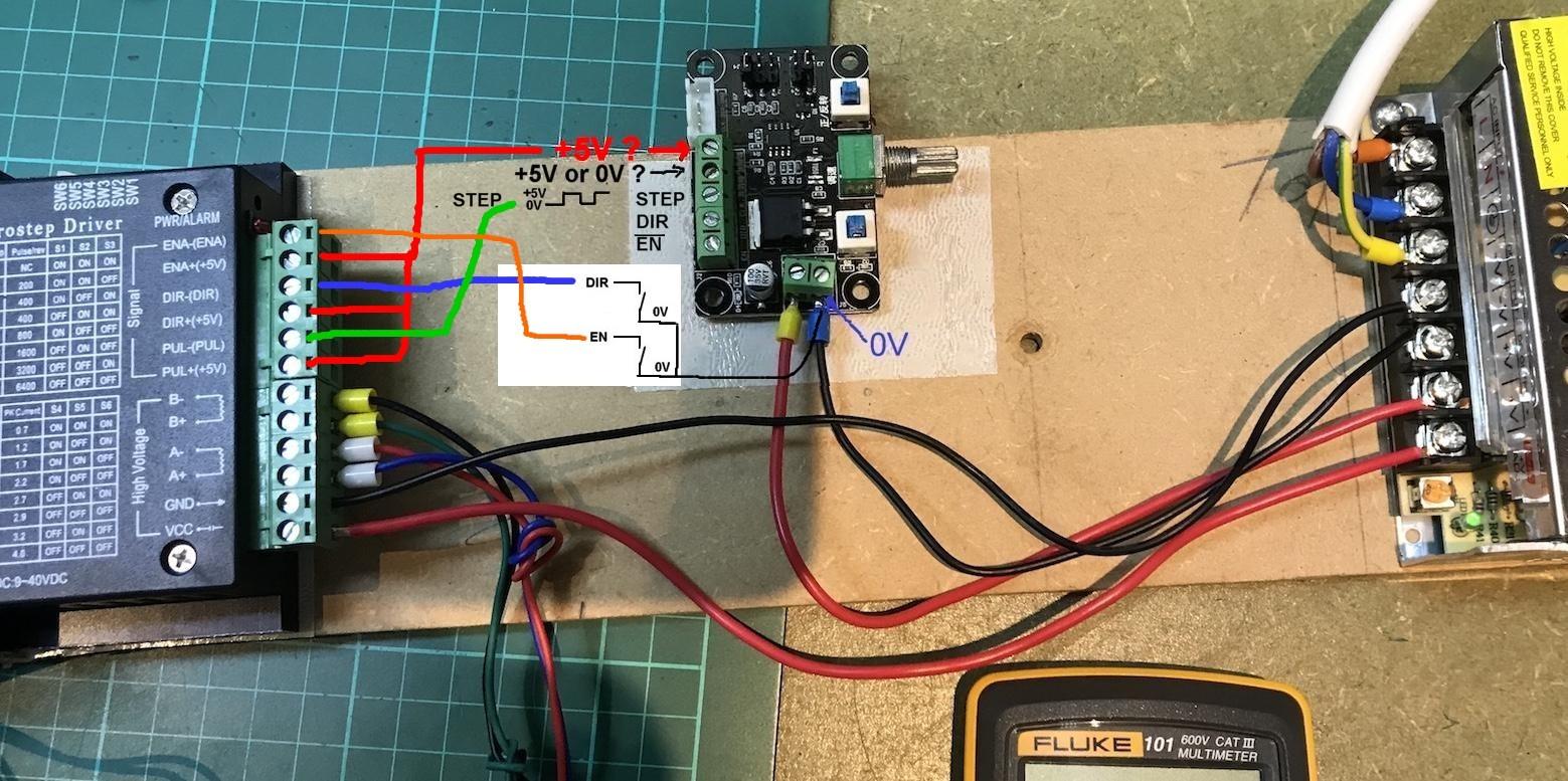

This is how I made a Start..but then realised that the controller thing was not the same ! but seemed a good place to start !
Offline ddmckee54
  • Posts: 446
« Reply #23 on: November 30, 2018, 02:13:42 PM »
Any chance that you could supply us with the manufacturer and model number of the boards that you are using?
I'd hate to see you unintentionally let the magic smoke out of your boards, and with the part numbers we might be able to find the manuals on-line and help you decode their "Chinglish".
From what I can see it looks like your set-up should work, you've got it turning so it's sort of working.  But the people that write the directions are not exactly consistent/knowledgeable regarding their subject.  Sometimes it requires a healthy imagination and a secret decoder ring to make any sense of their manuals.
This could be something as simple as your stepper driver board is looking for a "HIGH" level pulse on its' inputs, while your pulse/direction board is supplying a "LOW" level pulse.

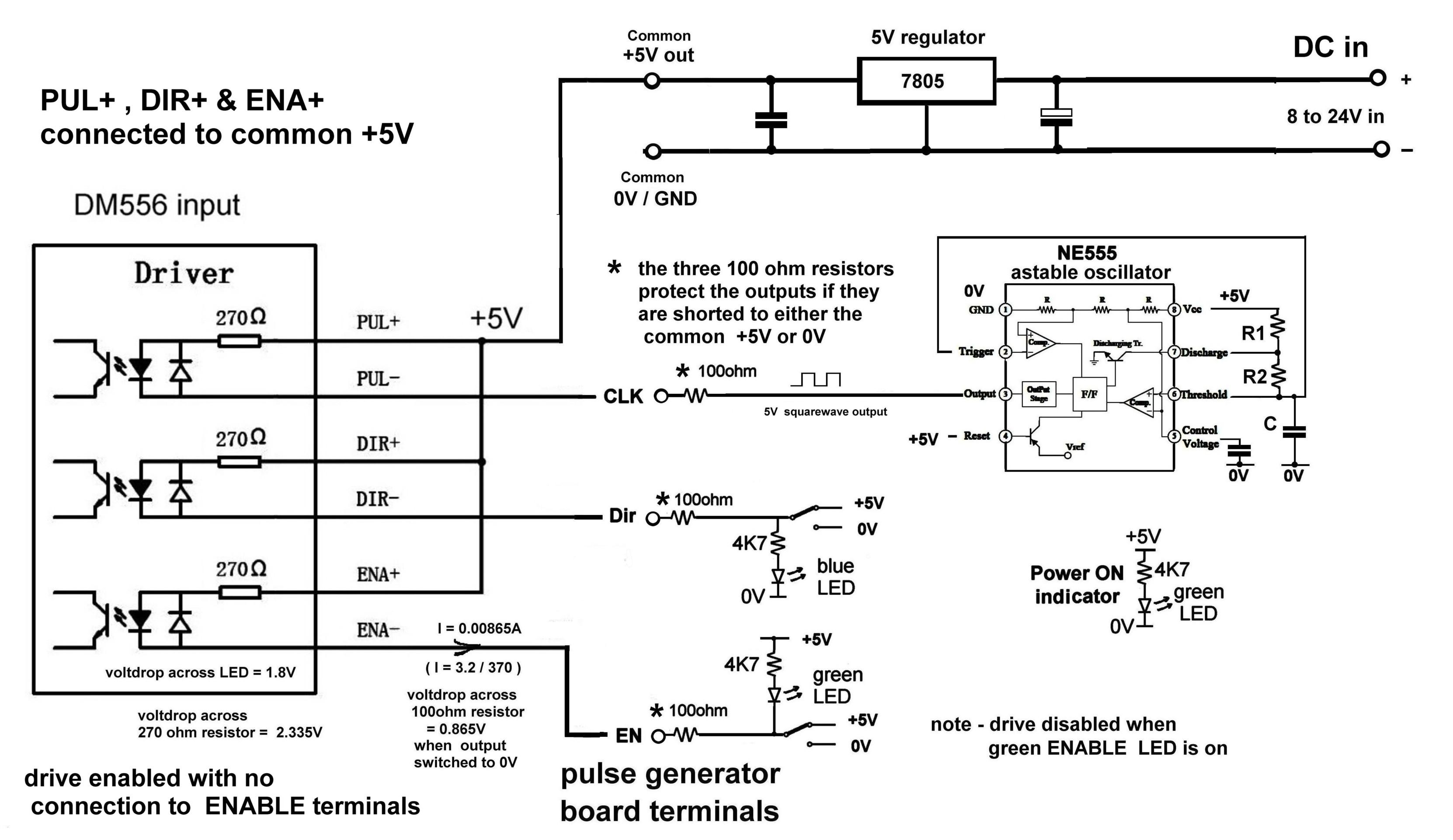

Offline John Swift
  • Posts: 344
« Reply #24 on: November 30, 2018, 03:33:52 PM »

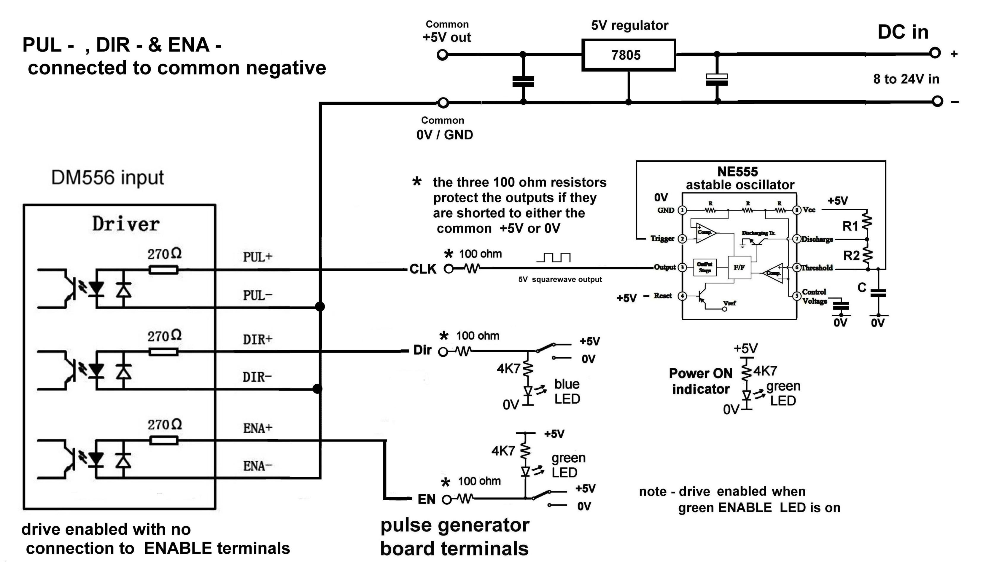

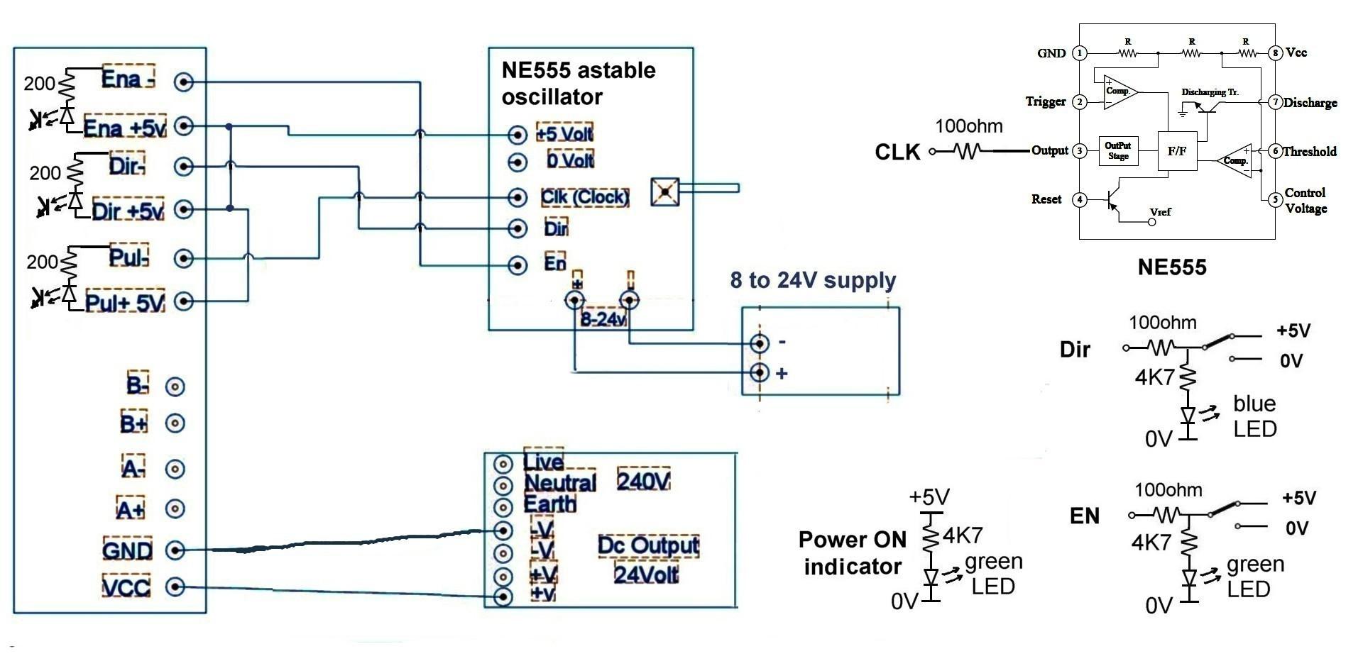

looking at the diagram in post22
it looks like they got the stepper drivers supply wires crossed !
fortunately you wired plus to plus and negative to negative even though you using  black as positive & brown as negative looks odd
and should look like the original diagram with correction
if the direction & enable switches toggle between +5V and ground/0V
you can try the second version  alternative wiring diagram with 0V connected to the step , direction & enable negative terminals
Offline mc
  • Posts: 108
« Reply #25 on: November 30, 2018, 03:41:04 PM »
Back to basics. Think of each control input to the driver as a little light bulb (they are actually an LED, just a fully enclosed one), that need both a positive and negative to light up.
The ENA, is your Enable. You need to apply power to this so the driver starts outputting power to the motor. The basic test for this, is with the main power connected to the driver, and the ENA powered, the motor should lock and remain stationary.
The DIR, is Direction. As the name says, it controls what direction your motor turns. Unpowered, the motor goes one direction, powered the motor should go the opposite direction.

Offline Buell
  • Posts: 77
« Reply #26 on: November 30, 2018, 04:36:24 PM »
Ok so just to clarify the diagram above for the controller is THE WRONG ONE ! it was just something I started with.
The unit im using is the One in this picture...
It has the following connections None of which I have any idea what they do or how they work !
EN>>>>DIR>>>>>CLK>>>>Chinese writing>>>>>>>>Chinese Writing.
I have wired as Follows  and it works perfectly !!! Only issue is that I would like IT to LOCK WHEN NOT BEING USED.
EN>ENA-
DIR>DIR-
CLK>PUL-
Last Chinese writing>DIR+5V Which has a link to pul+5V and a link to ENA+5v
excuse my lack of knowledge in this Im surprised it hasn't gone up in smoke yet ! I know nothing about this wiring i just wanted the motor to turn and lock in two directions with a decent amount of torque. As i say if you see the video it works just doesn't lock up when not used or off. Which will be helpful as i intend to use on a mill. Many thanks the item is of aliexpress and ebay.
This is what the mnf says.... thanks for all the help maybe this isn't possible ?
5613
Stepper Motor Driver Controller PWM Pulse Signal Generator Speed Control 12V-24V
Description :
1 this module is a pulse generation module, supply the control signal to stepper driver.
To control the stepper motor, it must be equipped with a drive.
2 this simple controller + stepper motor + stepper motor + DC power supply can be composed of a simple set of control platform.
3 the controller has high 5.4k-160khz, middle 540-16.6khz, low 80-2.4khz total of 3 kinds of low frequency signal can be used to select the jumper.
4 can produce pulse signal, can also produce PWM signal, can choose the jumper.
5 the frequency of measurement: PUL and common cathode end.
Different stepper driver may mark different name
EN=ENA=FREE       Enable
PUL=PULS=CLK     Pulse
DIR=CW=CWW      Direction
Common anode Connection method (B)
EN+  PUL+   DIR+ connect together to com+。
EN- connect  EN
PUL- connect  CLK
DIR- connect  DIR
Common cathode Connection method (B)
EN-  PUL-   DIR- connect together to com-。
EN+  connect   EN
PUL+ connect   CLK
DIR+ connect   DIR
The PUL, is Pulse, or more commonly referred to as Step. Each time this input gets switched on, the driver moves the motor one micro step (this depends on how the jumpers on the driver are set. On the driver you have, this could be 1 full motor step (1.8deg) down to 1/32 step (theoretically 0.5625deg or 3.375seconds).
To have your motor continually locked, you need to power the Enable. How you achieve this will depend on how you can get a continuous 5V. If you power up the control board you have without switching it on, is there 5V available at any of the terminals?
Looking at the photo, it's using a bog standard 5V regulator, so you should be able to use the input ground wire as the 0V, then probe the rest of the unknown terminals to see if any have continuous 5V. If there is no 5V, check again with the board switched on. It won't help you, but it'll at least establish what the unmarked terminals do.
I would hazard a guess, the two terminals marked in chinese are a 0V and a 5V connection.
If the board only outputs 5V when switched on, then I'll suggest other options.
And for those mentioning switching positives/negatives (other than the obvious diagram error of the main supply wires from the PSU to the driver being wrong - if you had done this, the driver would be a paperweight as soon as you powered it up) , and it making a difference, for the purpose of what you're trying to achieve here, it'll make no difference. Pulse timing and switching polarity does make a difference in CNC, however here you simply want to get the motor to lock/spin, so step/dir timing/polarity can be ignored.
This is a good start thank you ..Ok so with the controller off...but power and it lite up the last output has a permanent 5v its the one im using that goes to ..DIR+5v that links to  ENA + 5V and also goes to Pul+..
Now what ?
Now what ?
I've just realised the controller has a ENA output, which you are using, but don't want to be as it'll be getting controlled by the on/off switch.
In which case, moving the wire you have connected to the ENA output over to a 0V terminal (I'd guess the other mystery Chinese terminal will be 0V, but best check first), should mean the driver is enabled and the motor locked with everything powered up, but the controller switched off.
Switching on the controller should then allow you to control the motor, then switching off lock the motor again.

Offline mc
  • Posts: 108
« Reply #33 on: November 30, 2018, 05:32:49 PM »
Just need to clarify this.
Did you move the wire that was connected to the ENA terminal on the controller, or a different wire?
Your + terminals on the driver, should still be connected to the outer Chinese writing terminal (this being your common 5V supply).
You then want to connect the ENA- wire from the driver to the inner Chinese writing terminal (which should be your common 0V/Gnd connection)
I suspect we've got out wires crossed, and you've moved the + terminals to 0V and is why you're now getting nothing.

Offline mc
  • Posts: 108
« Reply #36 on: November 30, 2018, 06:06:42 PM »
Your prob correct ! The ENA- at the moment goes to another terminal in the controller marked EN....IM guessing I dont need this one !
That is the wire you need to connect to 0V.
With power connected (and the controller still switched off), measuring across the ENA + and - terminals on the driver, you should get 5V.

« Reply #37 on: November 30, 2018, 06:28:34 PM »
On the driver if i Measure ENA _ AND ENA+ i get 3.45v  IF I measure ground on the driver and the ENA + i get 5 volts.
This is what i have and this is what I tried
Offline mc
  • Posts: 108
« Reply #38 on: November 30, 2018, 06:35:27 PM »
That must not be a 0V terminal on the controller then, and it must be floating up under load for some reason. The driver inputs must need nearer to 5v to activate properly.
Try wiring the ENA- terminal directly to the Gnd/0V at the power supply (you could try bridging it across to the main supply Gnd at the driver, but that could potentially cause problems, and I wouldn't recommend it other than for a quick test).

Buell
PS
So I have taken It all apart and decided to start again just for my own sanity ! it looked messy and didn't feel I had given this a Fair chance . so results this morning,,,
with the Power from the power supply Now being Turned on and just the supply to the driver and the controller i have the Following as You stated..
24v to the controller....the EN on the controller with nothing attached in The OFF POSITION IS 5v however when the controller button is switched ON is 0v
DIR ON THE controller is 0v both on and off
CLK IS 2.2v on or off
Chinese writing is 0V on or off
and the Last terminal chinese writing is constant 5v on or off
so with just those connections when the power switch is on/off the motor is locked
Have I missed something ? will go back to your drawing and see if i can get this to work ! Wont give up yet....or am i flogging this horse !

In my heath robinson way I cut a simple toggle switch in on the wire marked ENA +5v on the driver to the other terminal DIR+5v... outcome is that it locks the motor which is great. However when the On/Off switch is activated ON the motor doesn't run in either direction and the lock is OFF Thus rendering the controller switch useless.  However  the toggle switch activates the lock in the Off position and activates the Motor in the other ! Is this where the saying " Forward one step back 2 steps comes from "  I feel Im close but as they say " A miss is as good as a mile "
Still I haven't blown it up yet !

This is as Good as it gets ...The controller has a CLK that was going to PUL- I put an Inline Switch there and It WORKS... When I did it before I assumed it was wrong because the light on the Board was Off and thought It was back to front..Theres a Chap who goes by the way Of NSA on youtube he kindly answered the question and Advised and Seems ok. Think i will put a different type of switch now i know it works . Thanks to all that helped finally got there.

without reverse engineering the pulse generator board I expect the DIR & EN terminals
are connected to on/off switches that either leave the terminals open circuit or connect them to
the negative supply
assuming the step terminal goes to the output pin of a NE555 IC
the pulse output is switching between 0V & +5V
If I am correct
this should work

This is what I have ended up with and it works Hope the loop over cables is evident !! Did my best!

Hi  Buell
on the pulse generator board
I have now found out that the clock , direction & enable outputs have a 100ohm resistance in series
the enable and direction switches do switch between 0V & +5V
a NE555 IC is connected in its astable mode to run as an oscillator
the output pin 3 is conncted to the CLK terminal via a 100 ohm resistor
I have added the details to your diagram
the effect of these 100 ohm resistors is , depending on the current limiting resistors inside of the stepper driver
the pulse generator output will switch between +0.75V and + 4.25V or +1V and +4V
not the 0V to +5V I initially expected in an earlier post
inside various stepper drivers
the manuals indicate the input  opto-isolators have a resistor between 200 & 300 ohms to limit the LED current to a safe value with a 5V input
diagram re saved after correcting typo
« Last Edit: December 03, 2018, 02:57:19 PM by John Swift »

Hi  Buell
THANKS VERY MUCH FOR THIS ....BUT WHAT DOES IT MEAN TO SOMEONE THAT DOESNT SPEAK A WORD OF ELECTRONICENGLISH !
or just layman terms. You will have to forgive me...looking at that reminded me of so many lessons at school where I couldn't understand what the hell the teacher was talking about ! But i do appreciate the effort you made to find out the details so thank you again.

With regards to the photo in post #12:
Are the Blue and Yellow ferules crimped onto the wire or are they solder or are they just slipped on and then the connector screw does the crimping. I am just about to do about 50 or 60 of these joints!
Offline mc
  • Posts: 108
« Reply #52 on: December 07, 2018, 06:06:06 AM »
They're bootlace ferrules/cord end terminals depending on where you are.
You get proper crimping pliers that crimp them square, but you can just nip them up with some side cutters, then rely on the terminal to crimp them, however that often results in them flattened too much so you struggle to get them into terminals.
A set of crimping pliers isn't that expensive (just checked and they're about £13 on eBay just now), and they make using bootlaces far easier.

Hi Buell
 In the absence of instructions for the pulse generator board
I have continued with the iterative process working out the details of the pulse generator details
Now I think I have corrected my problems connecting to the NET
here are two versions of the connections between the stepper driver and pulse generator board
 using either the pulse generator  common +5V or common 0V
while the diagrams don't show all the details of the board
they show enough to predict the state of the enable switch for the motor to run
and explain why the voltage across the stepper driver input terminals  are closer to 4V instead of 5V due to the 100 ohm resistors on the pulse generator board
(thats if you measured the voltage across the pulse generator terminals before and after you connect them to the stepper driver inputs)
« Reply #54 on: December 08, 2018, 07:00:27 AM »
Thats just the info I need, Many thanks MC
