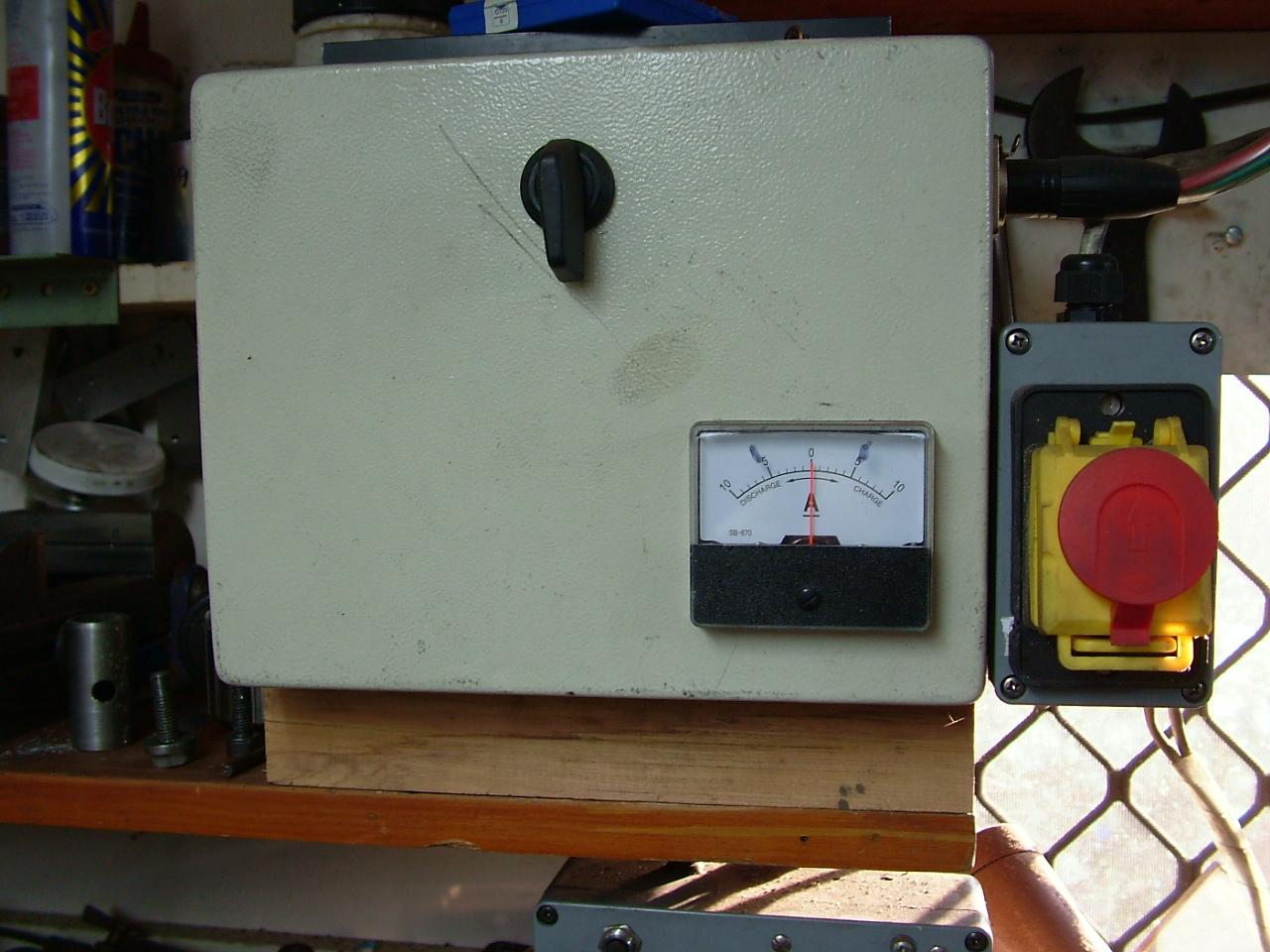

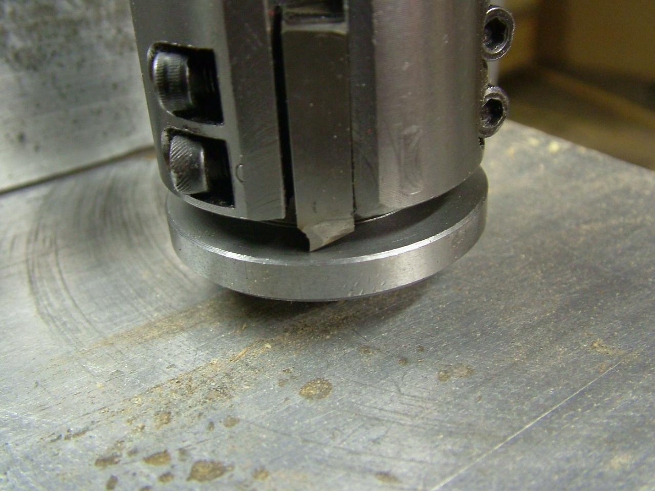

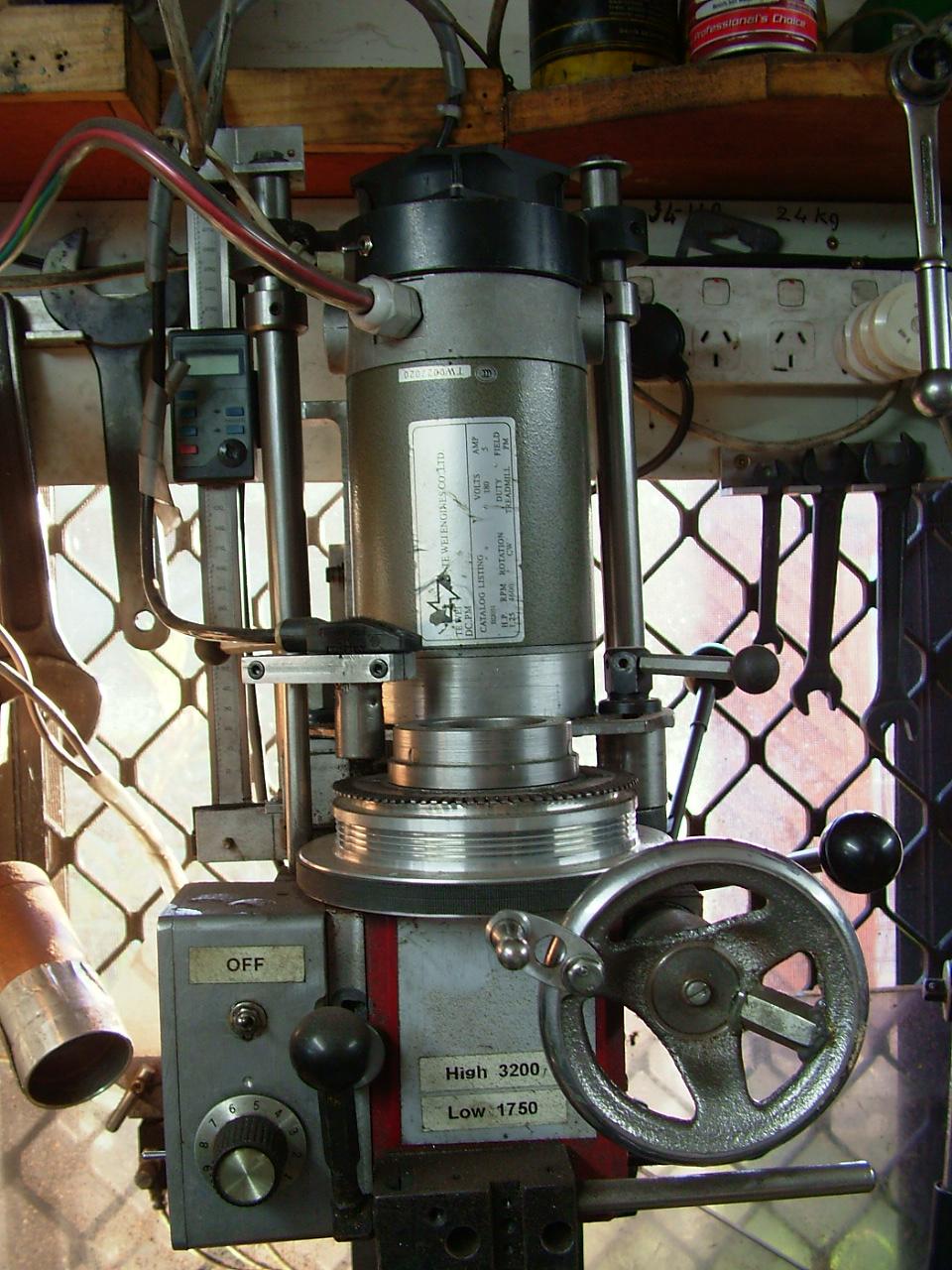

My X2 Mill has a 1.25 hp motor and belt drive fitted and drives a 50 mm facing cutter with HSS inserts quite well with light cuts.
One improvement that helps no end with a Facing Cutter is to fit an AMP Meter to the power leads. Adjust the depth cut to read less than the motor power.

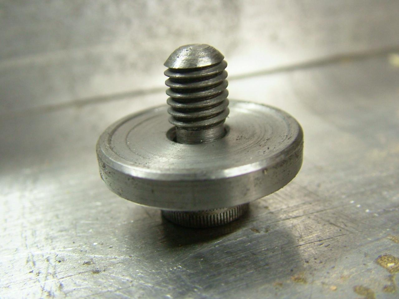

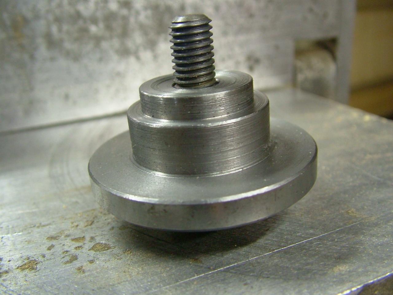

Photos of Facing Cutter and setup jig fitted with the lock bolt removed.

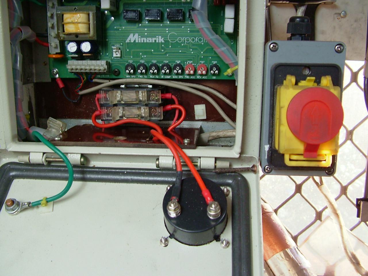

Can you show a few pictures of how the AMP Meter is set up?

The Motor is  1.25 hp 180 volt DC with the AMP meter a ((+ 10  0 - 10)) unit fitted to ONE Motor  Positive Lead so reads Amperage in Reverse or Forwards.  works out @ 900 Watts /  180 Volts = 5 Amps.
The speed controller is a Minarik  AC 230 volts To 180 volts DC converter with Quadrant 4 Braking and Reverse on A Much Modified X2 Mill Drill.
