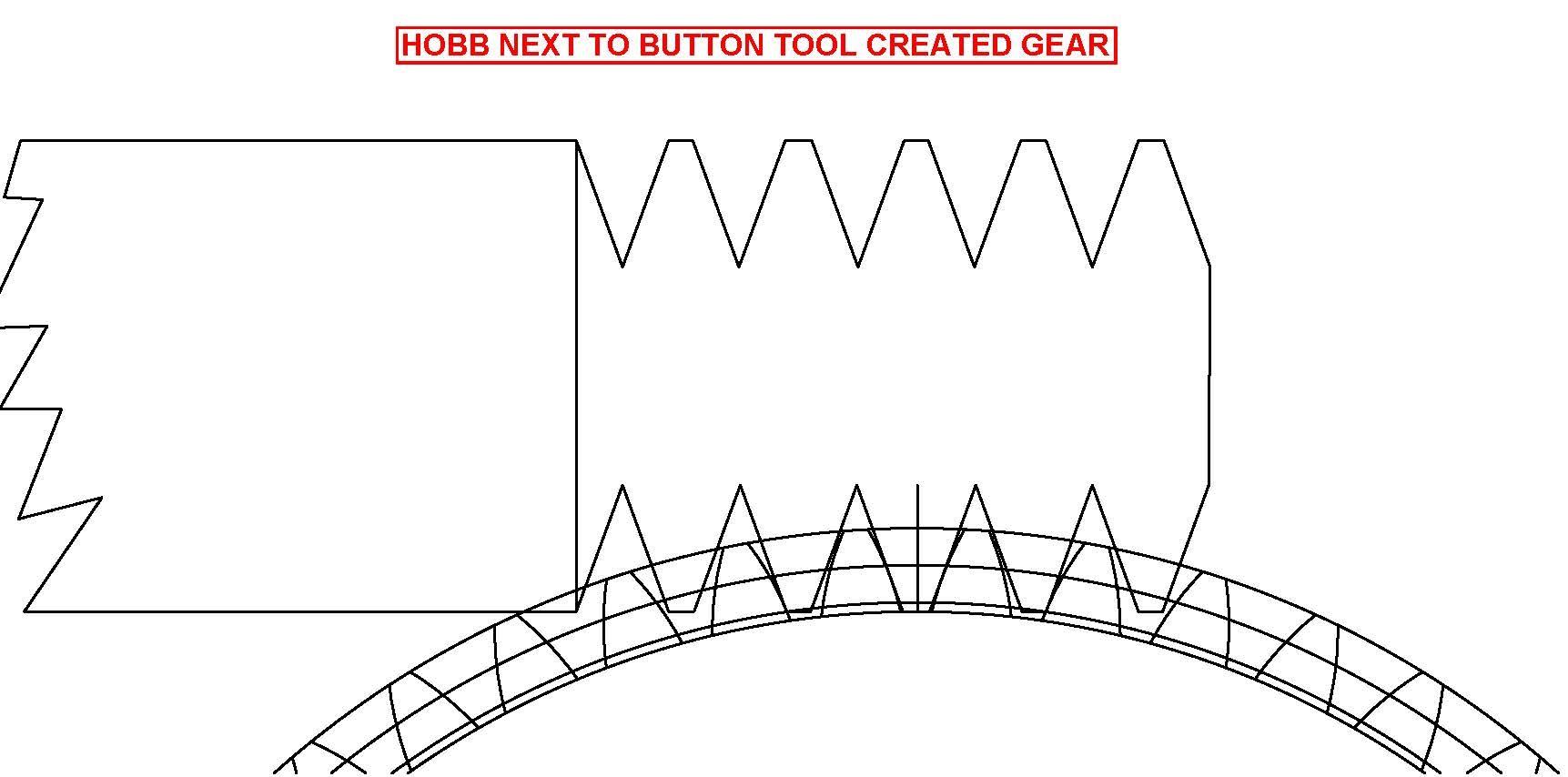

If the cross sectional form of your cutter is that of a rack of the correct dimensions, and it is long enough to encompass any teeth in mesh then surely by definition it must cut the correct profile.
Obviously the teeth in mesh will vary dependent on the tooth count
Re: Miniature coil winder
« Reply #13 on: October 07, 2018, 02:53:04 PM »
Not so Andrew!
In a gear planer the cutting rack moves tangentially between strokes and the gear blank rotates a small amount generating the involute form.
With just one pass of a rack form cutter at centre height you get:
Rotating the blank a tooth (in this case 30 degrees for 12 teeth) you get:
That's as good as it gets - the involute is approximated with 2 flats.
Add a pass where you rotate the blank 1/2 tooth and raise the cutter the equivalent of 1/2 tooth you get:
The next pass would be another 1/2 tooth rotation dropping the cutter down to it's original height producing:
The involute is now approximated with three flats but some horrible looking artefacts at the root of the teeth.
So to generate a perfect involute you'd have to do an infinite number of passes rotating the blank and adjusting the cutter height accordingly. A compromise somewhere in between would give a very acceptable gear.
I chose a 12 tooth gear because this would accentuate the problem.
Hope this makes sense.
Cheers.

« Reply #14 on: October 07, 2018, 03:40:07 PM »
Makes sense, I'll stick to normal hobs  :thumbup:

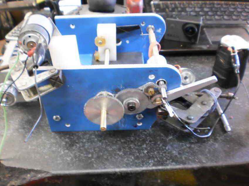

Tested the transmission gear train with a small 12v dc motor. And here are the results.

Gears seem to have worked out good nice work so far!

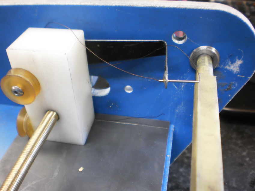

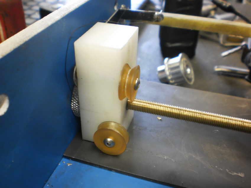

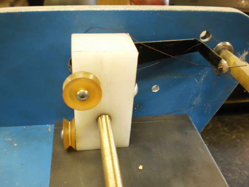

Well getting down to the finish but I did have a error some where. The wire guide I made from a hypodermic needle and some spring steel but ended up to long and would be to close to the spool. So I need to shorten it and I also missed the feed hole in the one side plate.
Once I get those errors fixed I'll get the counter mounted and the motor and I'll be ready for a trial run.

Getting close to the first coil wind and we will see if I end up with a usable coil or not. Always wanted to try this so it will be new to me. I'll need to build a vacuum chamber for it next.
