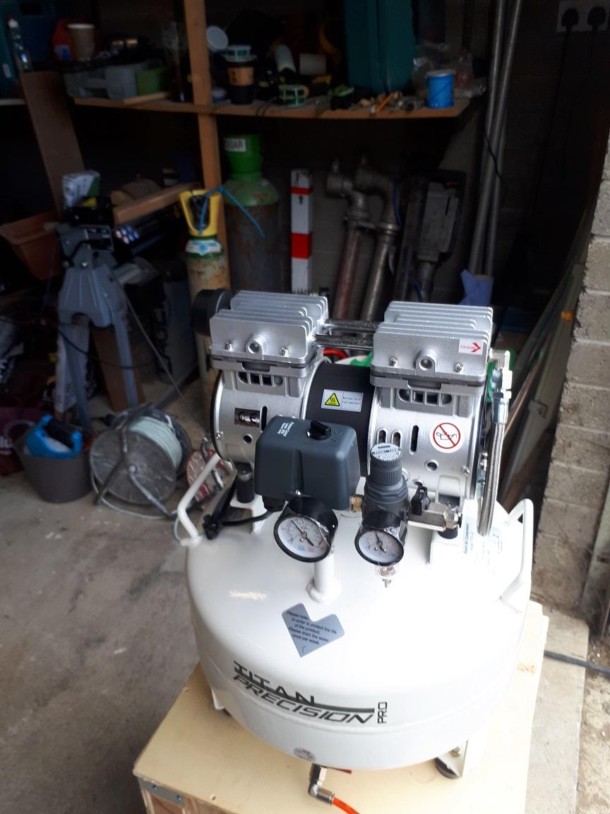

Well look what arrived today:
It is super quiet 52 dB claimed, I got 59 which is pd quiet.
Not cheap but I hope ye still get what you pay for.
Question: What do I add to water for the fog/mist?
Somehow I bought the mister and the compressor without knowing what soluble oil to use!  is it standard white water oil?
What dilution for a fog system.m Di I need to wear a respirator or use a vacuum extractor?
MTIA

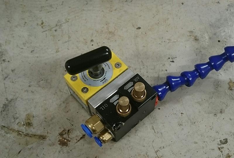

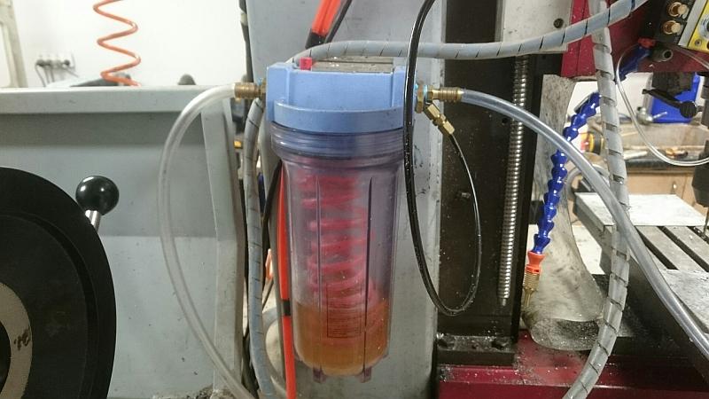

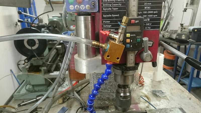

« Reply #6 on: September 19, 2018, 08:01:01 AM »
Pics of:
The coolant tank. All of the air comes into this tank, most of it just comes straight out of it. But the small amount of back pressure is used to force coolant to the nozzle assembly.
My current mister. It's OK, that valve is very touchy..
The one I'm going to plumb in next. It has pointer needle valves and a filter and I found these really strong mag bases.....
