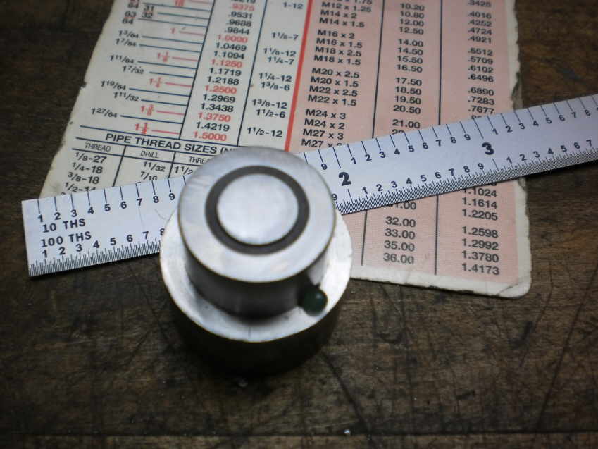

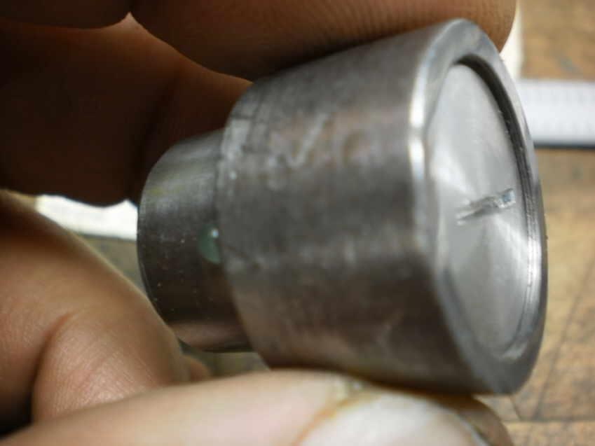

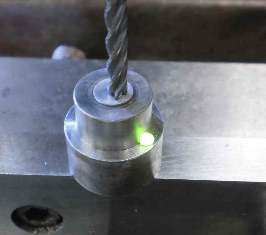

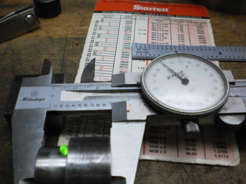

I've been wanting an electronic  z height set tool for awhile but the ones I seen were all 2 inch high I wanted a 1 inch height so I made my own today. I'm happy with the way it turned out. Kind of made it up as I went along so I didn't take any video but did take some pics after the fact.

How does it set the height?  CNC or manual mill?

Is the top spring loaded or solid?
The one I made for my CNC has 2mm overtravel.

« Reply #4 on: September 13, 2018, 08:53:05 AM »
The top is spring loaded is will work on manual mill or NC. I usually write my programs for my NC with a home zero position of 1. This will save me a step of touching off and moving up 1.0 and zeroing. That is one the reasons I wanted a 1.0 not a 2.0.
 I don't have any diamond tooling but if I do end up with some I'll keep that in mind thanks for the tip I guess I would have done the same thing.
