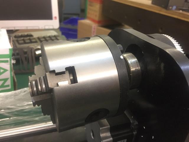

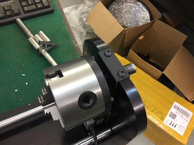

Beware of the cheap Chinese 4th axis kits. One came with my Laser Cutter, and they all look to be the same generic design. Thick aluminium plate with the main bearing pressed into a recess and nothing else holding it together  :bugeye:
A modification was in order ! (and duly executed)
