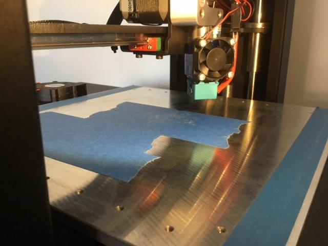

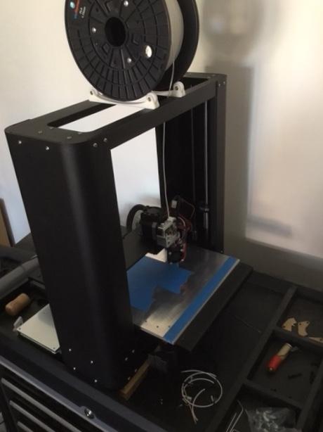

« Reply #7 on: August 31, 2018, 01:02:31 PM »
This is the printer waiting a brain transplant.  It was bought due to having the linear rails and steel chassis, on paper it looked a good one.  Ahh well, maybe it still can be, the E3D hotend was machined and a spacer added so it could be a direct replacement for the old hotend.  A lot of people actually print the adapter for these, but they just aren’t rigid enough for quality printing.  The old hotend had no heat break, one of the reasons it constantly dribbled as heat worked its way up with no cooling fan for the Peek section.

« Reply #9 on: August 31, 2018, 05:55:20 PM »
Paul, you actually would like quite a bit of the above printer.  The steel chassis is well thought out and very rigid once bolted together.  They did skimp on the table bearings using 3 rather than 4 and the Z leadscrews are a bit weedy and prone to getting bent easily, as you can crash the hotend off the edge of the table...  that only needs a block of alloy to fix.  Aluminium table is very flat, I don’t use a heater with it for printing PLA and not sure what 60℃ would do dimensionally.  I think it will do better work than the current printers once the mods are completed.  Then start serious work on the core XY design.
