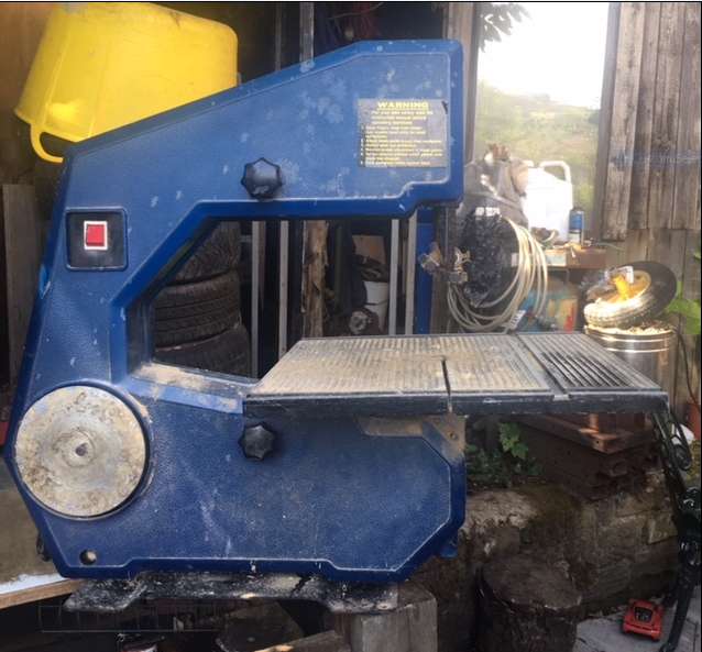

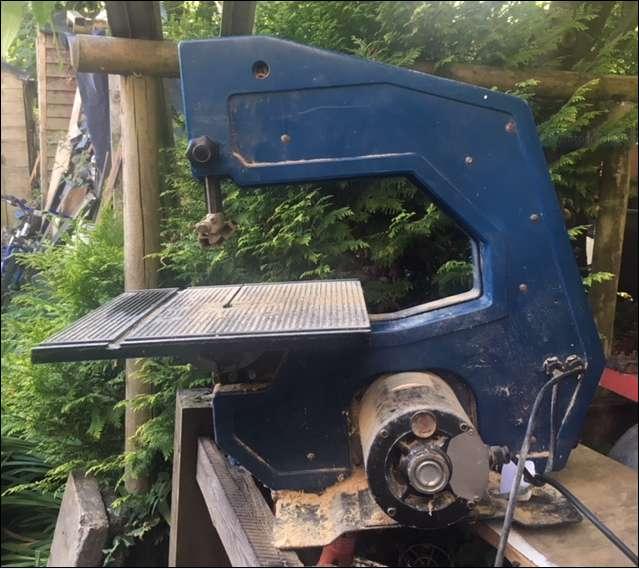

Hi all,
long time since I posted anything, But here goes.
A week or so ago I was driving into town and passed a scrap collectors wagon. On the back was the band saw pictured below.
It didn't have a blade, and appears not to have been used for some time. A fiver changed hands and it was mine.
And it runs. Appears to be in generally good condition.
It has two speed ranges, and two options on each range, although the lowest speed of 160 ft/min may be a little fast for cutting steel. I think 80 fpm would be better. I can deal with that though.
The overall appearance, style of casing etc, is very similar to my DeWalt bandsaw.
But, as there is no makers name on the casing I can't be sure.
Anyone know who manufactured it ?

Looks very much like a Naerok machine...

John,
Thanks for the info.
It certainly appears to be a Nearok machine.  and belts and blades are available.
I may make some new pullys to slow down the blade speed in the future. But for now it can be used as-is to cut aluminium and wood.
Dave. :thumbup:

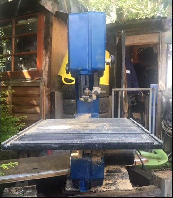

A couple of additional point.
Firstly I have Emailed Tony lathes for more info on the blades and rubber tires for the rollers.
As I was cleaning the saw down I noticed that, unlike most bandsaws, this one doesn't appear to have a support roller behind the blade to take up the thrust due to pushing the job into it.
It does have both rollers (one on one side above the table and one on the opposite side below it) and some kind of fibre blocks to keep the blade centred.
There doesn't appear to be any way to locate a roller behind the blade. Is this normal for the machine ?

I have just had a closer look at the PDF of the manual for the CBS 355.  Page 12 shows a good view of the lower guide block.
It appears that the blade runs at a tangent on the face of the bearing. and the actual guides are the two fibre blocks.  So the bearings are there to prevent the blade 'pushing back'.
