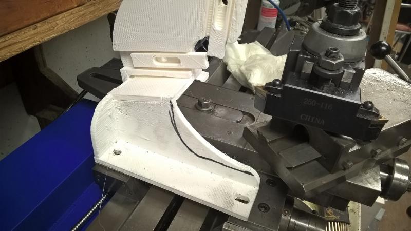

The drawing I had didn't actually agree with my lathe all that well, and it seemed to be designed to suit a lathe fitted with a lantern tool post (tool centerline through the compound centerline).  I thought about it a lot, and drew up a follow rest in Autocad.  A bit of fiddling and I ported the layouts to my 3D printer and made full scale models for fit testing.

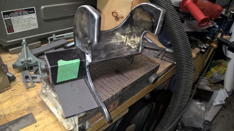

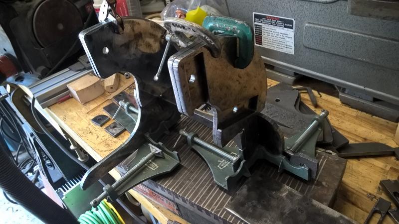

I ended up deciding it should have TWO sets of fingers so I could support things near the chuck and near the tailstock.  The pieces were plasma cut from my models, and had tabs designed in to make it self-jigging.  I used lots of clamps and a magnetic chuck to get everything assembled for tacking.
Just an aside: a magnetic chuck is a HUGE help for welding and grinding; you can just drop plasma cut stuff on there, mag it down, and grind the dross off quickly!  Grinding welds and stuff is also much easier when the durn thing stays put.

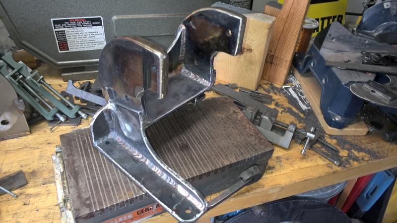

I did a lot of tacking and a boatload of welding, intending to make the finished product really nice looking with smooth corners.

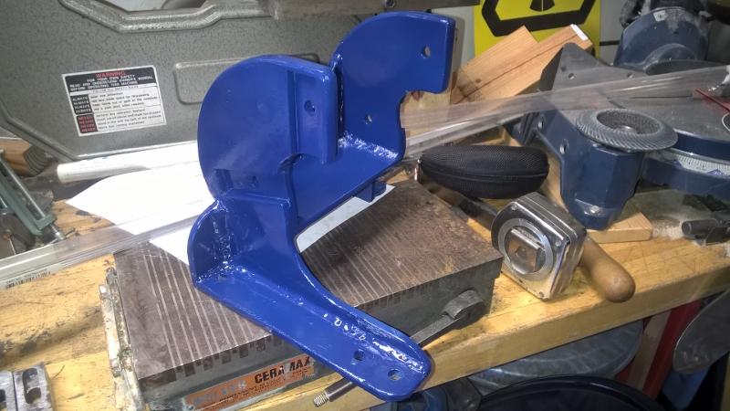

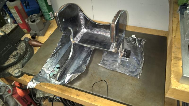

The three mounting areas were almost co-planar.  I decided (what the heck was I thinking) that I could replicate them into a plane.  I oiled my surface plate, smoothed some foil onto it, spread epoxy on the feet, and set the steady on the foil.  After it was set, I cleared it out of the bolt holes, trimmed it, and did some final sanding.  Then, on to paint!

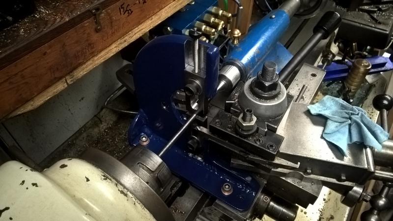

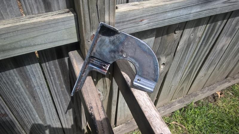

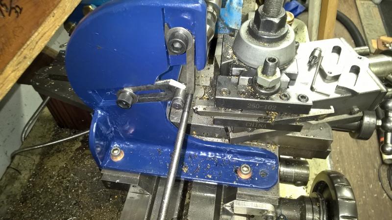

After making the fingers, I finally tried it out!
This is where things got ugly...  It bolted on just fine, but I found out that the tailstock hit the back steady basically all the time, and the front one wasn't where you needed it to be AND didn't have enough room to clear the tools or work.  It did a terrible job of steadying.  Scream! https://madmodder.net/Smileys/default/doh-45.gif
Oh, and I didn't get the fingers where they crossed the center line. D'oh!
After some calming beverages and a few days, I started over.  At least this time I knew where the center line was and the dratted bolt holes!

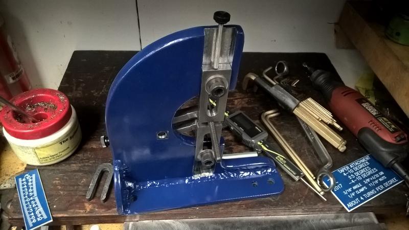

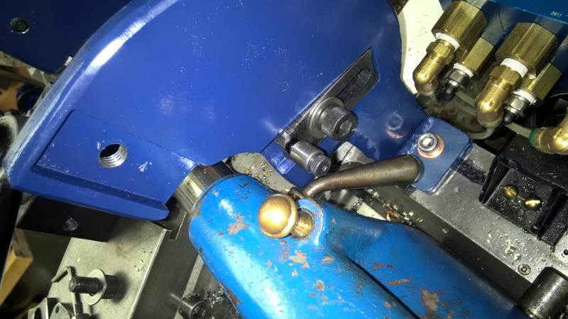

Did I mention that I drilled and tapped a hole in my saddle to make the bad one work?
The second one went together much faster.  An important trick I used: the main structure is two layers of steel.  The fingers go in slots in one layer and the other layer has the matching bolt hole.  I discovered that a steady rest actually wants to have the fingers offset so they can cross, and its nice to have three fingers.  Thus, one of my plates has two slots and the other has one slot.  I designed in a strip that closed each one of the slots so that they would keep their nice precision plasma cut widths during welding.  After the welding was done, I cut off the connectors and finished things on the mill.

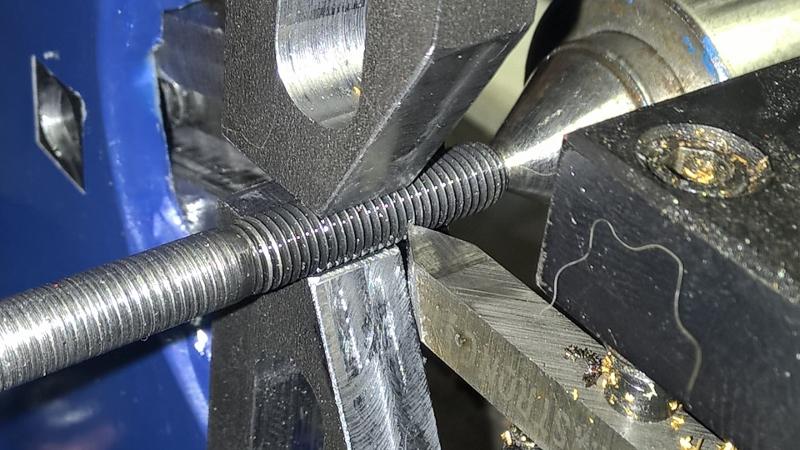

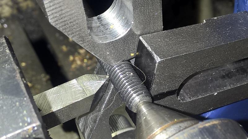

And, finally, actually cutting metal!  I needed to extend the threading on a 4" long 1/4-20 capscrew for the taper attachment, so that was my first customer.  The three fingers in two planes worked really well, and I was able to easily cut another inch of threads on it.  The funny shape of the top and bottom fingers are to give you a view of the cut and to clear the tool on the bottom.  They might be version 2B...  At least that didn't require a complete re-do.
Oh, another thing I learned the hard way: roller fingers are a BAD idea on a follow rest.  They gleefully roll chips in between the roller and the work, and push it around.  Simple fingers push the chips out of the way...  At least I learned that on the FIRST one!
I kearned the same thing....if the material is that crabby you may use hardened fingers (counter intuitive, but works) or put a large bearing into steady rest and a cat on the pice to protect it. I on the other hand use brass shimstock or greased cardboard between finger and work piece, if the surface is soft. Does not work on thread, for those you need pretty hard fingers ot thread will start driving your cross silde.

I TIG welded in short sections all over the piece,  and allowed it to get really hot; both of those help keep down distortion.  Preheating would have been better, but I didn't need that level of control.  Hard clamping would also help.  #1 moved no more than 1/16" over its 9" span after a full weld out.

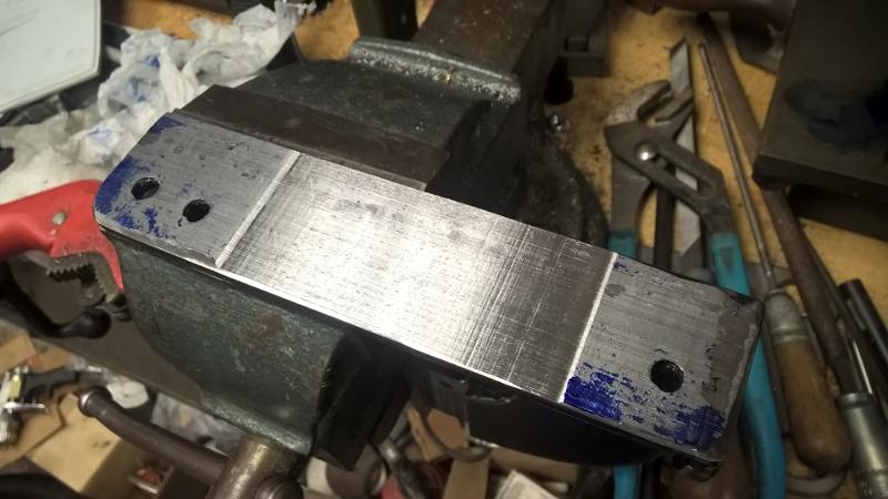

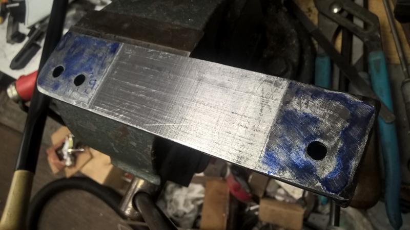

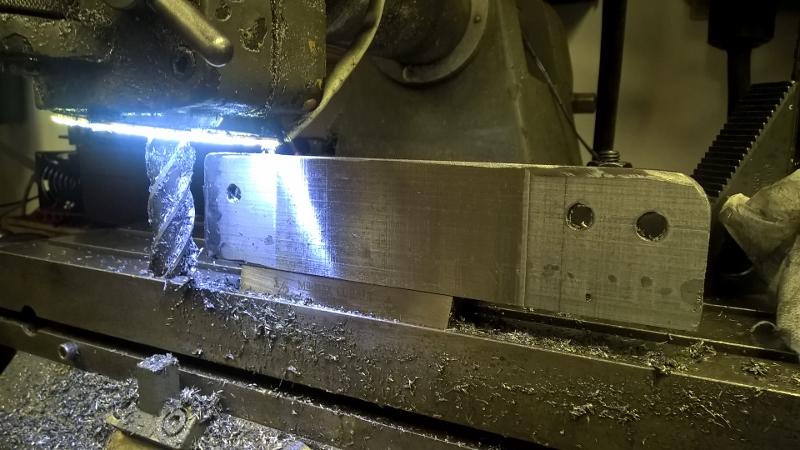

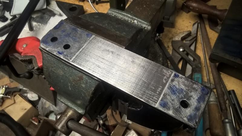

Ran across a couple more photos!  I milled the bottom of the follow, and relieved the middle.  I had some fun scraping the steel (carbide scraper of course)!
Yes, steel is a LOT more annoying to scrape than cast iron.  I liked that you can see the pattern develop.  I really didn't need to do it, but I wanted to...https://madmodder.net/Smileys/default/anim_32.gif
