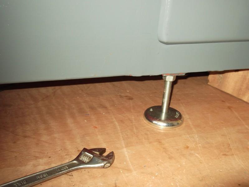

Howdi,
I have got my first ever lathe up and running a boxford BUD, well sort of.
I feel that it is a little to low for me when using the lathe and would also like to remove the wooden wedges from underneath it for someting a little more robust.
What are peoples ideads on adjustable feet (have to be adjustable due to my floor in the workshop)? My plan is to weld a plate over some 2" tube, tap a m16 hole and use some bolts as the adjusters. Only lifting it around 70mm. Would anyone advise bolting it down or would just sitting be fine.
I chose the desing listed as thats what i have kicking around the workshop.

This was my solution

Cheers seadog,
Wow, I must commend you on the clenliness of your workshop floor. Do you find that stable enough? I am judging from the picture that they are M8 at around 50mm lift?

If only. That was just after I'd built it and was in the process of refurbishing the lathe. They're 16mm if I recall and they raised it by about 4" and I had to open out the holes in the cabinet slightly to get them to fit.
I was lucky to come across four new ones on eBay, I think they're made by Bosch. I paid around £24 including postage, which is probably a quarter of list price.
