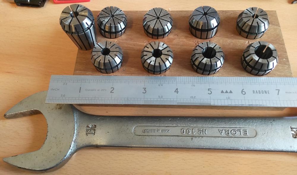

Just picked up a 35mm (1-3/8") spanner at the car boot for £1, and its Chrome Vanadium, Elora (German). Also managed to score a set of 9 ER25 collets, 1 - 12mm. As I use ER32 not sure what I'm going to do with them - offers anyone ?
Otherwise I will probably make an er25 chuck for the lathe - another get round to it project.
