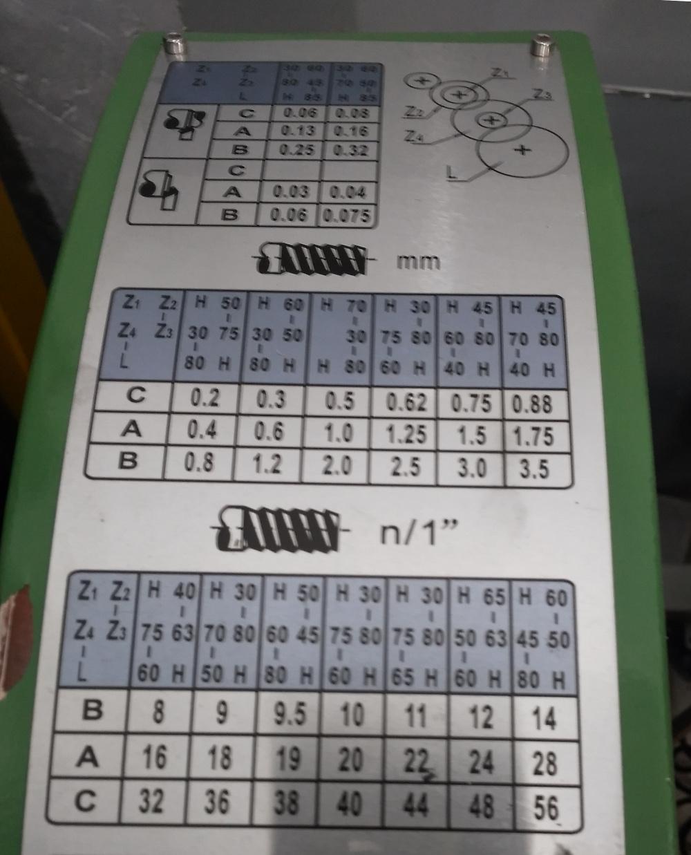

Am trying to set up for a 20tpi thread, which should be a doddle according to the label on the machine. However i cannot seem to be able to get the gears to fit in the banjo - there does not seem to be enough room. 30-80 and 75-60 seem to be the gear pairs, but it is impossible to fit the 80 upper gear with either the 75 or 60 lower gear in place. I am assuming that the leadscrew fixed gear is not changed.
Can anyone with a WM250 care to shed some light on this.
Best Regards
picclock
Offline picclock
  • Posts: 613
Re: WM250 change gear assistance needed.
« Reply #1 on: May 26, 2018, 06:27:42 AM »
Sorted - The leadscrew gear dos need to be changed and the H 's on the change gear list refer to spacers which are in the tool box.
