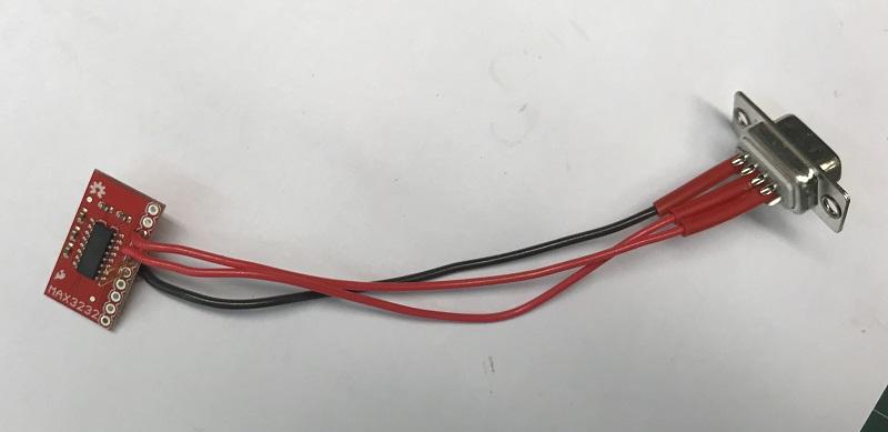

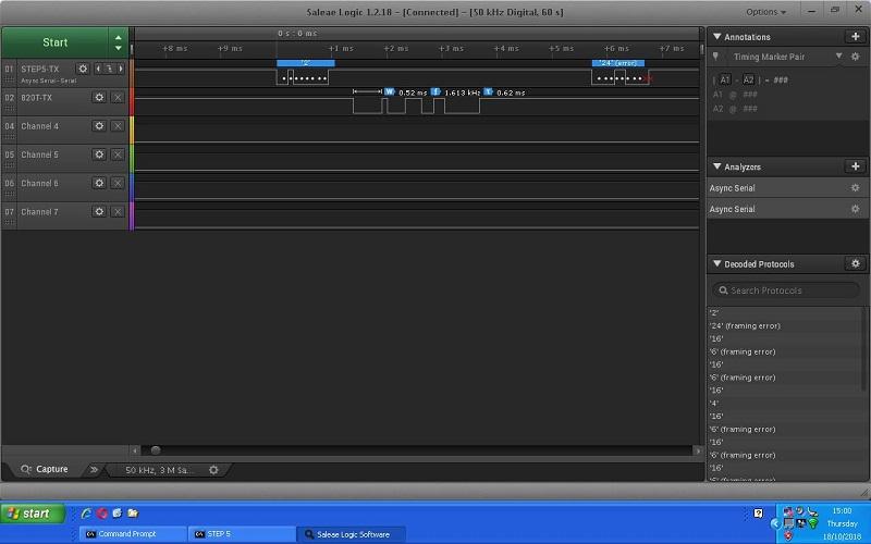

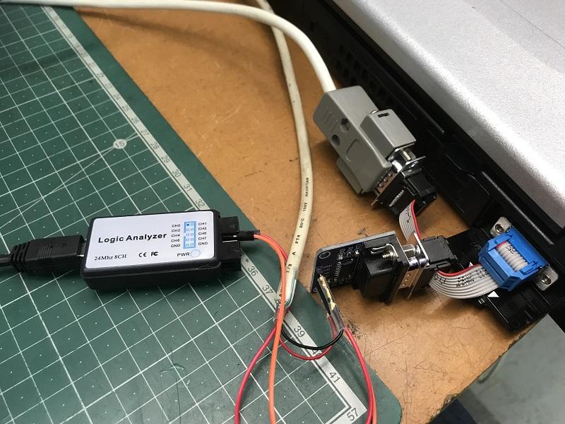

OK Moray kindly pointed me at a cheap 'logic analyser' that would let me capture signals between the STEP5 program on the Toughbook, and the Siemens 820T controller. But these signals are at RS232 levels and the analyser is expecting TTL levels.

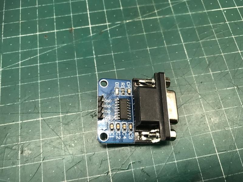

No big issue - either make or buy a converter based on the MAX3232 chip that does precisely this conversion. So, the USB analyser, a MAX3232 board, and some 9 pin IDC plugs and sockets ordered, all of which came to hand yesterday.
The MAX3232 board needs a 5 volt supply, so I modified a USB cable to give me this, and made up a short  Male, Male, Female adaptor cable for the 9 pin Toughbook serial port to allow connection to the converter card as well as onwards to the 820T controller.
First I set it all up just transmitting from the PC using the "COPY CON COM2:" command in a DOS box, and sure enough up it came on the analyser.
Then I tried connecting the serial port onwards to the controller, but no way would it go 'on line' Much chasing about then it dawned on me, the little MAX3232 pcb has one "RS232 to TTL" and one "TTL to RS232" port connected (the MAX3232 has two of each) - what I wanted, as I was just monitoring the interface, was a pair of "RS232 to TTL" converters. What was happening was that the RS232 output of the PCB was in parallel with the RS232 output of the 820T controller and clobbering it  :bang:

Frustratingly the PCB was laid out such that there was no realistic way of using the other port on the MAX3232, but I have found another version, a "Sparkfun BOB-11189" that doesn't embody a 9 pin Sub D, but does bring out all the inputs and outputs to accessible places - one on order from Farnell.
But what I HAVE manged to confirm, is that the STEP5 PLC monitoring software is definitely altering the COM2: port settings to 'Even Parity' each time it is run, and thus generating the 'framing errors' as the controller expects 1 start bit, 8 bit data, no parity bit, 2 stop bits ie and 11 bit word, but it is getting a 12 bit word with even parity !!!! No idea how or where, and still seeking enlightenment  :coffee:

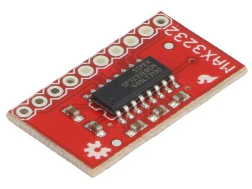

Farnell, good to their word, delivered the alternative MAX3232 PCB - the 'Sparkfun BOB-11189. So grabbing the soldering iron I quickly connected it up to a female 9 pin-D-Type and set the Logic SALE-AE analyser. Sure enough we can now go on line to the 820T and listen to BOTH sides of the conversation.
No time at the moment to go into it much deeper, but here is my first screen shot showing the transmission from the STEP5 port and the response from the 820T controller - need a bit of quiet time to dig into it further.

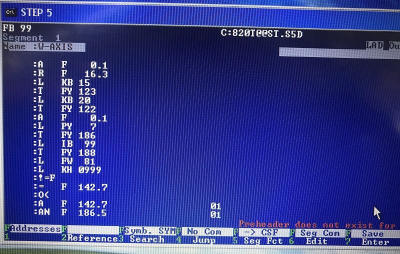

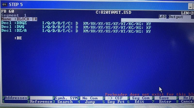

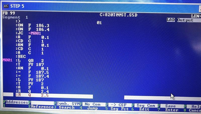

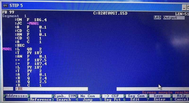

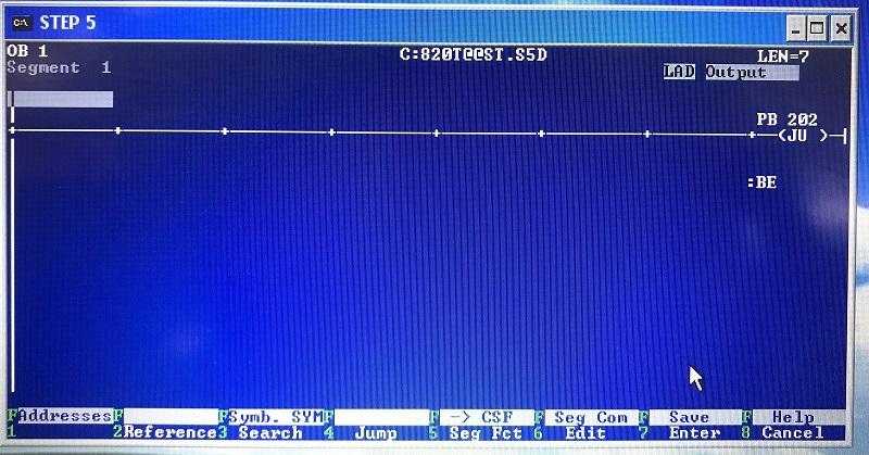

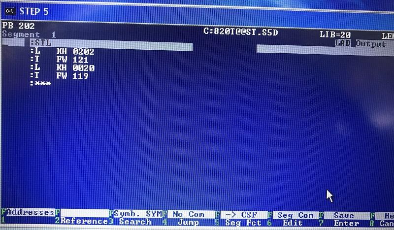

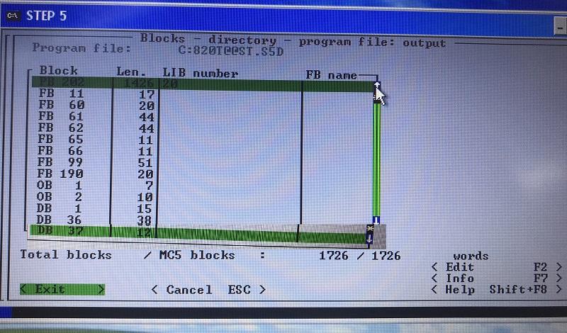

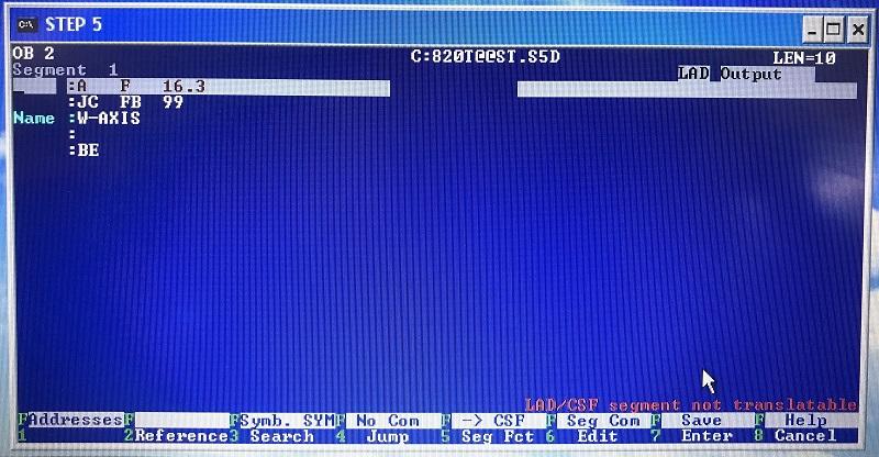

To illustrate this conundrum I'll post some screen shots of some of the blocks in the PLC as downloaded by STEP5
First the Directory - (it was one line longer than a screen so I cut and pasted it !)
Then OB 1 which is the entry point for the program
Then OB 2 which is called on interrupts (and only seems to call the FB 99 W Axis routine)
Then PB 202 which should be the main program block
Then a couple of function blocks (FB11 & FB 60 as examples of 'no meat'
Then FB 99 the W axis service function that isn't used but is meaty !!!
There just HAS to be more to the program than this trivial bit  :scratch:

PB202 looks very suspect, given it should be far longer compared with the rest.
The thing that stands out to me, is what's the significance of the Segment 1 on all the screens?
Is there some way to access more segments?
« Reply #488 on: October 19, 2018, 11:30:00 AM »
Yes it's very odd Moray, and try as I may I can't at the moment see any way of getting further segments.
Looking at the guide to programming the PLC most, but not all, of the FB function blocks listed in the PLC directory are standard ones that do things like transferring data to and from the PLC and NC parts of the controller.
It all looks pretty shell like and empty if I'm honest, and it's really odd that the one FB that looks OK to my untutored eye, is FB_99 for the non-existent W-Axis.
I'm trying to formulate a concise but meaningful question for the Siemens forum about this - they are an odd lot, and the moderators tend to kick things into touch if you are not careful how things are phrased and ramble too much! It's a question of getting all the graphical information into the single picture that they allow !
When the controller is loaded from an empty state you start loading NC Data and PLC Program and data, but then there is an 'ASM' file that no-one can explain what  it is, but I strongly suspect that it is compiled assembler code - the only reference to it I've found calls it a 'dump of user memory'.
I'm tempted to do a reload without the ASM file, and try and go on line to the PLC and see what's in it. If the ASM file IS compiled  assembler code for the PLC then surely the PLC program has to hook into it to use it at various points, and I see no sign in the 'Blocks' I've downloaded.
It's no tiddler at 207Kbyte and takes 30 mins to load !

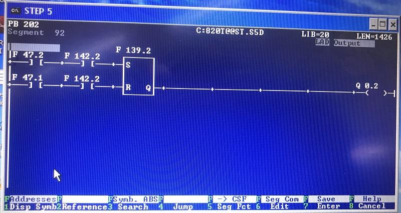

« Reply #495 on: October 21, 2018, 04:55:21 AM »
It turns out that the one 'Program Block' PB202 has 172 segments full of all sorts of complexities waiting to be de-coded. (But all the other blocks are 'single segment')
Below is a random but not untypical segment, segment 92 displayed in 'Ladder Format'.
Todays job is to try and find how I can get the graphical representation of the whole 172 segments into a readable file or out to a printer. Taking screen shots, or as I've been doing this morning actually photographing screen images isn't really practical to get to grips with this beast.

Ade,
No, a long way from G code !
PLC's or Programmable Logic Controllers evolved to eliminate the masses of relays found in many automation systems as they were a constant source of failure, were expensive to build and fault find.
Consider the PLC like an electronic ULA or uncommitted Logic Array, that has loads of inputs, loads of outputs, and is programmed to define the logical connections between inputs and outputs.
The PLC goes one further step and can incorporate timers, latches, and interrupt service routines.
Now there are several ways this logic can be portrayed. In my view the simplest is the 'ladder logic'  with decisions shown as open or closed switches. You have such a ladder of contacts in your Bridgeport Interact for the 'eStop Chain' where the ultimate end point is to open the eStop relay if things aren't safe.
'Ladder' because the original relay logic contacts were strings between the positive and negative rails of the supply each string making effectively one decision, and when drawn out looking like a ladder!
Below is a slightly more complex bit of my PLC ladder (Segment 92) where an RS Flip flop is involved :
Flag bit 47.2 sets the RS flip flop if Flag bit 142.2 is True
Flag bit 47.1 clears the RS flip flop if Flag bit 142.2 is True
And the resulting output of the flip flop is presented to the interface as output bit Q0.2 which on my lathe is an actual hardware output 'Chuck Low Pressure Select'
(it equally could have been another flag bit to be used as input on another rung of the ladder)
I've no doubt that ultimately Flag Bits 47.2 and 47.1 will be derived from decoding M codes (or machine control codes) in the running program but I've not got there yet !
. . . niffty eh  :ddb:
