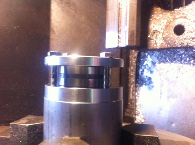

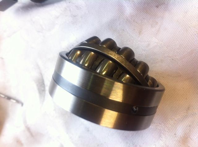

I found another publication where the author modified the casing and shaft  to fit a metric  self aligning roller bearing 22205, by boring the casing from 2in. to 52mm and grinding the shaft from 1in. down to 25mm
I decided instead of modifying the case and shaft I would see if it was possible to machine the bearing to imperial outer and inner dimensions
To hold the bearing inner and outer rings absolutely true would be vital to make this a success

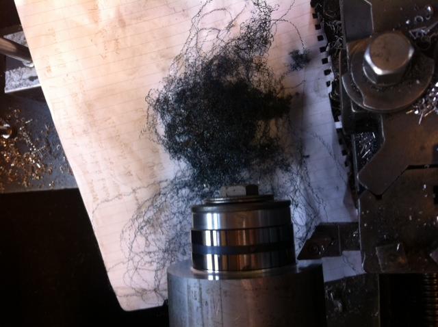

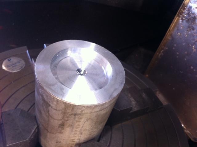

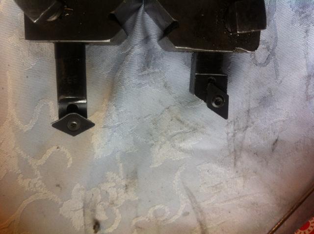

I chucked up a piece of 75mm round alloy bar and bored a recess in the end face that was a tight fit on the 52mm outer race, a tapped hole in the centre of the bar held an alloy disc to clamp the bearing against the recess. I have some DCMT tool tips in P25 grade that will machine the  bearing race steel
I then cut away the alloy that was holding the bearing true, I took it really easy cutting the bearing ring, 5 thou off the diameter per cut, making a ball of steel wool in the process !!

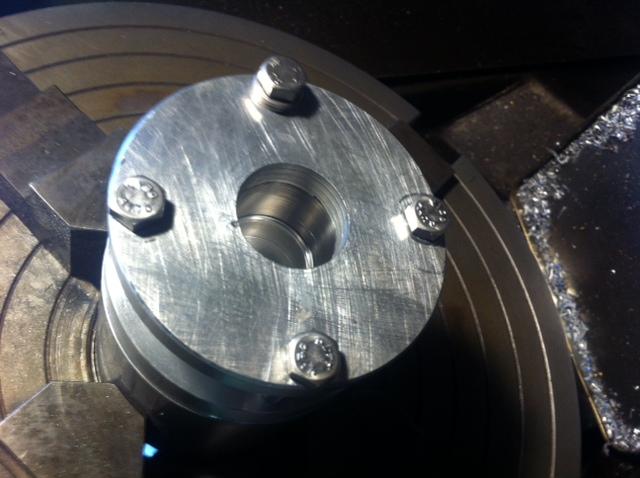

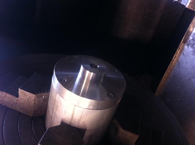

To hold the inner race I made another alloy disc, relieving the outer part a little, this was held  by four 6mm bolts threaded in the end of the alloy bar outside the bearing outer
I turned a 10mm length at the end of the 75mm bar down to 25mm a tight push fit for the bearing inner, then clamped the bearing in place
I then drilled and bored the alloy out of the inner race

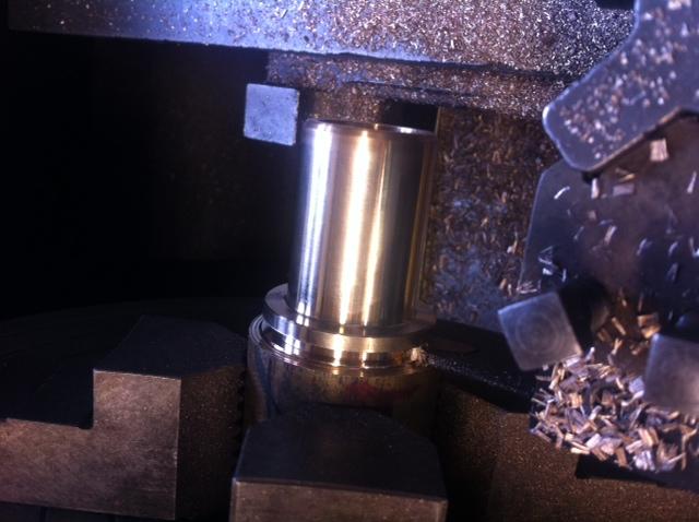

I did not have a boring bar to take the DCMT P25 tips,  :bang: so I hacked an old boring bar to hold one.

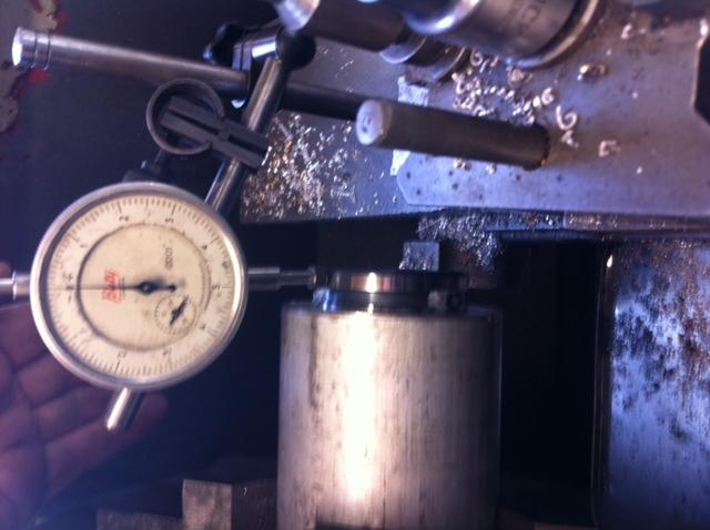

Taking very light cuts and taking lots of measurements as there was only 0.4mm to remove I snuck up to the 1.000in size, It was difficult to see into the bore when the boring bar was in there
I was really happy to achieve the sizes required without scrapping the expensive bearing   :beer: :beer:
