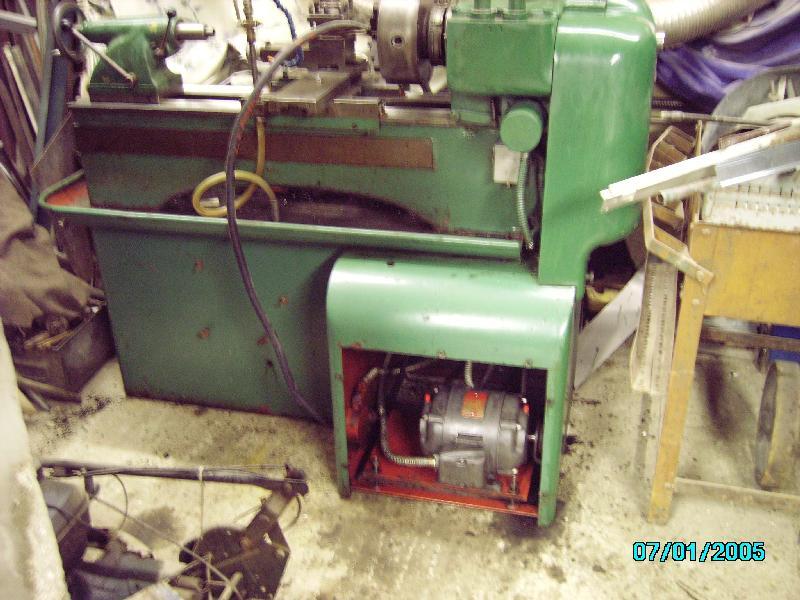

Hope this helps, do you have a manual? if not have a look on the Yahoo group for Harrison lathe users to see if they have a PDF, or you could buy one from lathes.co.uk. the pic is the motor in the back of my Colchester, which is a Brooks 3ph, 1.5/3hp 1440/2860 rpm, just to illustrate that they are actually quite small. You would be better off buying a rebuilt or rewound Brook motor or similar than buying a new italian or chinese one! Do you know of a motor rewind shop in your area?

The motor on mine is huge in comparison to the one I’m your picture!

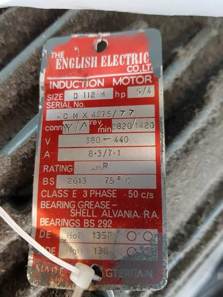

I've got a 3-phase dual speed motor that's not going to be used by me. It's from an A&S 2E mill. if I recall correctly.
Rated at 3kW. Any use to you?

That would do the job Seadog, but it depends on the physical size of the motor, and whether it will actually fit in where it has to go. My Student has a 1.5/3 hp  1440/2860 rpm motor which was the standard fitting at Colchester. I am not familiar with where the motor is on a Harrison, but I am pretty sure it is inside the machine.

« Reply #5 on: May 12, 2018, 10:41:15 AM »
Hi Seadog,
I’m interested in the motor. I think it’s about the same as what was fitted as standard.
The current 1 phase motor is 3hp and I was told the previous owner fitted it as it gave equivalent power to the original motor.
The current motor is mounted on the outside of the machine, so plenty of space.
What are you thinking on price? I see your in SE London, for a change that’s not too far away!
