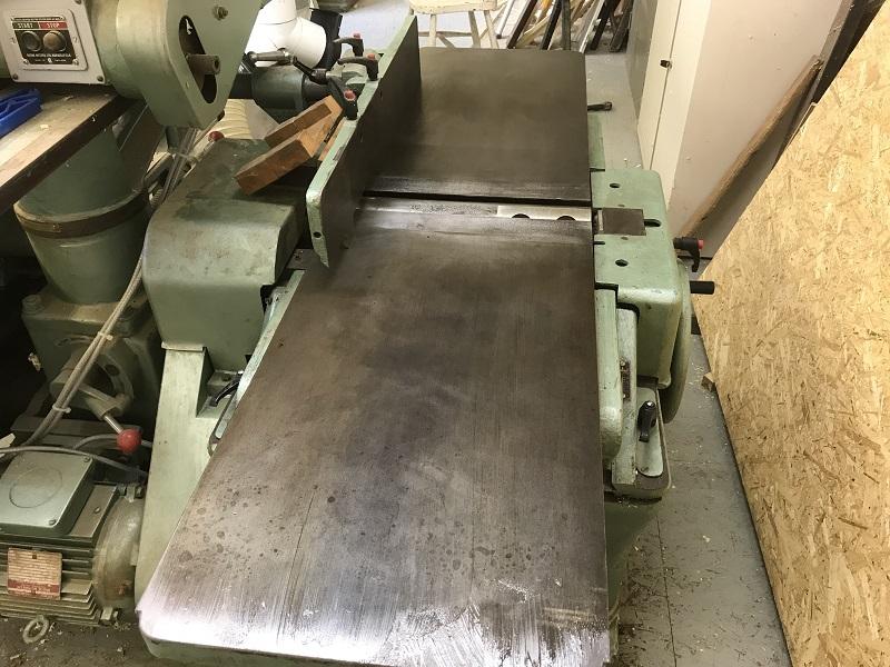

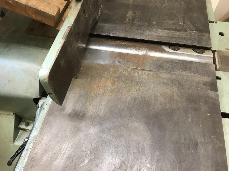

I've been doing a bit of woodwork recently, using among other tools my Planer / Thicknesser which is part of my Dominion Elliot combination woodworking machine.
Experiencing feed issues I realised that the lower table that wood slides on had a slight haze of rust from infrequent use. Now I use Silber Wax usually on woodworking machines but it does mark the timber.
I'd spotted a Beeswax Spray in the domestic stores - ideal I thought, a light beeswaxing and the spray should carry into the bits I cannot reach.
. . . this morning I took a look, and there was significant RUST where I'd sprayed  :bang:
There must be a load of water in the aerosol spray  :bugeye:
So, a good idea that went wrong but there must be a non-water-loaded wax spray - anyone know of one?

You can dissolve beeswax into many solvents. Laqueur thinner comes to mind, but some less volatile might work too.

would waxoyl or another car type wax work? I've an aerosol 'cavity wax' that I used on the car and also use on cycle parts. ACF50 might also work, I use that on the inside of steel bike frames and it seems to protect them.

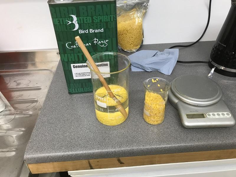

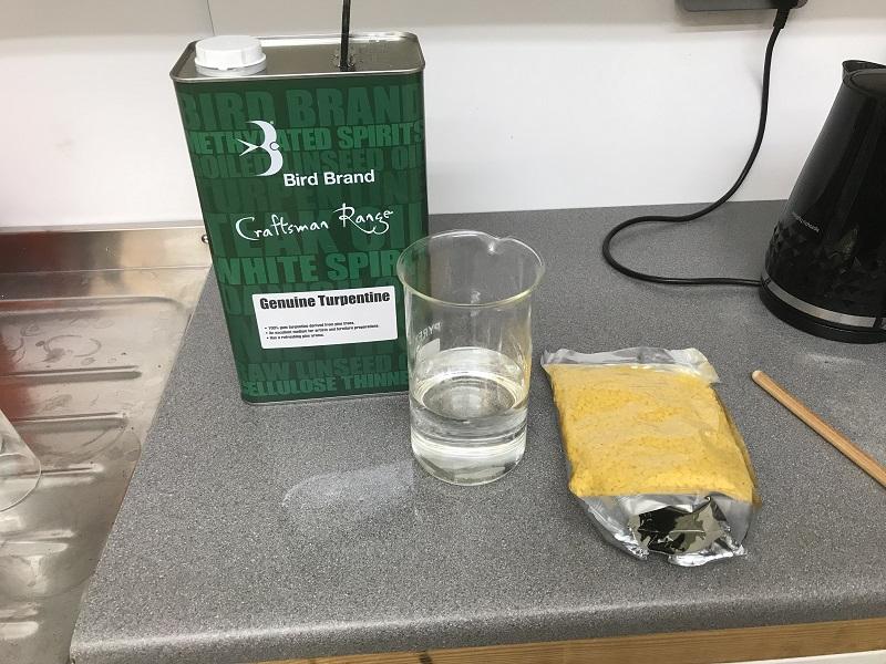

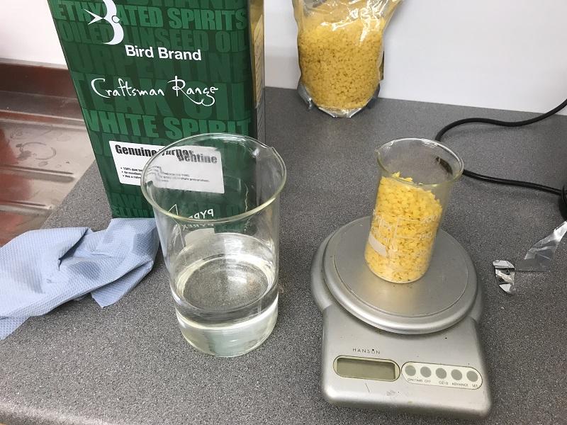

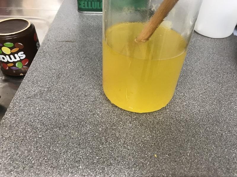

OK I've received a gallon of genuine Turpentine and a kilo of Beeswax so the experiment begins:
My hand spray bottles are 500 ml, so 500 ml of the Turpentine into a Pyrex flask but how much Beeswax will dissolve into it :scratch: I weighed out 100 gms of Beeswax into another flask and started adding it slowly and stirring - it seems it's going to be a slow process.
No doubt a bit of heat would help, but Turpentine is very inflammable so maybe not too clever an idea  :zap:
I'll leave it for a few hours and if things aren't happening I'll put the bigger flask in a bowl of warm water.

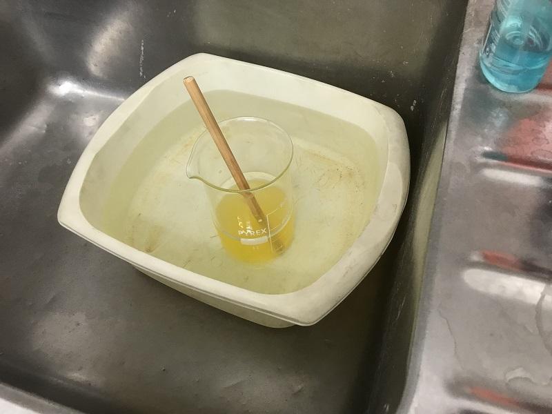

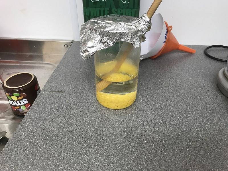

So time passes - like watching paint dry - a slow process.
Added a little heat in the form of a bowl of hot water, and continued adding the lentils of Beeswax and stirring it whenever I walked past. So far 25 grams are pretty well dissolved in the 500 ml of Turps - there are still one or two floaters of partial lentils.
I'll leave it in the bowl over night - no doubt the water will cool, so it may start to settle out of solution - at the moment the viscosity is OK for the hand pump spray bottle but when it cools it may need a bit more Turps adding - I hope not as I want to be able to leave a decent wax deposit on the machinery when the Turpentine evaporates.
Re: Sprayable Wax - does it exist?
« Reply #10 on: May 03, 2018, 03:14:17 PM »
Surprisingly after supper I found that the water had cooled and the dissolving of the wax pellets was pretty well finished  :thumbup:

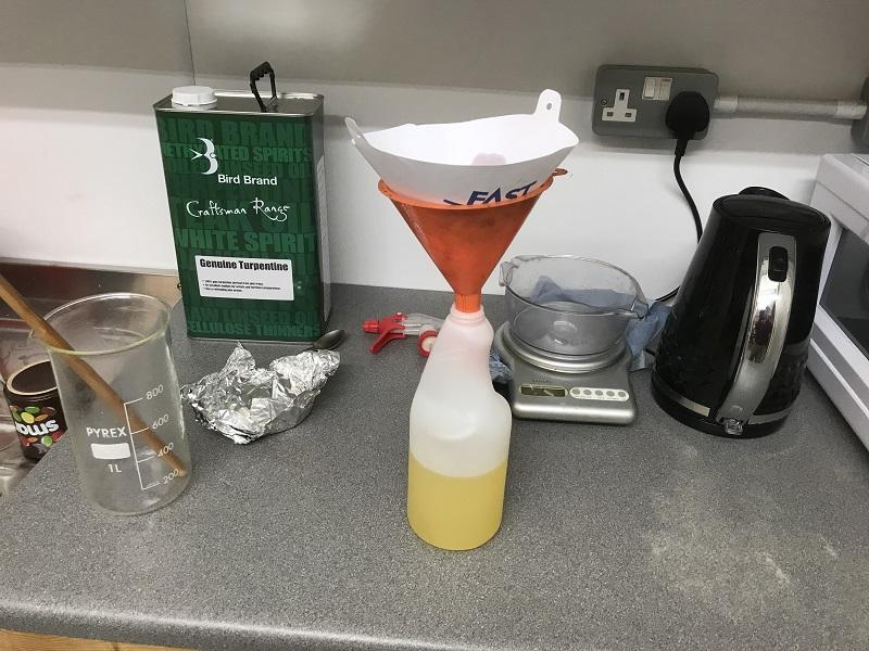

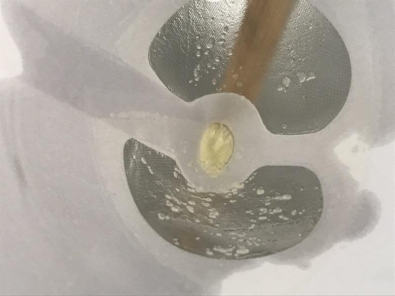

So I decided to filter it through a paint spraying filter, put it in the hand spray bottle and have a go at the machine table. A light coat of the wax solution and a gentle scotchbriting brought the table back to life - cleaned it off, gave it another spray, wiped it down and we'll see how the Turps evaporates overnight before I attack the rest of the machine

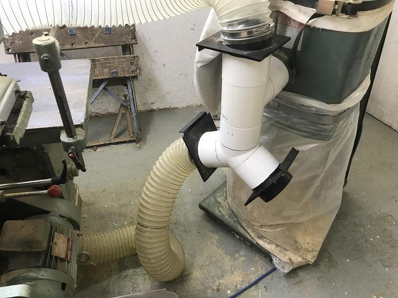

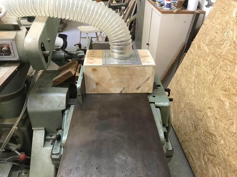

All this has encouraged me to at last sort out my extraction plumbing and make a simple box to extract from the thicknesser and rip saw when in use - by golly they kick out loads of wood plannings  :bugeye:
In celebration I put another 25 grams of Beeswax in 500 ml of Turpentine to leave over night and soak - maybe all that warming and agitation isn't needed

The wax wasn't a major expense, it's the genuine Turpentine that's expensive.  £38 for a gallon inc postage. But a gallon will probably last me out.
Watching videos of Beeswax furniture polish being made they add molten wax to a mixture of Turps and boiled linseed oil in a 1:1:1 ratio. The wax coagulates then they leave it for a few weeks on a sunny window cill  and it turns into a soft paste.

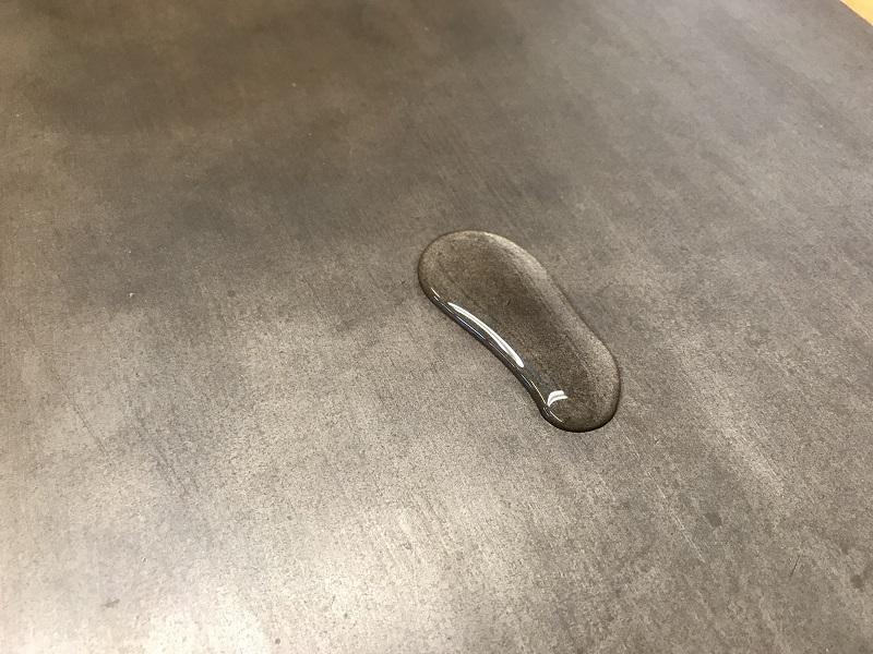

The Turps has nicely evaporated on the machine bed over night, and the wax residue is nice and firm, giving that squeaky  feeling as you rub your fingers over it.
I tried scraping with a sharp wood chisel to see what sort of deposit was left, and apart from where I'd missed bits in the wiping process there was no perceptible wax coming off, (so probably a few tens or hundreds of molecules thick ) but I'm convinced it'll do the trick.
As a test I put a bit of water on the table and as expected it balls up with no wetting at all.
The beaker of extra Turps & Beeswax is slowly dissolving at room temperature and only the occasional stir  :thumbup:

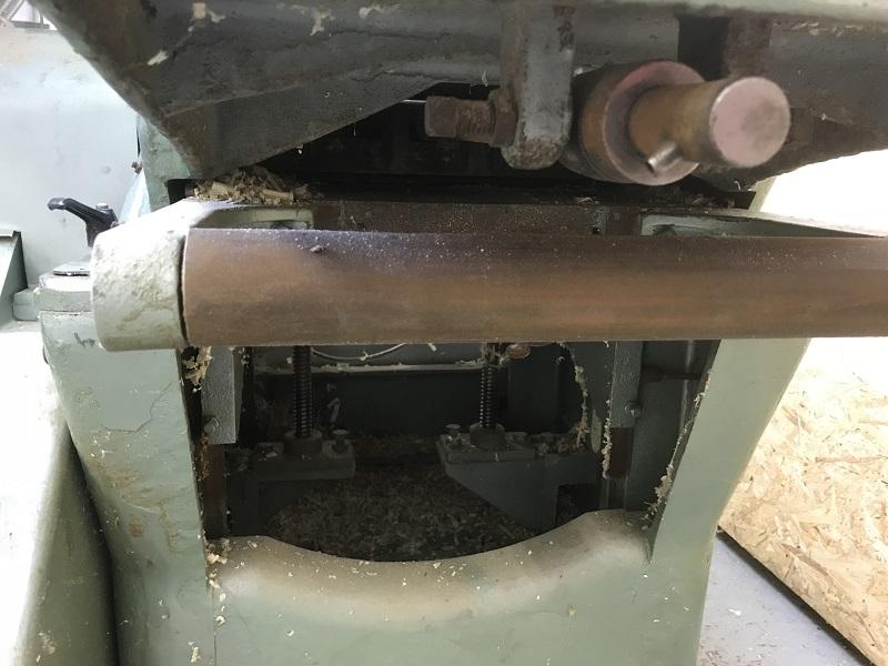

Having need just now to get a definite measurement for my Ripsaw spindle (1.25" / 31.75 mm) as I'm buying new blades I undid the large left handed nut that holds the 500 mm blade on, and promptly dropped it into the cowl that leads to the dust extractor  :bang:
Despite many contortions I couldn't reach it - so saw off / dust cover off / cowl off and eventually found it 6" up the extractor hose !
BUT, having got in so far it revealed a large compaction of sawdust round the elevating mechanism that must predate when I wired the extractor to come on with the saw, and my builder was using the machine on my house rebuild and he didn't always remember to turn it on manually. Clearing it all out let me spray my magic Beeswax on the sliding surfaces of the rise and fall table, and the spiral bevel gears of the height adjusting mechanism, all of which now work so much more smoothly.
