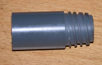

« Reply #23 on: April 22, 2018, 06:28:34 PM »
That's just a normal three phase motor, or a single phase, or a large hamster in a running wheel.
One pulse per rev is all you need to cnc turn threads.
I have a party trick (which I can't find video of). 2 start tapered ACME thread. All done with......wait for it......one pulse per rev.
