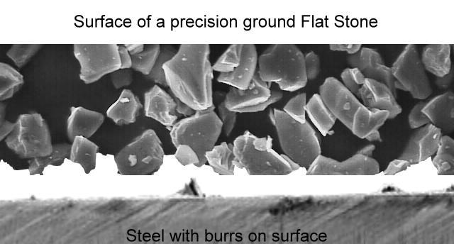

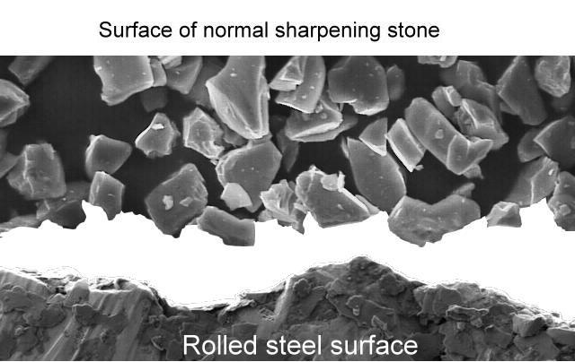

« Reply #11 on: April 01, 2018, 08:32:30 AM »
I may not have communicated accurately enough, so here are a couple of doctored microscope images to illustrate what I believe Robin Renzetti proposed and achieved - and I copied, seemingly successfully:
Cheers,
Joe
Not to be purposely argumentative, but I'd like to see actual unaltered images showing the same thing.  I don't think what you've illustrated is possible.  The abrasive grains will either be ripped from their bonding matrix and/or fractured in a somewhat random fashion depending on the material and orientation.
Of course, this entire discussion is hypothetical.  The original question, as I interpreted it was "is this a waste of my time"?, to which I emphatically say "no" until proven otherwise.  If it's proven otherwise by doing the experiment then it wasn't a waste of time, now was it?

Well, sparky, sadly I don't have the means to do microphotographs....
The reason we use fine-grit diamond surface grinder wheels for this job is that they don't rip the aluminium oxide grain out or fracture them, but abrade them flat.
All I can tell you that my stones no longer work to sharpen anything, just slide across smooth surfaces. They will, however, make any tiny burrs shiny, so I can see where they are. By concentrating pressure a little on the shiny spots, they soon disappear and the stones slide again.
Since that is the intention of flat toolmakers' stones, I'm happy with the result.
