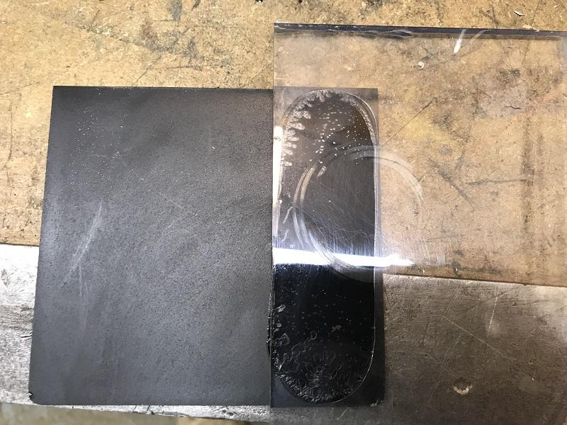

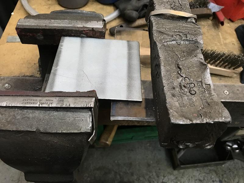

Re: Bonding Polycarbonate / Lexan Windows Into Steel Panels?
« Reply #5 on: March 17, 2018, 06:18:30 AM »
I did a simple bond test between a polycarbonate off cut and a sample of Zintec that had been painted with the chassis paint I'm using.
I used the vinegar smelling version of silicone bath sealant ('acetoxy') and let it set for 12 hours - probably not long enough as it still smelt vinegary this morning - I suspect due to the very small air exposure channel.
It worked pretty well - If I still needed to bond the window in the lathe I'd be happy to use it, but I've managed to glaze the door using conventional rubber moulding strip.
I did however do a pretty aggressive peel test as per second picture. The bond area is 30 x 80 mm and the lead weight is 3500 grams. It stood the test for a good 25 minutes
This "Acetoxy" type of sanitary sealant was what I had to hand, but reading up on it is is not the best for bonding polycarbonate, however in this application I think that it would have been fine.
