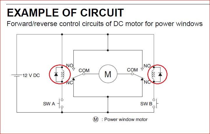

In the schematics below, there appears to be 2 diodes wired in parallel with the coil on this relay. I would have thought they would be wired in series. Just checking as I don't want to fry it.

The circuit is fine !  As shown the relays appear to have built in diodes, if you are using the ones specified then they must be wired with the correct polarity to the coil terminals.  Otherwise using relays without diodes, the coil polarity doesn't matter but any diode added must be the right way round.  All the diodes are doing is acting as spike suppressors.

You mention "2 diodes wired in parallel with the coil on this relay".
There are two relays each with one freewheel diode! As Baron says these are there to suppress spikes thus protecting the contacts in the switches SW A & SW B.

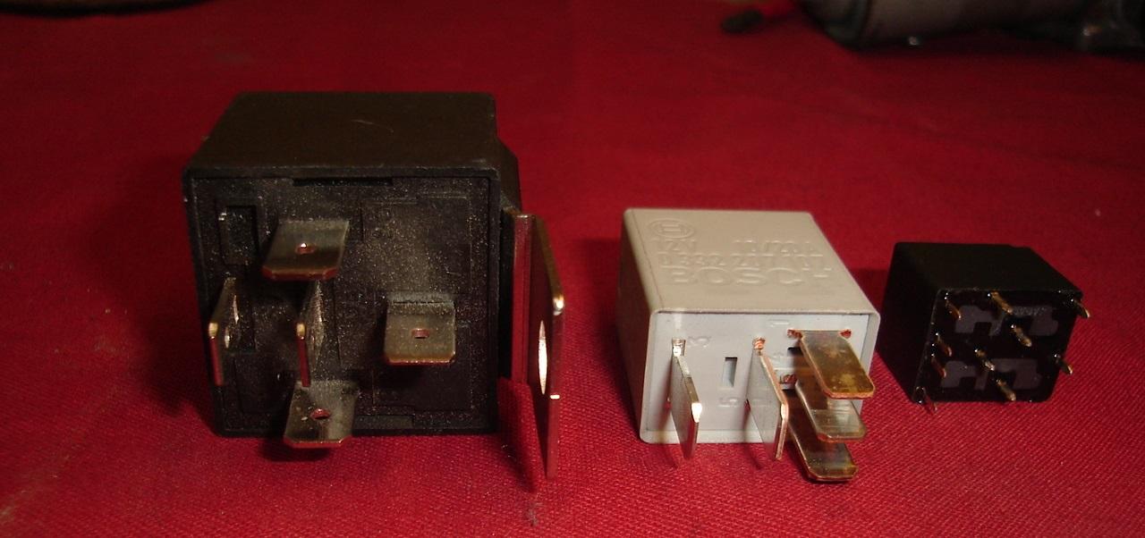

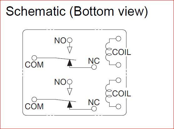

Thanks for the replies. This is actually only 1 relay, it has dual coils. It is also very tiny so I don't know how they could find room for diodes inside. 17 mm x 14 mm x 13 mm. Actually, I can't figure how they got anything inside that tiny cube, yet it's rated at 20 amps. It.s the one on the right in the 3rd picture.

As Phil said the schematic shows external diodes fitted across the coils to prevent them generating large reverse voltages when the switches are opened and the magnetic field in the relay collapses.
Without the diodes these large voltages would generate arcs across the switch contacts and wear them out.

Just had a look at the data sheet. Even though they are in the same housing there are two independent relays. There doesn't look to be any diodes internally so you'd have to add them.

Some one has incorrectly used the symbol for a relay with built in diodes on the circuit diagram that you posted. After looking at the data sheet there are no diodes built into that relay, though they could have been.  You will have to add diodes yourself, any 1N4007 will work.  The 1N4007 is rated at 1000 volts, 1 amp.
You mention how they could incorporate diodes into a housing of that size along with all the other bits, well the die size for common diodes are only a couple of mm in area, and they wouldn't have any packaging around them to increase the size either.
