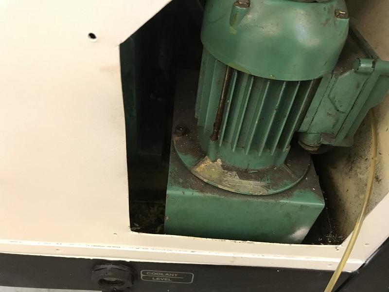

Well Steve, yes it probably is.
As the MIRAC is still waiting for a coat or two of white paint I've not refitted the reservoir, which is still sitting as per the photo next to the workshop coffee making area AND IT'S NOT LEAKED  :ddb:

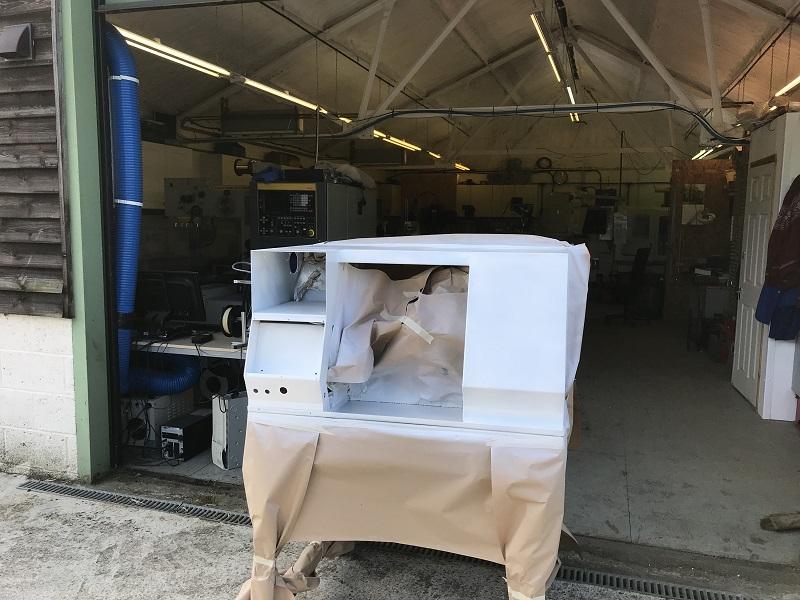

Re: Rebirth of a Denford MIRAC CNC Lathe
« Reply #129 on: March 26, 2018, 07:44:21 AM »

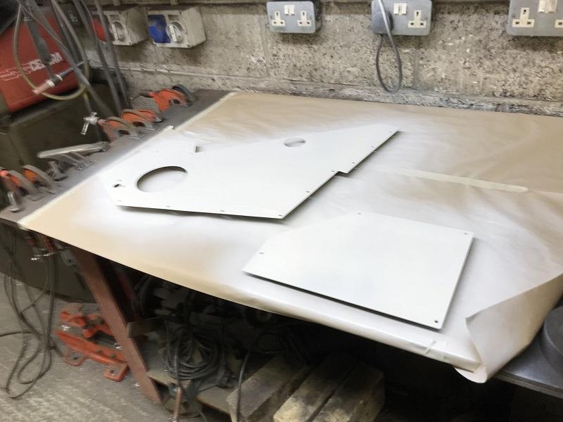

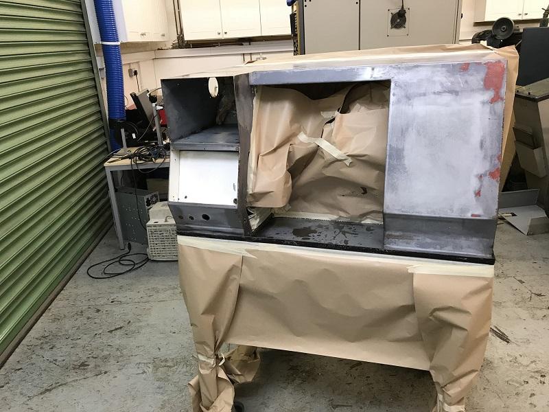

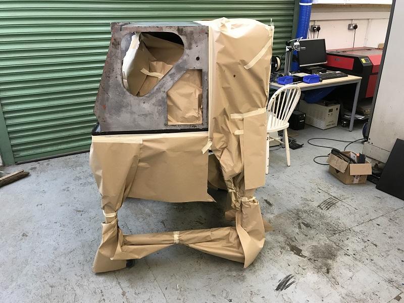

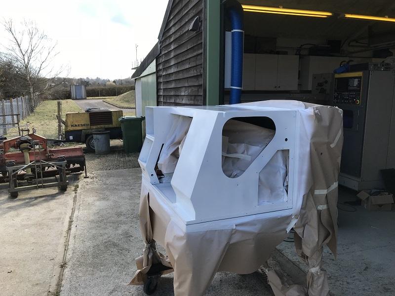

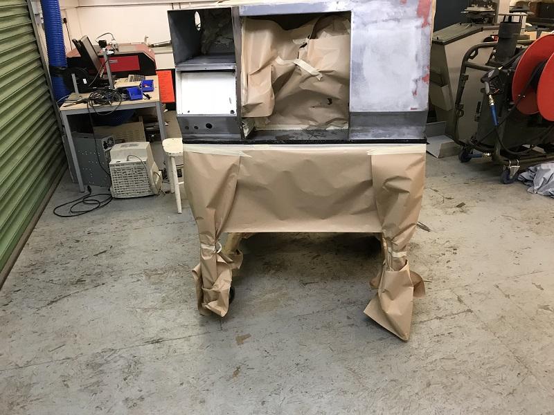

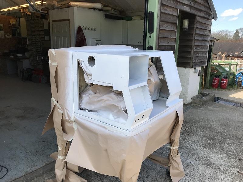

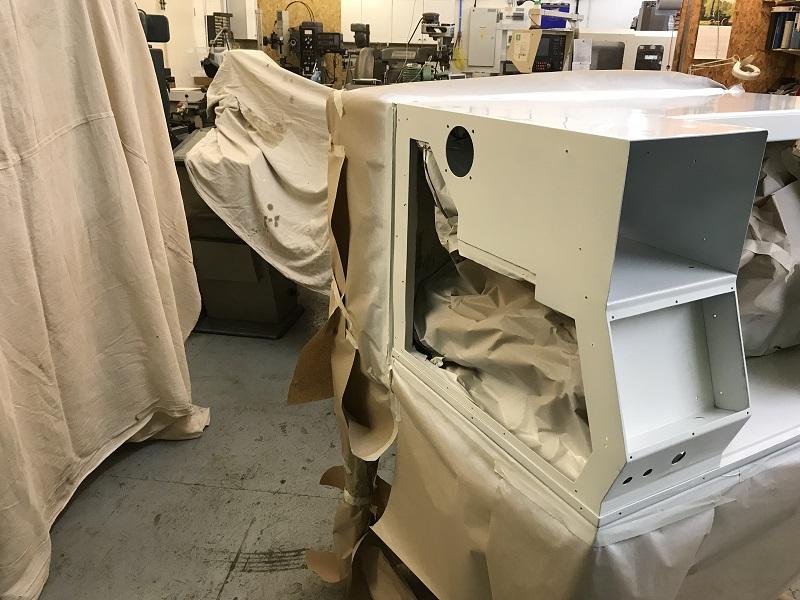

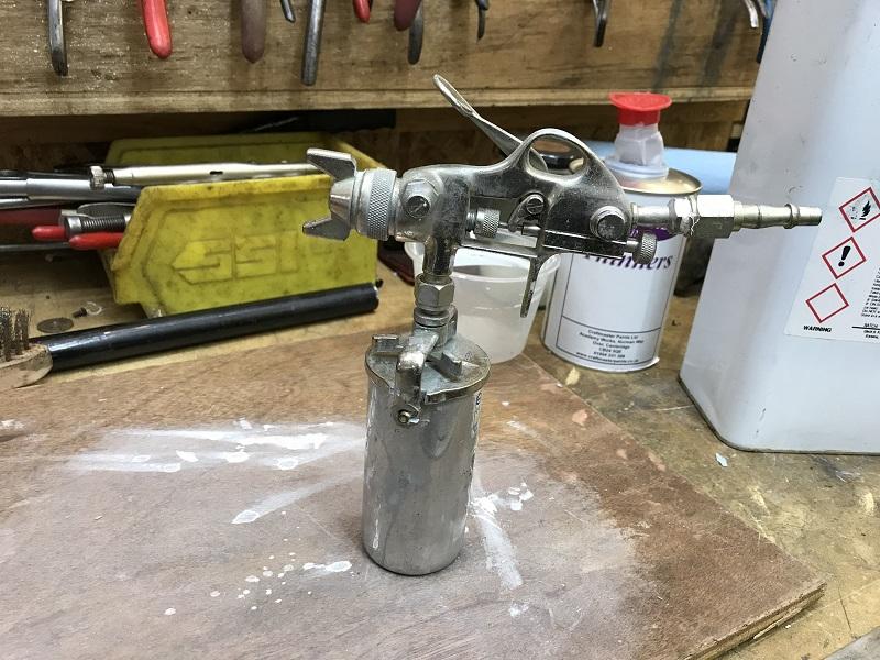

I set too masking up the MIRAC this morning - outside is fine but the interior was a pitta  :bugeye:
However the paper dispenser came into its own - would have been tricky without it.
... then the big decision - spray indoors and get overspray over the rest of the workshop, or wheel it outdoors where if the wind picks up I'll lose the paper masking and insects can be an issue. Well it's a dry day with the sun shining and only a light breeze so I pushed it outside.
On the overspray issue, I'm using a 'detailing gun' and actually the overspray is fairly minimal though still there.
« Reply #130 on: March 26, 2018, 07:47:10 AM »
So out she went and got the first coat - next one due in 24 hours so she's back inside until then.

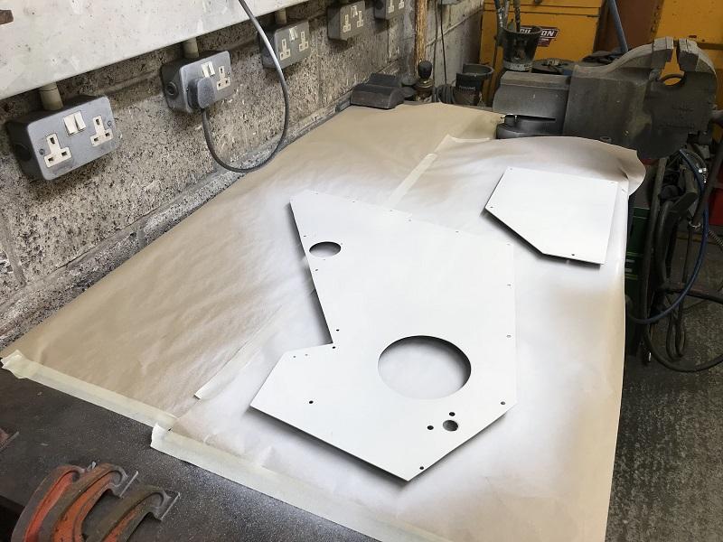

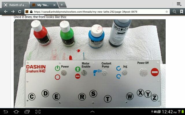

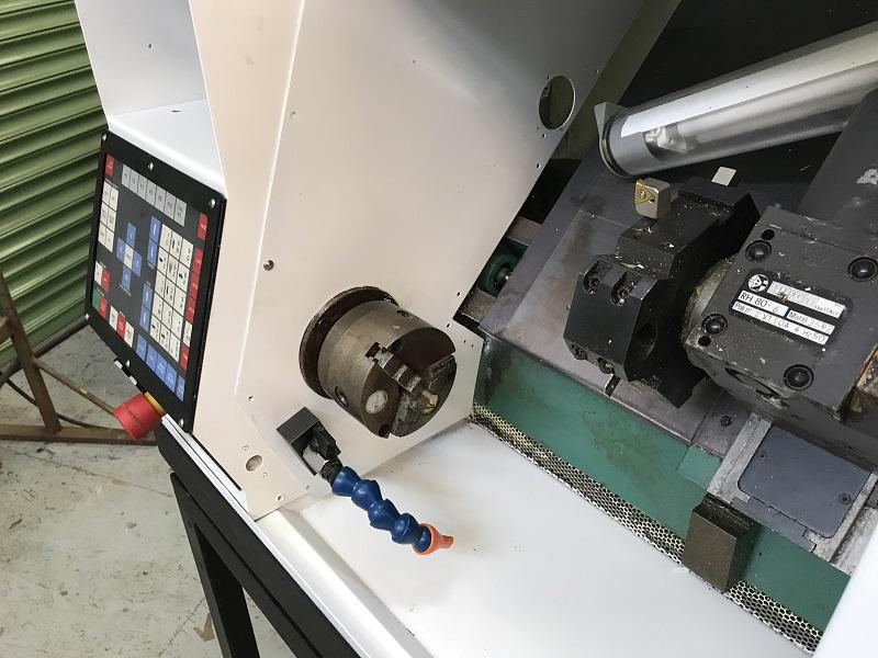

So what do you do while paint is drying . . . . .sand blast and spray black the door slider rails, and have a go at finishing off the label for the Button Panel.
This I do by spraying the reverse of the polycarbonate panel in black, then reverse engraving the text using the  CNC laser engraver. It hasn't come out good enough to use on this occasion for two reasons. Firstly I didn't leave the paint long enough and the white infill has reacted with the black background. Secondly I did the engraving at slightly too high a power setting and the front face is distorted.
Never mind, that the good thing about CNC - tweak the commands and do it again, you only need to alter the bits that were wrong rather than the entire gizmo.  :thumbup:

« Reply #134 on: March 27, 2018, 03:22:36 AM »

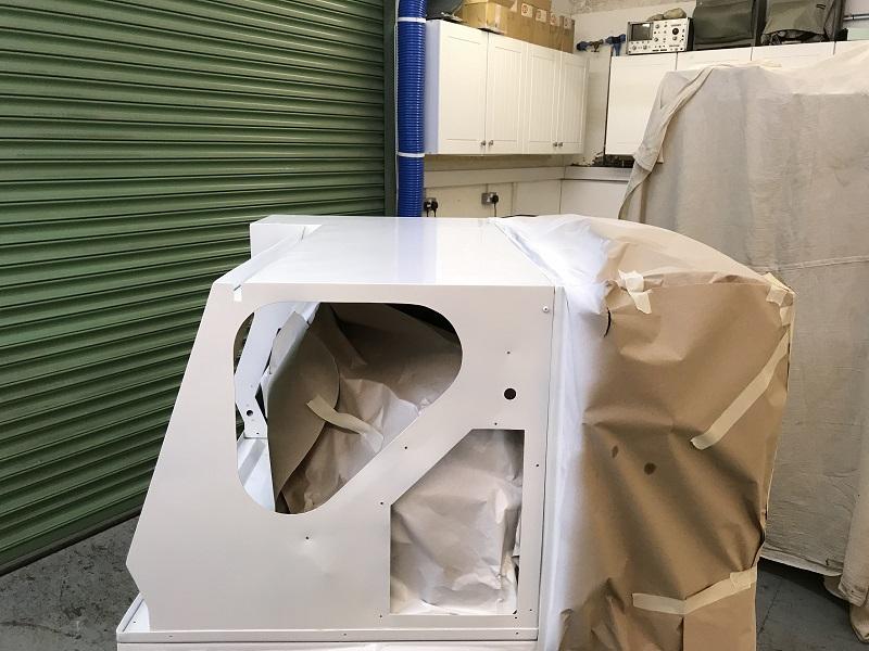

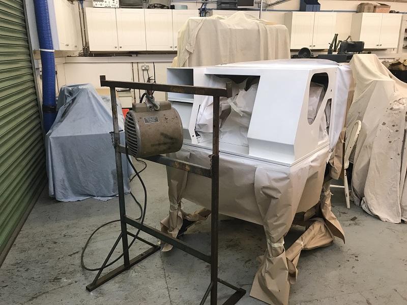

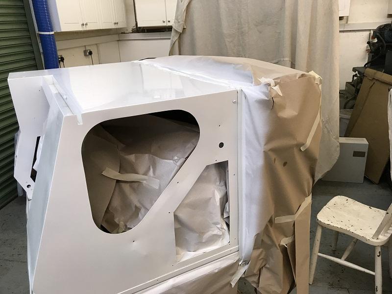

Raining today, so the second coat has had to go on indoors. Dust sheets everywhere !
First coat went on rather dry and didn't all blend so I used a bit more thinners this time, and of course went the other way and got a couple of runs   :bang: They'll be cut off with a razor when dry and touched in with a small roller.
« Last Edit: March 27, 2018, 04:20:12 AM by awemawson »
« Reply #135 on: March 27, 2018, 05:27:34 AM »
I need the paint to be good and hard before I shave the runs, and also before re-assembly. So I've set up a 4kW fan heater to bake it now it is touch dry.

Made a few alterations to the Button Panel Label and re-did it producing a more satisfactory result.
a/ I changed the font to Ariel Black
b/ I removed the black paint by scanning with the laser rather than doing a light cut to eliminate the 'two line' effect
c/ I filled the lettering with water  based emulsion paint as I found that the white acrylic I'd been using was dissolving the black surrounding the letters
I think this one will pass muster  :thumbup:

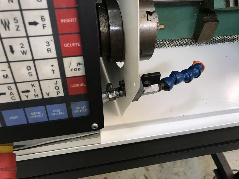

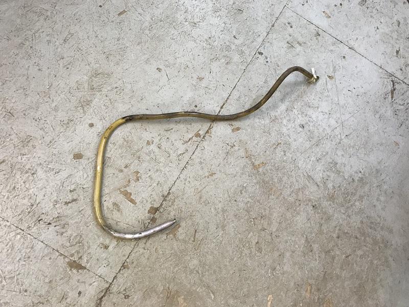

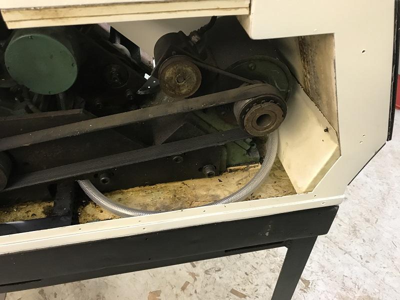

As I'm held up for a bolt delivery I decided to re-run the coolant pipe as the original is old and brittle.
Obviously this starts at the coolant pump, snakes through the body of the machine and terminates on a block bolted to the spindle panel. Now when I dismantled this it was evident that one of the bolts had been cross threaded and inserted at a rather jaunty angle. So firstly I re-tapped the block. I imagine that originally the block was offered up after the spindle panel was mounted, and the cap screw inserted on a long driver, hence the cross threading. So I decided to bolt it on first and loosely fit the panel until the bolts arrive.
Didn't quite go that way, as the panel and rear protuberances from the block need to be fully seated before a little protection panel (that protect the button panel wiring) would fit on. So the Spindle panel was pushed fully home and given a single screw to hold it in place.
Having got the coolant pipe done there was nothing stopping me re-plumbing the lubrication pump, so this was next on the agenda.

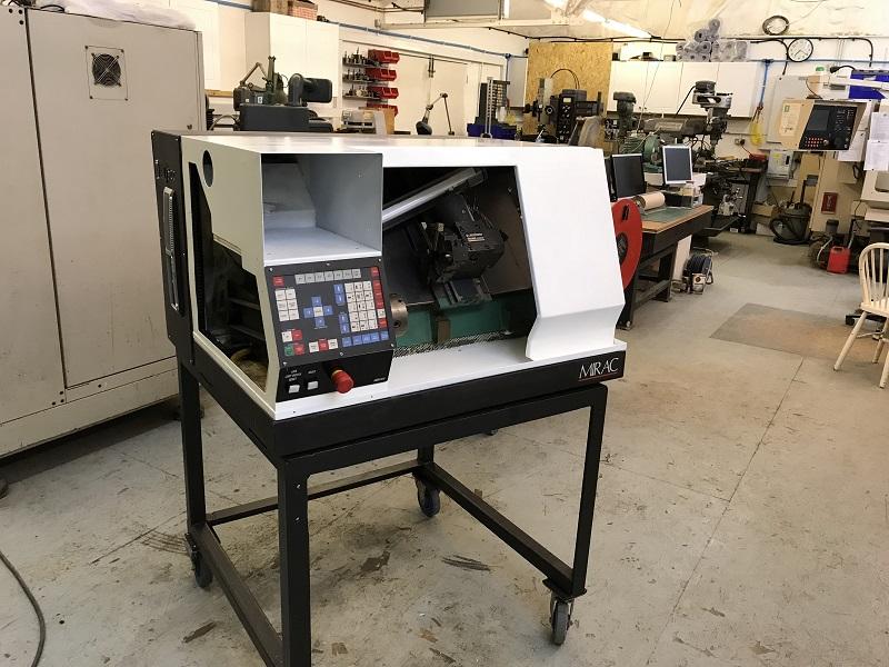

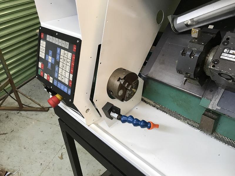

« Reply #141 on: April 06, 2018, 12:27:29 PM »

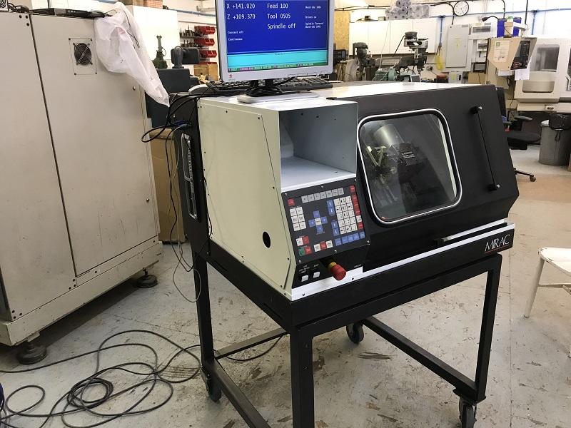

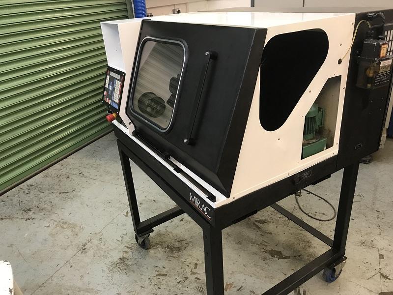

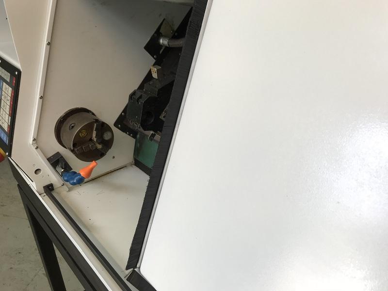

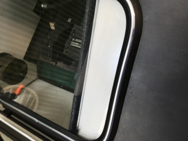

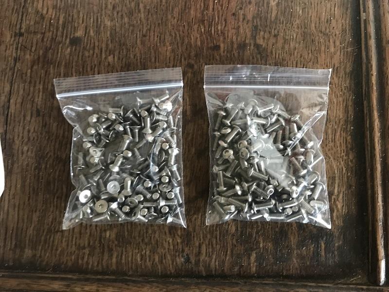

At long last the screws that I had on order materialised and I could put the lathe back together. All went reasonably well, not too many paint chips to touch up.
Glazing the Tailstock end window was a bit of a struggle, and there was a bit of paint damage when I'd finished, but I got there in the end  :thumbup:

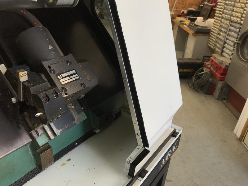

Having re-set the rails that the door slides on it was necessary to first do a trial fit and make sure it still slides ok - which it did.
« Reply #142 on: April 06, 2018, 12:31:42 PM »
Then it was just a case of plodding on fixing internal and external panels, interior light etc..
A quick run through of the M6 bolt program proved it still works  :lol:
So that's just about that - just got a little retainer clip to fit to prevent the door being lifted off

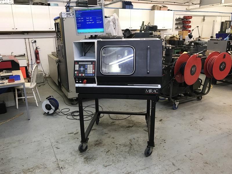

. . . remember how it was? . . see the last picture

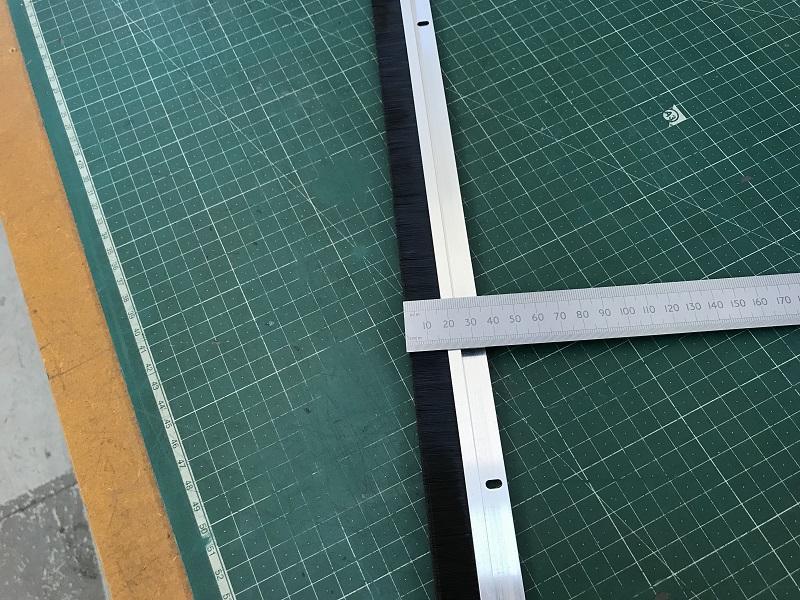

Of course these things are actually NEVER finished. It wasn't until the postman delivered a long thin parcel this morning that I remembered that I hadn't replaced the door wiper strip - another long awaited delivery  :bang:
A bit fiddly to fit as not quite the same size as the original, and the two smaller bits had to have a bit of a hair cut to allow the door to slide reasonably freely - but now fitted.
. . . .so perhaps NOW it's finished  :scratch:

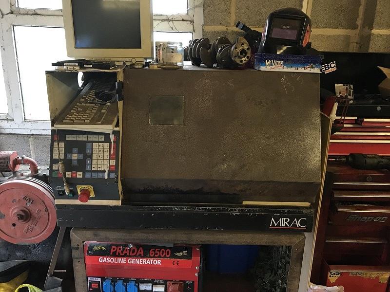

Offline nrml
  • Posts: 262
« Reply #149 on: April 07, 2018, 02:15:02 PM »
Yet another excellent restoration thread :clap:. Not quite in the same league as the Traub restoration but still very entertaining and educational. You sir are a real inspiration to us all :thumbup:.
Is the tool changer going to get a tear down and re-grease at some point in the future? It sounded a bit noisy in one of the earlier videos. Has that resolved ?
