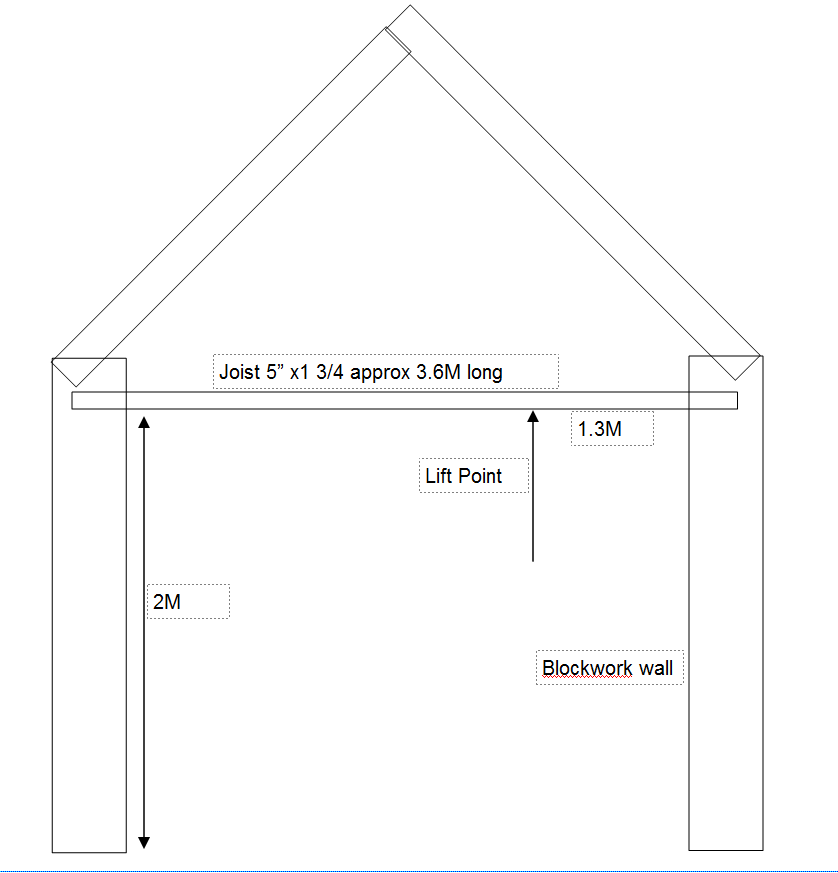

Considering a larger mill but will have to install myself. Weight all up is 160 kgs but I'm hoping to hoist it up in bits using the joist and a pulley or similar. How much weight can a 5" x1 3/4" joist take ? about 3-4ft from the wall. Any idea ???

Re: Can a 5"x1 3/4" joist support a WM18
« Reply #2 on: January 31, 2018, 01:55:19 PM »
If you can put a prop in to reduce the span of the joist, it will be fine, can you post a sketch of the set up?

« Reply #3 on: January 31, 2018, 03:29:34 PM »
Hi hermetic
Sketch as requested. The garage was built over 3 different eras. This is the weakest section (and the newest), others have massive joists.

« Reply #4 on: January 31, 2018, 04:02:59 PM »
Picloc -- The stress you will need to worry about is the extreme fibre stress in ths joist.  Assuming that you will hang the pulleu some distance below the Joist's horizontal centerline, the thing will be controlled by the Area Moment of Inertia.  That is (for the beam itself) b*h³*12 or (1.75)*(5^3)/12 = 15.625 in^4.  If the axis of your pulley is located (say) 5 inches (below assumed) from your Joist's horizontal centerline, then add r²A (64 * 7.5 = 480 in^4) to the 15.625 in^4 (for 495.625 in^4 total).  As I recall, your Pulleu will be located 1 m (call it 40 inches) from the "support" for the Joist.  Thus, yopur "applied bending moment" is (160 kg)*(2.205 lb/kg)*(40 inches = 14,110 lb-in).  Your fiber stress will be S = mc/I = (14,410 lb-in)*(8 inches)/495.625 in^4) = 233 lb/in².  Most structural timbers here in the U.S. have an allowable fibre stress in the 1600 lb/in² range.  Does this help?

« Reply #5 on: January 31, 2018, 04:36:31 PM »
When I unloaded my Bridgeport at my last place, I reversed the trailer into the workshop and erected Acrow Props either side of the trailer pressing up onto the relevant joist above thus minimising the span of the beam.
OK they were 9" x 2" joists but the span without the acrow props would have been 20 foot !

« Reply #6 on: February 01, 2018, 03:15:03 AM »
You could also connect the rafter to the joist halving the load .

« Reply #7 on: February 01, 2018, 06:05:36 AM »
You could also put in beam running across several joists to spread the load.

« Reply #8 on: February 01, 2018, 09:30:28 AM »
Thanks to all for the ideas.
Acrows sound wonderful, never thought of using them like that. I have some 3" box section which I can place in between the beam and the acrows, that way the stress is taken by the acrows and steel box section with the joist just giving lateral stability with minimal load on it. Acrows look like they are good for a ton so it should be comfortably rated.

« Reply #9 on: February 01, 2018, 12:12:13 PM »
Just make sure that the joist and box section cannot pivot forward or back by having them fixed to several other joists by a tie timber. In my case there was an OSB floor above fixed to all the joists very effectively anchoring the one I was using.

« Reply #10 on: February 01, 2018, 04:19:05 PM »
Yup! they all got in before I got back! if you prop the joist as close as possible to the lift point, with a fixed prop that can't fall out, you will be fine. Lift it half an inch and let it sit for a few minutes to test the rig, then go ahead.
