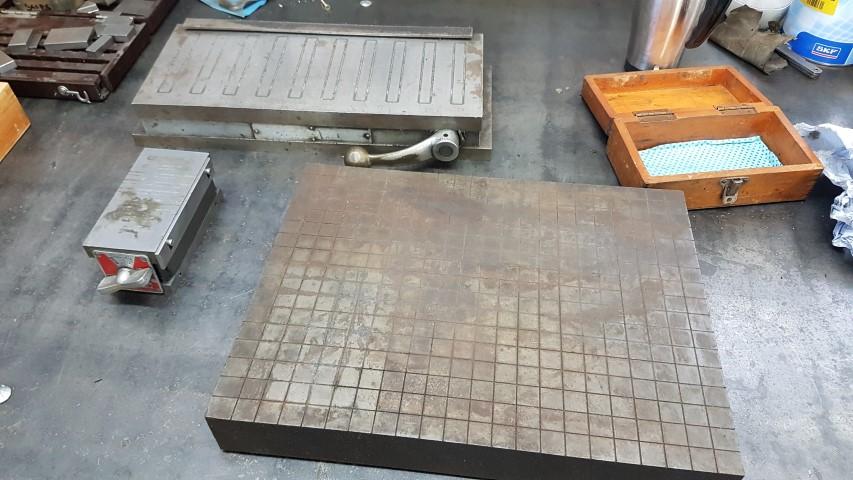

In a recent haul of bits I acquired was this massive piece of iron in the pic below, weighs a ton, just wondering if that is a lapping plate.... :scratch:
Cheers,
Paul.
Re: Lapping
« Reply #8 on: January 06, 2018, 07:54:05 AM »
That is a lapping plate!
Re: Lapping
« Reply #9 on: January 06, 2018, 09:43:47 AM »
Check that it is straight. Three out of three I have tried have more waves than north sea.
