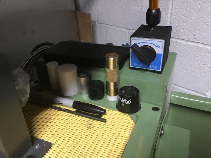

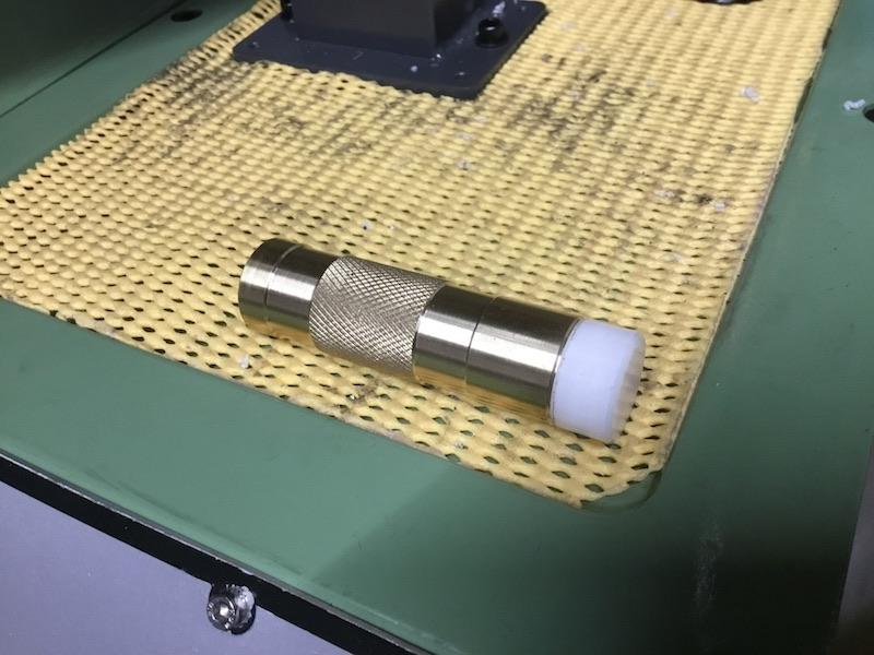

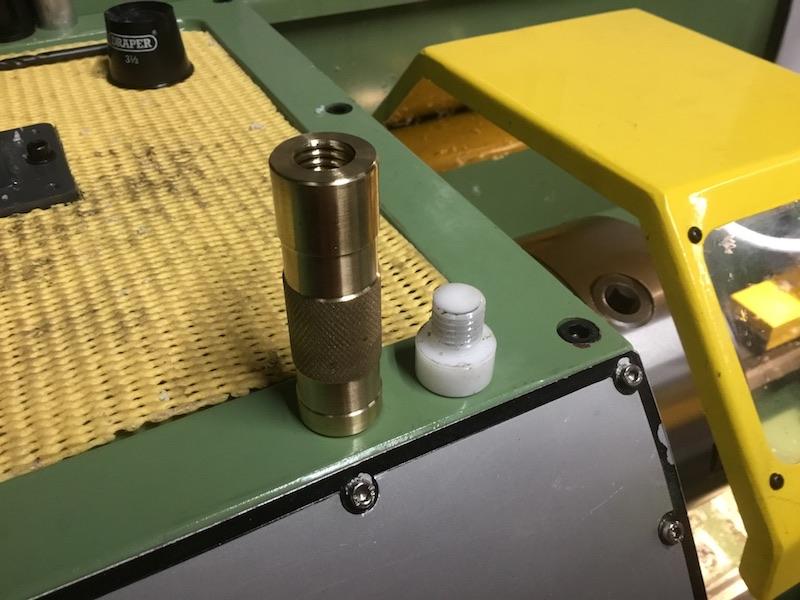

Been on my to do list for a while now.   Simple turning, bit of drilling, tapping and knurling to make a setting hammer.   Some scrap brass I had behind the shaper and a bit of Delrin left over from work stuff.   Kept me in the workshop for a couple of hours, as tea was also cooking in the workshop stove, so good excuse to keep an eye on it cooking.  The stove has been heaven these last few days with sub zero temperatures.
The hammer is a finger tool for setting up work where it needs a small adjustment or tapping down against a surface.  It also comes in handy for centering work in the lathe with a subtle tap.  A truely handy tool to have about the workshop for lathe or mill where a hammer might be just a tad overkill.

I'd need a handle on it or it would disappear into the Workshop gremlin's lair. Good idea and job well done.

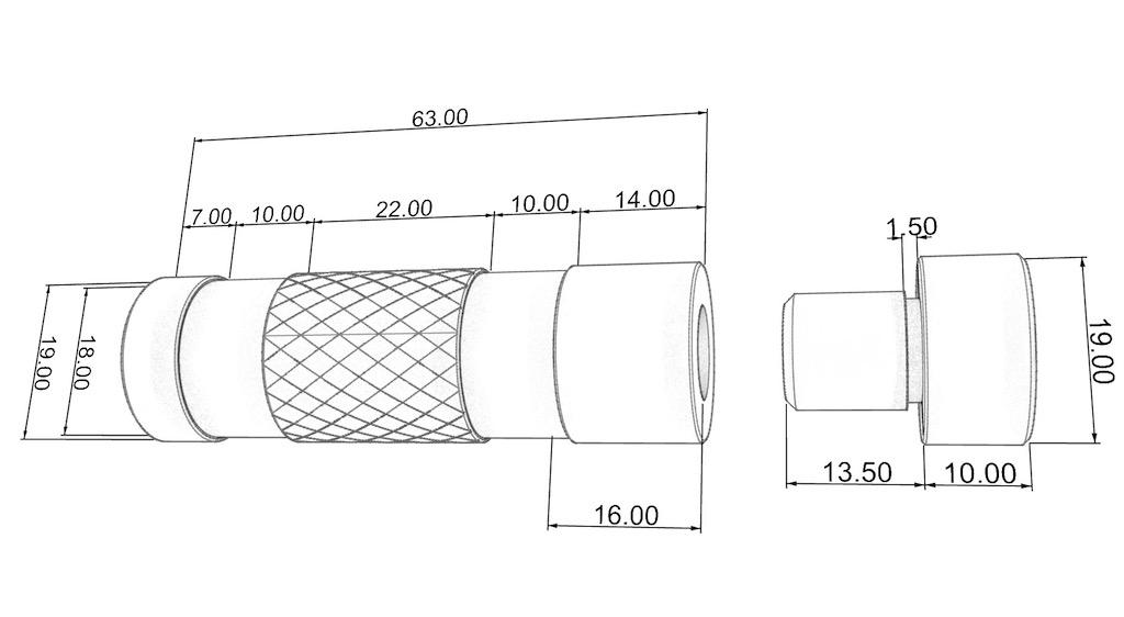

How about some dimensions please? I could do with something like that myself.... :)

Here you go John, measurements are a guide just adjust to the stock you have to hand.  I tapped the thread 12mm, but anything over 6mm should be fine.   Acetal, Delrin or Nylon would do for the soft end.  If you only have a short bit of brass, the body can be turned in steel or alloy and mirror the threaded end.  I used a light knurl so it has quite a flat top, then you can use beer can to grip the body for the recesses to clean up the knurled area (10mm gaps)
LOL, the 1.5mm should be 2.5mm on the soft insert, and of course, all dimensions in mm,  Unless you want a really BIG hammer.
