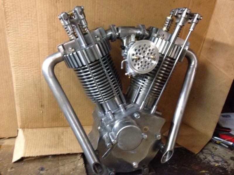

I am going to build a vintage board track racer with the v twin engine that I built on a thread here about two years ago. Here is a picture to jog your memory.

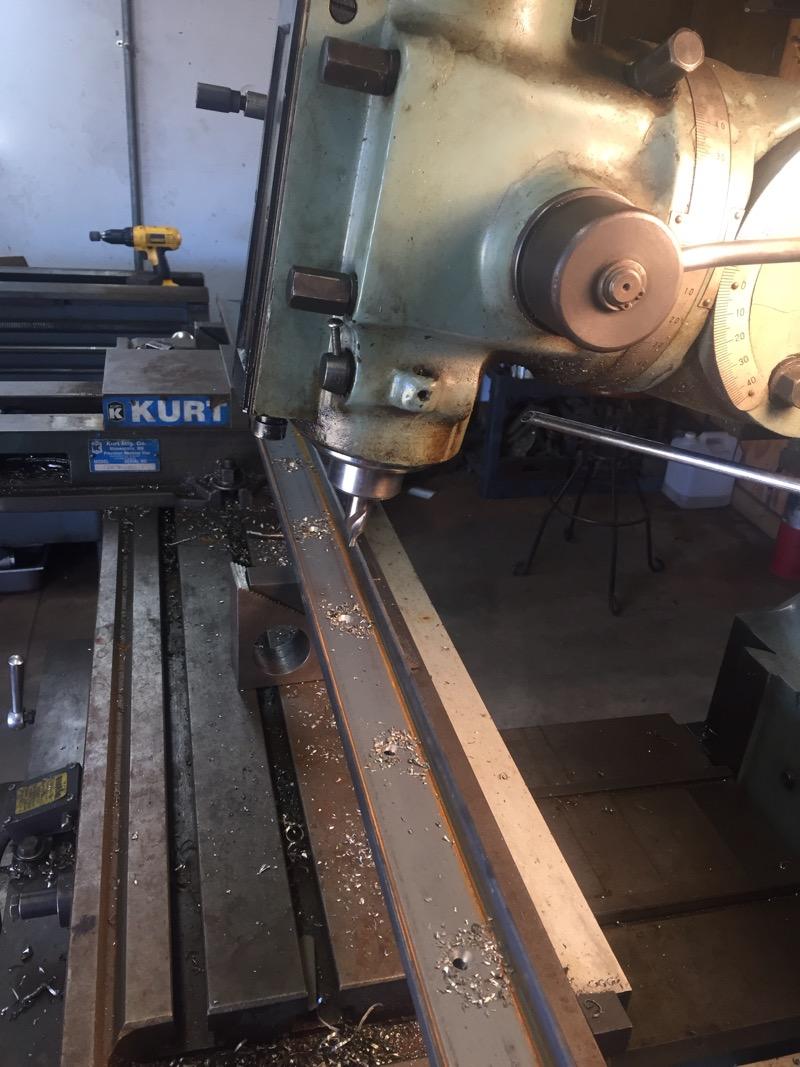

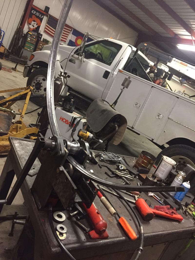

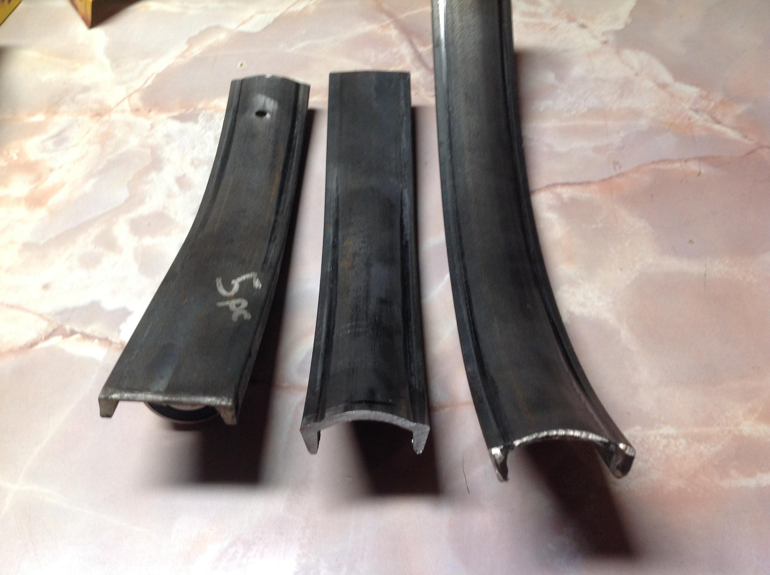

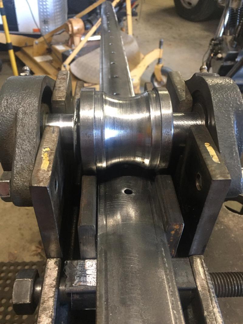

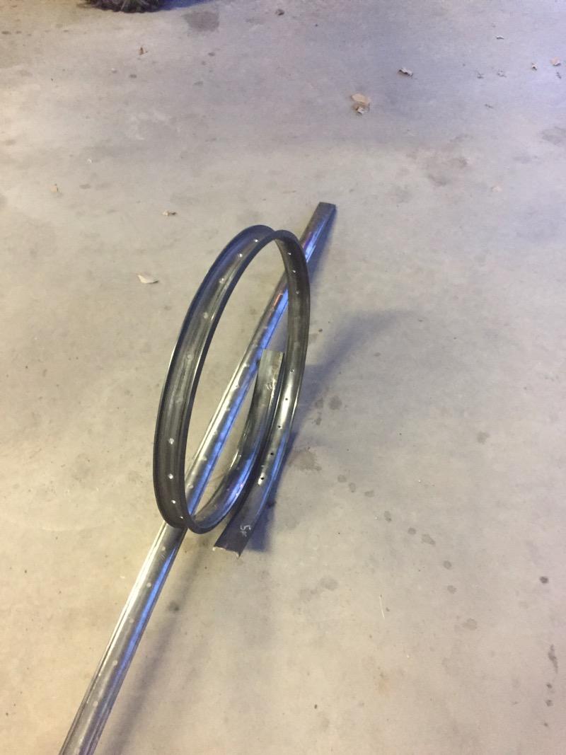

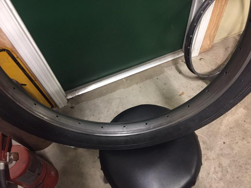

To build this bike without plans I need to start with the engine and a set of wheels. I have the engine so  what to do about the wheel. I could buy some but I can't find some I like.  I built some for the last bike but they had no drop center and it was tough installing the tires so I have decided to try to make some dies and try to form a drop center in a piece of 2-1/2-1/8 Chanel and then roll it to the radius I need. After making three sets of dies I Finally made some that I think will work. Here are some pictures of the process

Interesting stuff! I've never seen pics of this process before..

« Reply #4 on: November 30, 2017, 07:57:02 AM »
Wow. Rolling your own rims. That is real DYI! Awesome.

Mark I like to make all the parts that I can. Its not practical and definitely pushes my limits .

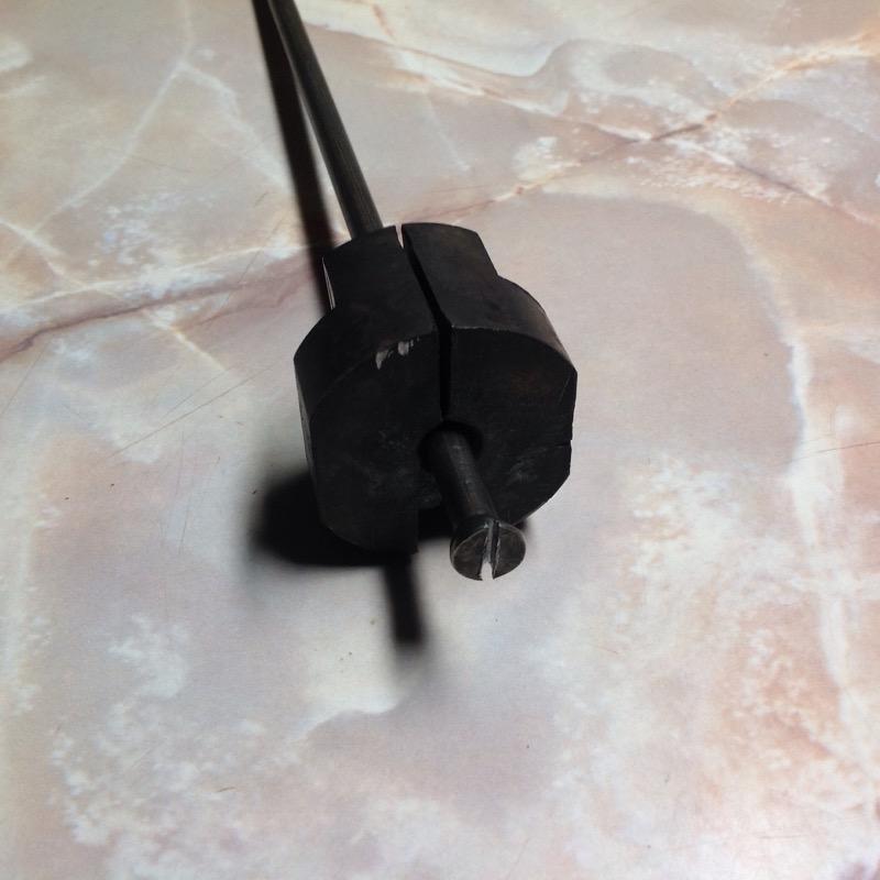

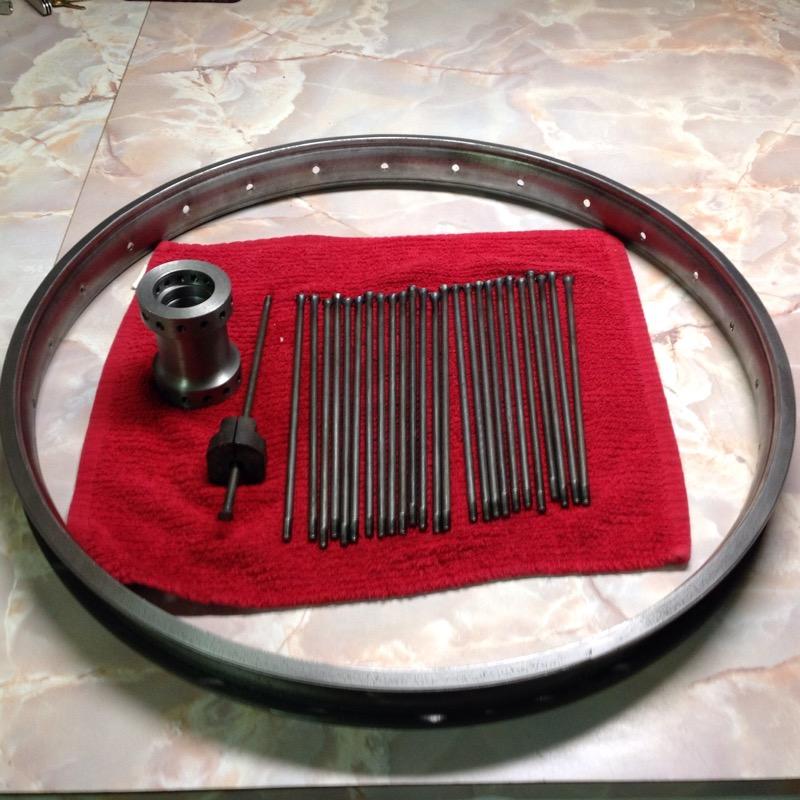

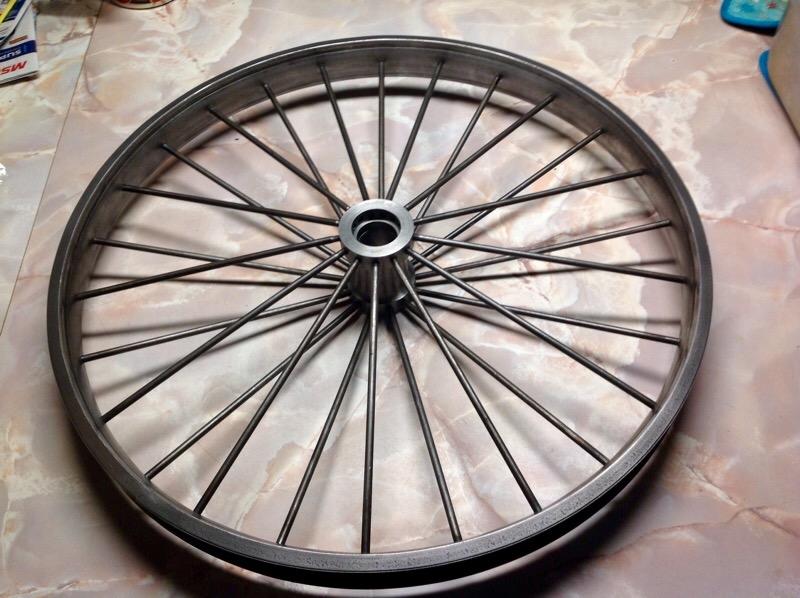

Here are some pictures of the spokes,hub, rim,and die I used to forge the head on the spokes.
I am still having a little trouble with the photo size thing some moderators please delete the over size ones thanks.

« Reply #7 on: December 08, 2017, 01:01:16 PM »
Do you use a hydraulic press to forge the spoke heads onto the die?

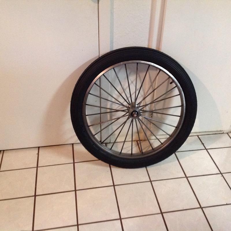

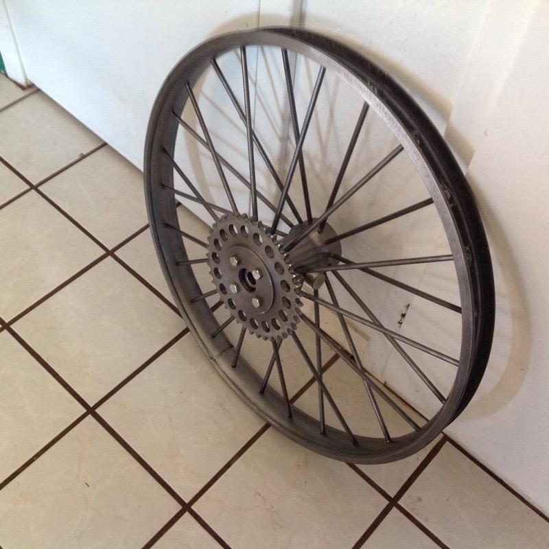

Mark the die is split so that when a spoke is in it and put in a vice it squeezes on the spoke and holds it firm then the end of the spoke is heated and forged in to the die see picture.
I have have been working on truing the wheels . I got the front one done and mounted the tire. they are Avon Speedmaster 3.00-21

« Reply #12 on: December 10, 2017, 03:34:14 PM »
Interesting so are the spokes tapped into the hub or do you insert nipples through the hub?

« Reply #14 on: December 11, 2017, 08:59:19 PM »
Osselton yes the hub is threaded.
The flashbackfab bikes are a very good example of a board track racer and thanks for posting the link but that is not what you are going to see in this post what I am building will have some similarities to a board track racer but is not a replica of a original. I enjoy building engines and the bike is basically a display stand for my engine all though it should be rideable it will be ridden very little

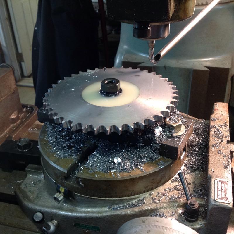

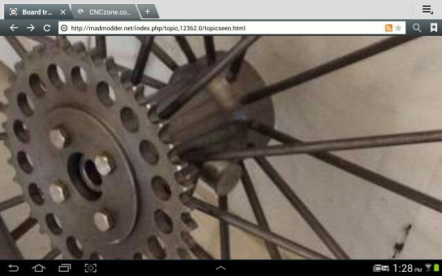

Here is a picture of the rear hub and sprocket blank

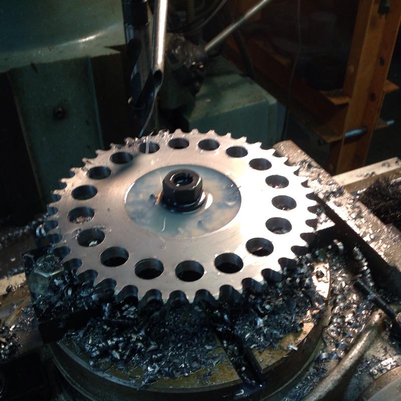

« Reply #15 on: December 16, 2017, 12:30:52 PM »
I made a little more progress on the rear wheel and sprocket . I am going to make the front forks next.

« Reply #16 on: December 16, 2017, 03:17:24 PM »
Its coming along good, whats that on the far side of the hub it looks like a spedometer fixture?

« Reply #17 on: December 16, 2017, 05:07:28 PM »
Tom it's a grease cup to lube the wheel bearings. It's for looks but could be used if I took the inner seals out of the wheel bearings.

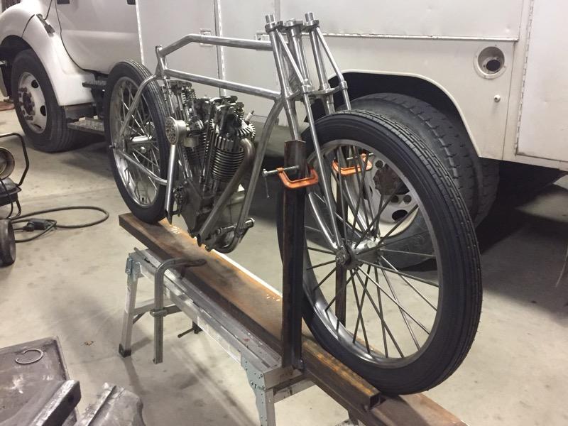

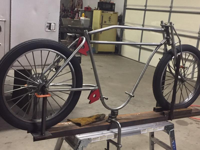

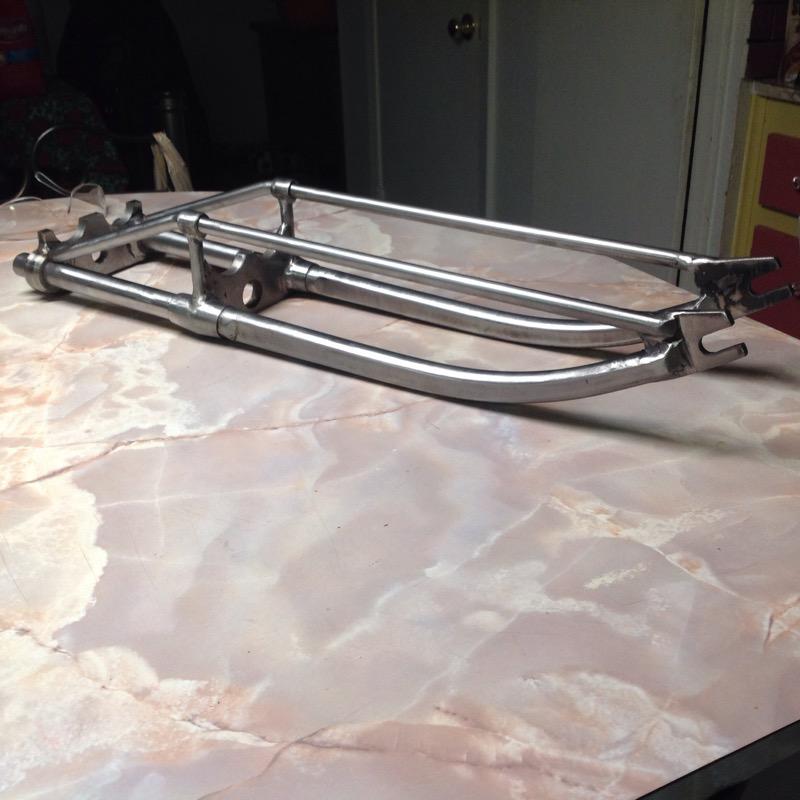

I have made a little progress on my bike. The forks are done and the frame is about done. Here are some pictures.

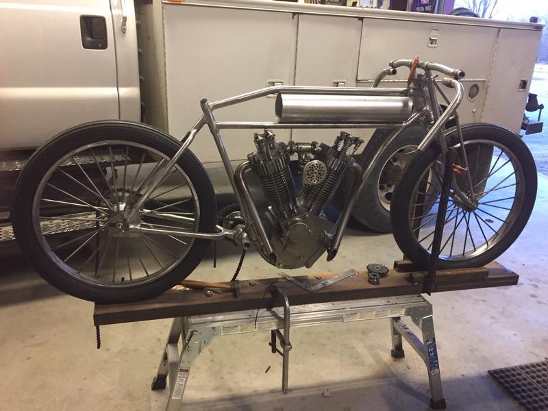

I got the peddle holder mounted and the frame welded up and then mounted the engine in the frame. Here are the pictures.

Coming along good! Are you sure you don't want to turn the front end into a girder front end?

« Reply #22 on: February 14, 2018, 09:03:11 PM »
Osselton I like the way the ridgid front end looks but I may change it in the future. There is so many parts that still need to be made I don't want to remake the  already made ones yet.
